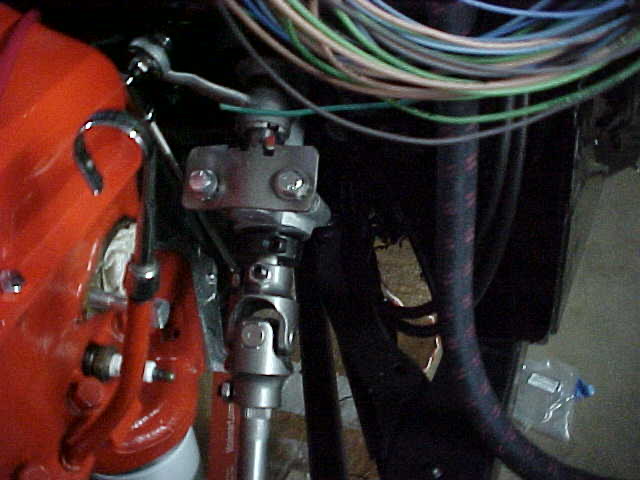

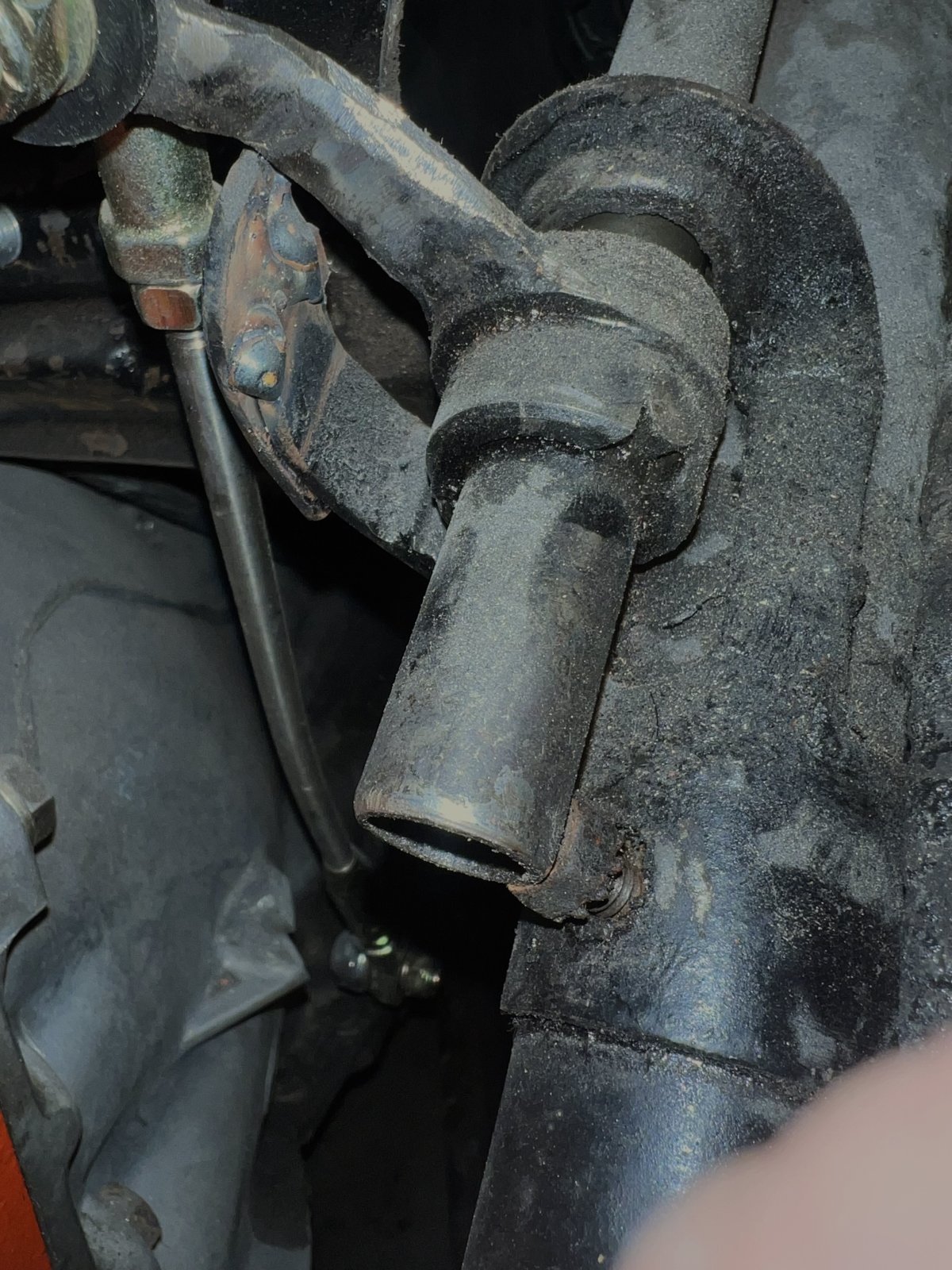

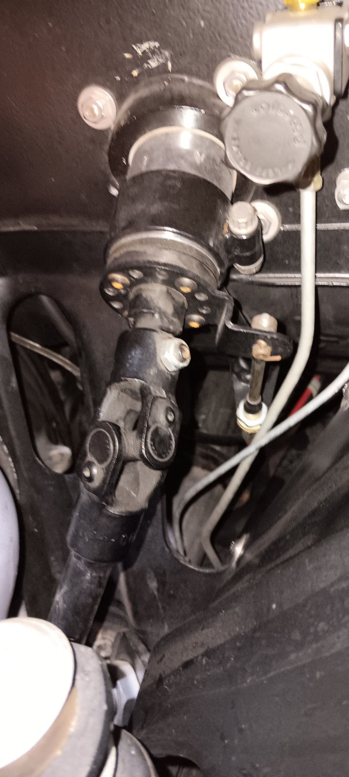

    I bought a 1946 Ford Business Coupe and want to do a few things to it. I have thought about a Tilt steering column, but it may be more trouble than it is worth. My original column looks really good, and I want to keep it. The car has a floor shift in it now, but I don't like the way it looks. It has an FMX transmission. I want to convert my manual shift column to an automatic shift. An ideas or suggestions would be very much appreciated. 20240124_085230.jpg 20240124_085110.jpg 20240124_085209.jpg

    It's a pretty common thing to do. I've done this personally a handful of times.You just gotta see if you're exhaust i's gonna be in the way of your linkage from the column to the Trans. Usually you would weld the 2 arms together and then fabricate the linkage. From that to the transmission.

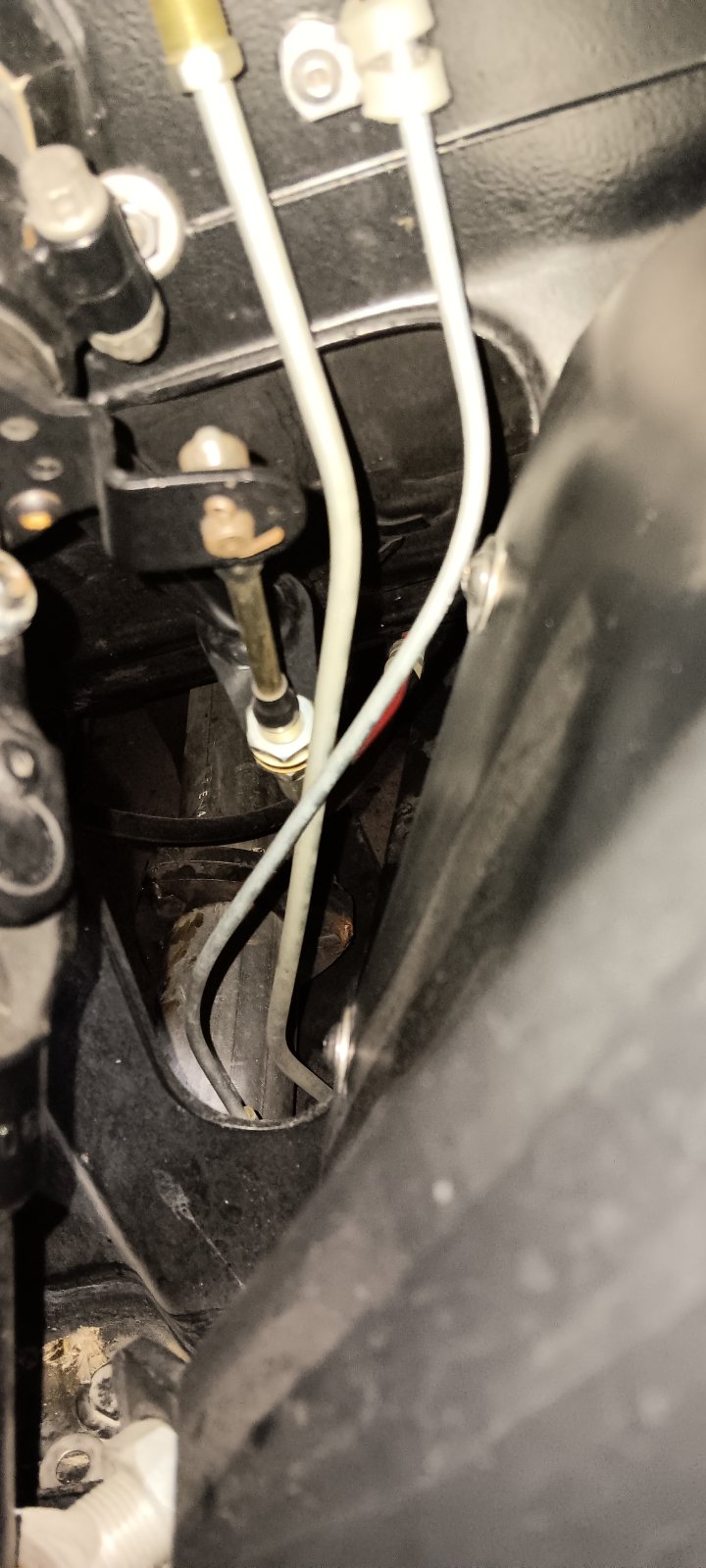

    Sure thing a cable could work. Just fine. here's one in A
    1950 Chevy, I have at work. A little bit different set up, but it could be made to work just the same. 20240124_121836.jpg 20240124_121827.jpg 20240124_121813.jpg

    That looks really clean too. I will have to wait until I get my headers back on before I can do any real measuring. If I got this right, just have the two shift levers "tied" together and it should work? Appreciate your help.

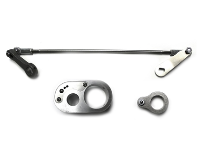

    This is the reply I got:
    "I do not have anything specific for the FMX, but the parts for the C4 and C6 are pretty universal.
    Kit comes with the detent plate and lower support. Detents for P R & N. safety switch in the Park position to prevent starting in gear. You may need to use the shift arm on the FMX trans. Not sure if the one in our kit will work on that trans." SS-LINKAGE-2T.jpg
  15. I suspect that probably only really works on their column, and the combined price will likely take your breath away...
    An off-t******lf bolt-on solution for your OEM column is probably nonexistent. The previously mentioned Econoline column would likely be the best lo-buck solution but would require some fab work. A '58-62 Ford full-size Cruisomatic column would also work (and likely be easier to find) but would need a bit more work on the D1 detent for a SelectShift trans.
    bama7 likes this.

    Their kit is around $190.00 on sale. Does not include the column of course. My biggest problem with the Kit is I would have to remove my column. I don't want to do that. I haven't even been able to remove my horn ring so far. If the parts were two piece and held together with Allen screws, then that might make a difference.

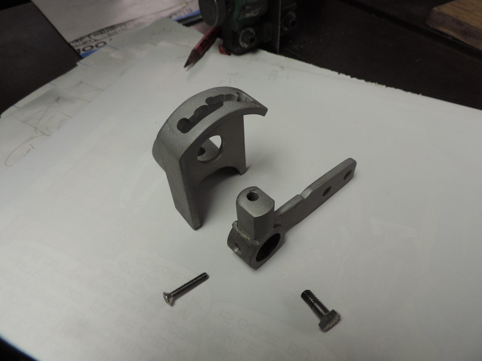

    Here is a detent I made for a 51 Ford column to convert to use with an automatic trans. DSCN3147.JPG

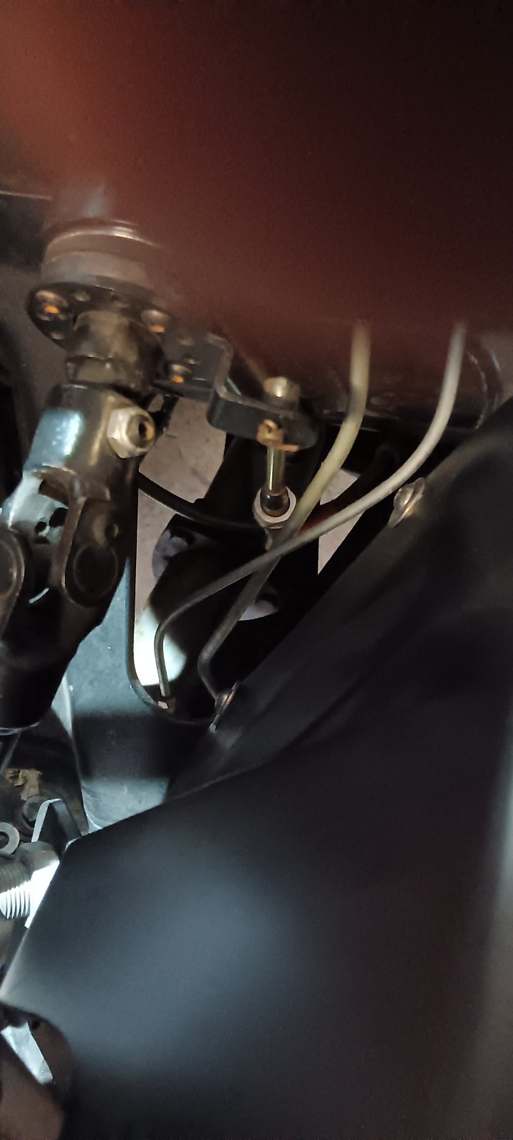

    i recently converted my 40 merc to automatic column shift using stock column& the lokar universal linkage, i made my own detent for park and driving gears to keep it from going out of driving gears and to keep it in park(not as nice as @chevyfordman though ! ) works real nice, but is there a way to rig up a neutral safety switch without reinventing the wheel ?

    Tough to take a pic of the slotted area for the homemade detent, and these close ups make it look crude, but it works , keeps it in park and keeps it in the foward gears and from going into park from reverse, I just notched the tab
