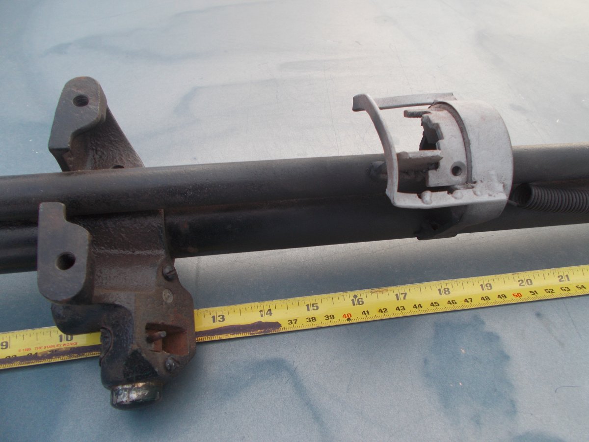

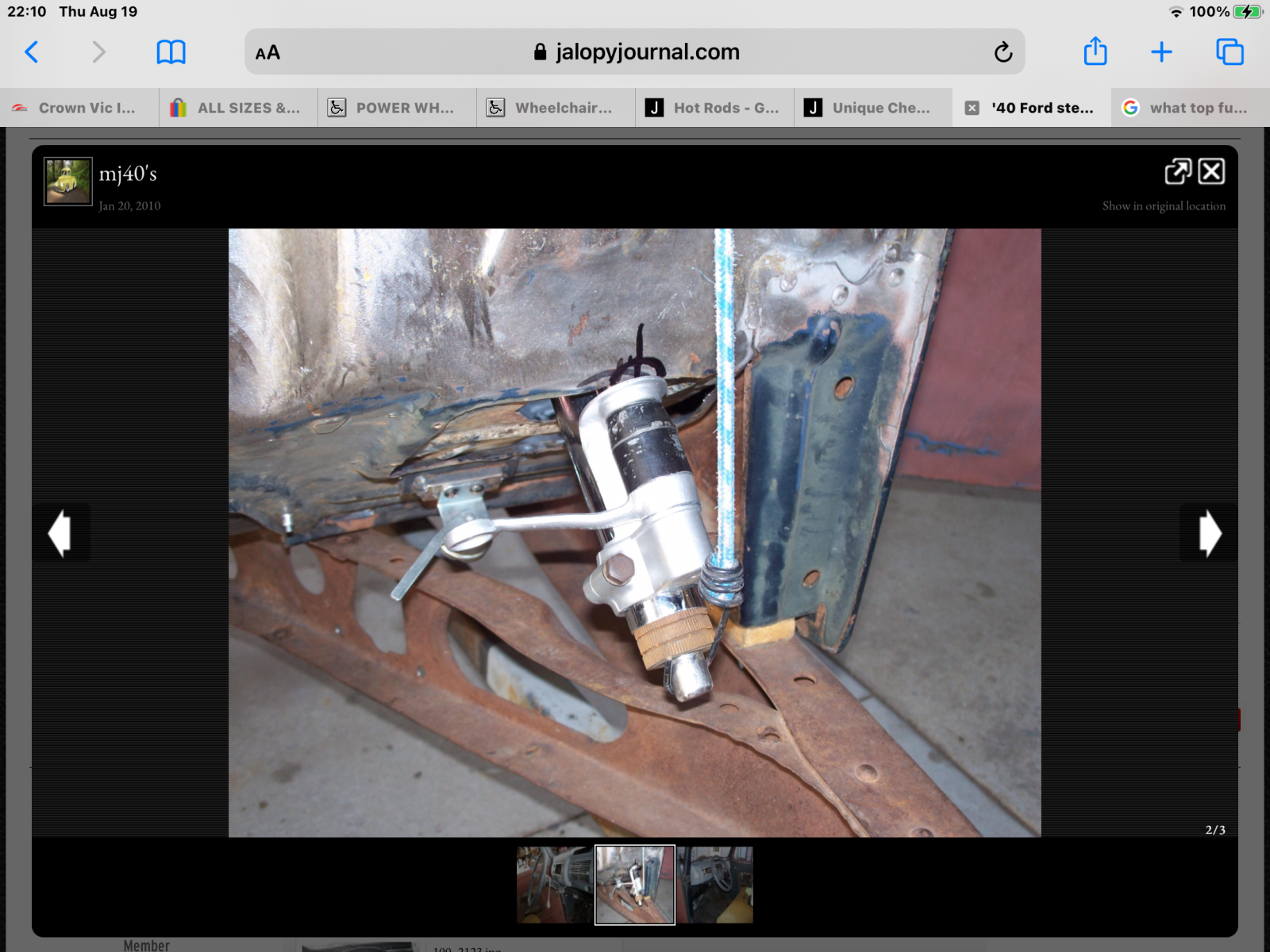

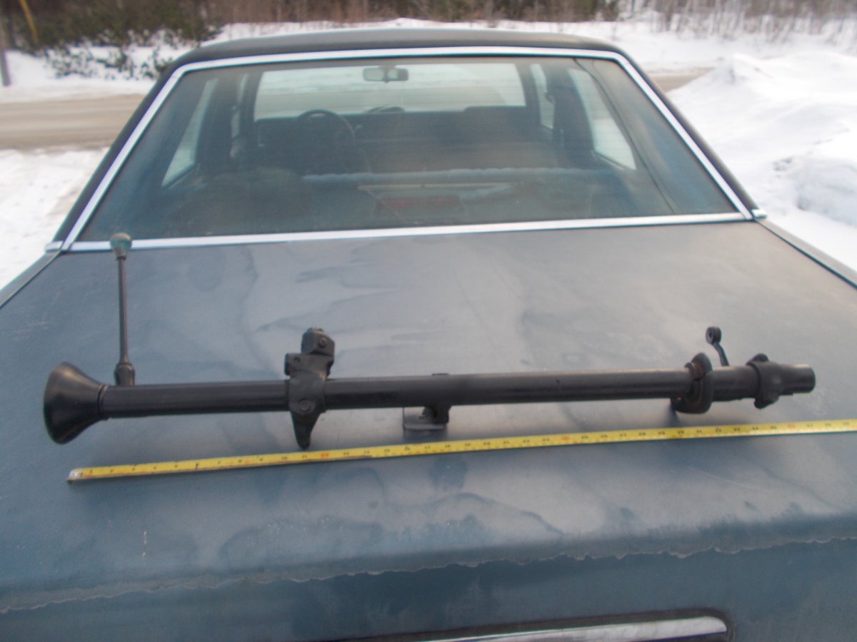

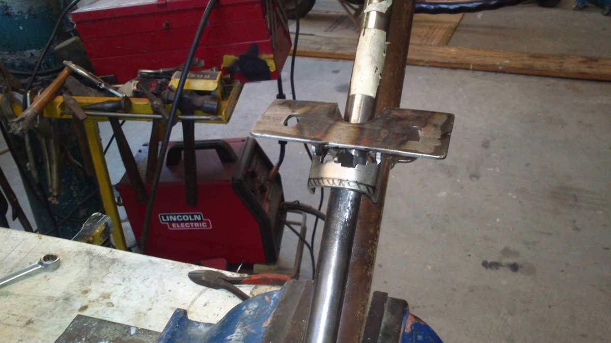

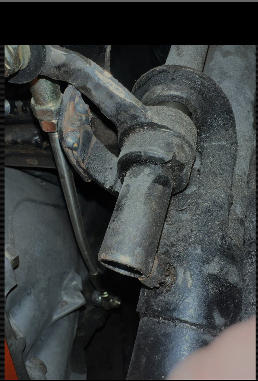

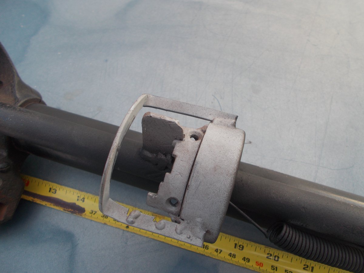

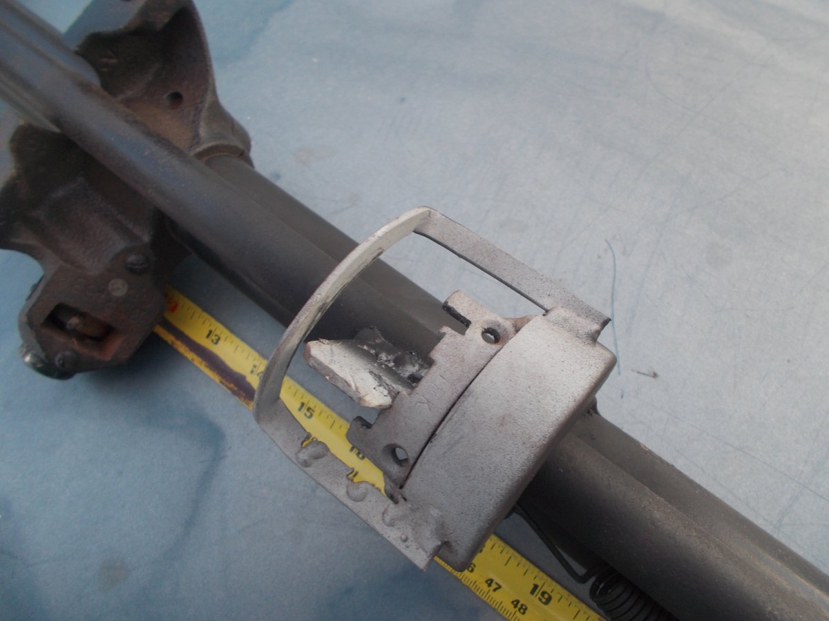

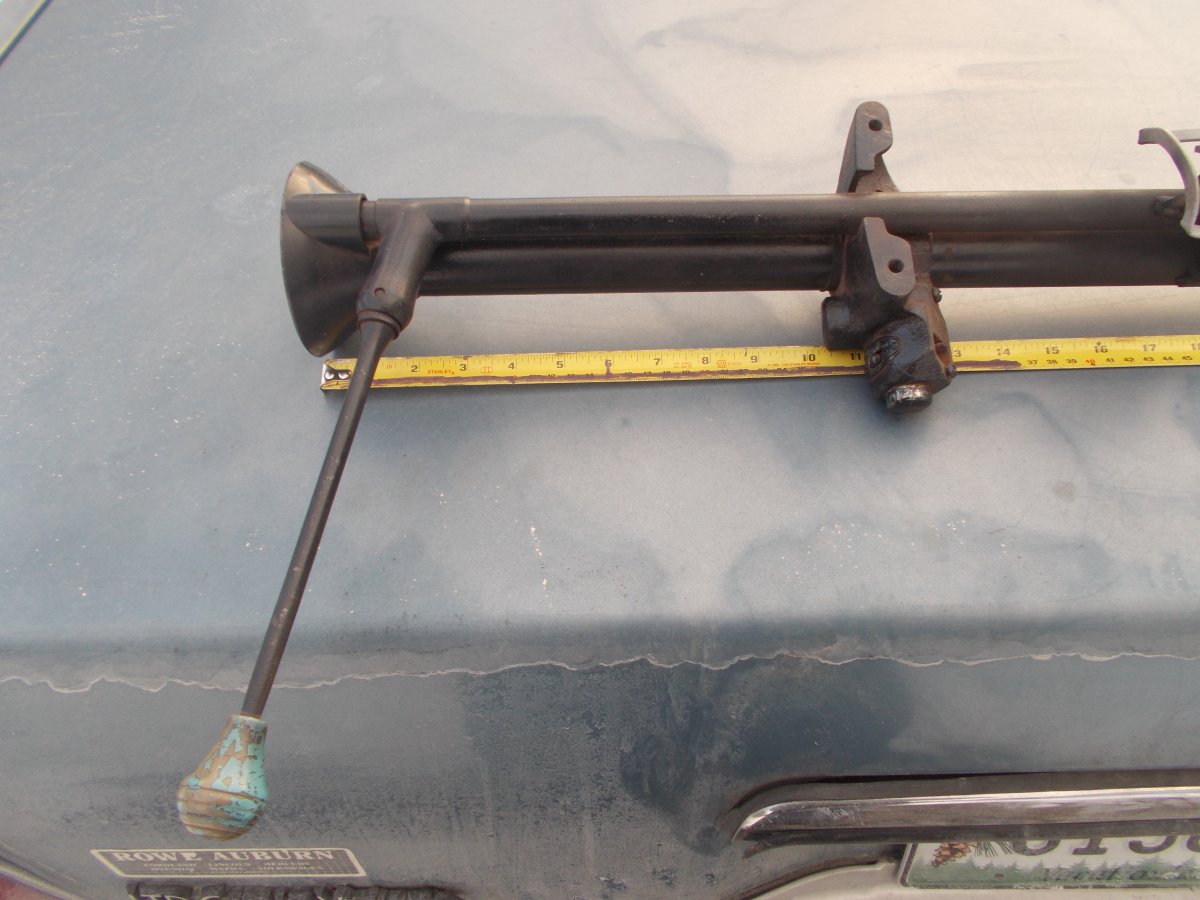

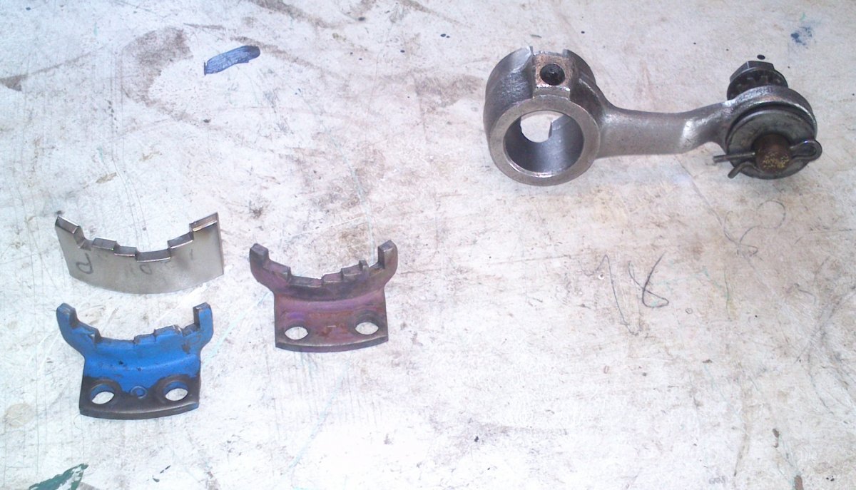

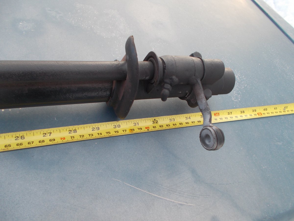

    Here are
    IMG_6246.png IMG_6247.png IMG_6248.png IMG_6249.jpeg IMG_6250.jpeg IMG_6251.jpeg IMG_6252.jpeg IMG_6253.jpeg IMG_6254.jpeg IMG_6255.jpeg IMG_6257.jpeg IMG_8881.jpeg IMG_8882.jpeg some more pictures I hope this helps. Frank
    PONTNAK123, ffr1222k and bama7 like this.
  3. Replacing the floor shifter with one that you like the look of better seems like the easy (easiest) answer to me.

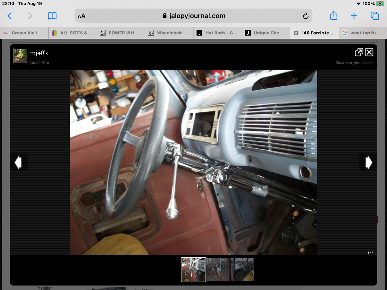

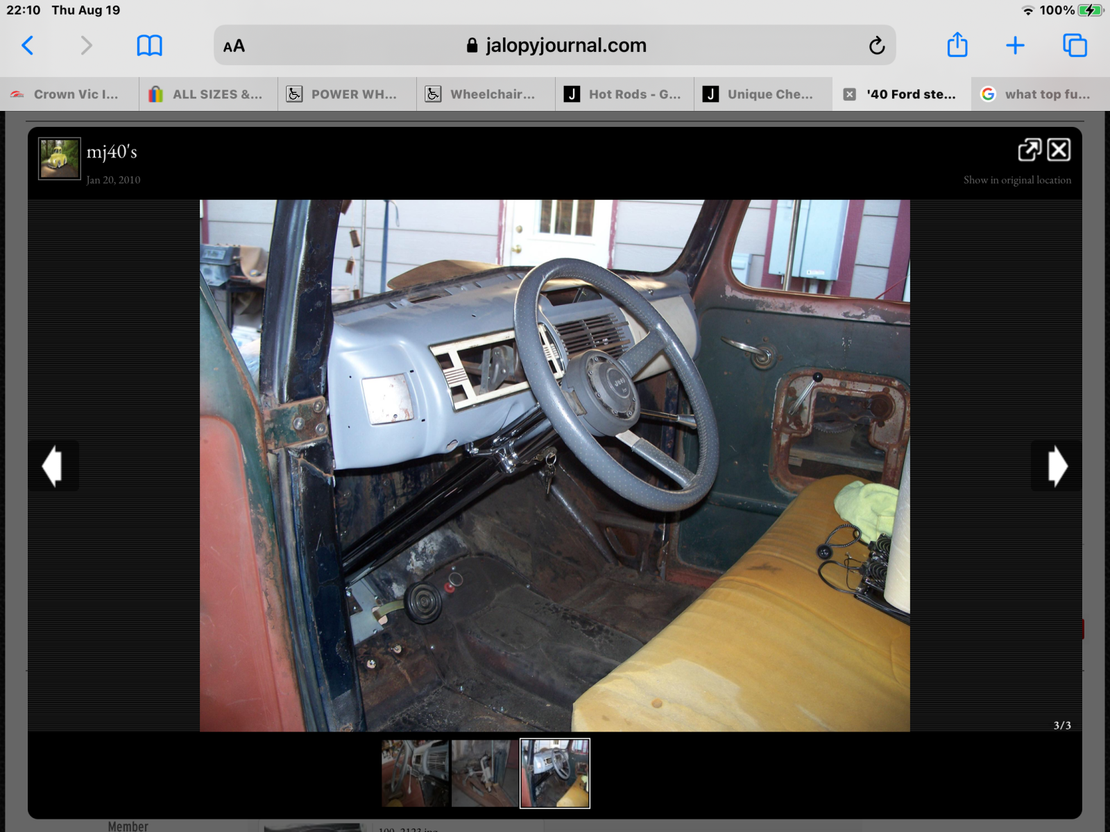

    The 40 one shown I did--did maybe 8-10 that way==work very well. NS switch is on trans.
    PONTNAK123 and bama7 like this.

  7. Years back I used the housing from a 1958 Ford Car. It has the 3 speed auto detents as well as turn signals. I believe the tube size was the same as the stock steering box at the bottom so it just clamped in place, no big issue. I may have shortened it just a bit. The shift pattern letters are in the dash but the pointer was easy enough to relocate. I reinstalled the 41 steering wheel. It has a nuteral start switch on the jacket also. I don't remember it being a big deal to do.
    Dak Rat and bama7 like this.

    I purchased the Lime Works shifter kit and it looked very nice. But it just is too finicky for me. I 20240709_123555.jpg 20240713_124357.jpg could not get it to work as it should. I did use a couple of their parts to use my original shift mechanism. I used the Shift Arm on my Shift tube, the Shift Lever for the transmission, and their Linkage. All I had to do was drill the Shift Arm, very tough metal, and also drill into the original shift tube and install a self-tapping screw. It works great without any slippage. I also had to use an S10 seat until I get what I need for the original seat. The FMX transmission I had was not working correctly so I had a C4 installed. Works as it should.
