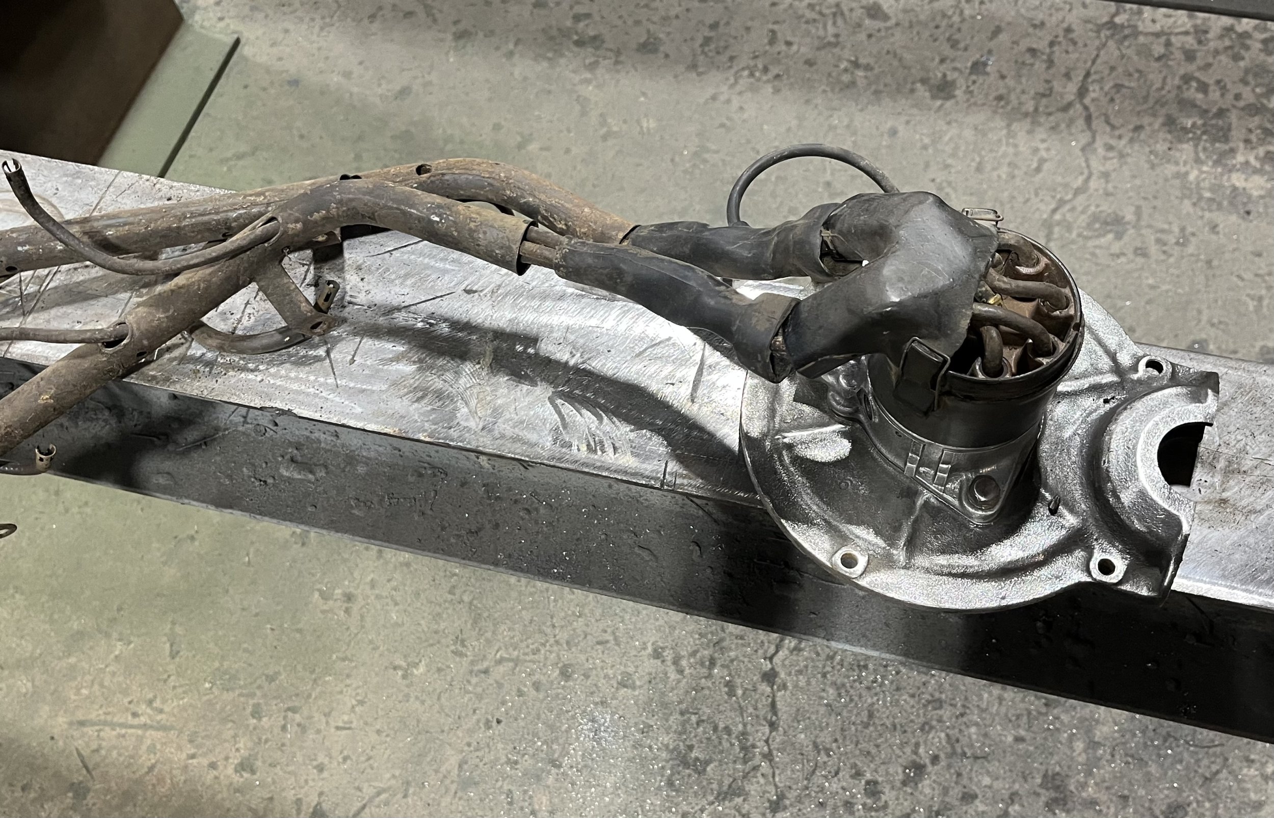

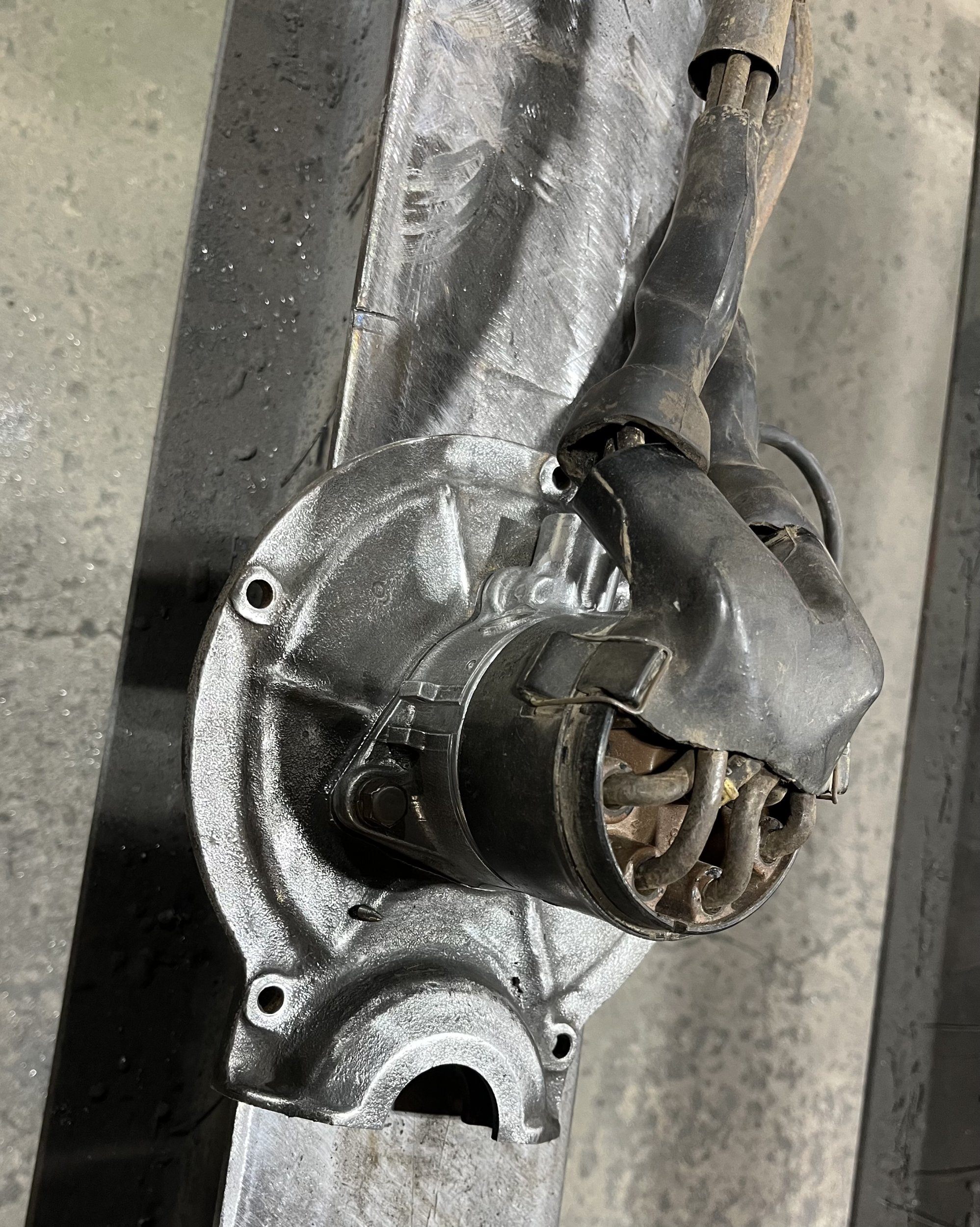

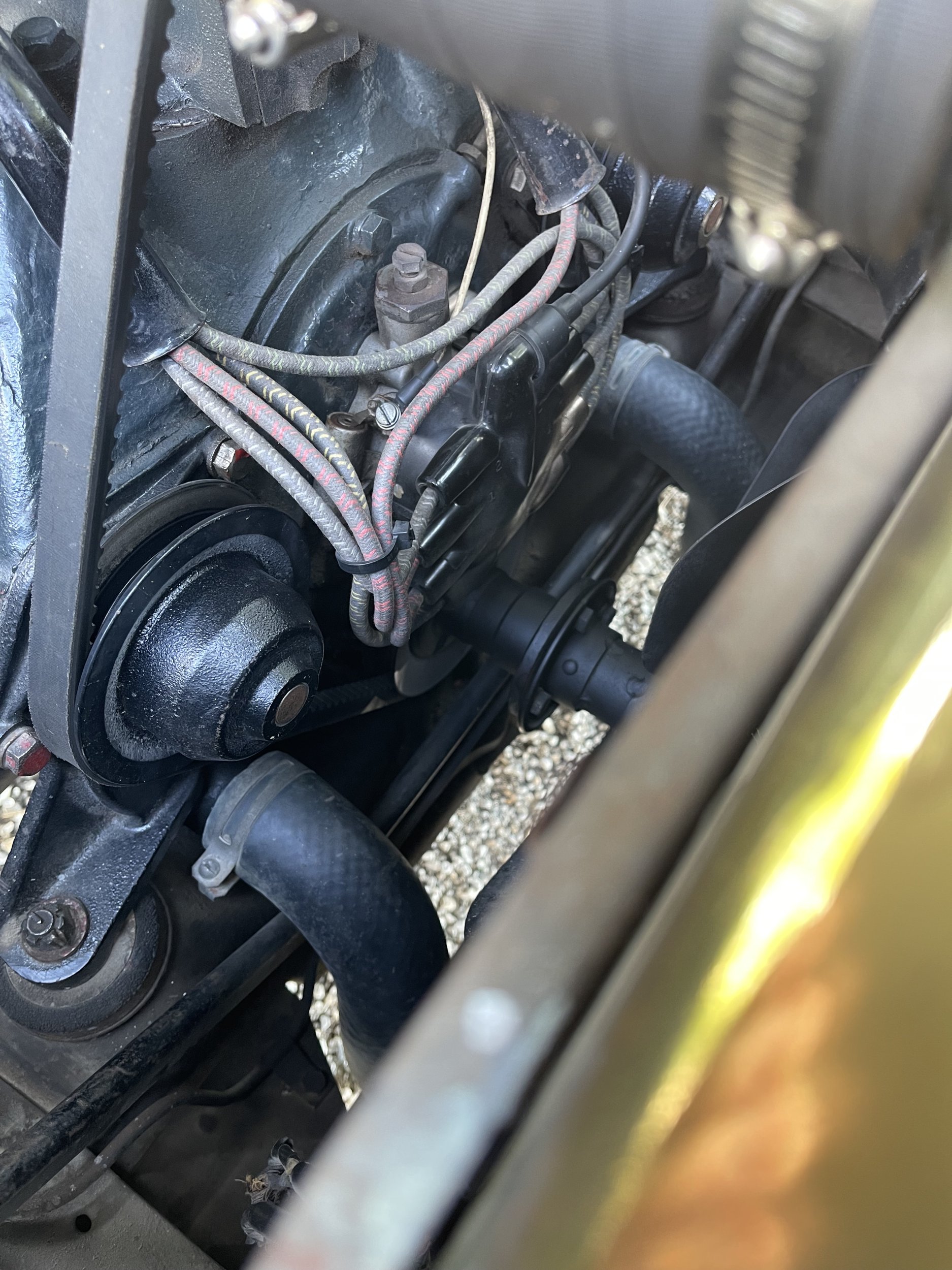

    2C5675E6-596D-4FC4-95AF-0E0BE88C1FA1.jpeg EE3ED394-5052-466E-AA38-3A64FB18A3F1.jpeg 59A95A92-FD71-4B36-BC30-A539E38500FA.jpeg I think I would just need the small straps, cap and rotor to convert?
