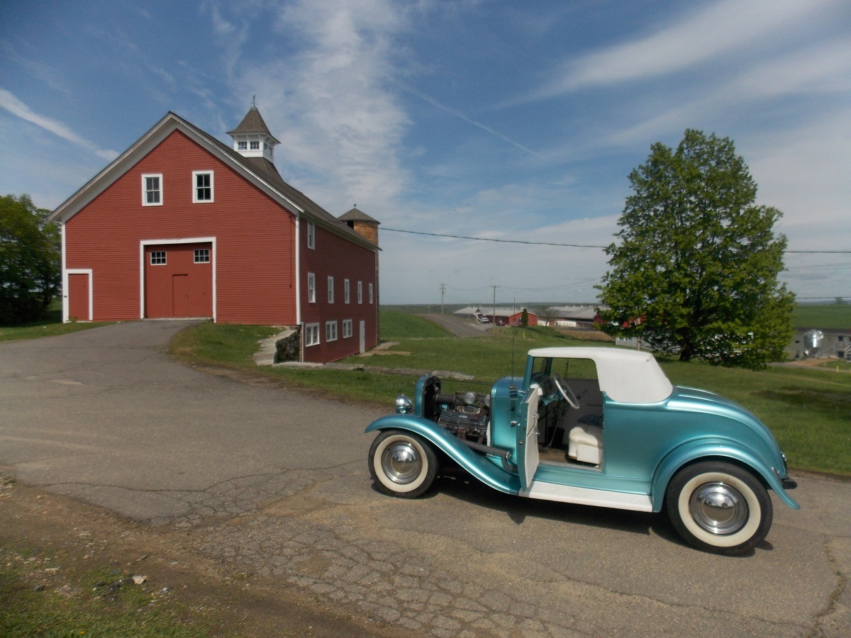

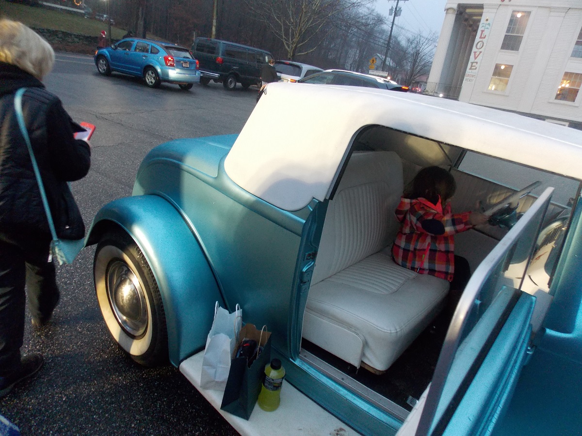

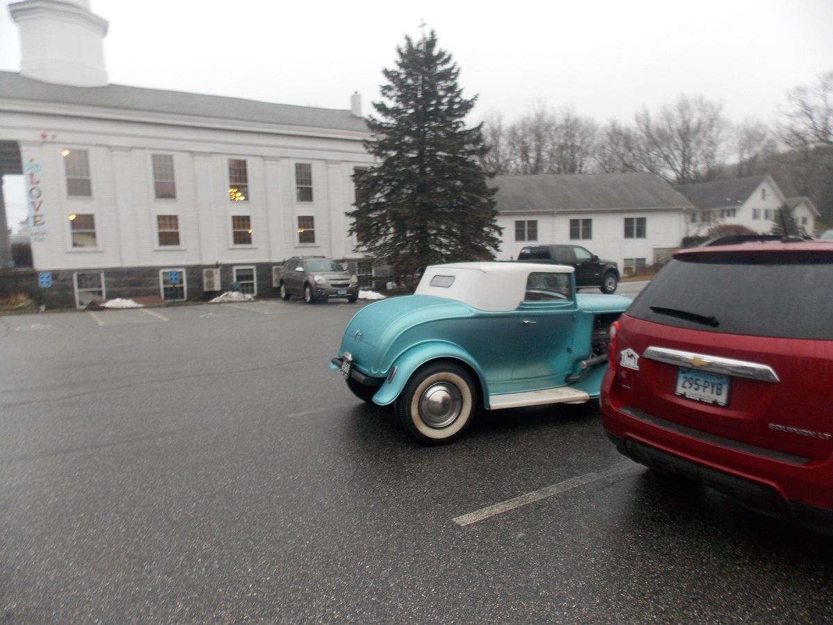

    When I built my steel top (for my 32 Ford that was a coupe missing it's roof,) a lot of thought went into not only the styling "look", but you must always be thinking of how the material can/can't stretch. when building a roof.
    ...I did own a 32 Plymouth cabriolet years ago that I installed a Haartz pre-sewn top cover on it, so I recalled how & where the 4 fabric panels were joined.
    I don't have a good pic right now of how the side panels wrap around towards the rear, but they do come around and go to the small rectangular fabric piece around the back window.
    ^^^ this pic gives the basic shape of the driver side panel as it runs with the square tubing^^^
    Then I used a Hidem strip at the rear "bow" so I could do a relief cut up at the top, so it could wrap around the rear of the roof.
    Yes, pics would help, as there are some trimmers here that can give some input on what you built/
    By the way, I did a solid roof for the exact reasons you said, and mine is very quiet. The smooth header above the windshield might be part of why it is quiet.

    Thanks for the pics and info. That is a very nice job that you did.
    My problem is the area between the last two side bowes on your top - where the material of the side panel at the very top bends around to meet the flat top. Half way between your last two bowes is where my top starts to taper back to the rear bow. As a result there is an excess of material at the very top in this area. No excess on the sides, just the very top next to the flat section that lays across the top. As I have mentioned I can put in a 3 inch "dart" to remove the excess or ??????. I don't know. I really don't want to do the dart if there is some way around not doing it.
