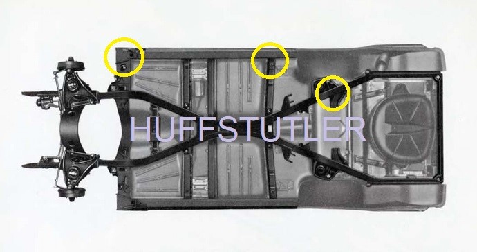

    Does anyone have a picture of where the extra frame to body mounts are on a convertibles?

    @4EyedTurd Which make and year of car?

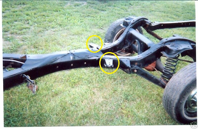

    @oldtom69 It was a challenge to put a roll bar in but it is the body of the car being protected. The attachment points were where the sill had been reinforced at the door post and cowl attachment. In the rear, was at the kickup rail in the trunk area. Here is a diagram I put together circling where the attachments were for the cage with the 1958 Chevy.

    64 Chevy

    @4EyedTurd This is of a 1959 but the mounting bracket is the same. Extra ones at the end of the tunnel for the convertible. You can also see the welded on plating on the top side of the rails and tunnel for the convertible (is the same on the bottom of the rails.
