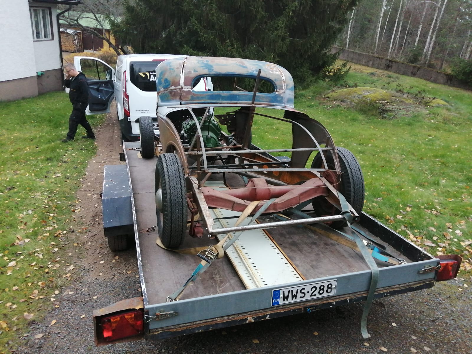

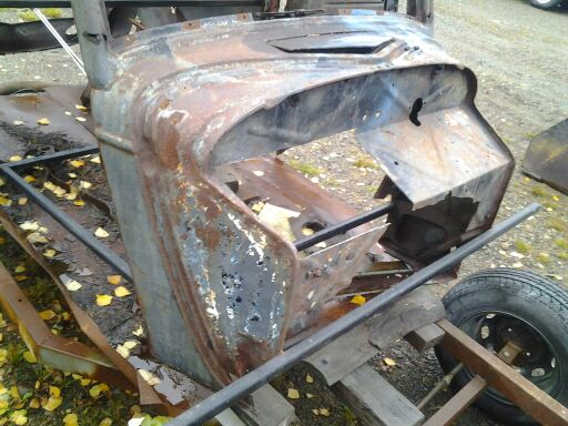

    I got a phone call from my friend Tommi. He told me that he got '34 Sedan roof and rear doors laying around. "It is cheap, he says".
    I asked will it fit in my Volkswagen Transporter Van? Sure, said Tommi!
    Well, it didn't fit, so the roof was cut up in smaller pieces at Tommis yard.

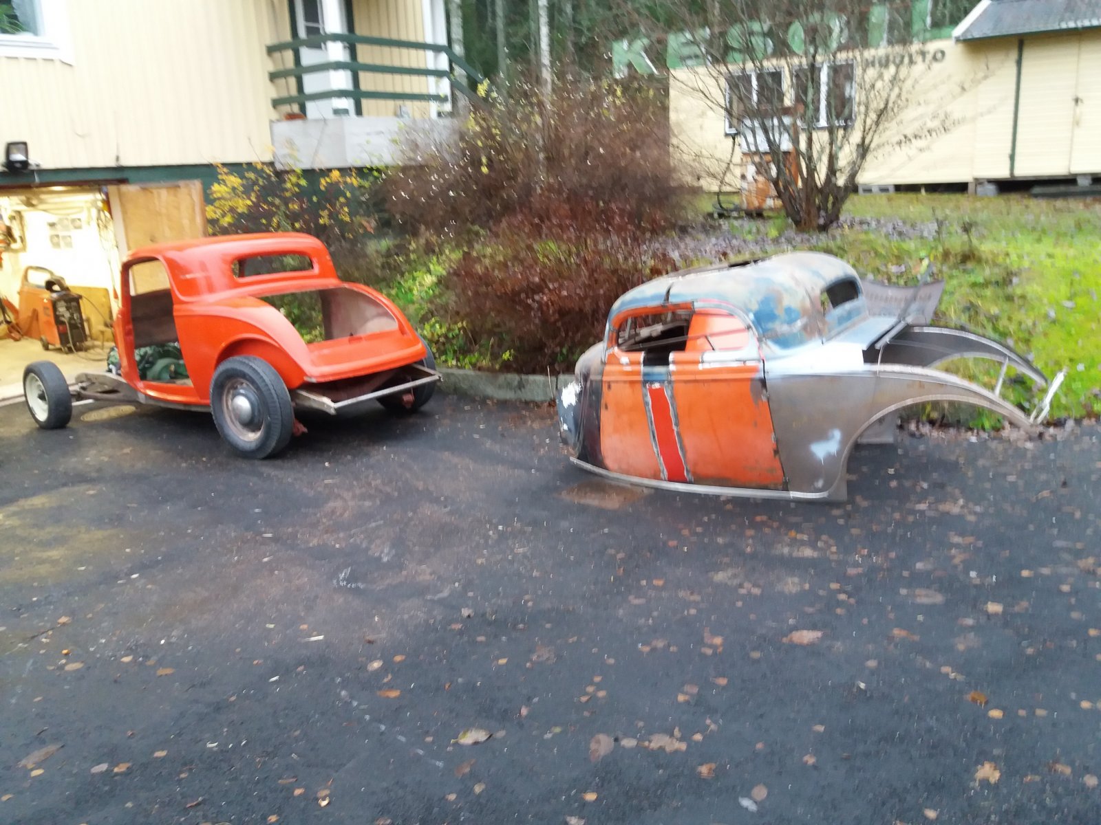

    I stored the roof in my backyard several years. I was still working with my A-Coupe, so no time and money to build two cars.

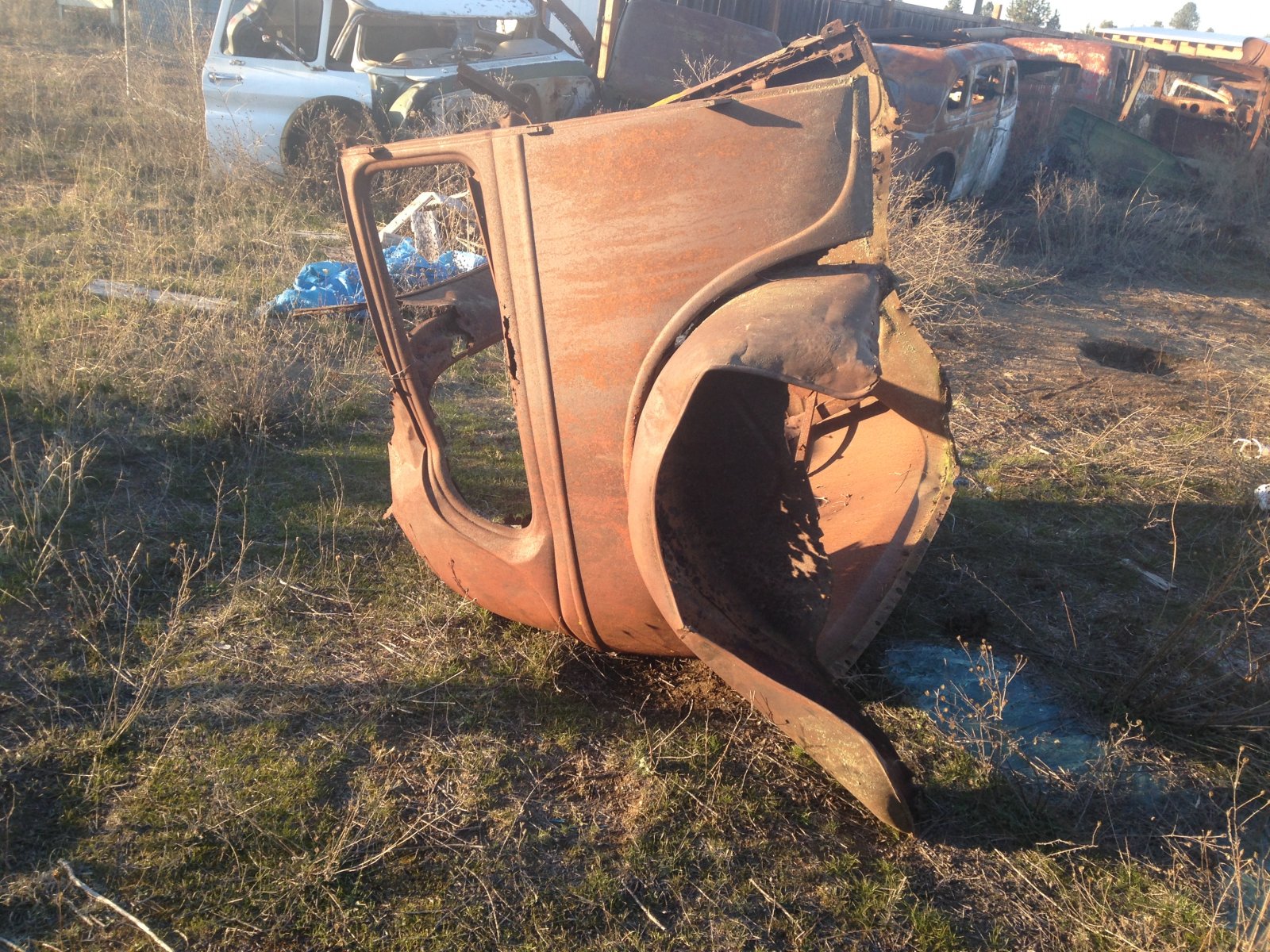

    I found ’33-34 Coupe rear quarters that were made in Sweden at Lazzes sheet metal course
    They were cheap and I bought them. Pieces rested at by backyard until 2014, when I moved to another town, Karkkila, Finland. Situation did not change much at all. Now the parts were lying in the backyard at Karkkila.

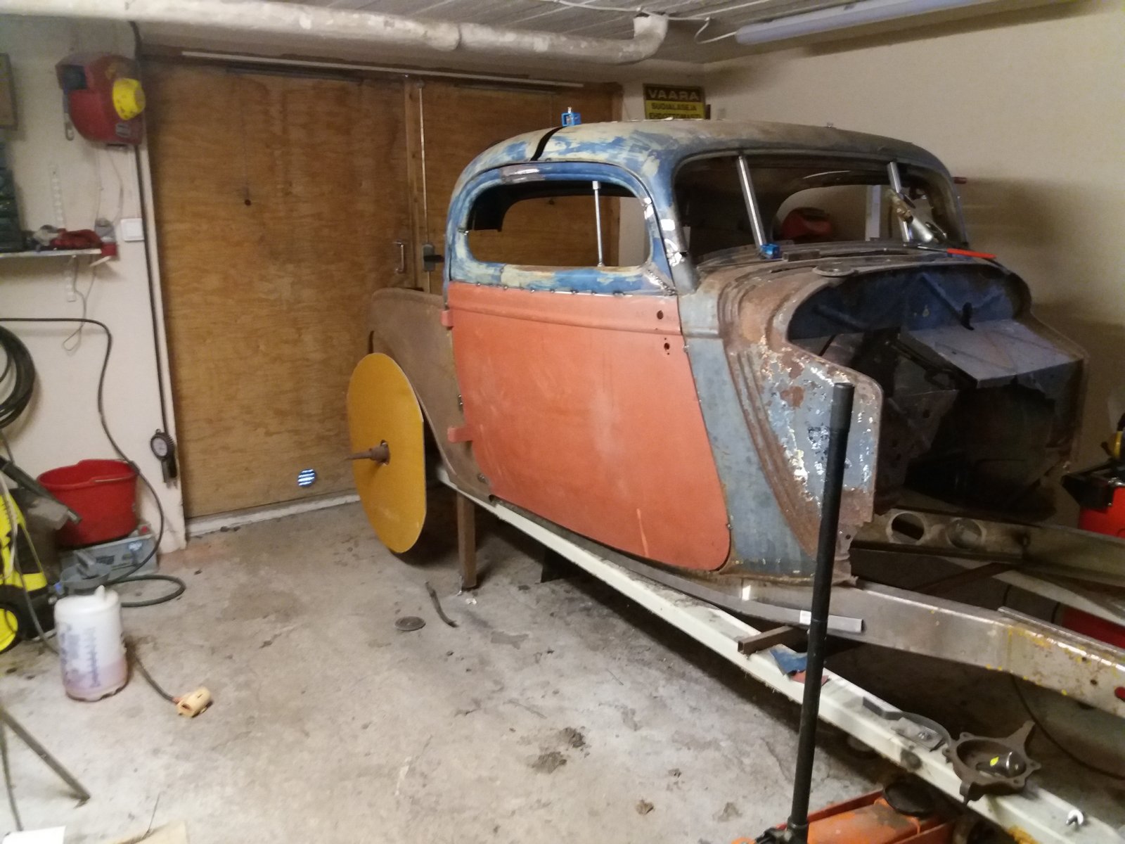

    In the summer 2017, the basket case was already piled up so much, that I wanted to have the car outside to see what it looks like. I couldn't get a car out with plywood wheels, so I put "search on" for rear brake drums. Then I found complete banjo axle. Same guy was selling a running 21-bolt flathead and three-speed trans. Of course I bought them too!

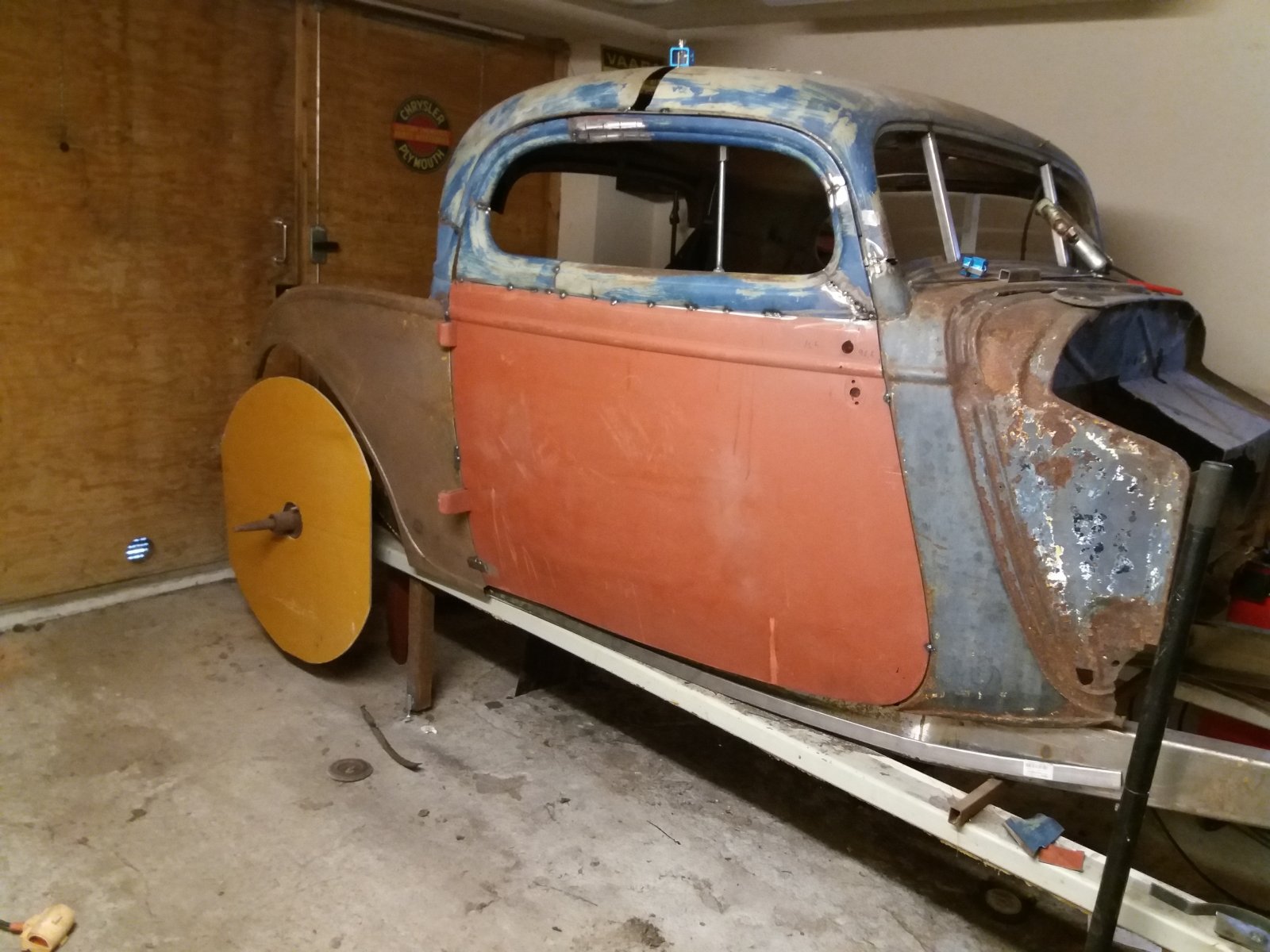

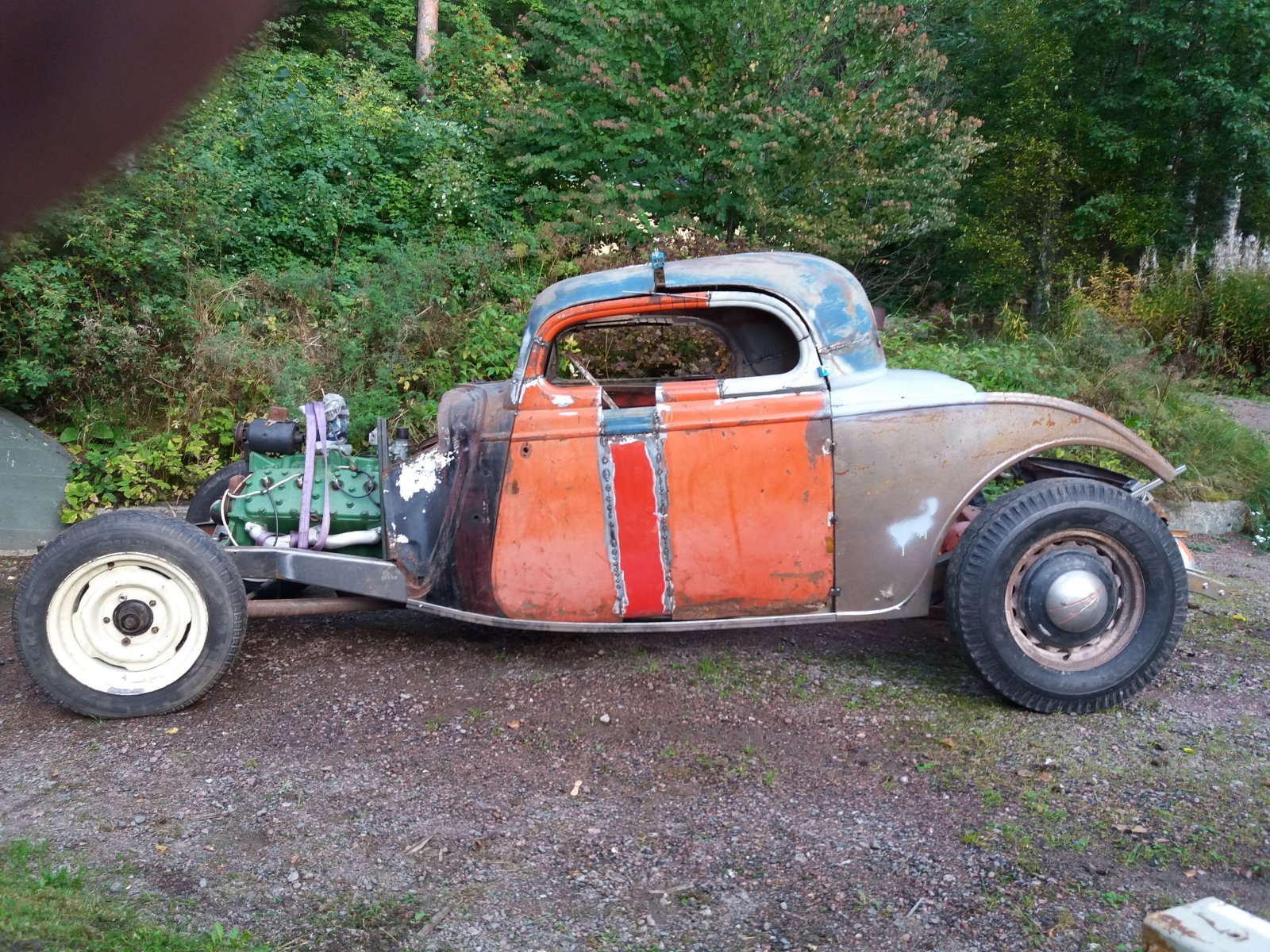

    I install the rear axle in place and I screwed the wheels. There was already some kind of axle in the front end and wheels in place, so basically the car was rolling.
    It was a little challenging to get the car from the jig alone Somehow it worked out and on September 12, 2017 was the great day!! I rolled the car out from my one car garage! It was very interesting to see what it really looks seen from a little further away.
    It was a totally shit! Awful, Ugly! What ever you want to name it!

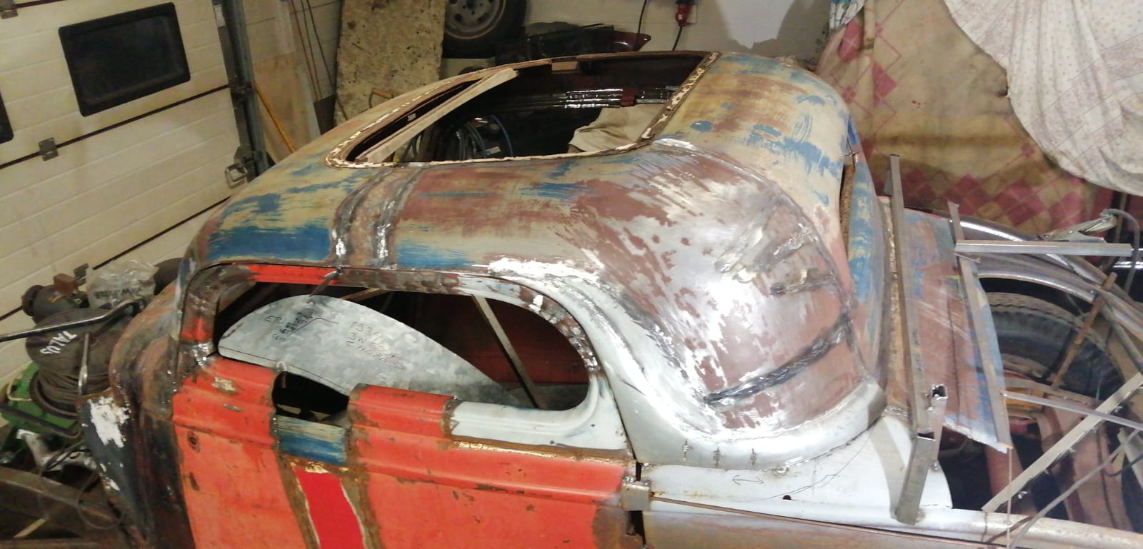

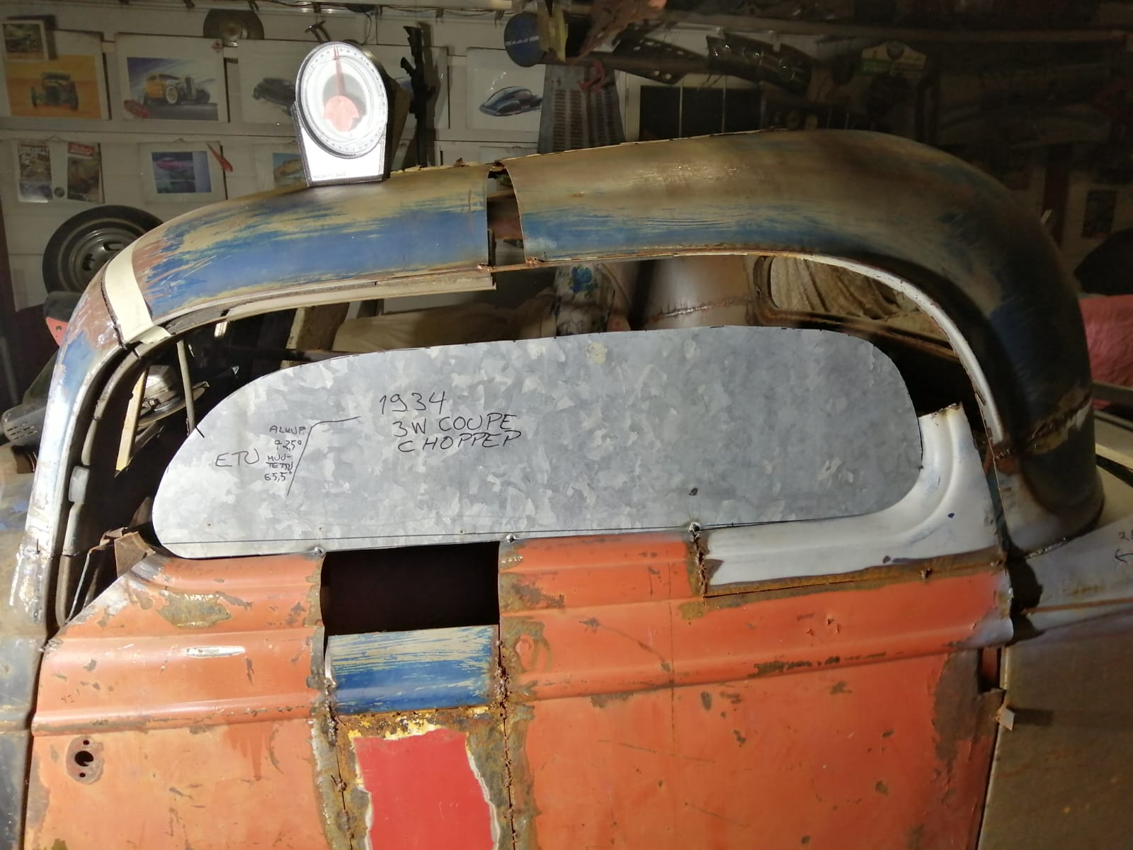

    The A-pillar is way too upright and the rear part of the roof is also too vertical. Somehow the proportions just didn't match at all!
    Reality hit straight to my face and I pushed the pile back into the garage!.

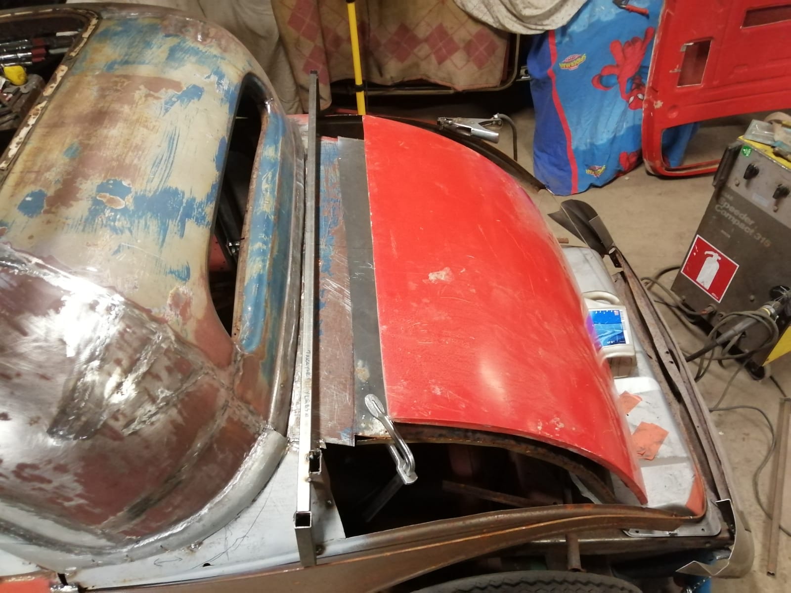

    In the fall of 2018, I tried to shape Sedan door upper sills to follow new roof curvature. I tried, I cut, I did everything that I can, but the steel doesn’t bend like I wanted! Painful!

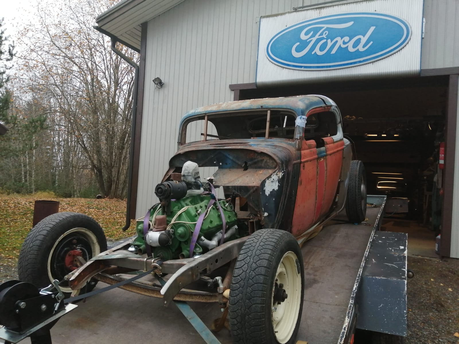

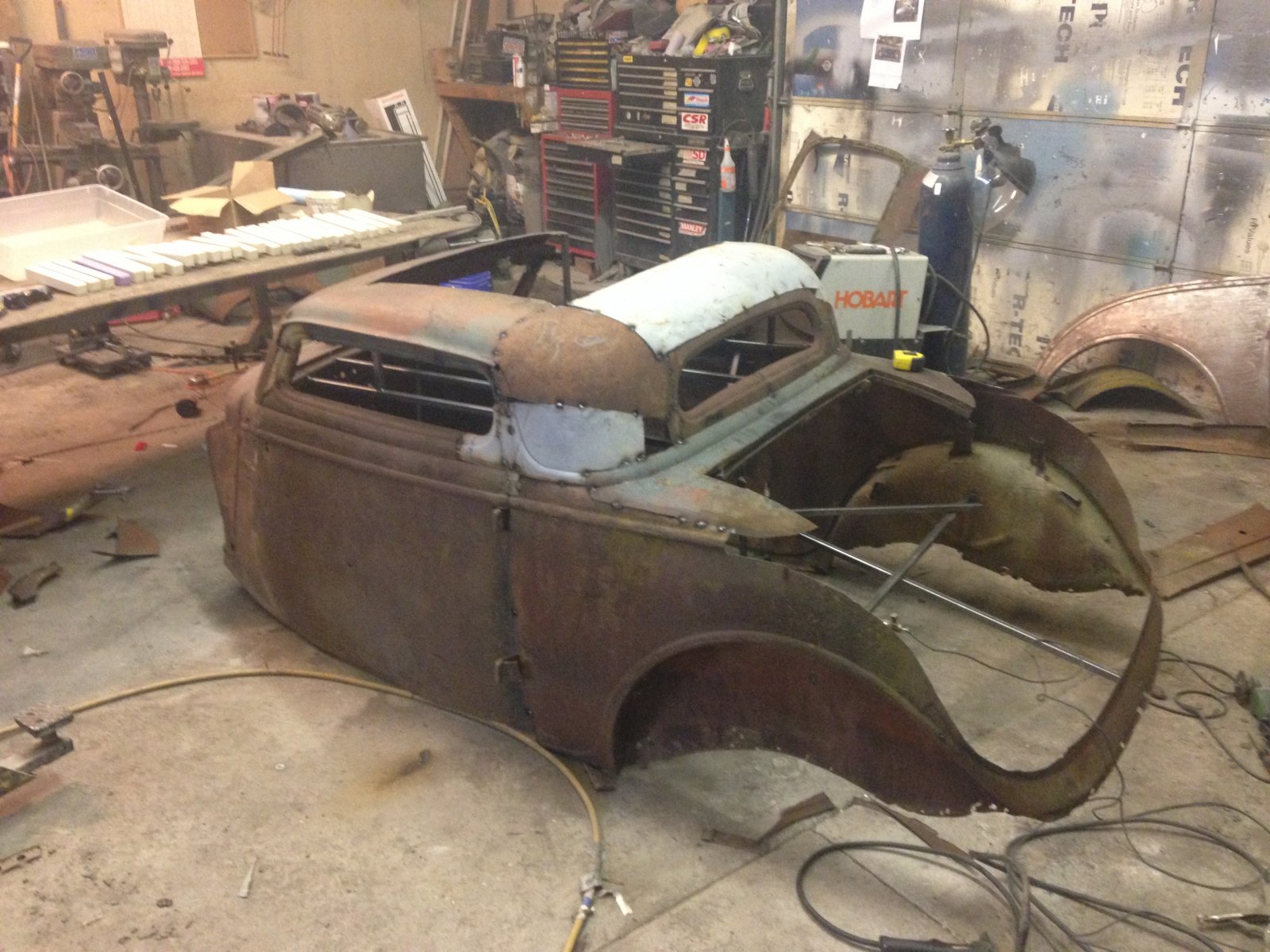

    I decided to go with option number three and have a help for person who all ready have all the tools and experience to use them. I contacted one guy who promised to take my project in the winter of 2019. That date moved and moved month after month… It felt like I couldn't get a car never under work.

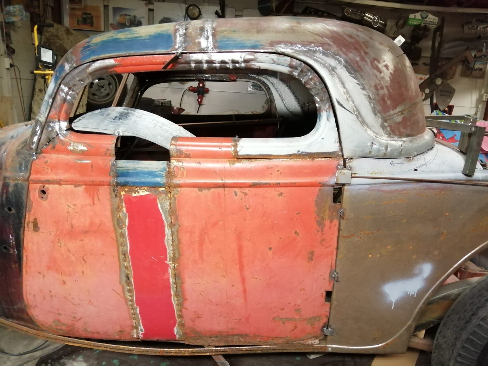

    In the fall of 2019, I talked to my good friend and Ari Talus about my case. Ari happened to have too much free time, and he was very interested to start project like that! So, I towed the pile to Ari in Lieto, Finland in end of the November 2019
    c3e44a48-d3e7-4234-ad58-a8ccb91d5b8a.jpg 93ee4d7c-2127-4e63-a56e-7605a99dbbcd.jpg
    Ari got down to business right away and at the same week my whatsapp started to pop up project photos. Things started to progress in excellent speed!
    2d314bbb-b618-4a92-a9a1-58de9b7bab23.jpg 935ea715-62cb-46dd-a62c-a2350df86237.jpg 5aadd529-5d9c-43d7-bf1d-35efa613e72f.jpg 08dae773-9dbc-49d3-8dda-afa03fb33e78.jpg 3b92c926-3fcc-4529-a704-06486b7fa22a.jpg e5068388-83e3-4e06-afce-7db3d6bf2b06.jpg

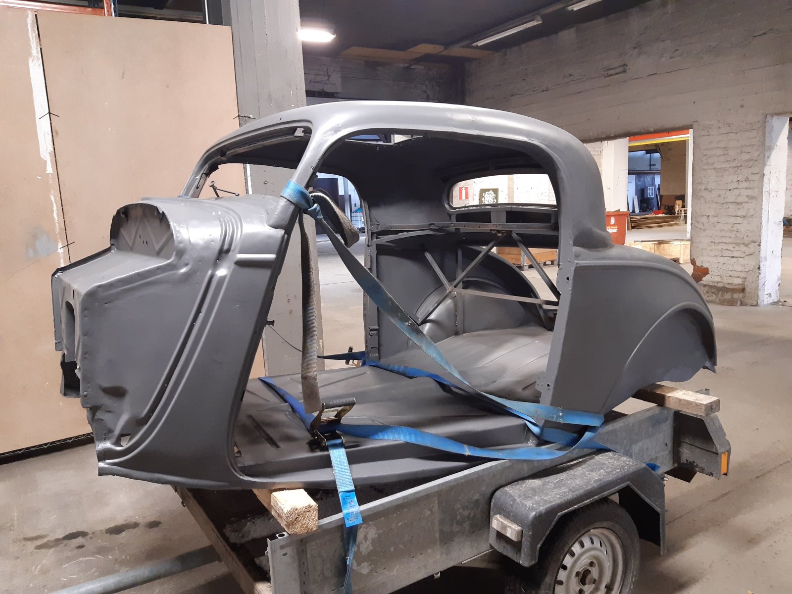

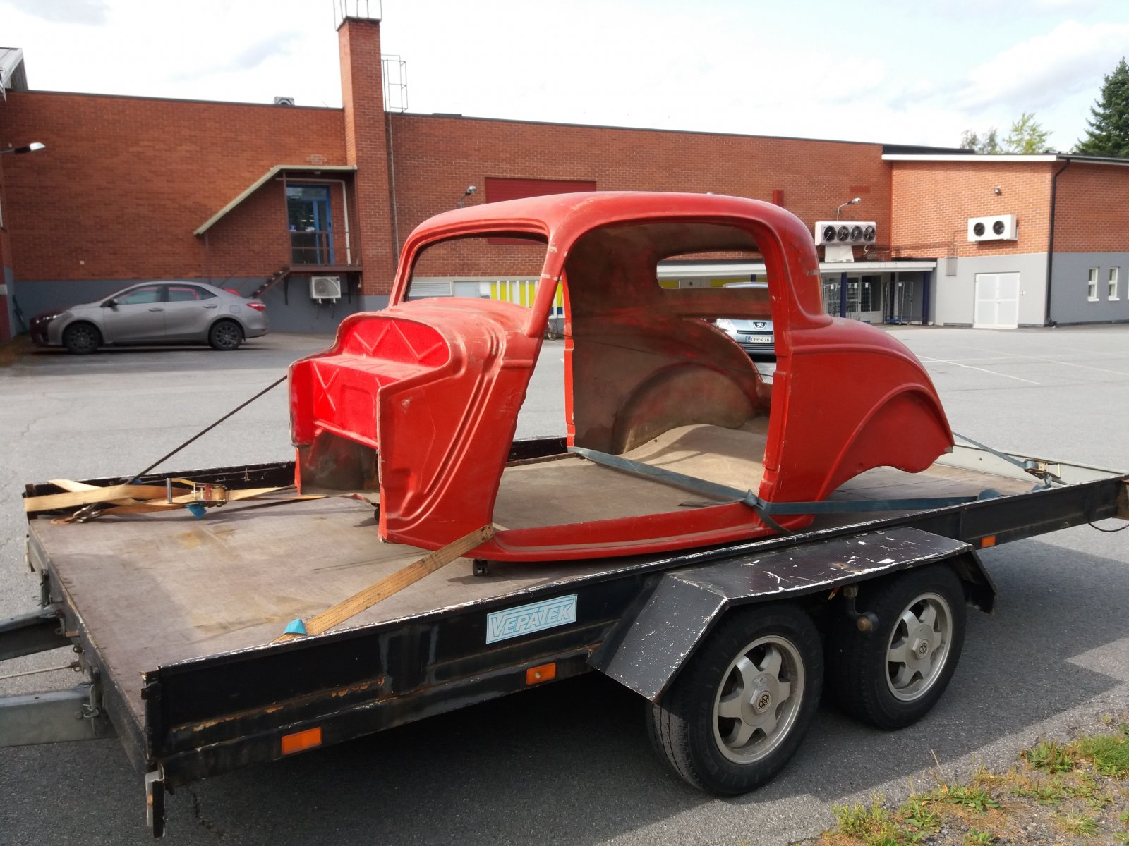

    I delivered a fiberglass body to Ari and it was great to notice, that rough-looking pile is starting to like a complete car!

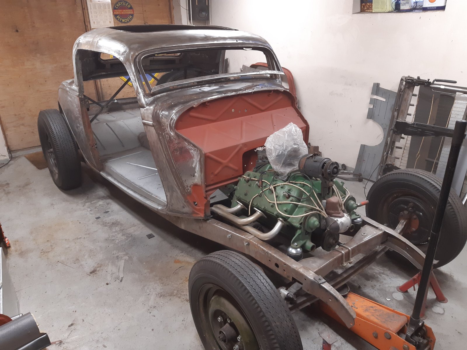

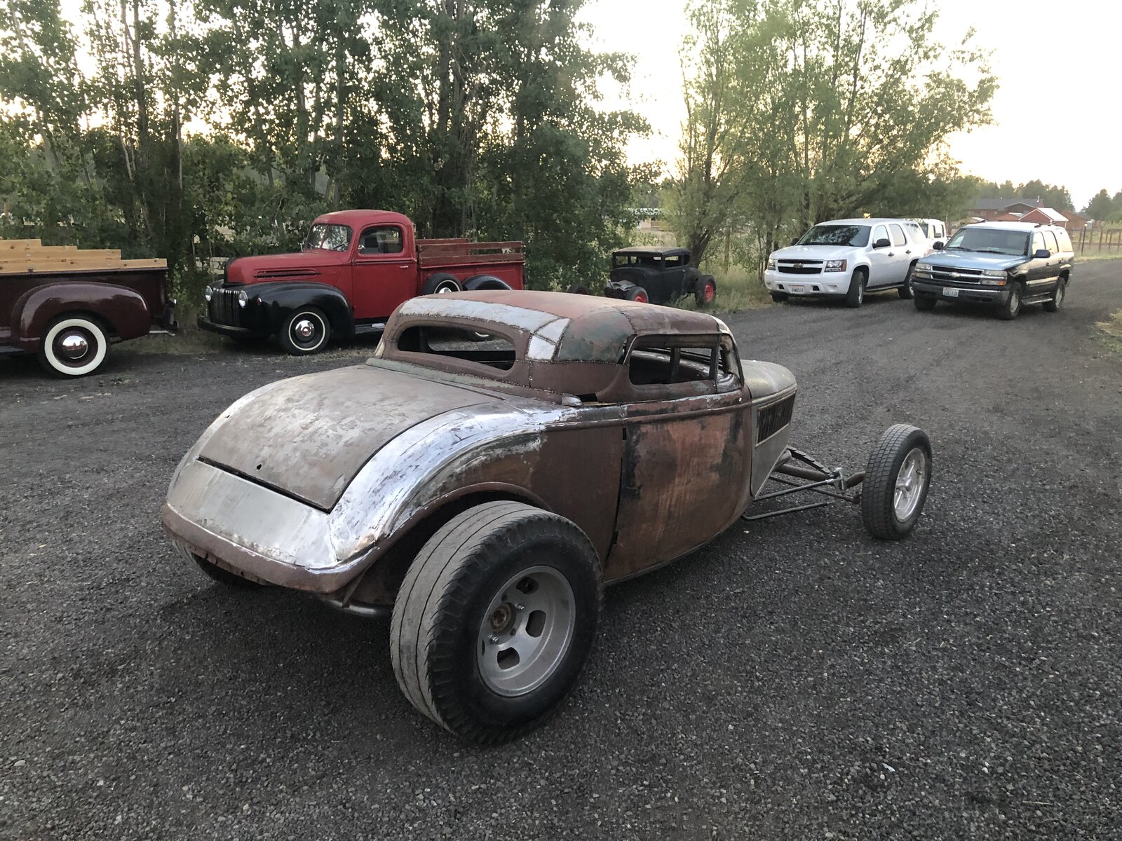

    On January 20, 2020, I get the car back home from Ari.I was impressed when I saw the car first time outside in one piece. It was absolutely great. Chopping, shape of the rear roof, the tilt of the A-pilars…everything caught my eye very nicely! Absolutely great work and craftmanship!

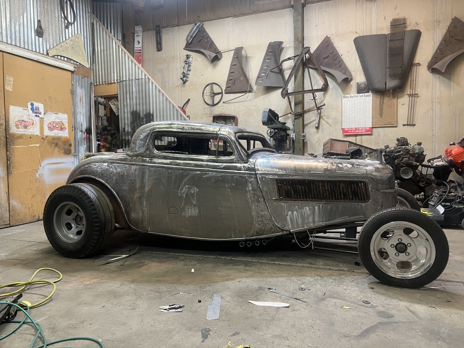

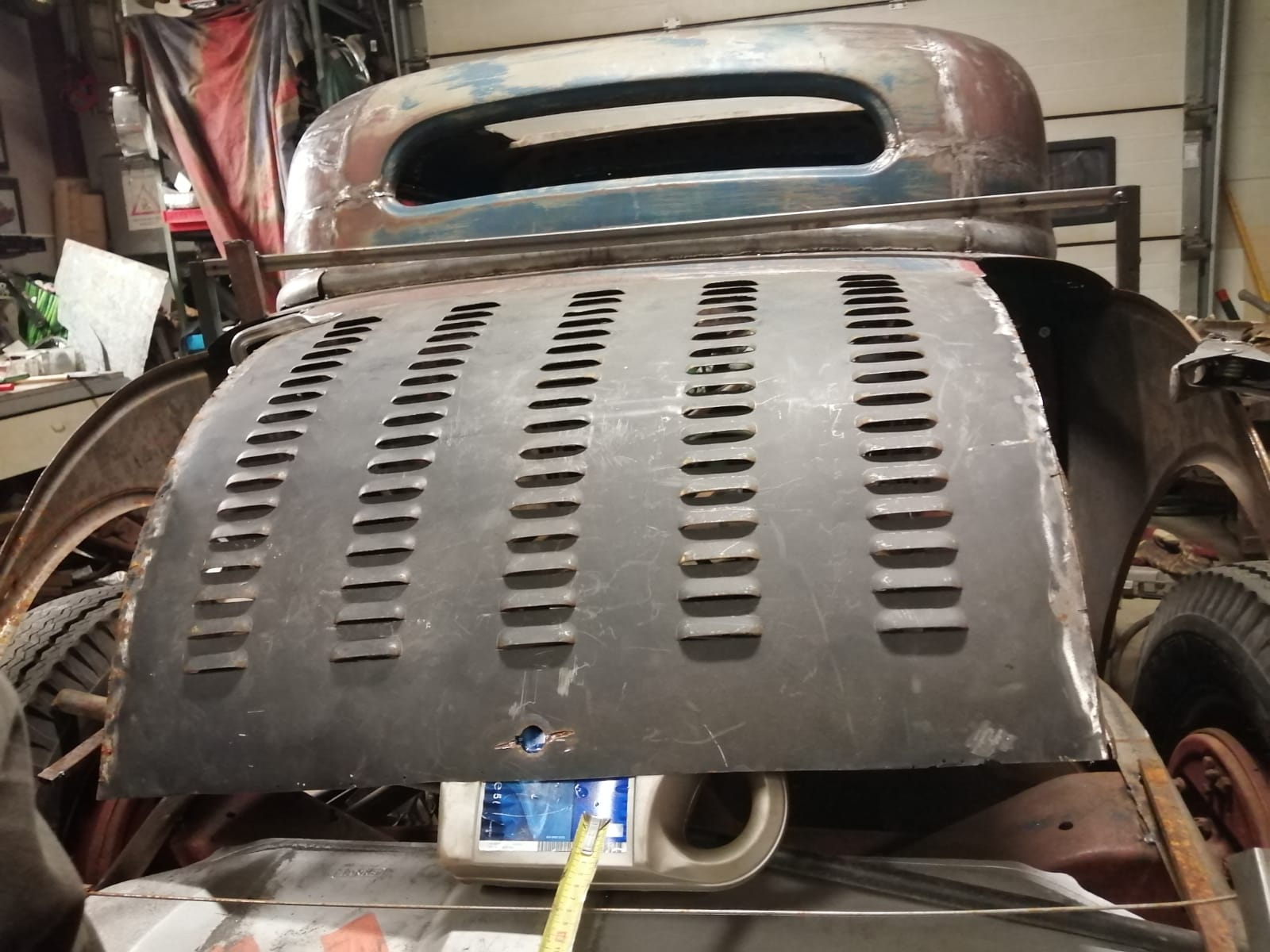

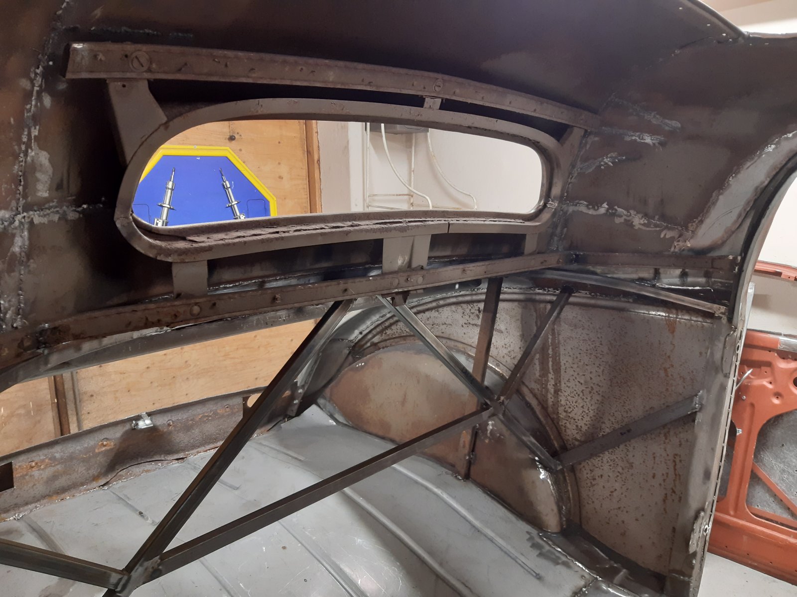

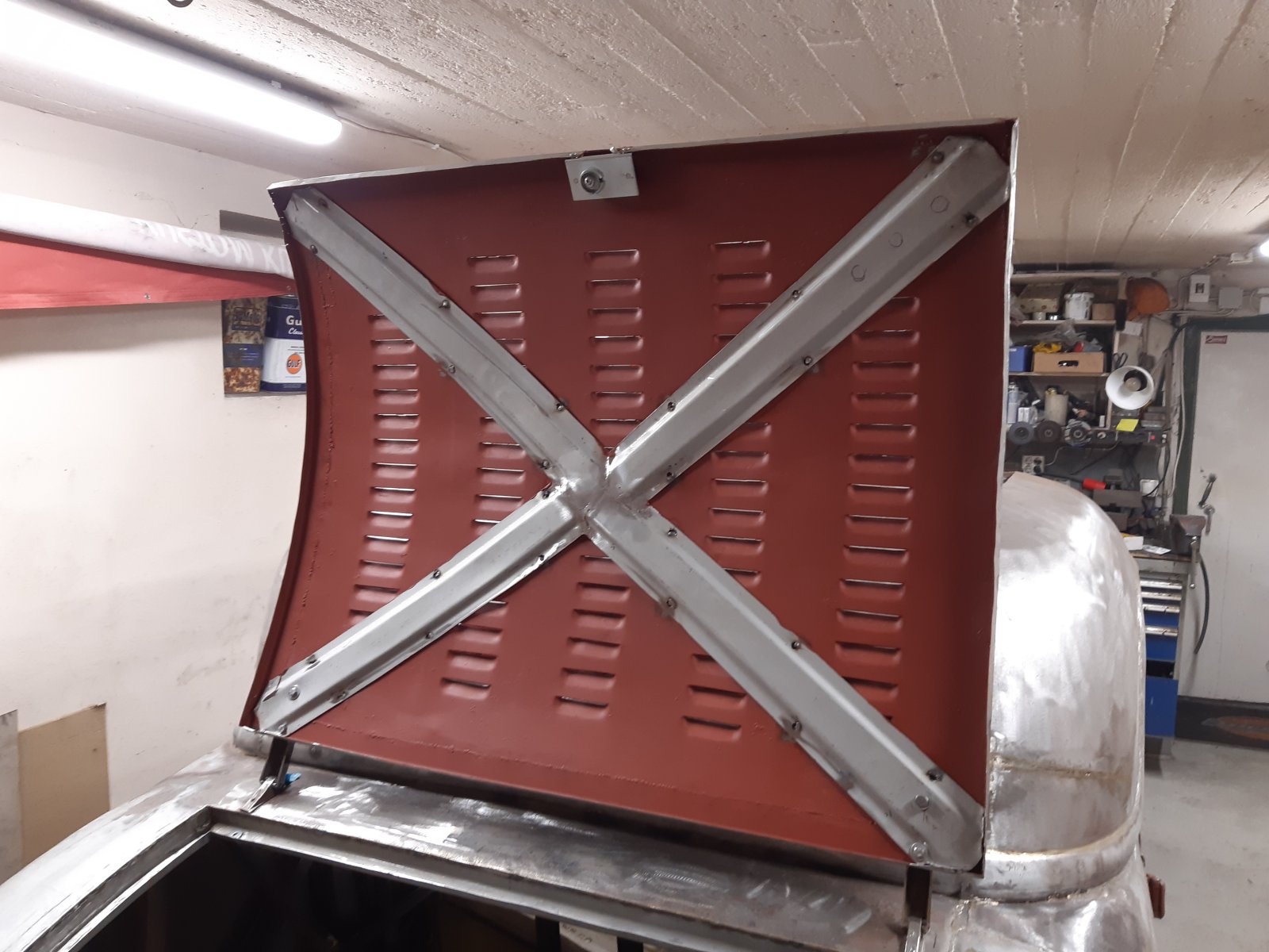

    Metalman Ari had done excellent job, but, there was still a lot of welding and grinding to do. I have to replace firewall, weld Bear Claw locks, chop the windshield frame, adjust the gaps in the doors, repair a few
    rust holes, replace all wooden body supports and made new structure from square tubing, etc… in total for a year of that.

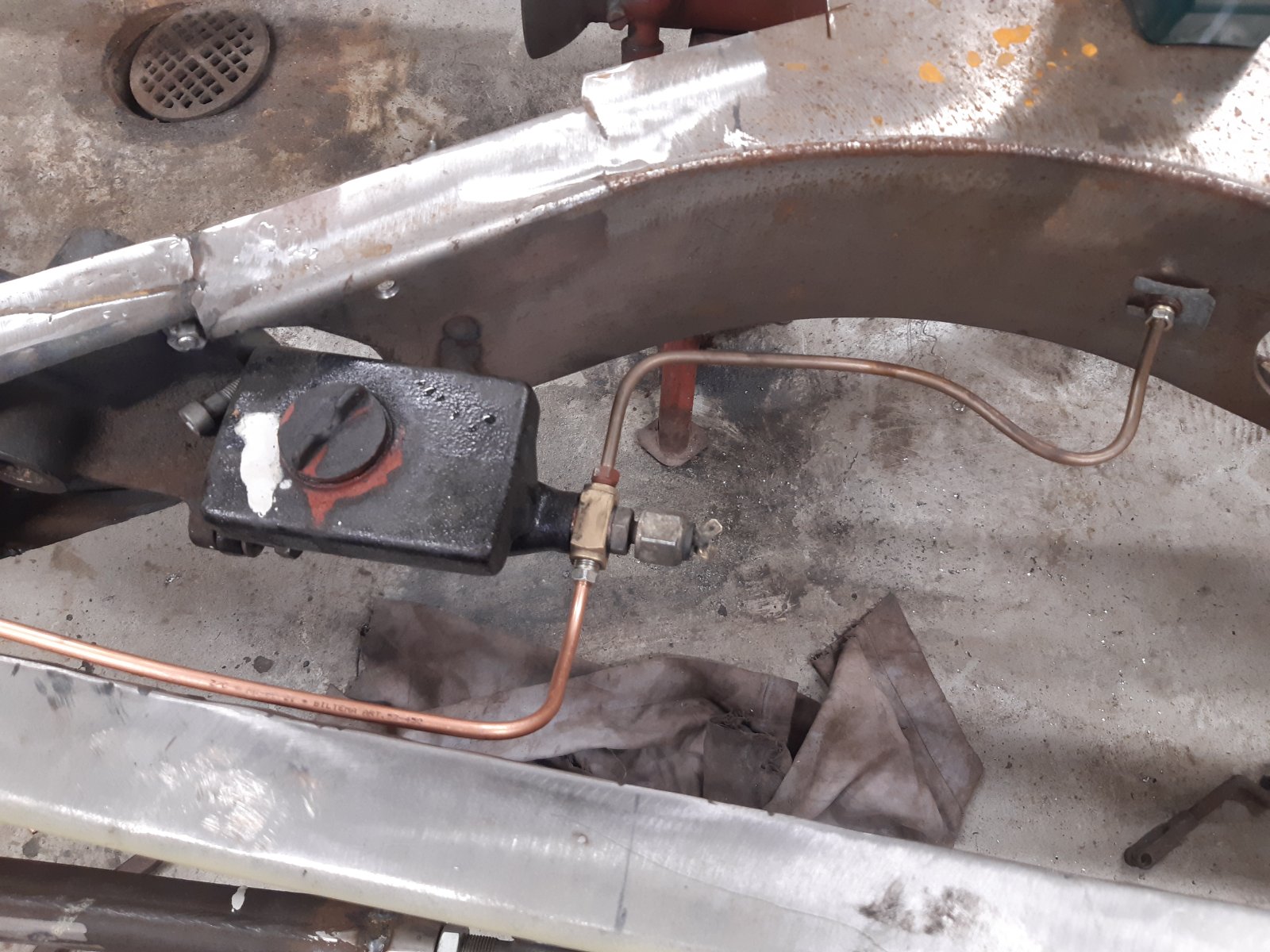

    One quite big job was fit ’39 pedals and master cylinder to the chassis! It was surprisingly tricky trying to figure out what is the right distance for the pedals, when the body was missing!
    I put a 21-bolt first into place, because I wanted to know if it works. There was a rumor that it was running engine when I bought it! That was also true!

    For some reason, when there is a deadline things tend to work out. I signed up to a car show at 1-2 of April 2022. While the body was at the painter I try to do every small things that I could do on driveable chassis. I even take a notebook and I wrote an note if I found something than I can do before the body is back. Of course there was lot of things that I couldn't do until the body was painted.
    Choosing a color to the body was just as much pain in the ass as it always will be. In last hours there were two options: something blue, or dirty yellow. You know how nice it is to make a decision on small color sample…. There weren’t no time to spray some test color, because Markus (the painter) was in a hurry with "real jobs". So…. I decided yellow! Not any typical color for me. I saw one French 5W Coupe on that kind of color on Instagram and that was it! Let's make it yellow!
    Finally, on Friday 11 March 2022, I went to the painter to took the painted body back to home. I took a risk and I have to admit that the color was shock! The yellow was incredibly bright! No can do anymore! A rolling chassis was pushed into the yard and four of my friends threw the body onto the chassis in a few minutes.
    So there was about three weeks to get car ready to the show!!!
    I had agreed on an Jari Kedonperä that he will paint to the body some "competition numbers" and other stuff on Saturday 12 March. In my thoughts it was also possible to do some patina to the paint. It was a pleasure to watch the work of an professional.
    While Jari painted his things, I piled up the body so that I wouldn't be in Jari's way. The competition numbers and other things came ready the same afternoon. We agreed that Jari will continue next Saturday body patination.
    Too bright yellow color bothered me all week no matter how long I was staring at. Jari Kedonperä came next Saturday to continue his magic. After an hour of work, too bright yellow color was a memory. Jari did his "magic treatment" the paint showed exactly what I had thought in my mind – dirty and patinated surface!
    I had promised the car to the exhibition in Tampere, Finland which was organized on 1-2 April 2022. The coupe was show-ready on Thursday 31.3. at 3:30 p.m.
    There was only one day i didn't build a car when I cam from a work so late. All other days I was building a car!
    "If there was no deadline, then nothing would ever be finished".
    At the exhibition It was a great surprise, when I won the "Special Award"!
    There was a smile on my face!
