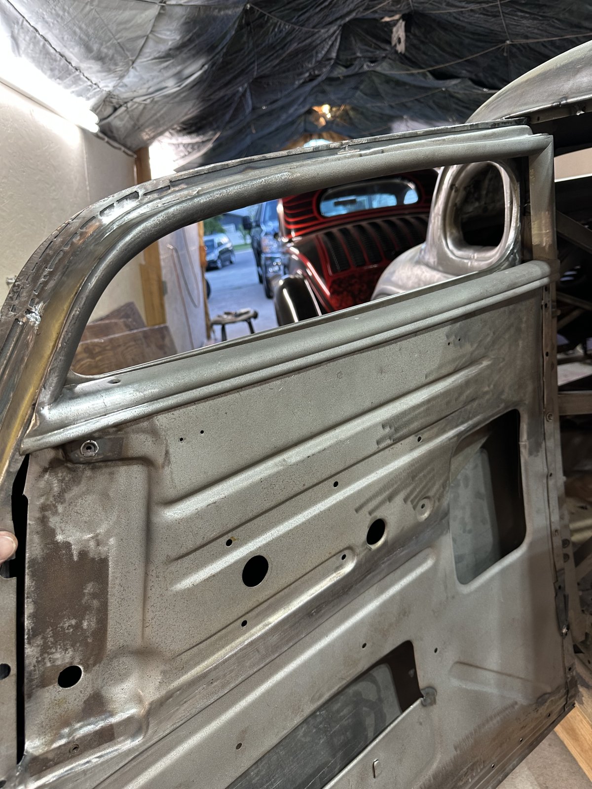

    getting the final fit for the wood over the door. Welding up all of the inner structure that I had to cut up as well.
    cut down the inner windshield garnish moldings and fitting them. I need to weld in a captive nut to be able to get it bolted in. IMG_9863.jpeg
    Fighting getting this inner panel/visor fitted. I had no idea how much stuff you had to fit between the windshield frame and the actual structure where the windshield fits into. There are a few flanges that I am trying to get to sit flush so the windshield will sit up flush to the frame.

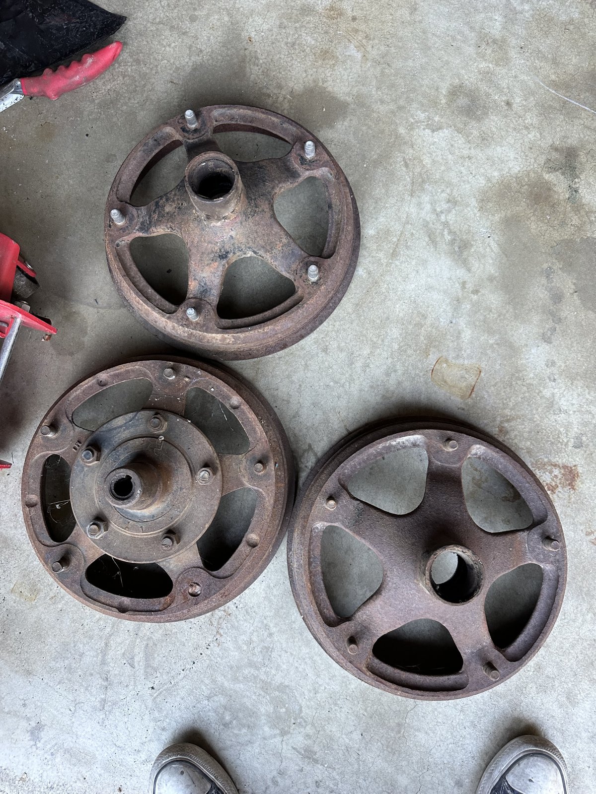

    IMG_9963.jpeg IMG_9960.jpeg IMG_9961.jpeg IMG_9967.jpeg IMG_9966.jpeg IMG_9969.jpeg IMG_9965.jpeg
    this is a part of hot ridding I haven’t really touched on. Partly because I am fairly new to it and am slowly learning about the important history and culture. I have been trying to collect parts for years now for this car and the more I learn the more I accumulate. You buy one thing and then time passes buy and your taste and knowledge changes. Then you find something better and cooler then you end up with doubles and triples of things. I have been draining my bank account to get the right parts. The best part about doing it is meeting new friends and learning all of the amazing stories about them and their hot rod parts they have had for years. The wide five hubs are hard to find. I was lucky to randomly come across them. I’m hoping to pair them with some 18 inch wide fives but they are hard to come across. Been looking for about 6 years now. Was able to pick up the grille at the roadster show and I think it will have the right patina for the car. Was lucky enough to find a couple of Culver City quick changes. One of them needs a full rebuild including the pinion halo welded up. Not sure what I will do with the spare. Hopefully build another hot rod. Maybe I’ll sell it. Not sure yet. The old wood that came out of the original car might be my favorite out of all of it. I’m not sure how much of it I will be able to use. I’m hoping to at least find a way to cut the quarter window wood down to use. Then again it’s not very bonneville to have the extra weight. But still cool. Trying to find the right period parts for the car and keep it traditional. Thanks for reading! Happy hot rodding!

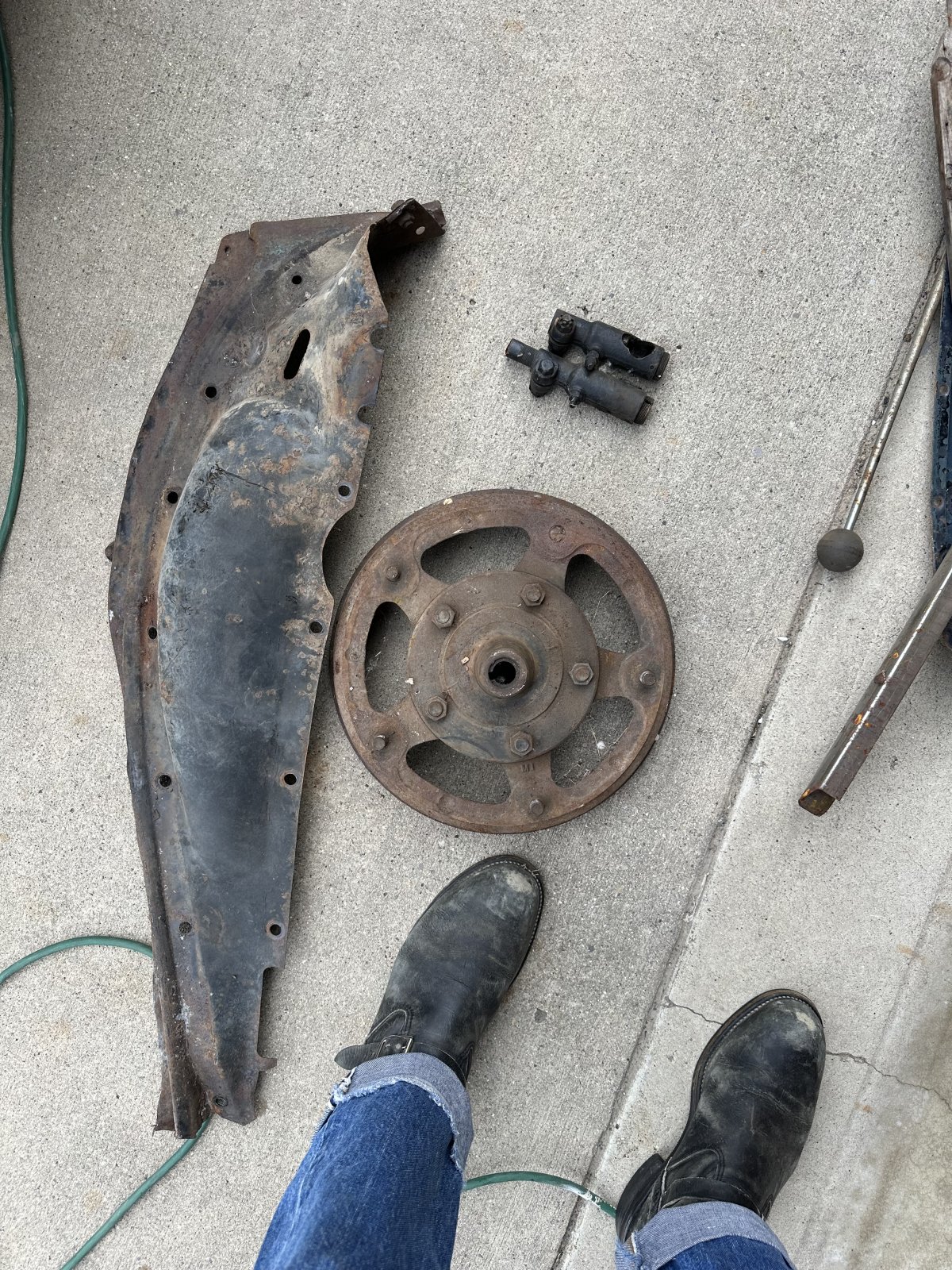

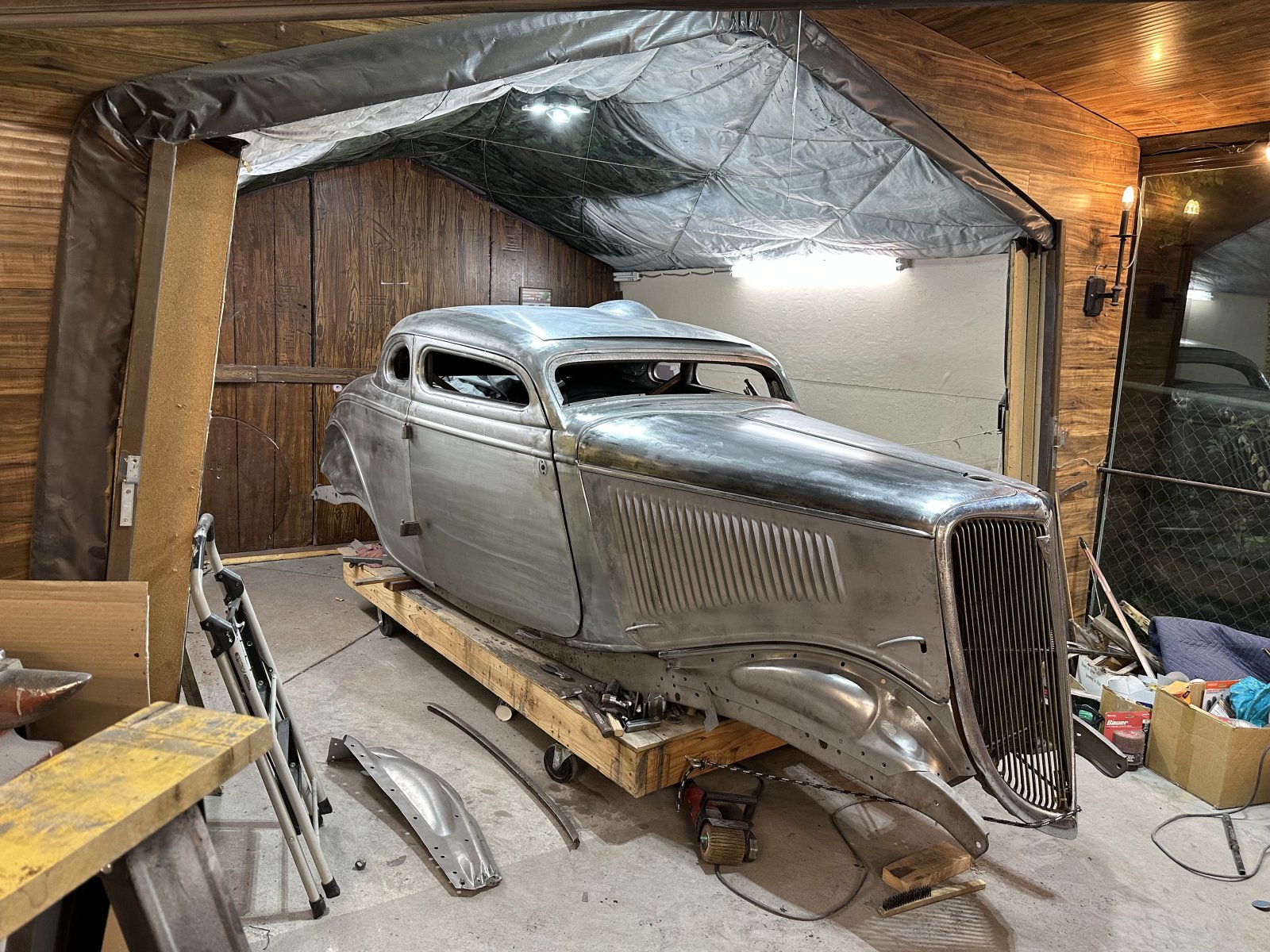

    trying to catch up with the pictures and progress. This will probably take two posts. Been trying to tie up little odd and ends on the body. I leaded the a pillars as well. No too bad but I’m not full happy with how they turned out. Gonna take a little more work to get them right. Picked up a super early, I think pre ear high rise thickstun intake. Also started tearing down the rear end.

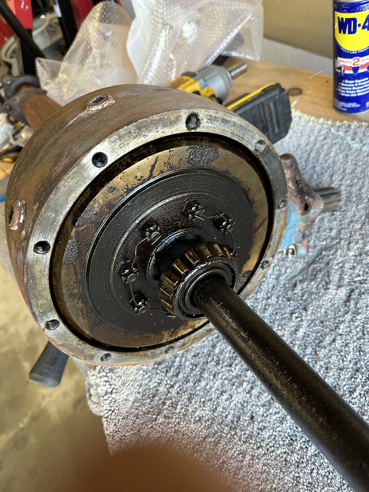

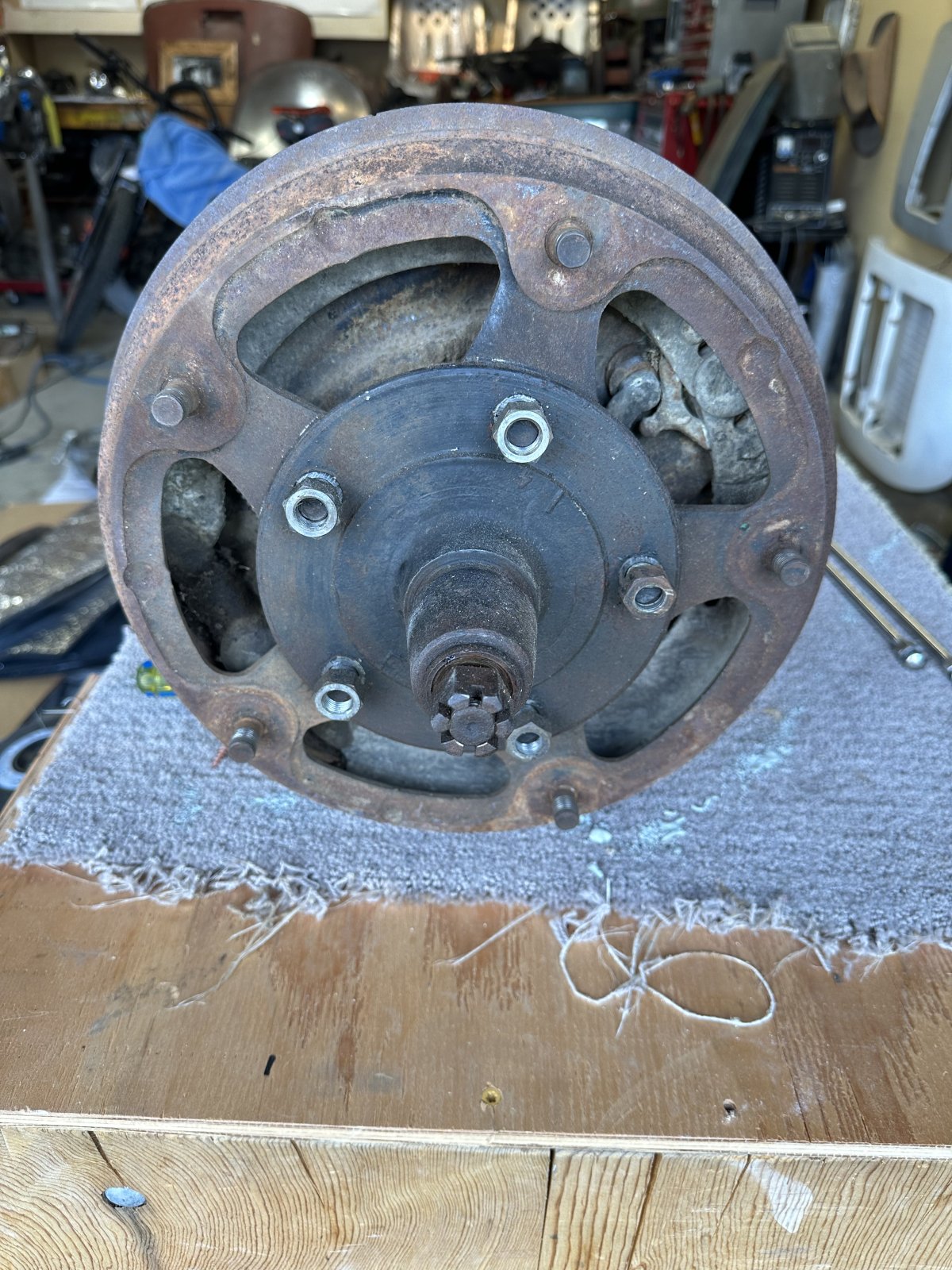

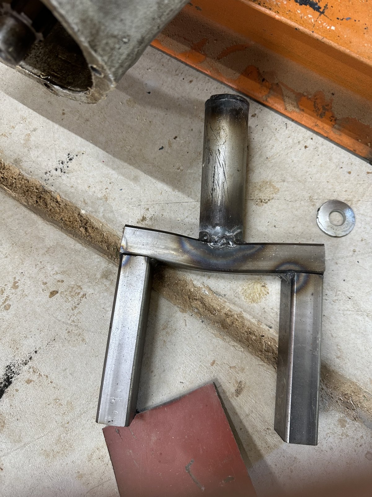

    stepping into new territory. I guess this whole build has been new territory. But I pressed out the old pinion and the lower shaft along with the rear lower shaft bearing because it was bad. The tool I made was taking a beating. Had to reinforce it. I have two quick changes that I’m rebuilding. This next one was a little more trick to get out. It took a few days to get it but i finally did. Cleaned up nice. I just need to weld up the pinion halo on this one and have it machined. Someone tried to do a repair it looks like and didn’t have it machined out correctly. IMG_1639.jpeg IMG_1641.jpeg IMG_1657.jpeg IMG_1660.jpeg IMG_1664.jpeg IMG_1663.jpeg IMG_1673.jpeg they cleaned up nice. I have bought all new bearing and a ring and pinion to rebuild them. That’s all for now. Thanks for looking!

    Real nice work on the conversion. I think everyone with a hydraulic press has a piece or two of bent tubing they used before they figured out to use solid bar stock.
