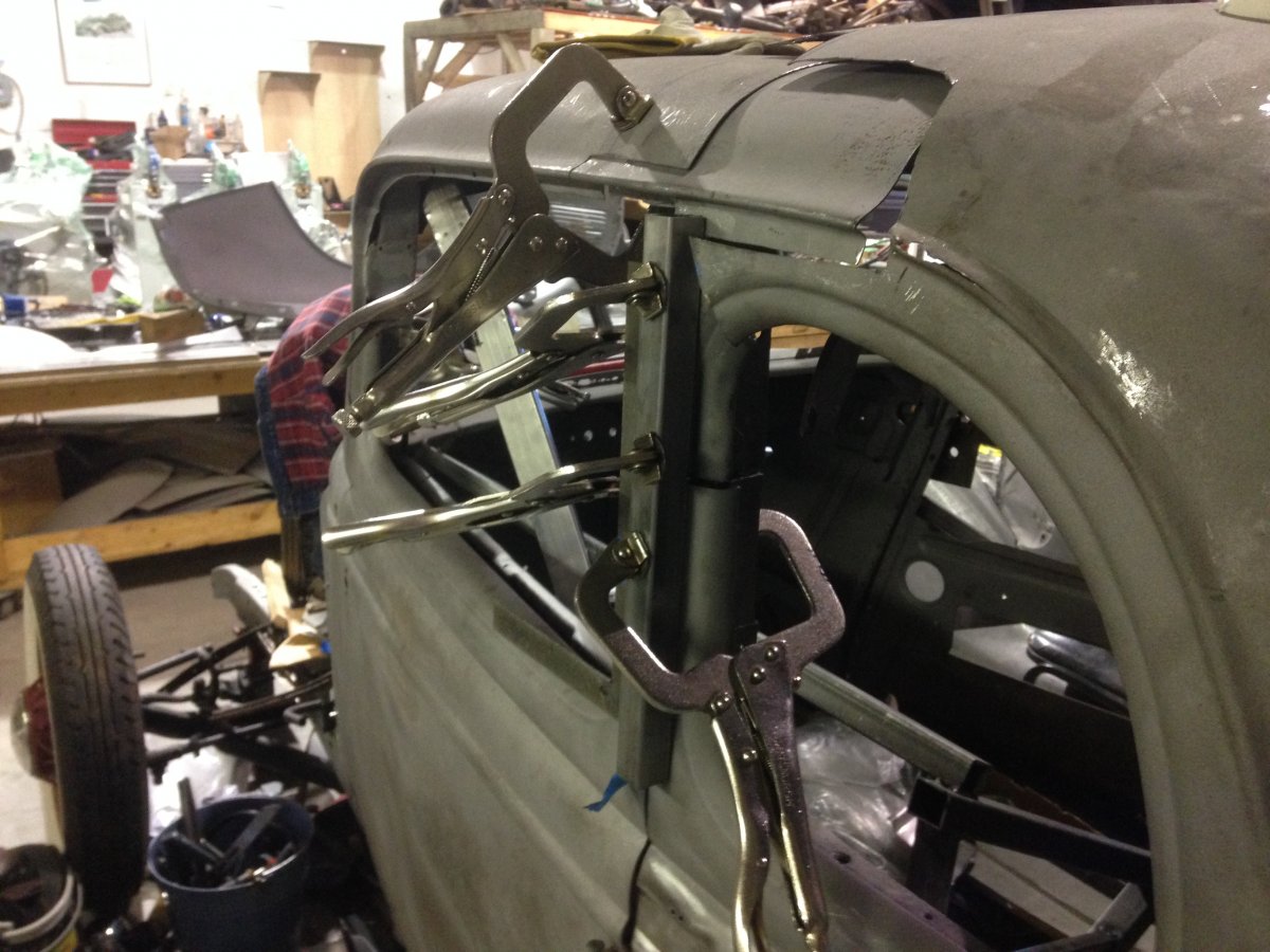

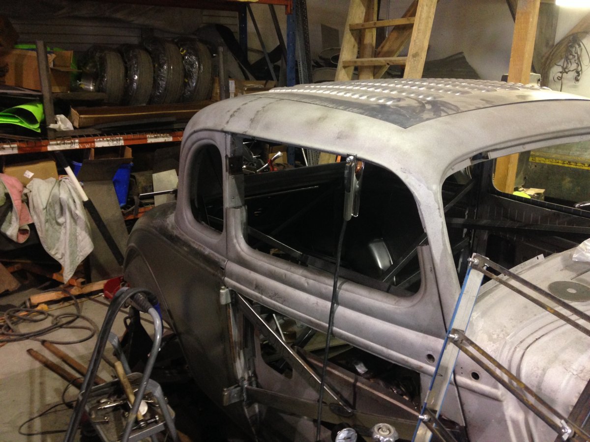

    from Utah

    Found that the cross bracing wasn't sturdy enough, with all the fitting of the 5 widow top it kept want to pull the quarters in. I put a bar across the top of the trunk to keep them from separating. Seemed to do the trick!

    This is where I think a lot of guys who do conversions come up short. Nailing the lines while grafting the two roofs together is critical. It's gonna take a lot of clamps to get it right. This part has also taken a couple of week of tinkering and manipulating pieces to get them to look perfect and fit.

    Grafting the roofs together. Trying to get the crown and lines perfect.
    This angle is looking straight down on the "sunroof" the five window doesn't want to match up exactly with the sedan roof. I will end up cutting out the corner to match it.
    The big contraption on top of the car has the original crown of a five window, I am using it to help match my roof while it gets tacked.
