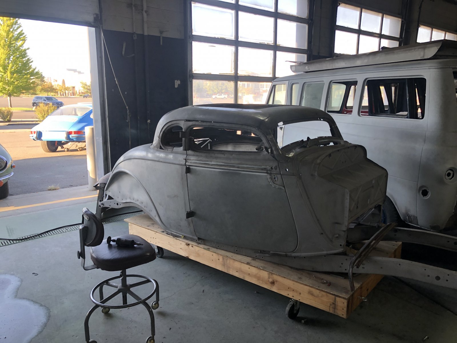

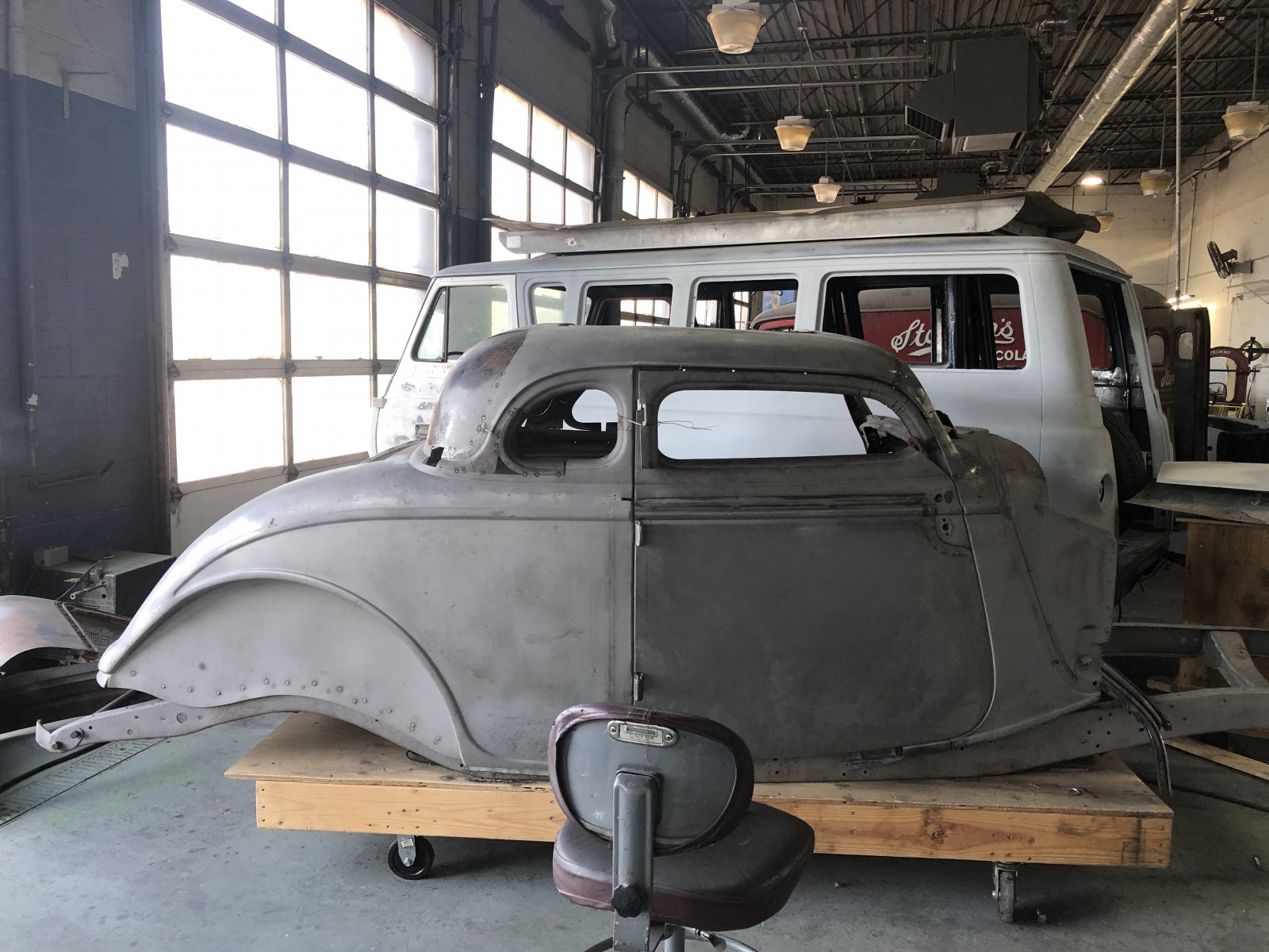

    Well... the shop I was working in moved up north so now I am back in the garage. As you can see not much space but it’s on a big rolling cart. Going to wheel it outside to work on it.

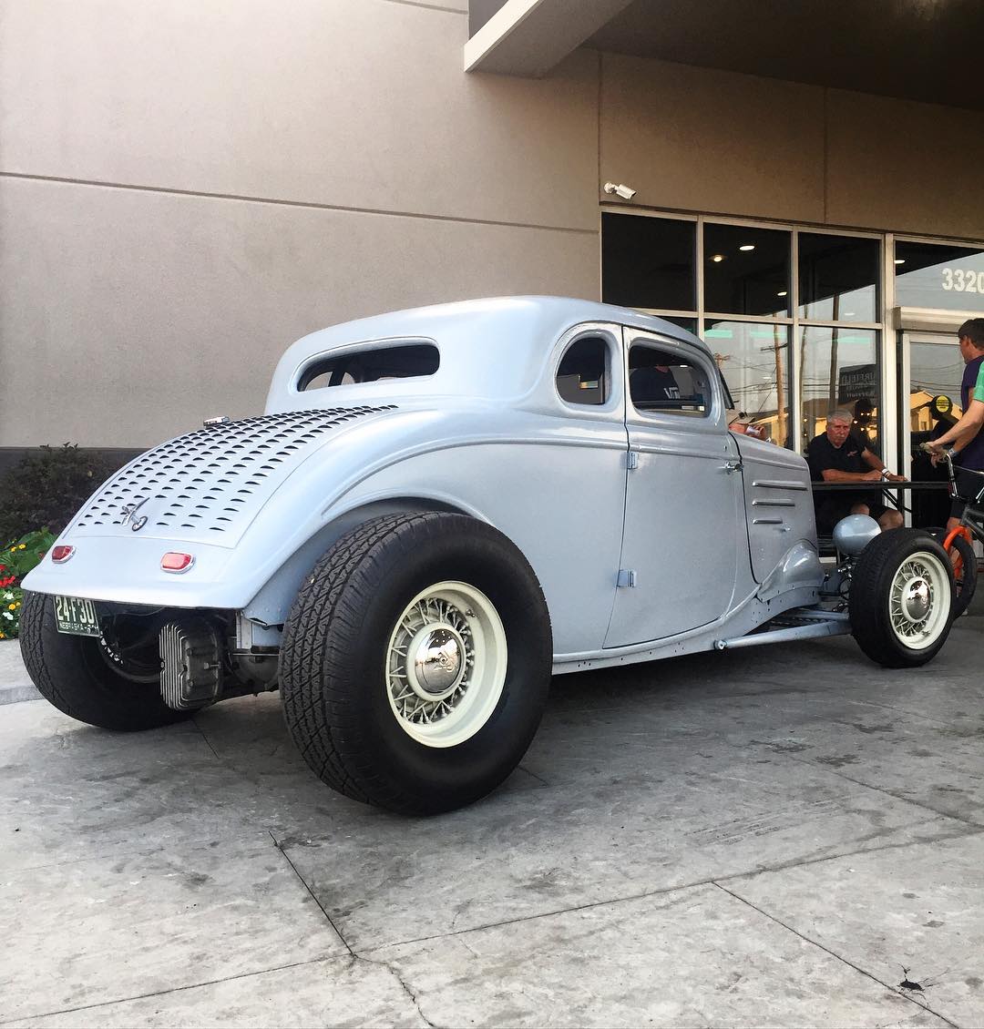

    Holy ****!!!!!!!!!!!!! I thought it looked great before you cut it all back apart again. It's gonna look like 100 MPH sitting still! When my body man and I were talking about chopping mine, I wanted a 4" chop with the posts leaned. He said no so we agreed on a 3.5" chop without leaning the posts. Now I see why he didn't want to do the full-tilt-boogie chop job on my 5 window. Lotsa work! Love watching your progress. 34rodders Journal photo.jpg

    full tilt boogie chop, I like it! Man that’s a beautiful 5 window you have though. You guys did a great job. That lighter color you went with has me thinking about going with something besides black. I’m liking it.
