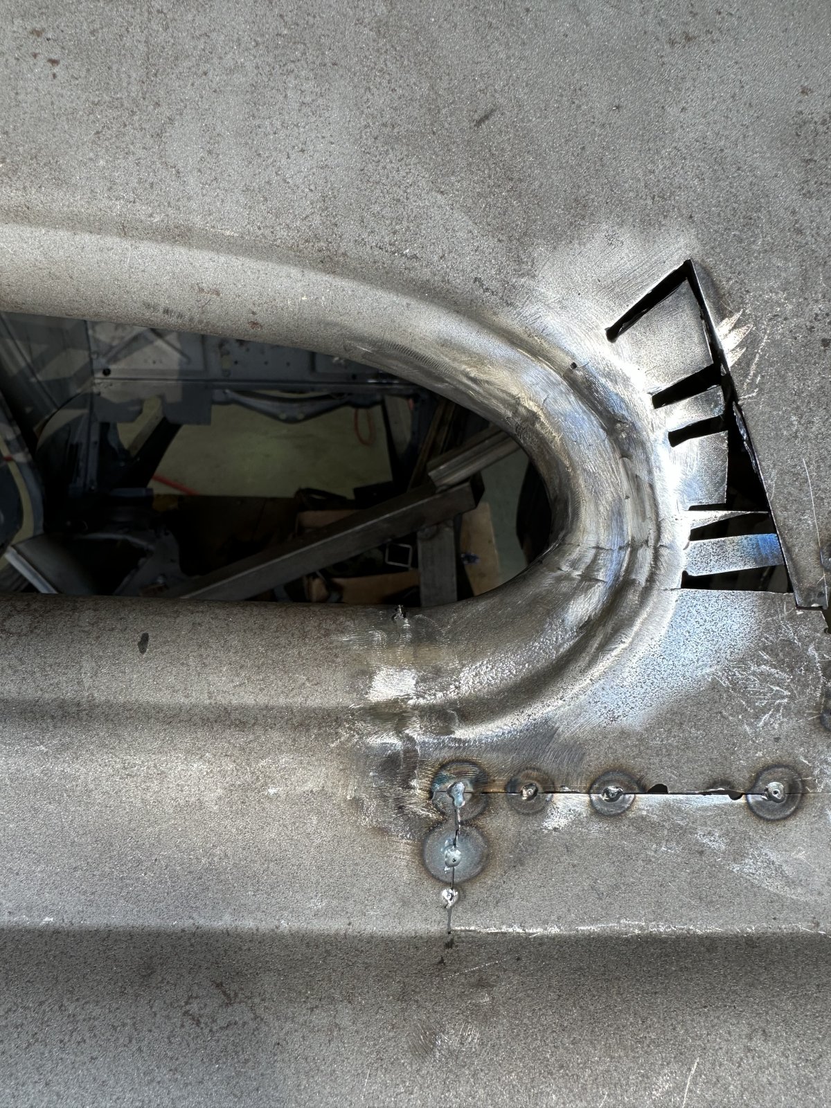

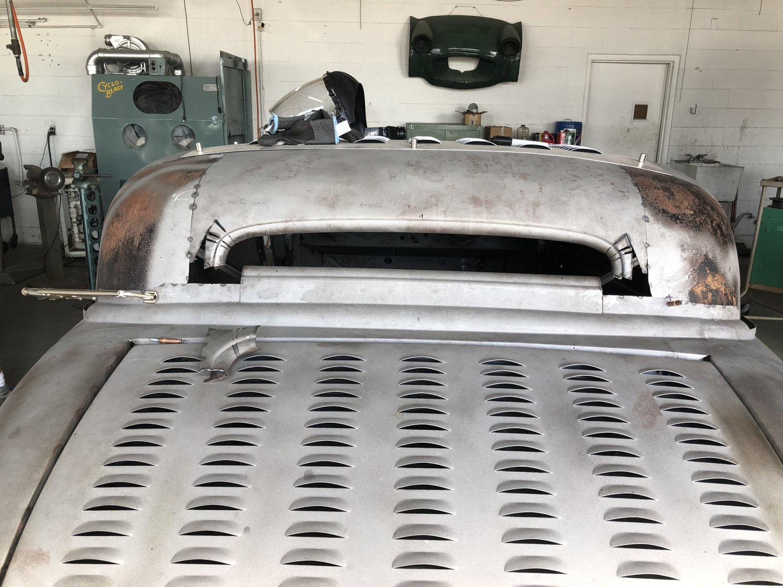

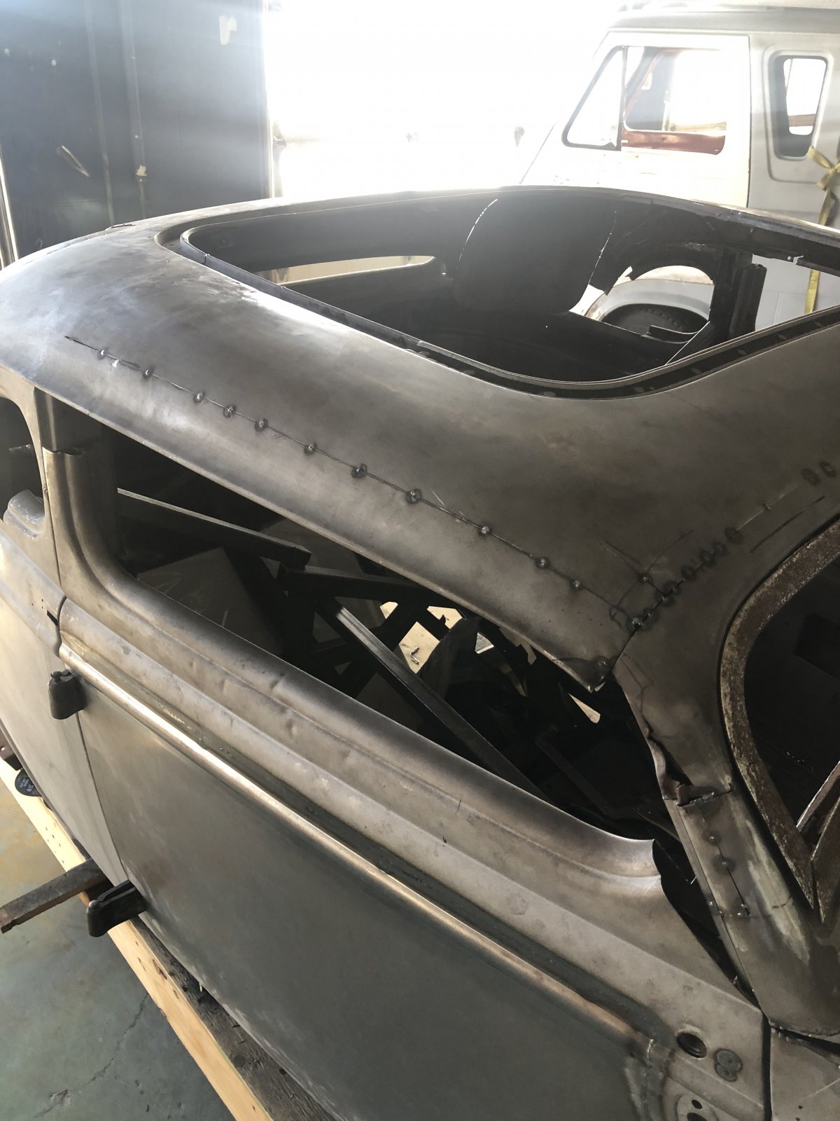

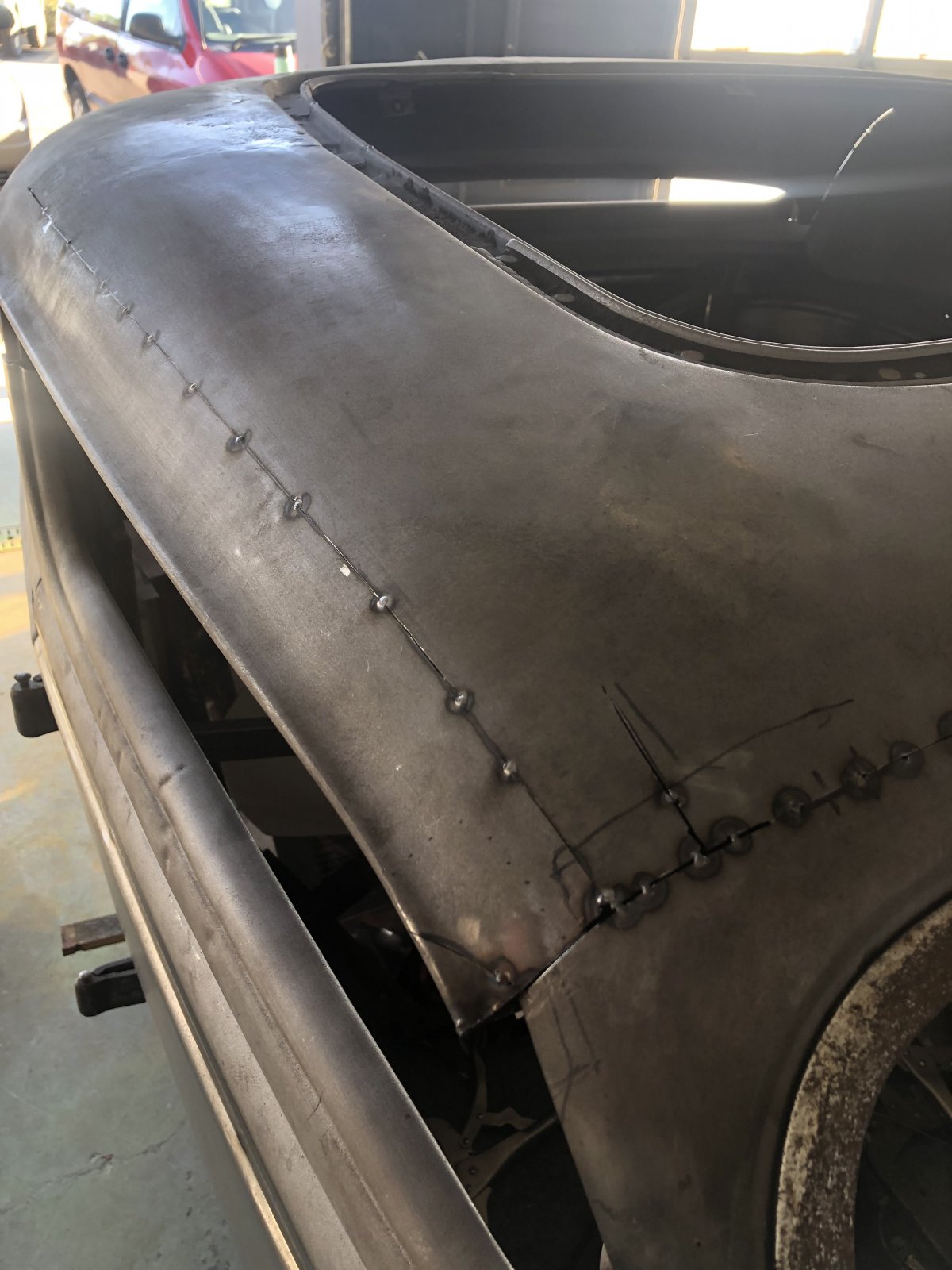

    192EA2F5-B152-419C-A429-BED8D08A72E7.jpeg 8D7C040C-07AE-4C6B-A37B-2C8F7F2C3418.jpeg DAB850EA-35DA-4672-8237-48C60D75BAA9.jpeg
    close up of the drip rail, raised it about 5/8

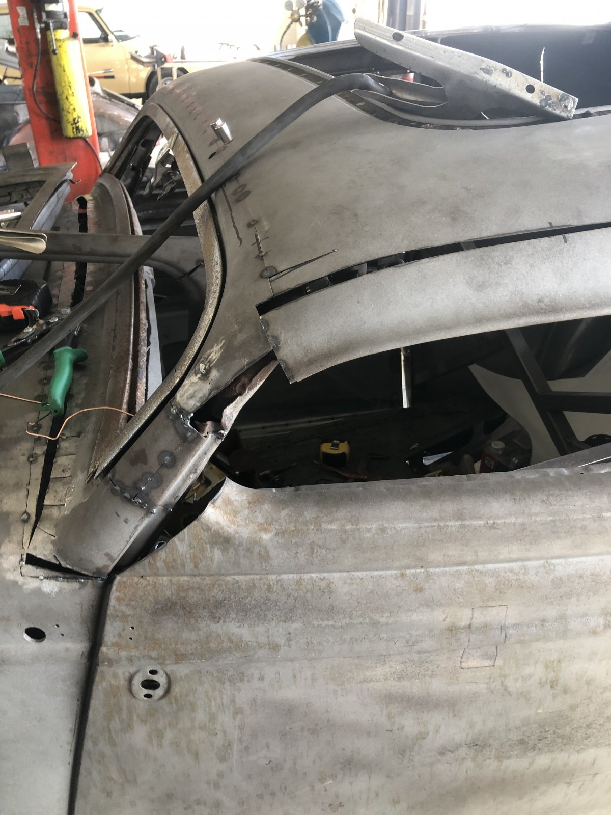

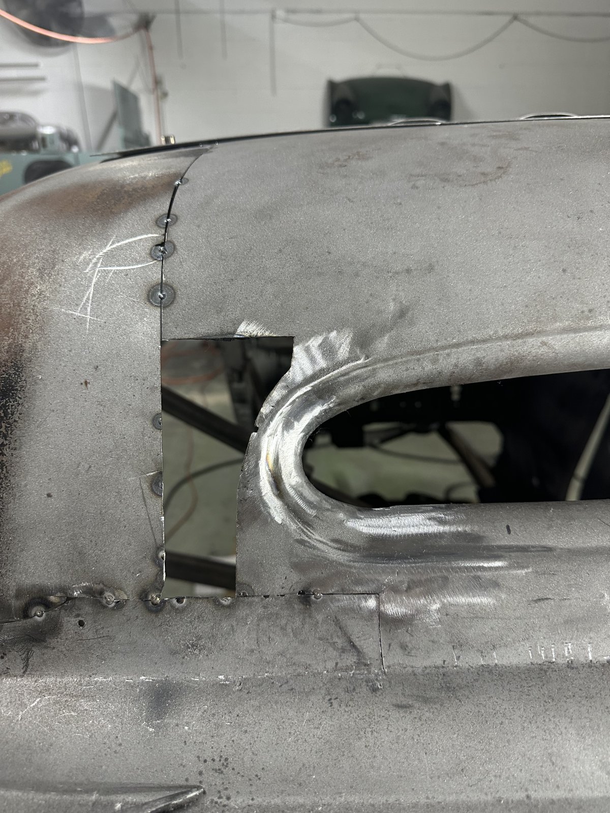

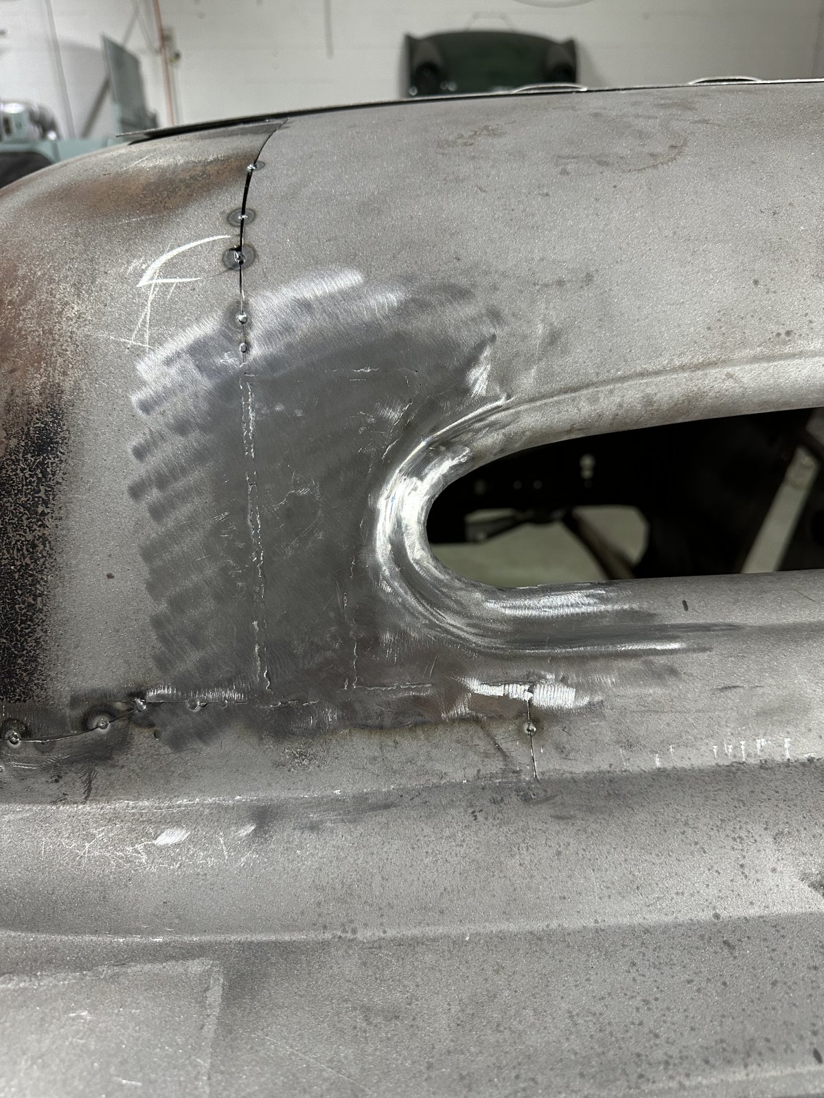

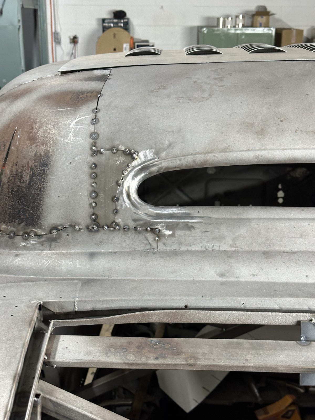

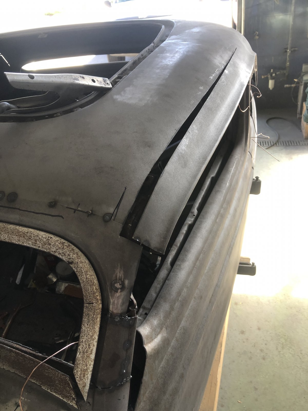

    E4475E04-A886-458E-984C-3FAEE0D78CB4.jpeg EF464579-BB15-48CA-9347-87F6C6011BE0.jpeg F91E4D05-7EFD-4E20-9AD8-30DD73492D11.jpeg
    getting them ****oned up on both sides.

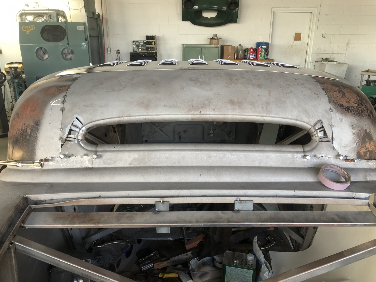

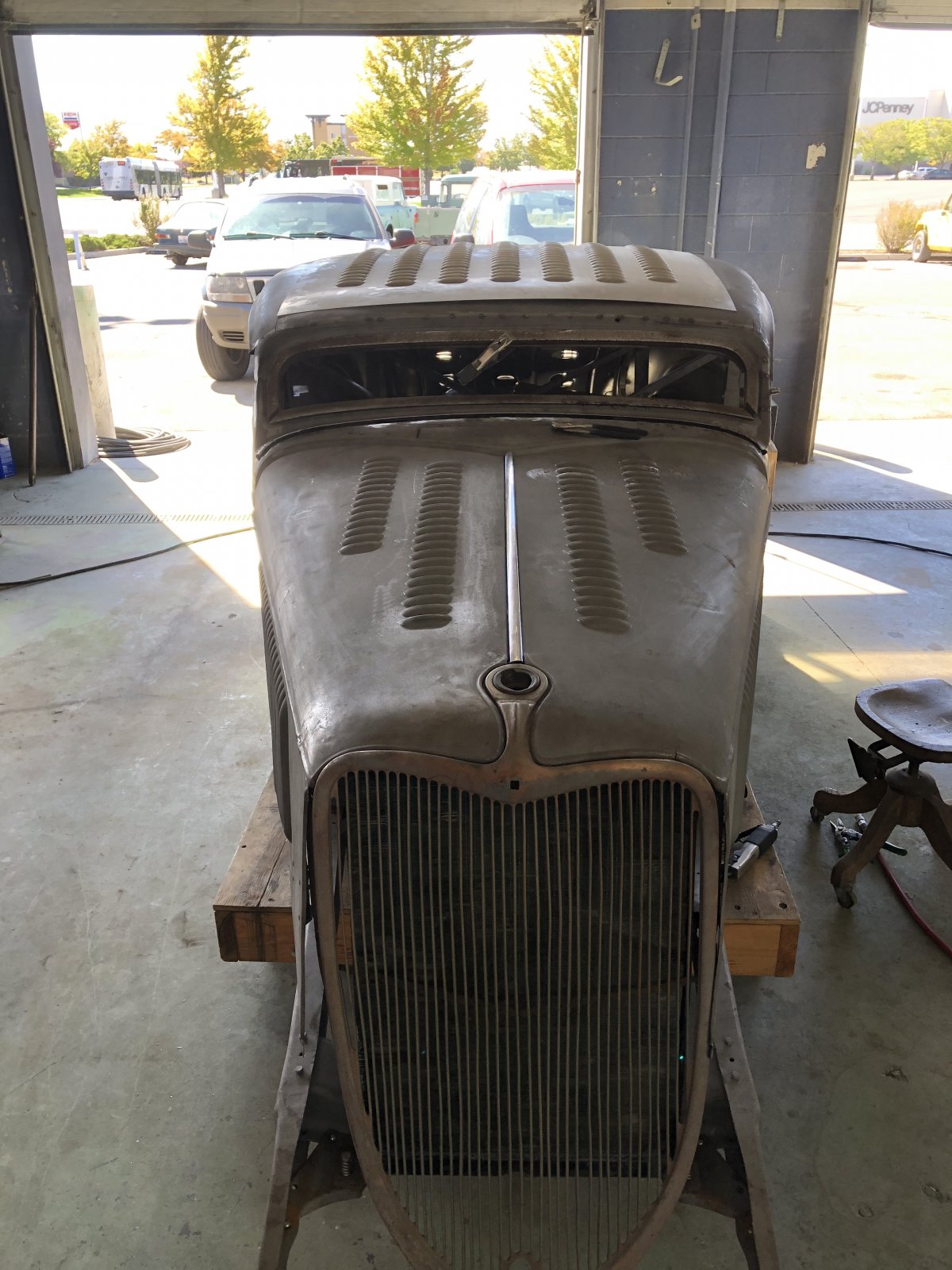

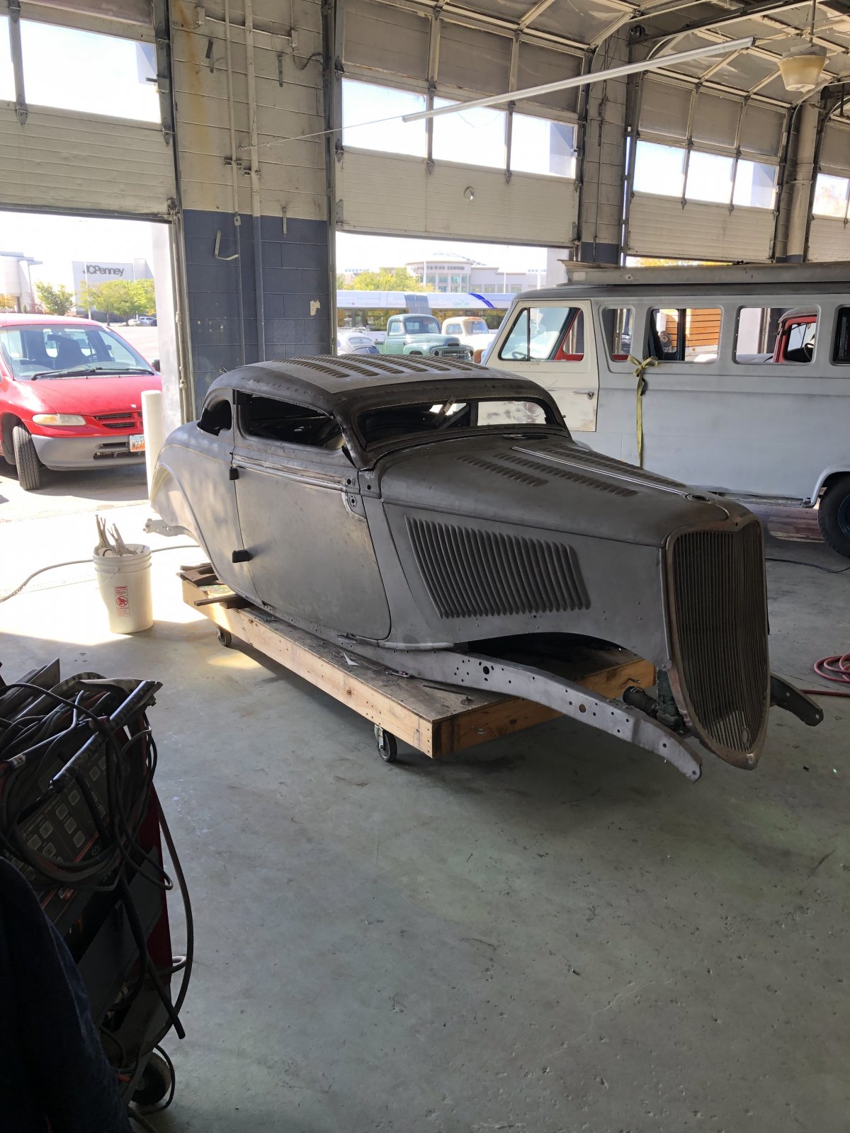

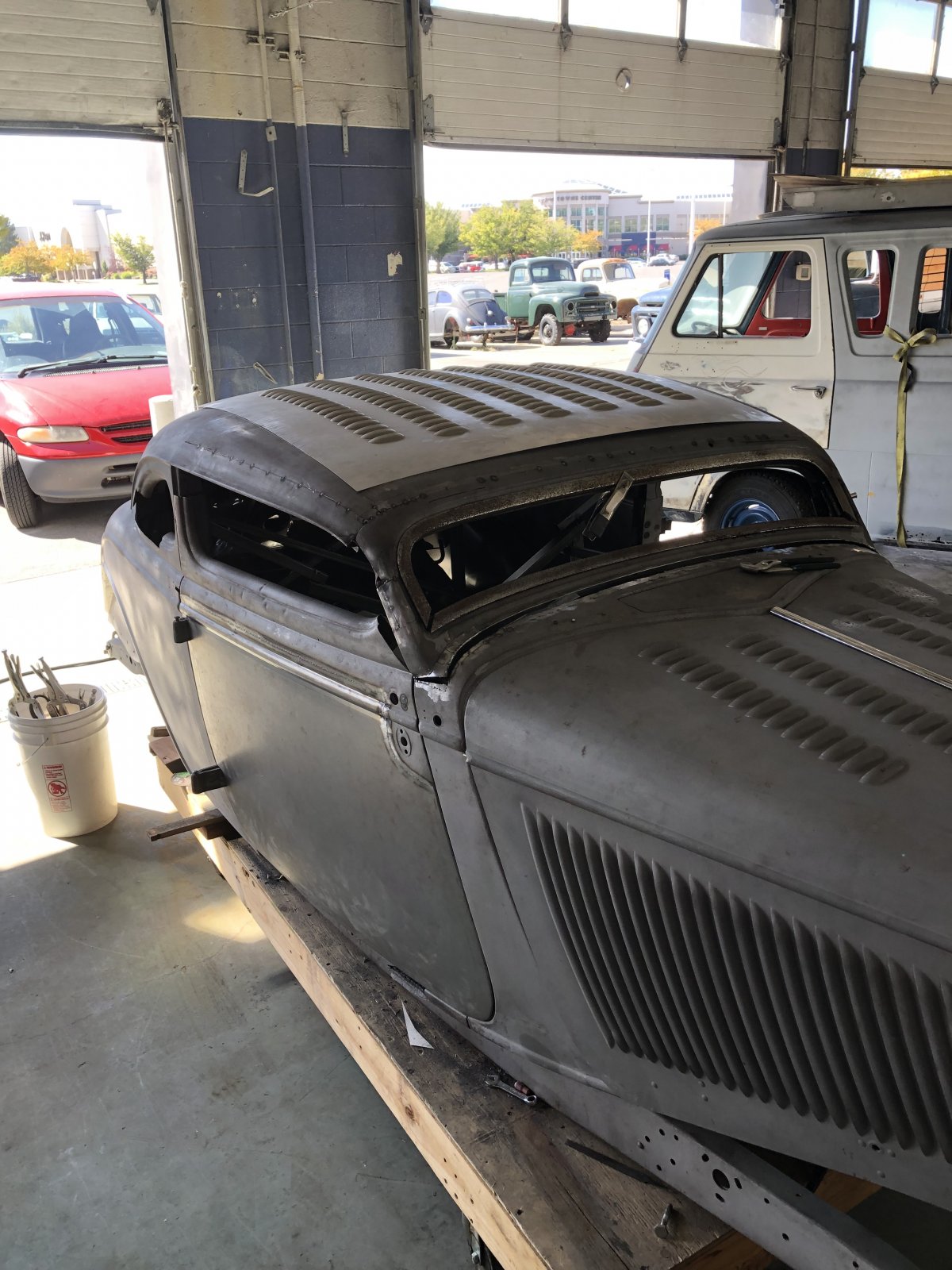

    She looks different with her hat on. B9E19A11-1AC3-4D8A-AAFA-ABC39B5CC582.jpeg 901BAF79-E458-4B87-B22C-1EB2A8731824.jpeg 05C73AF2-77A8-4C7E-ABA0-75B253A66577.jpeg E6925D12-F325-4A15-945B-FA0B81CDB21A.jpeg

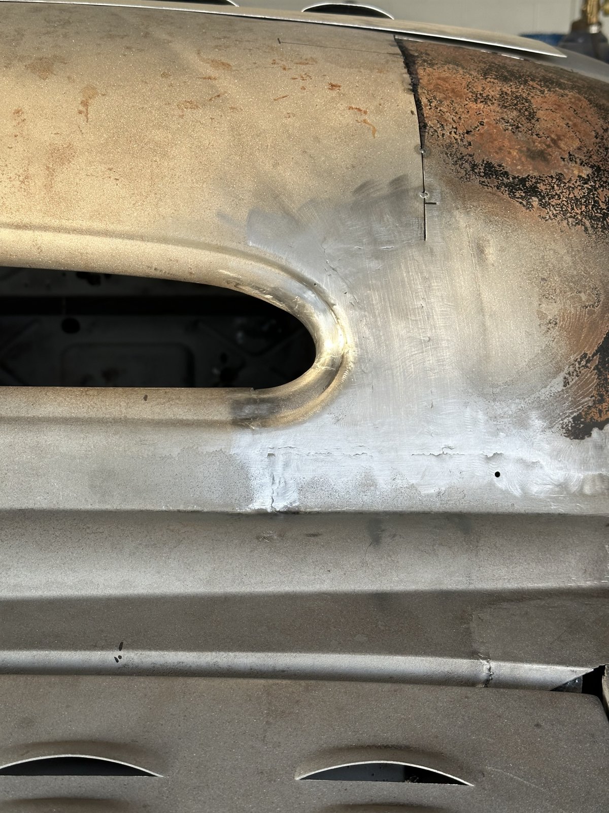

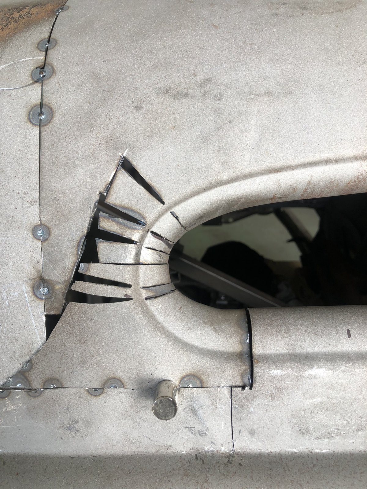

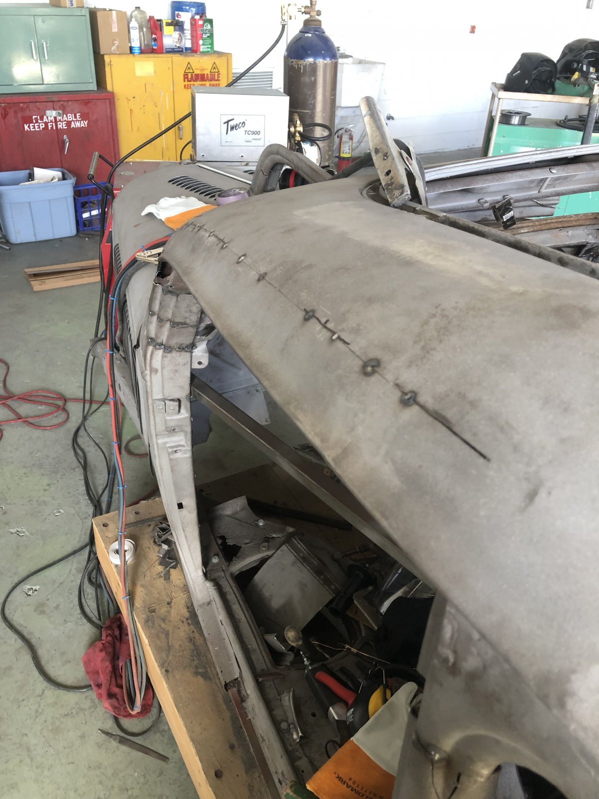

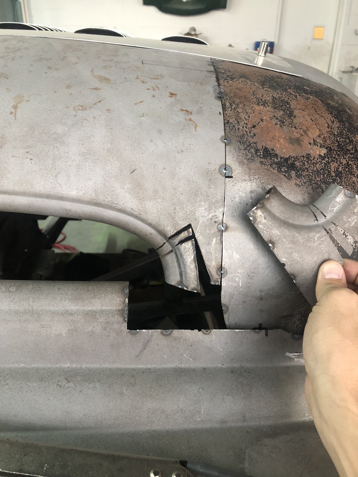

    E8ED9BF5-71BC-4912-9880-ABE58D9E37D8.jpeg B4B67B22-5D72-48E9-B3FF-4A1E23C5FFFB.jpeg 24388664-739F-43D9-A9FD-C6D979EAB558.jpeg 621F2E79-C812-4B0D-A8F8-019B8C32999B.jpeg B3D0D0CC-89B7-49CE-9612-6BAFE02FA2AB.jpeg 23B728E2-DFA8-49E0-842D-841506EB7B33.jpeg 4C8187B5-ADB8-45EB-8050-32BB4C81A6F8.jpeg A3D5D6BD-E62F-4D19-8E54-80A61500FA99.jpeg E9F19794-0260-47E5-A67B-80975EE85A6C.jpeg
    doing is this way was the only way it made sense in my brain. It turned out decent though. Nice to get that part of the chop behind me.

    In that first picture above, I saw that drastic turn that needed to be done. I said to myself going to intersting how he pulls that one off, might not make it. Damn I should have known better, great job!
