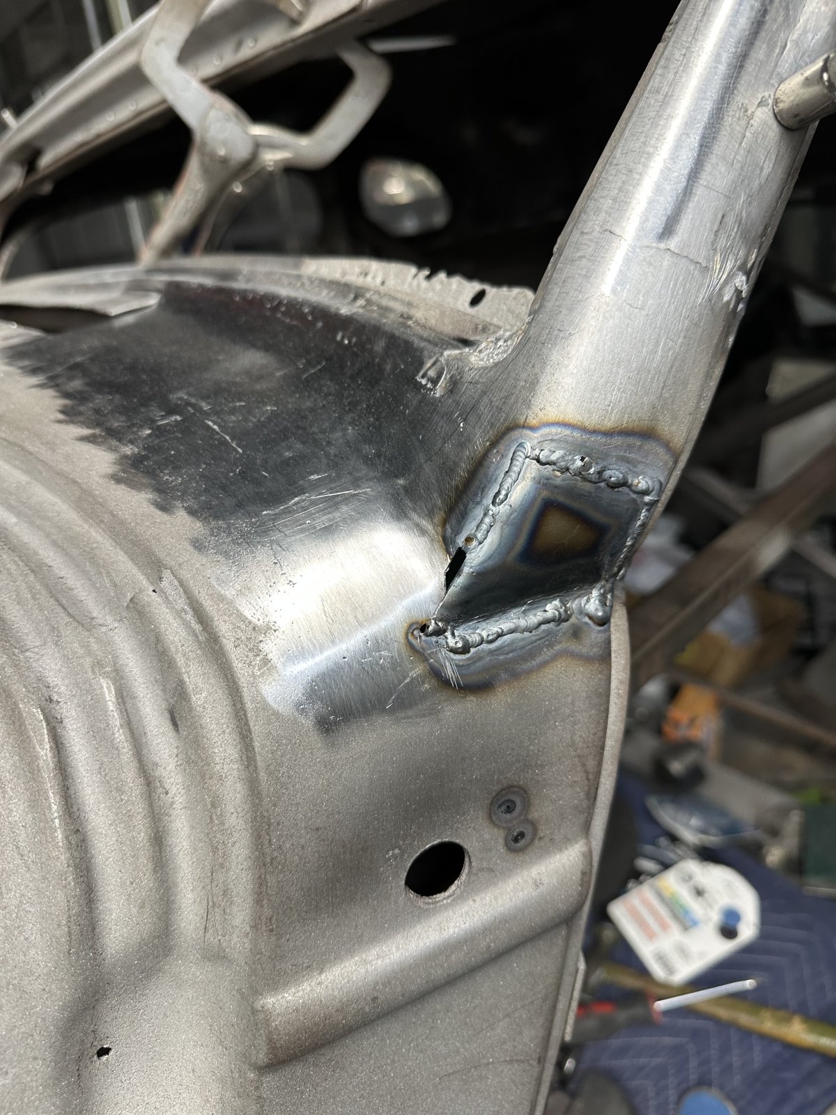

    Took a little bit of metal m***aging but it turned out!

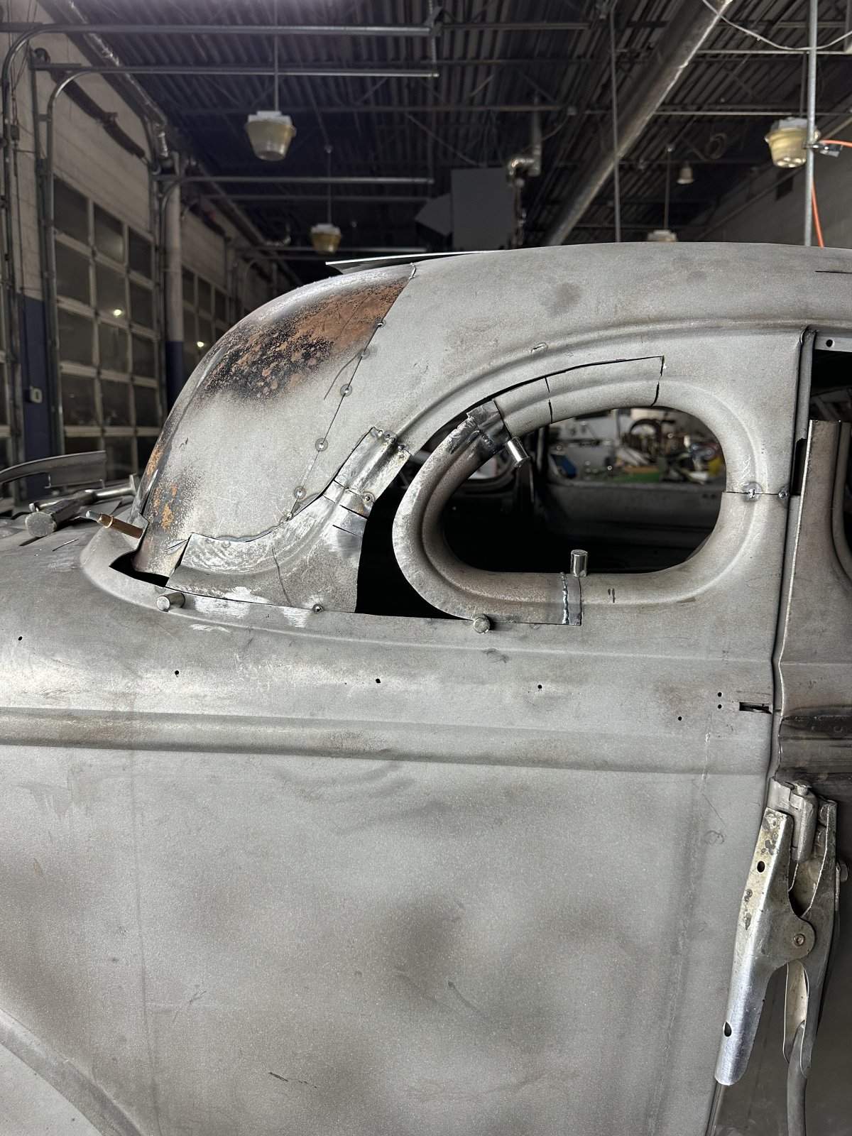

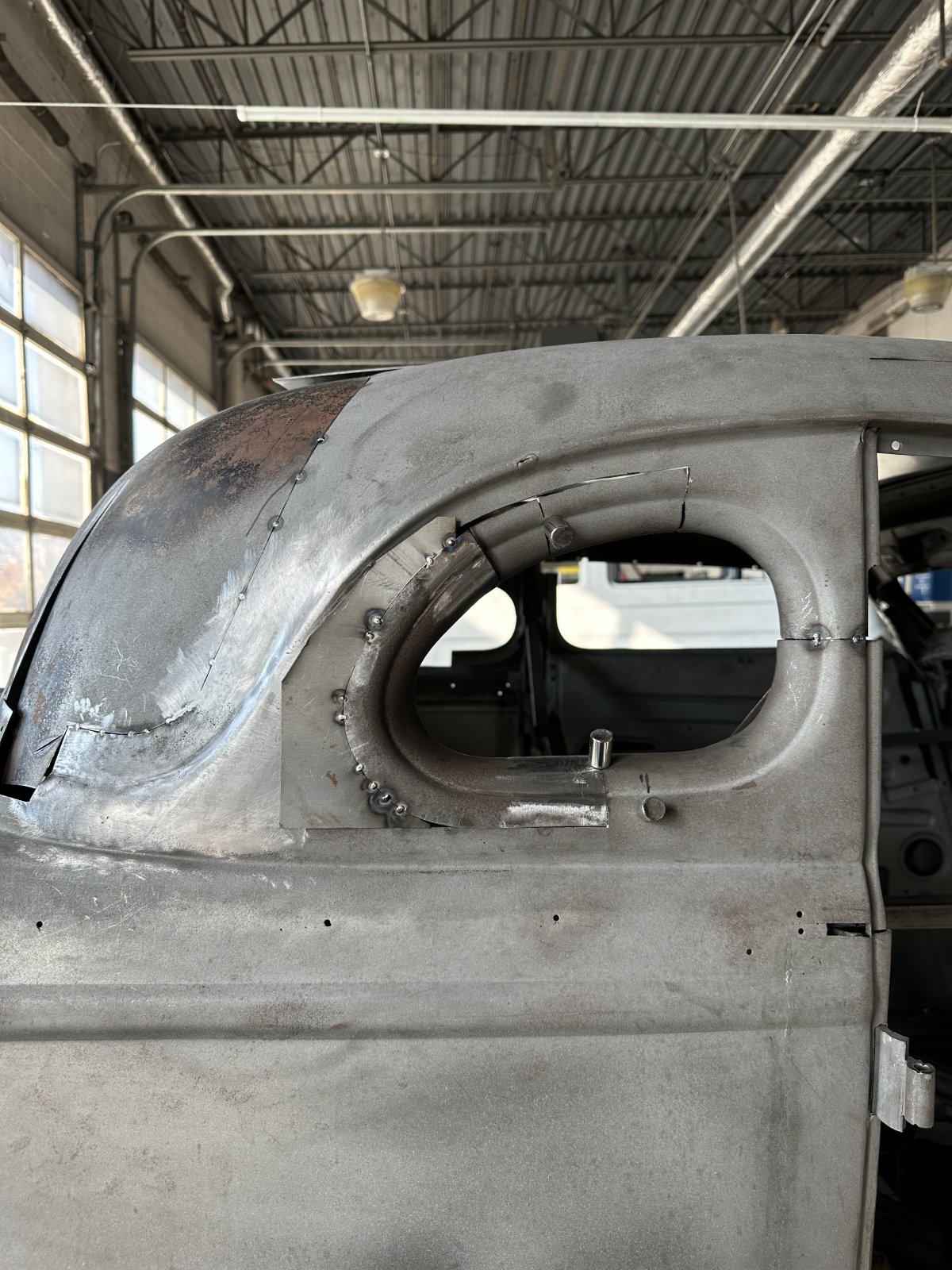

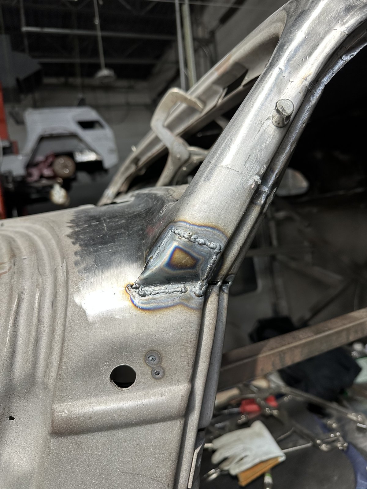

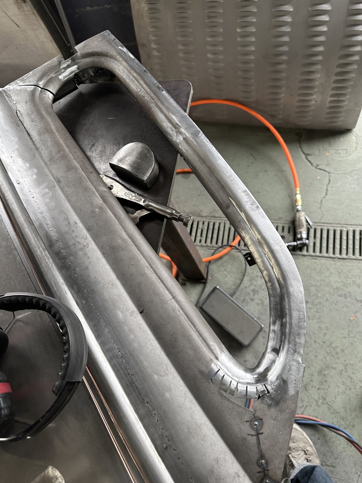

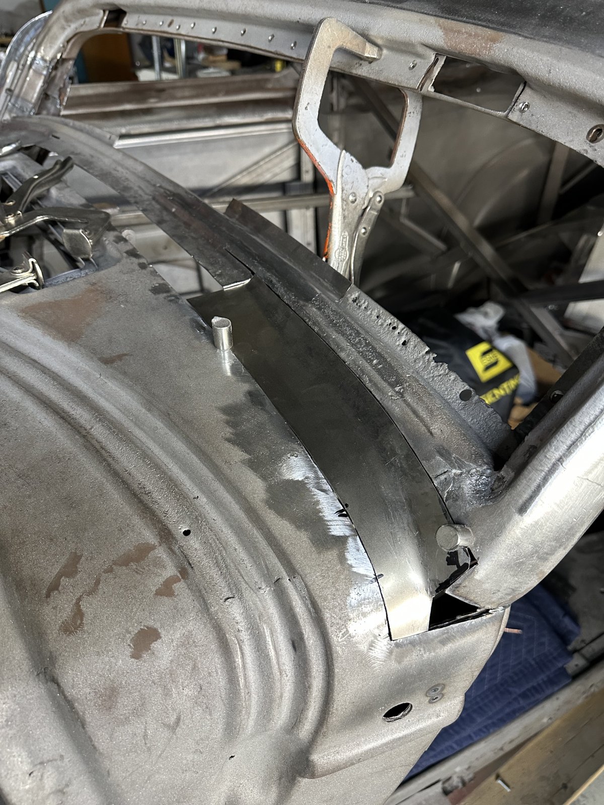

    from Utah

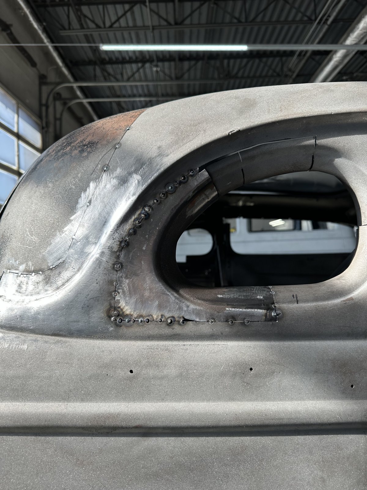

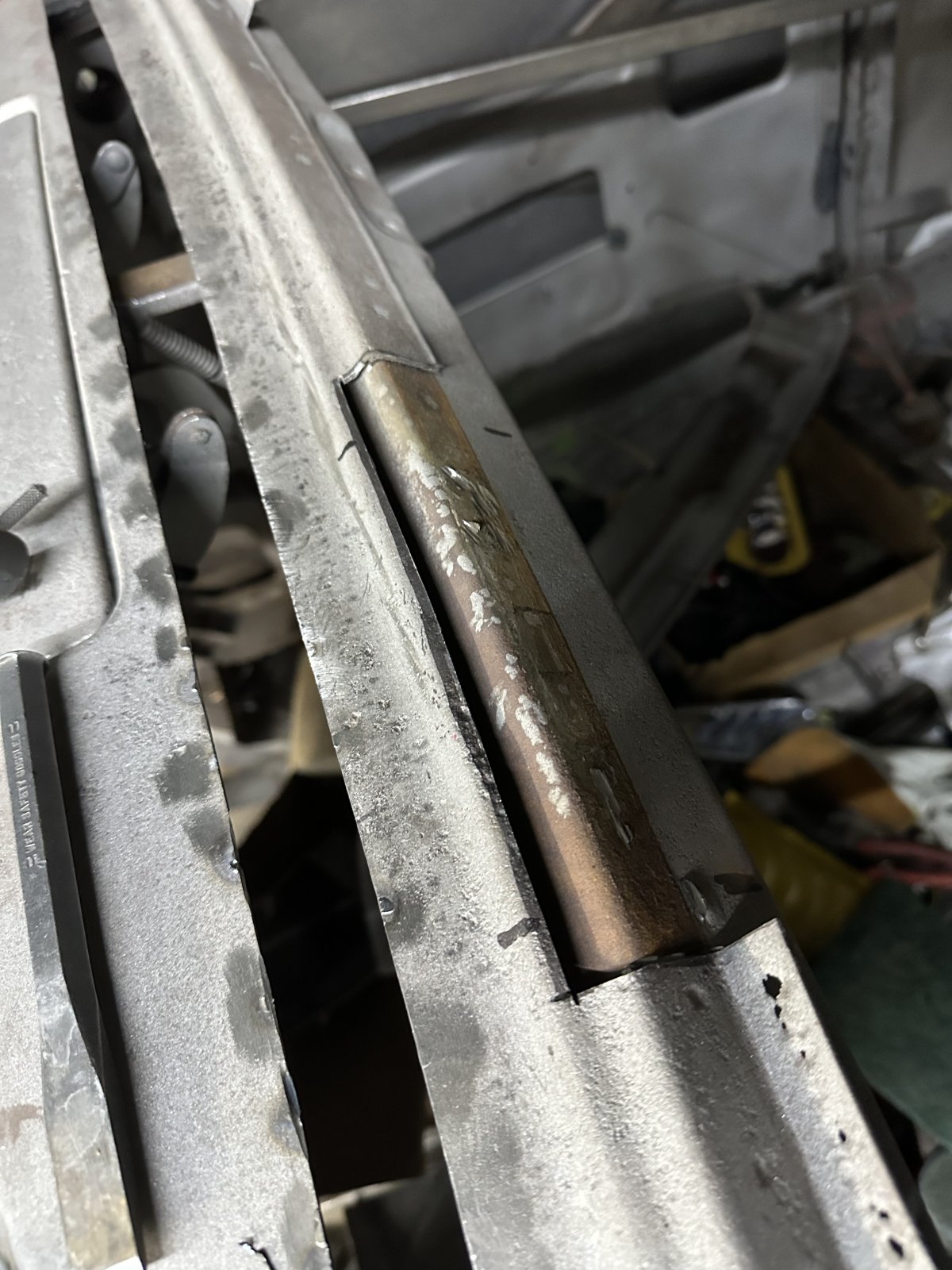

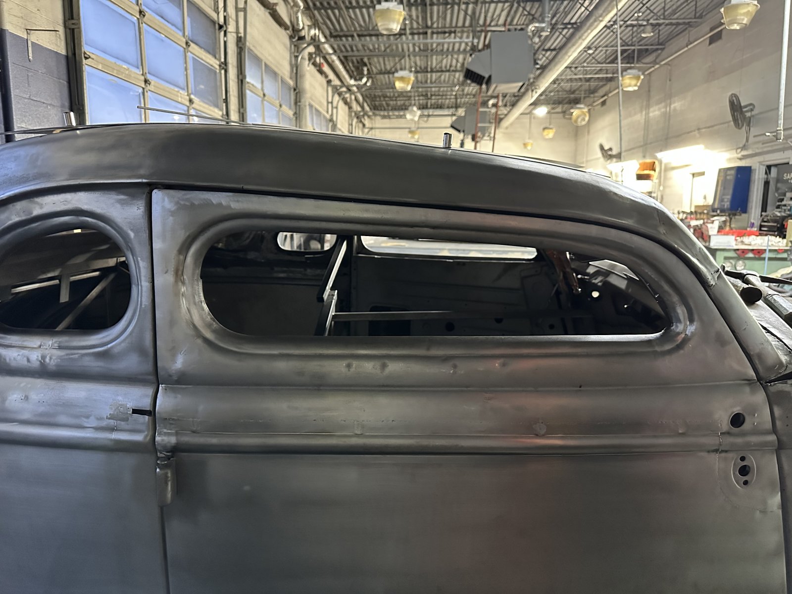

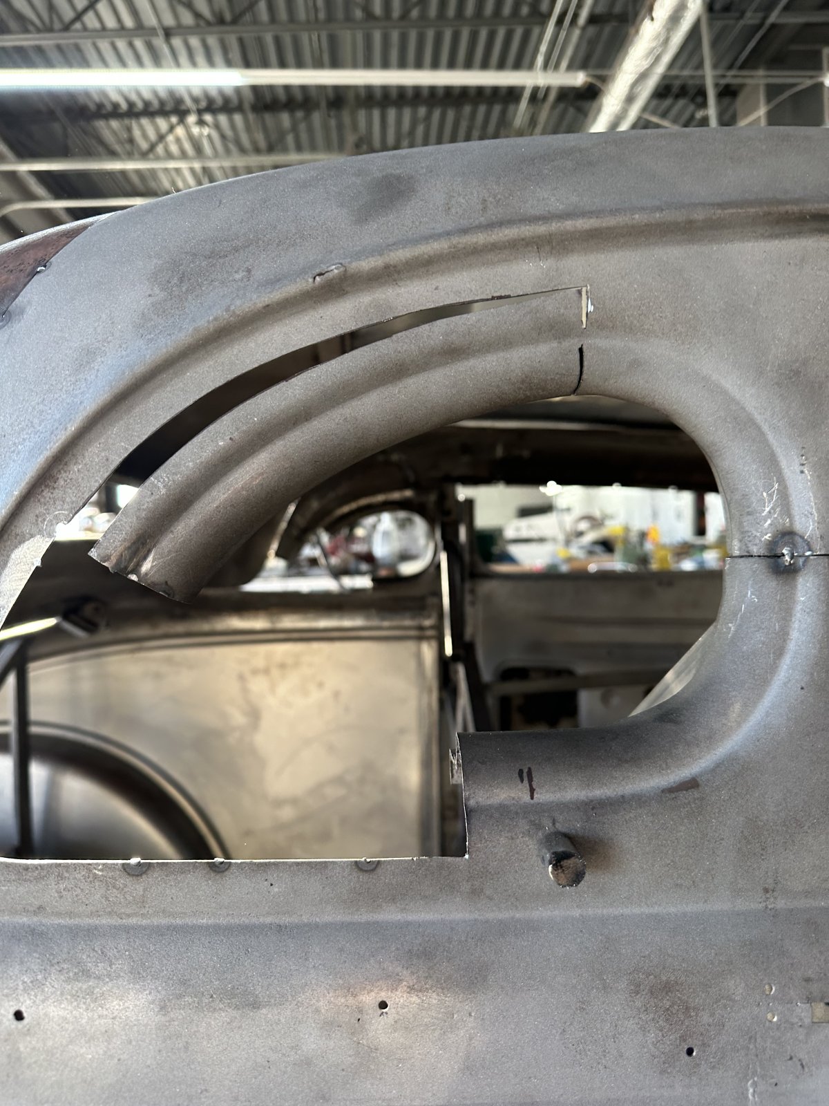

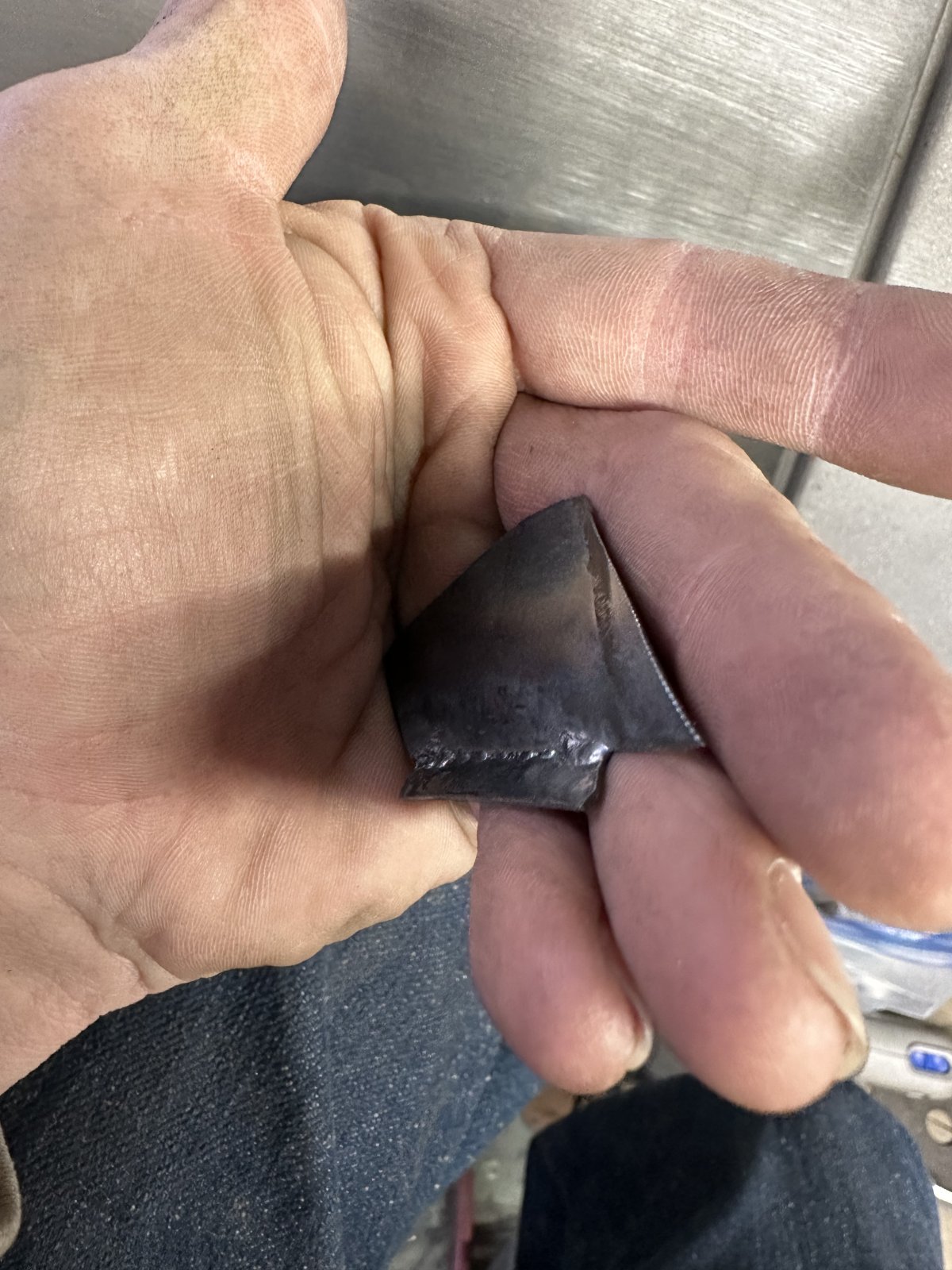

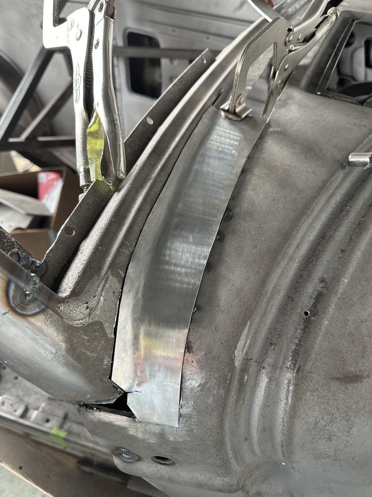

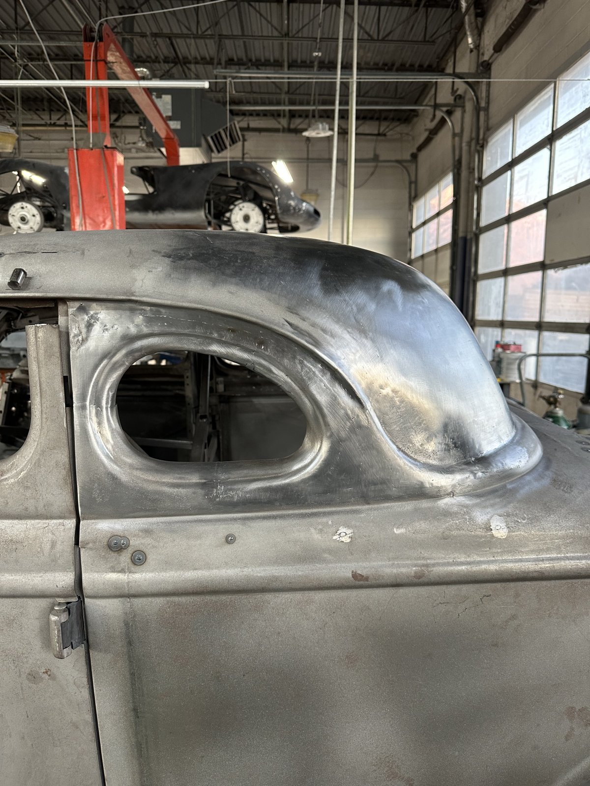

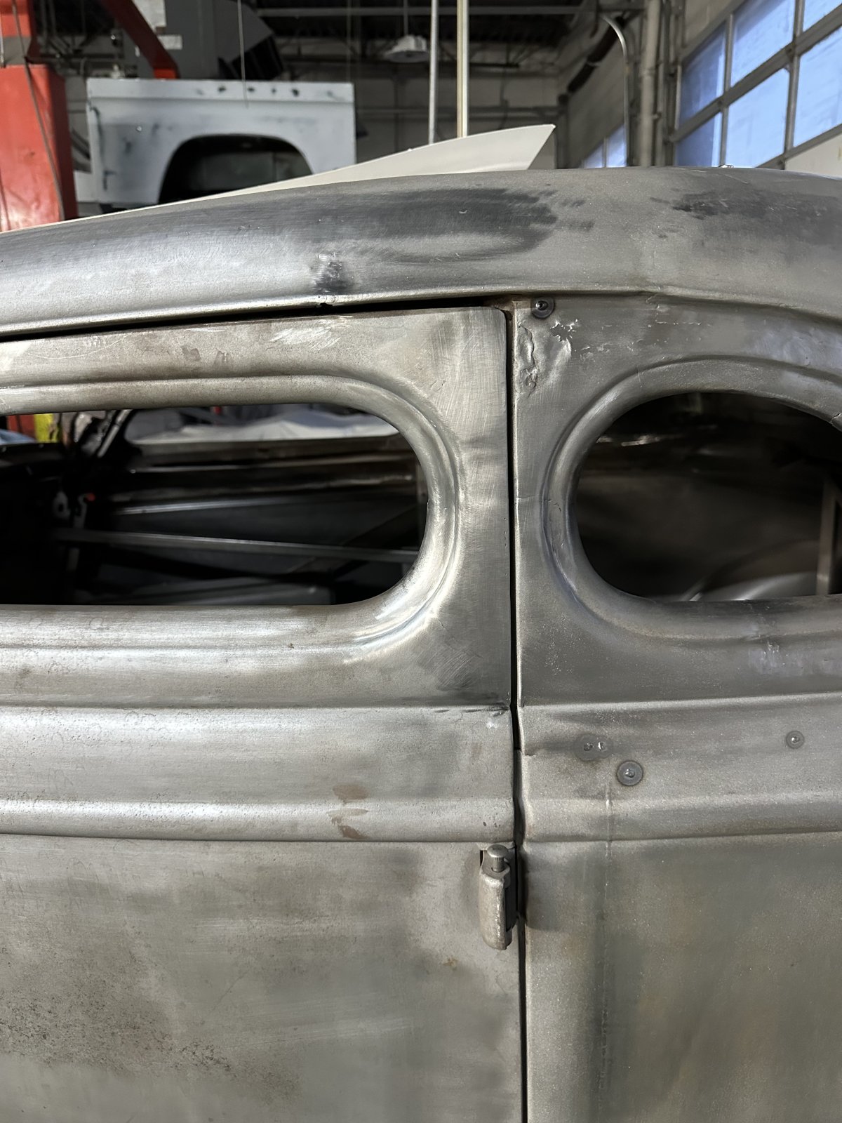

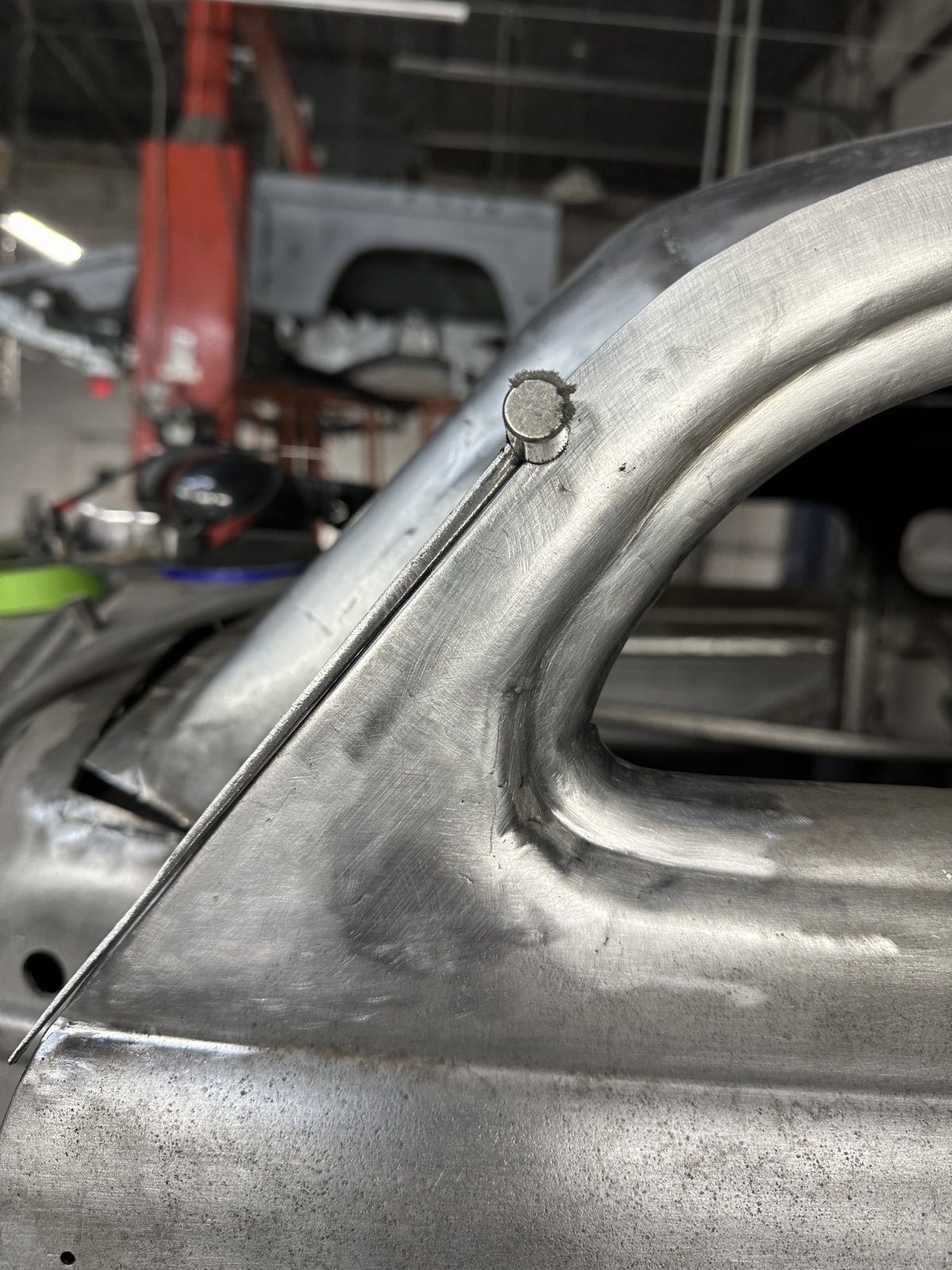

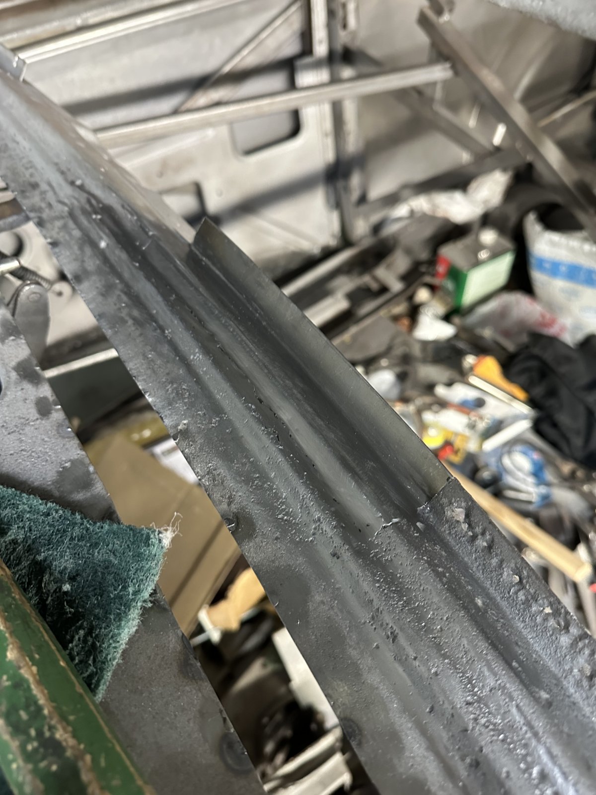

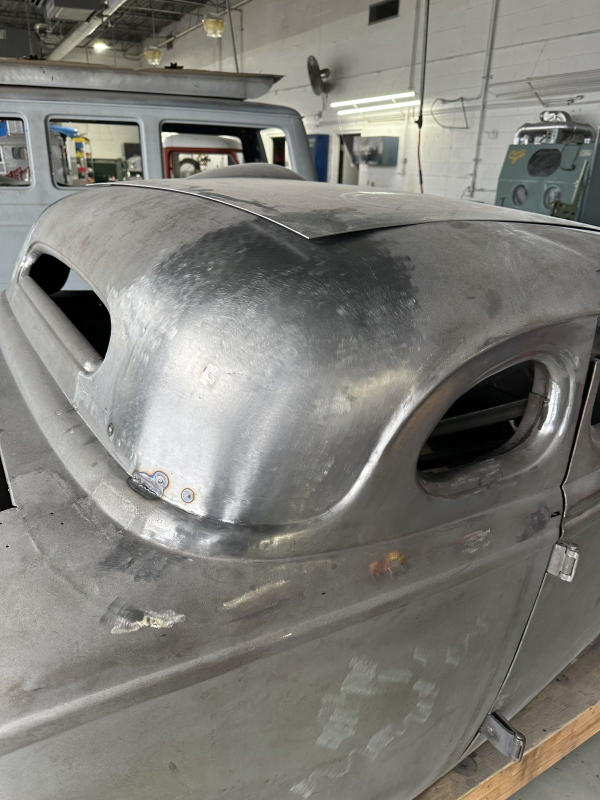

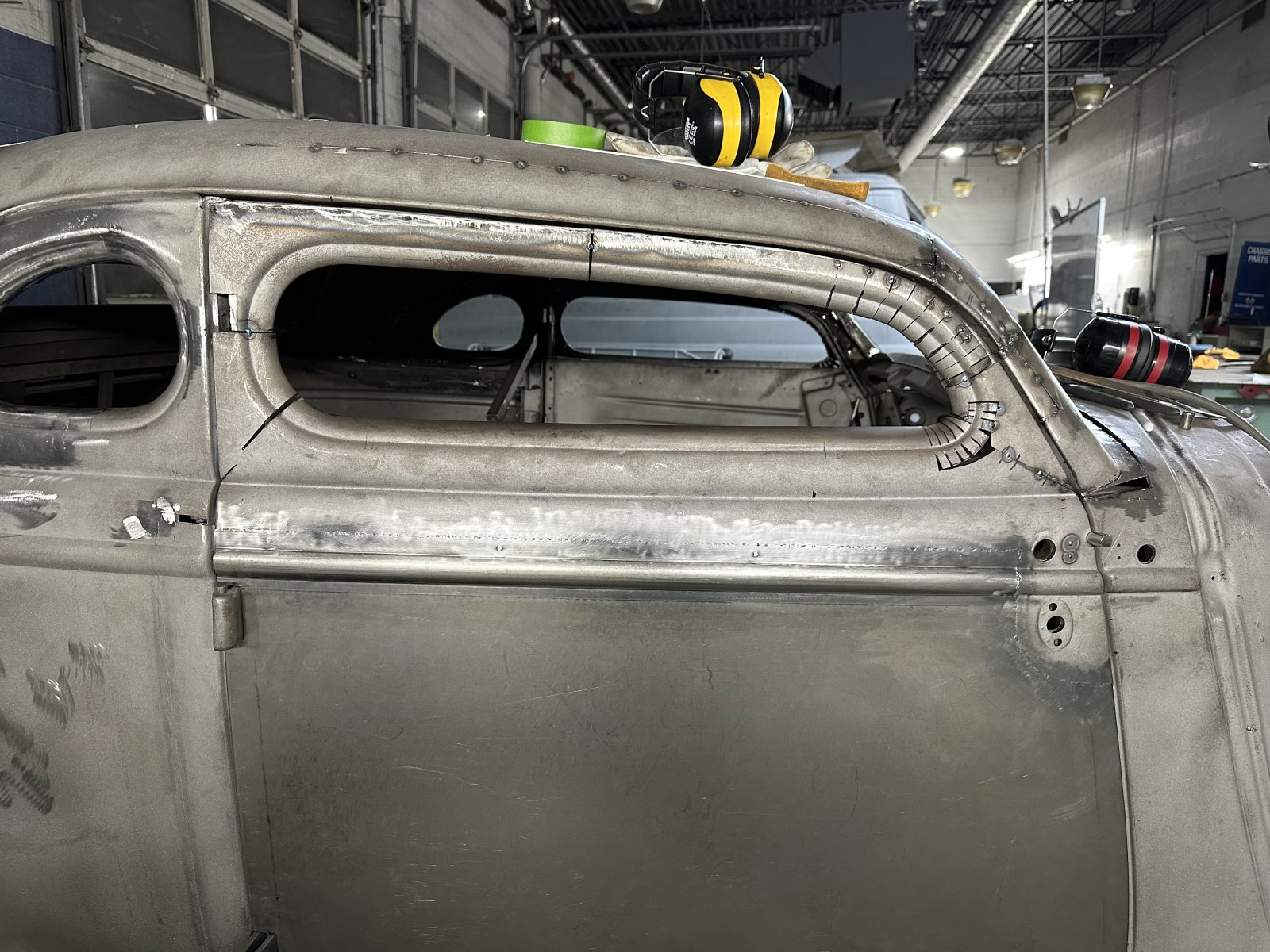

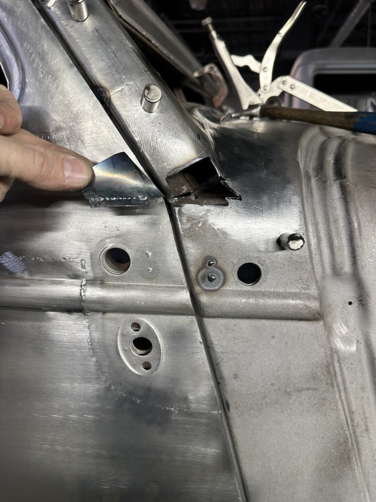

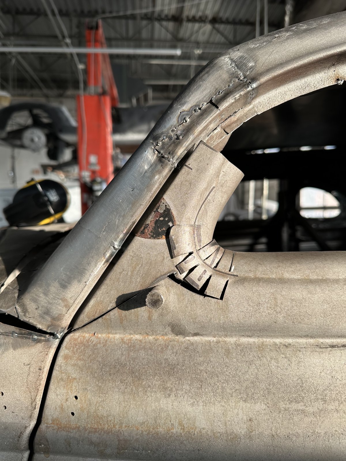

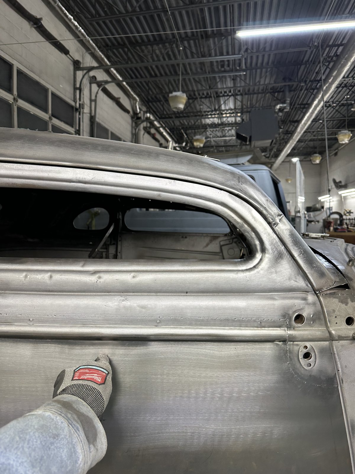

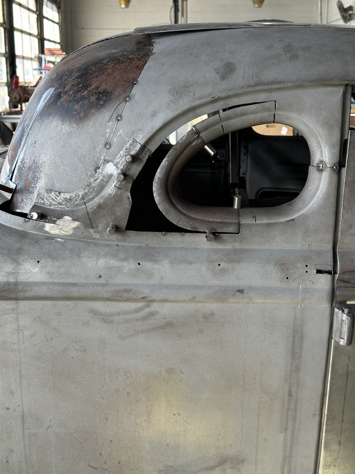

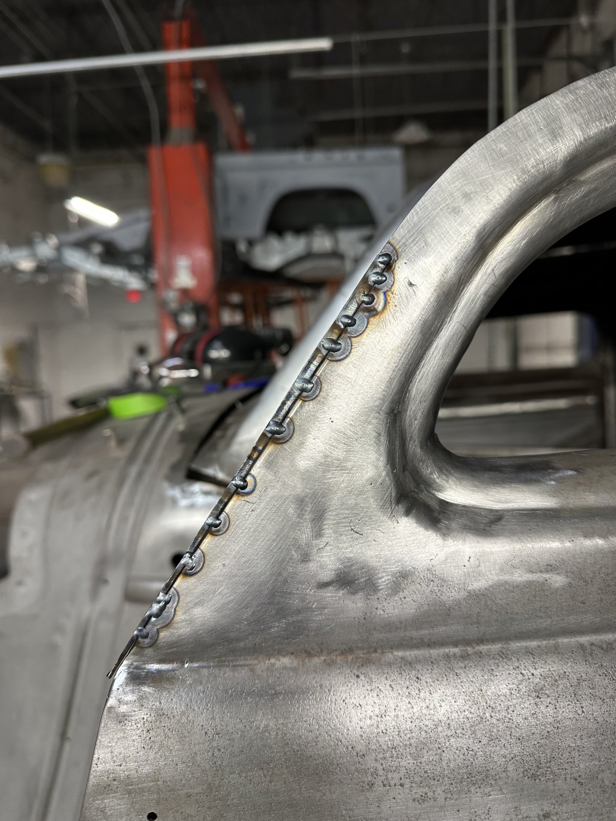

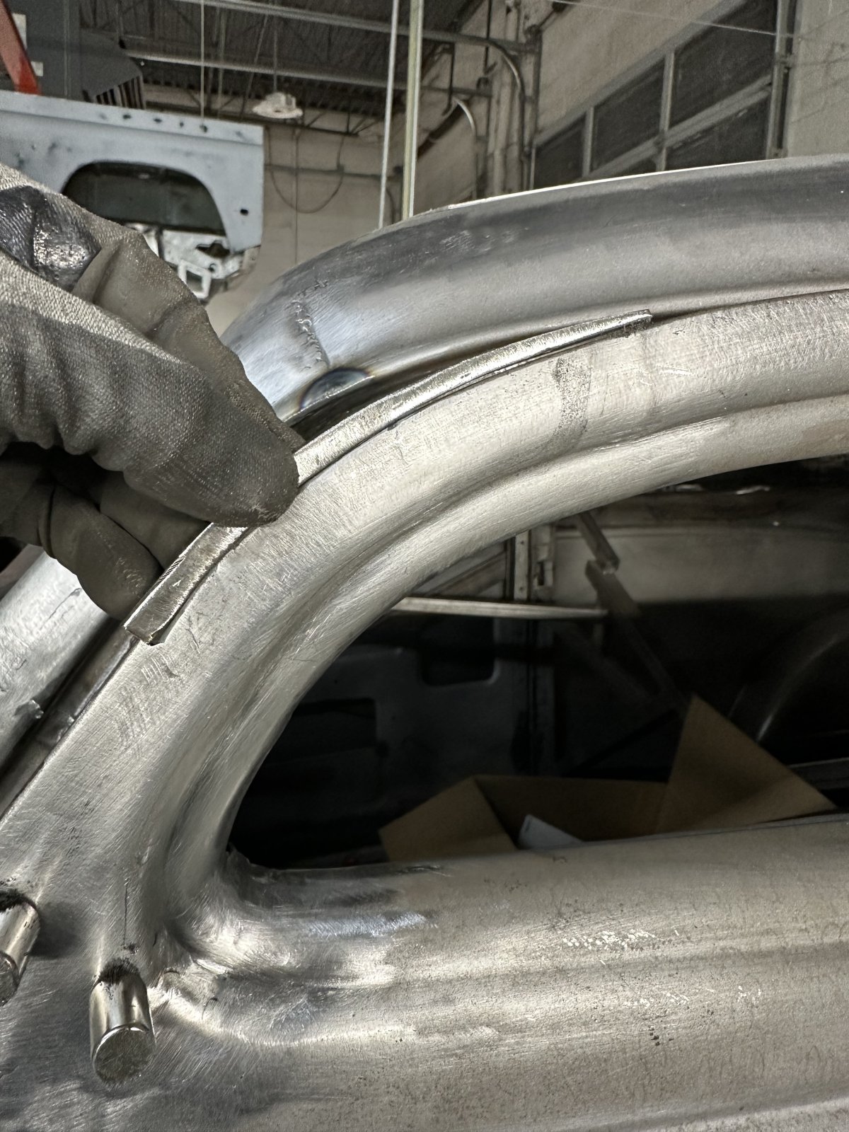

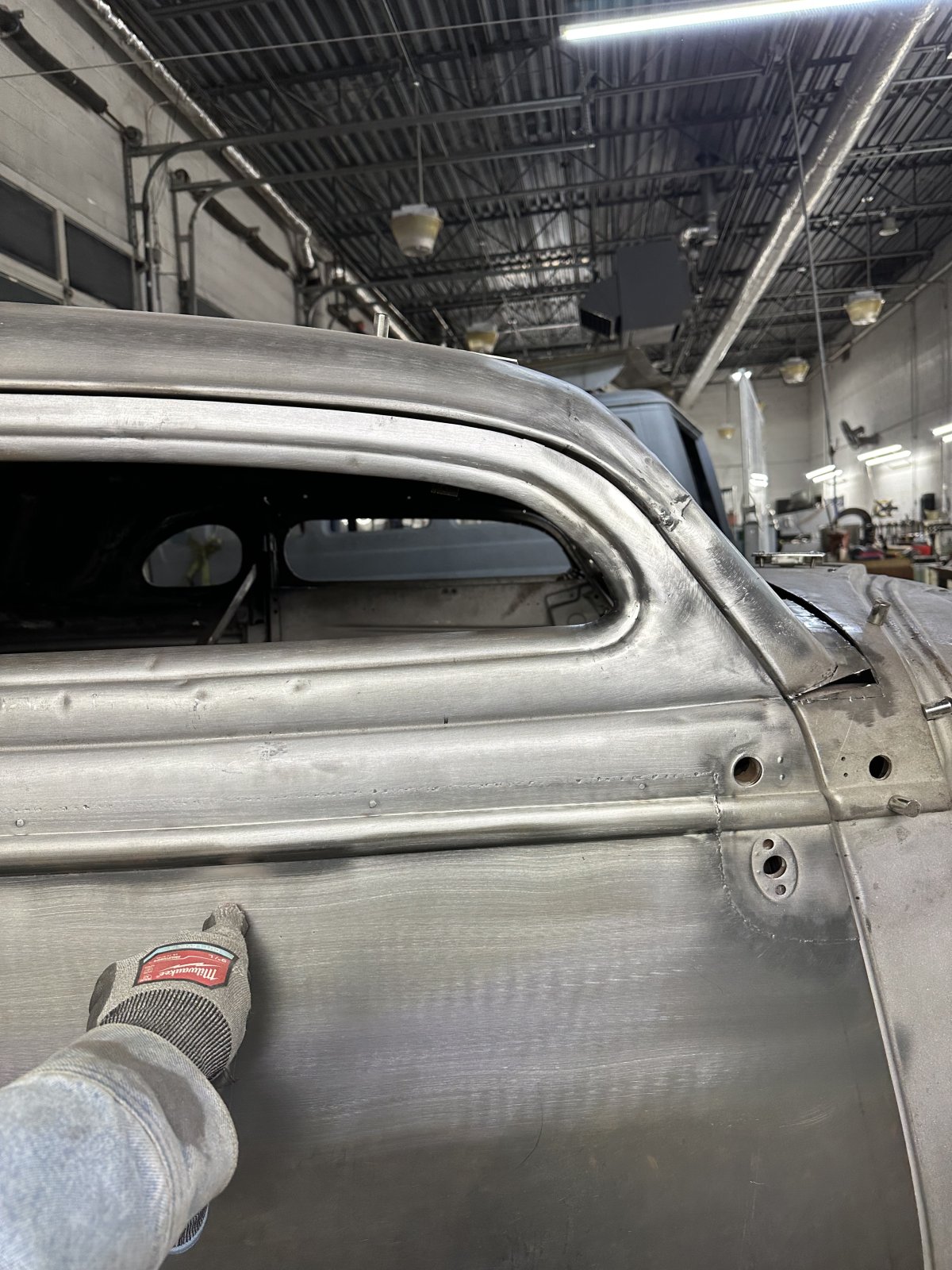

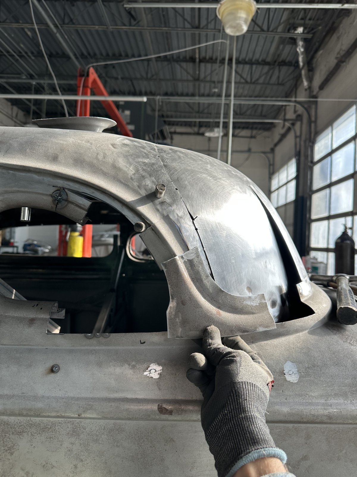

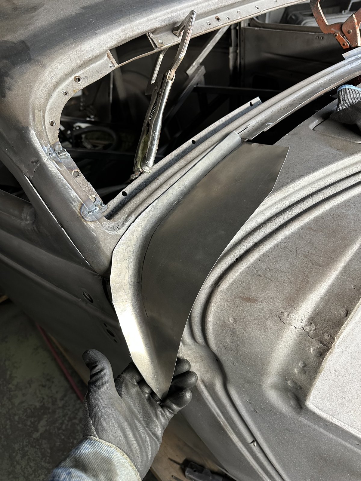

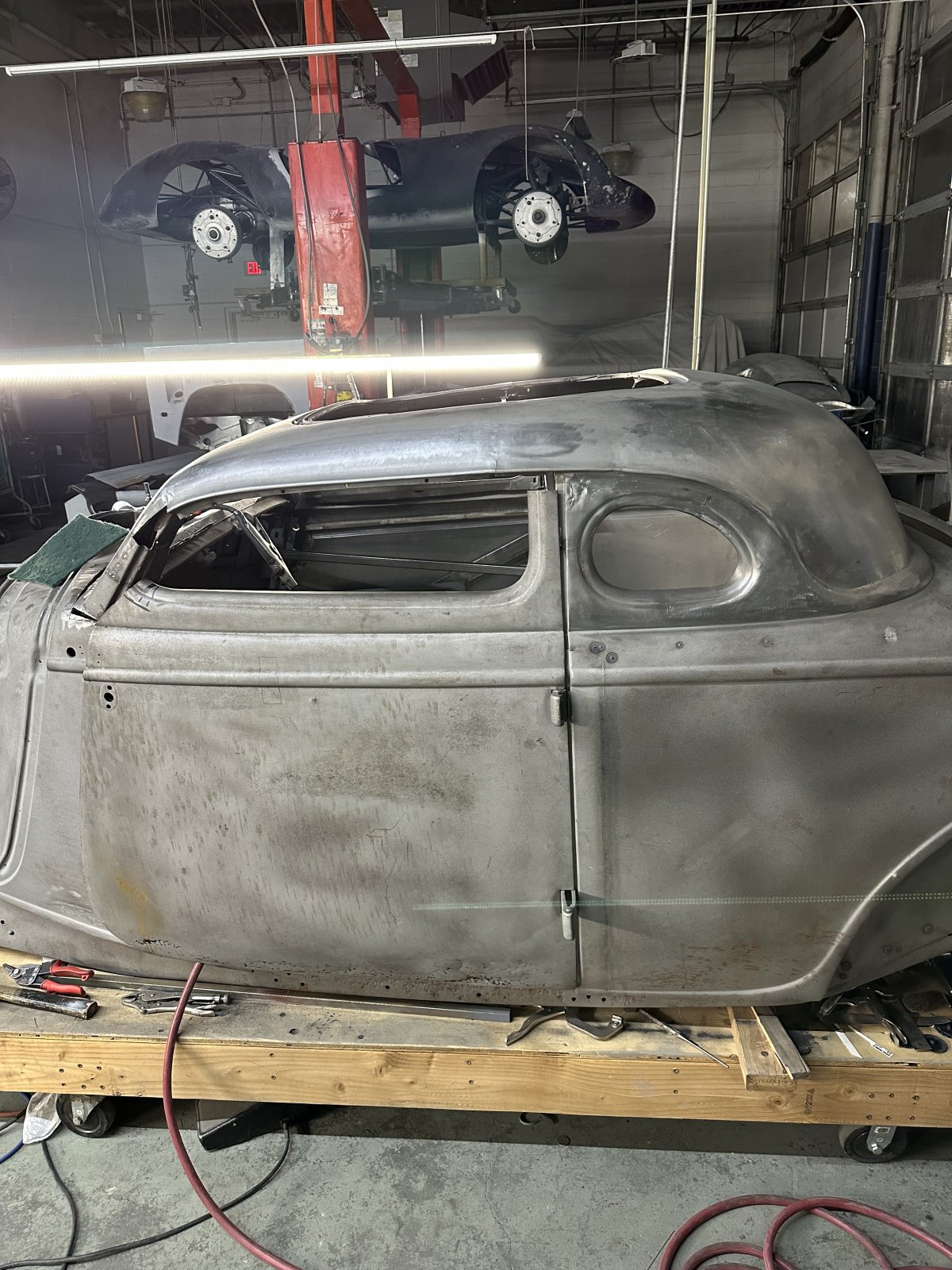

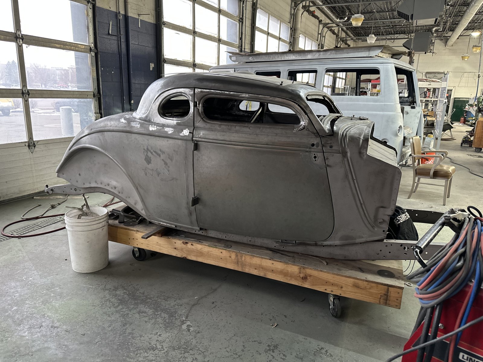

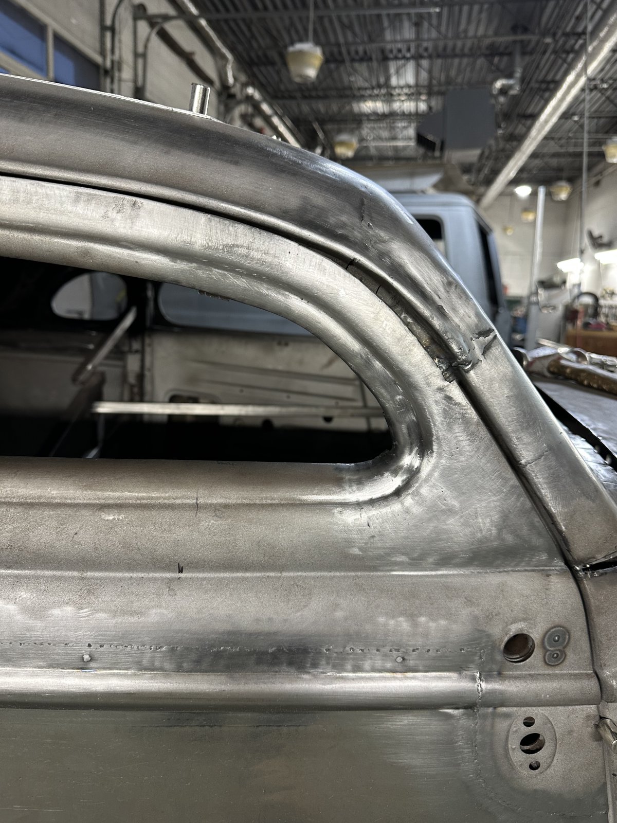

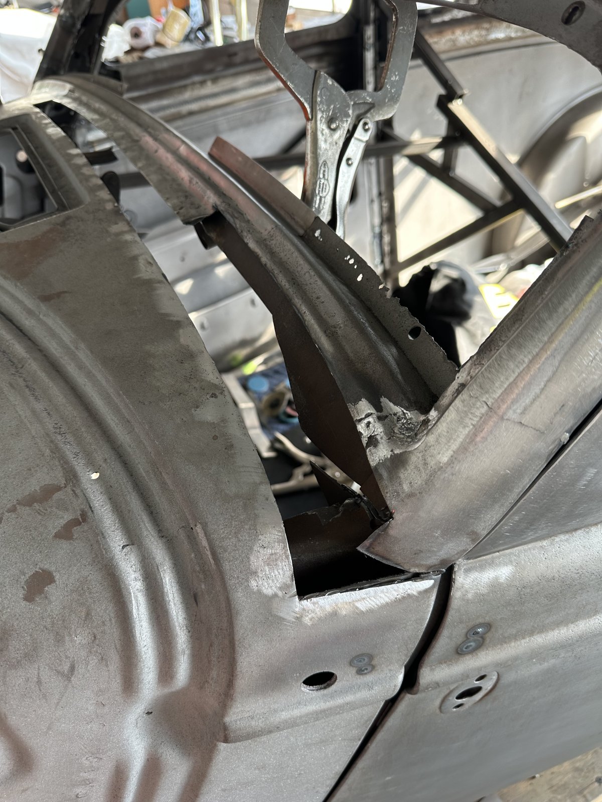

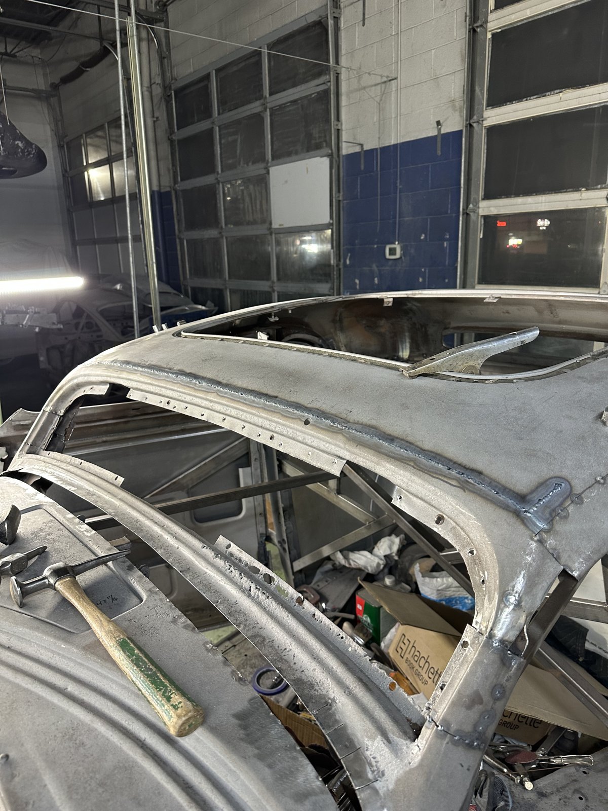

    14FBDDEA-6F98-4827-AC6E-EB9E20E0A65D.jpeg 3269DD8A-85E1-418A-9DFE-F3CB3D22467C.jpeg B38E7B4B-2486-4CB4-B69F-E511D35A8147.jpeg

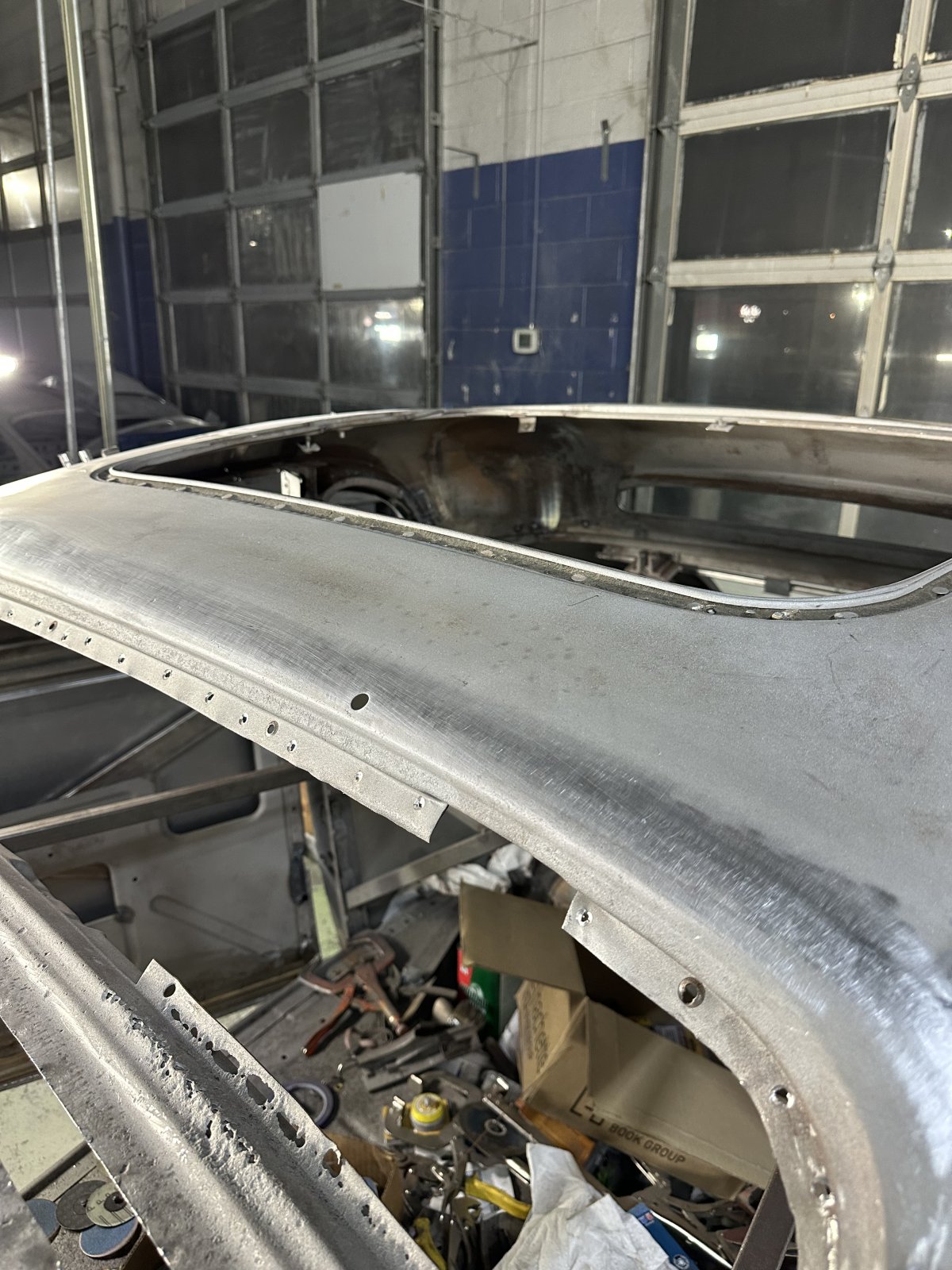

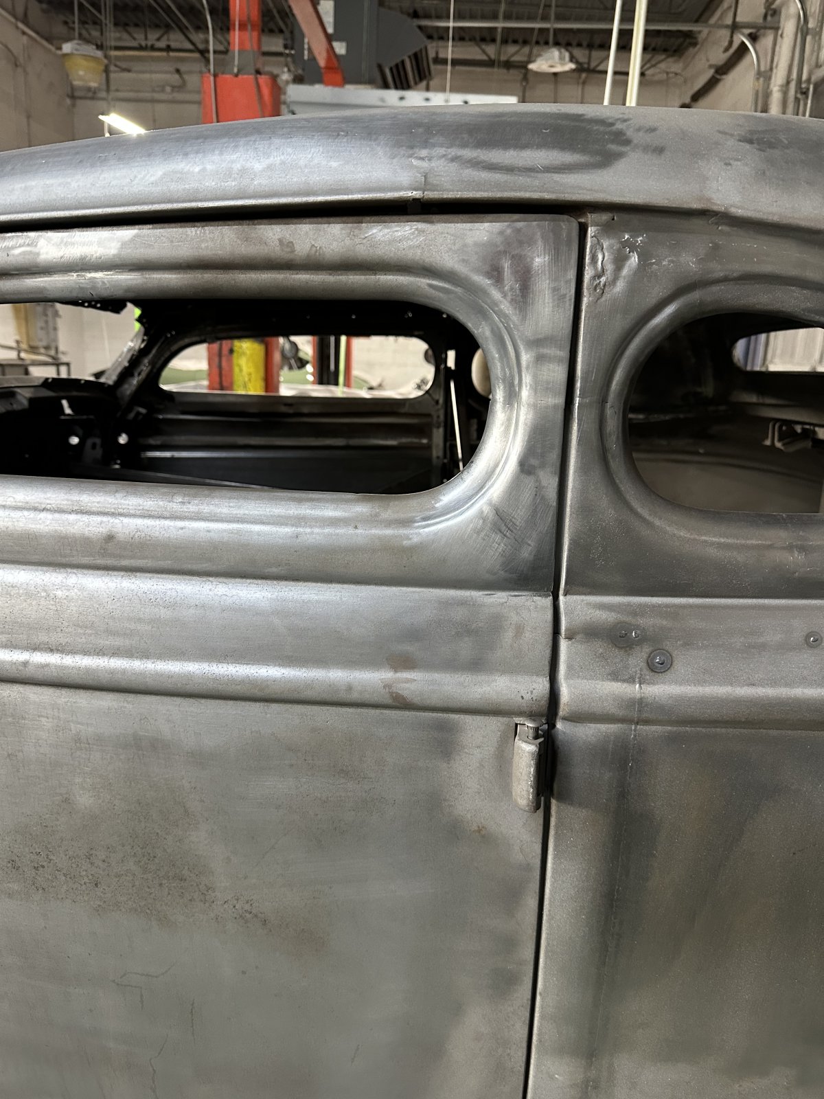

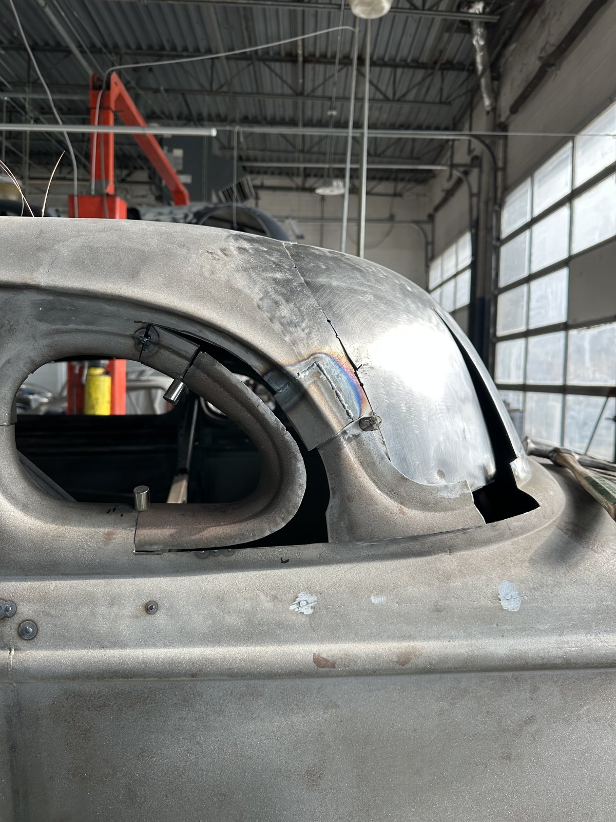

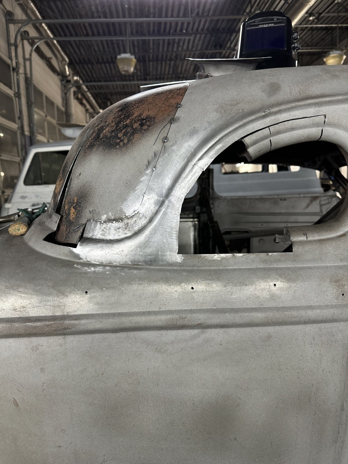

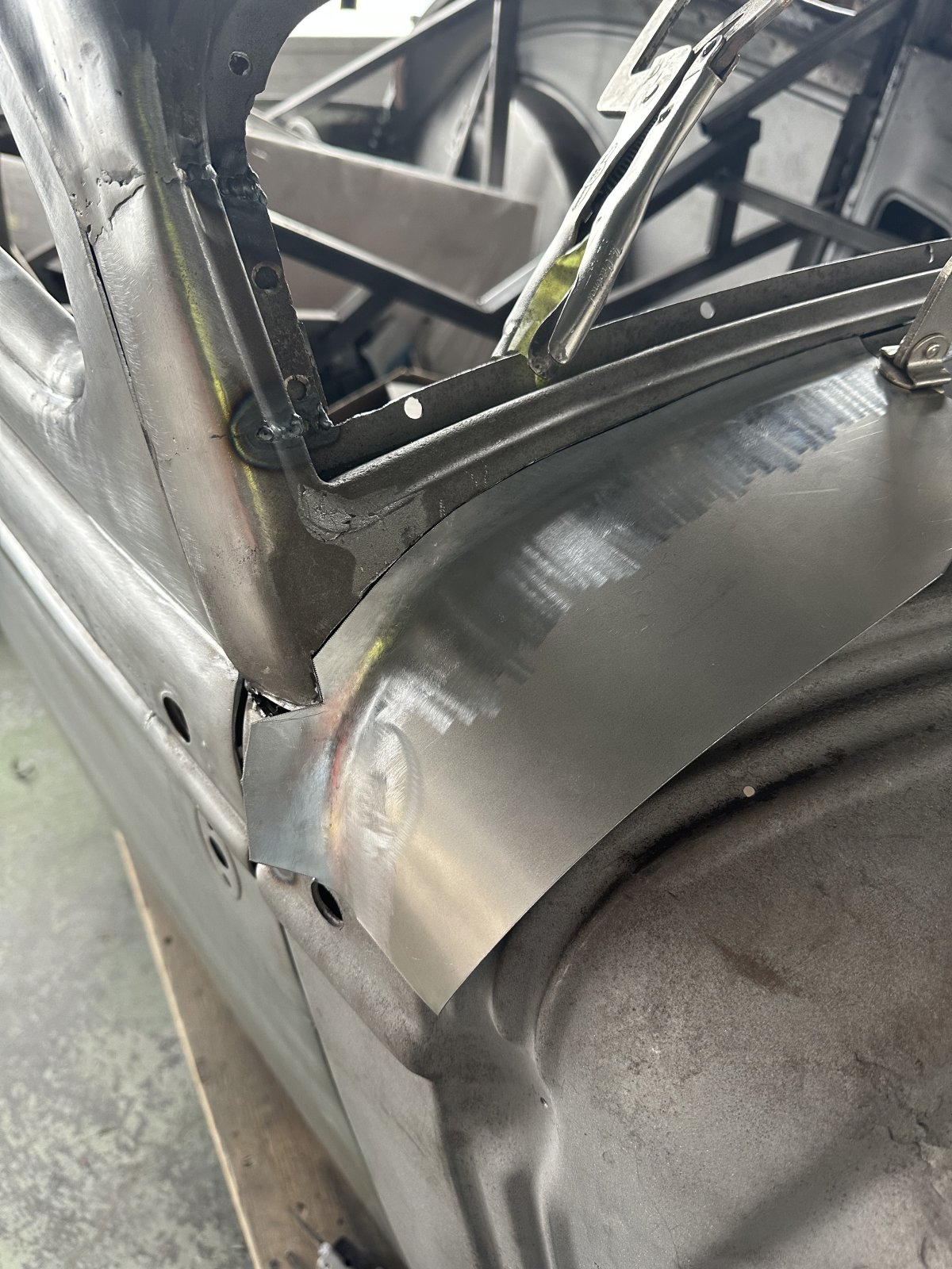

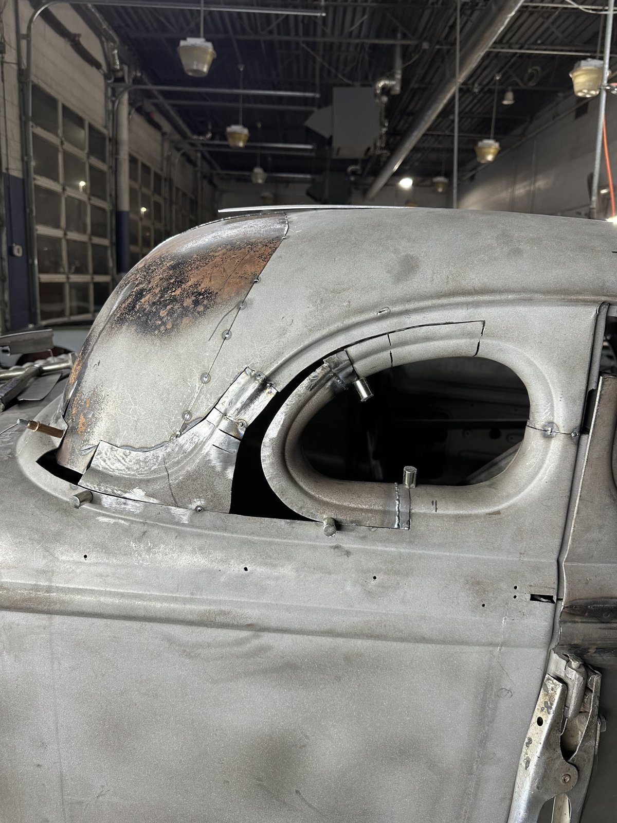

    getting started on the quarter window. 67E1070F-6DE7-4931-98F5-CE88D3DB7775.jpeg 0A5C0B9F-580E-4D65-88FC-226AF840F51C.jpeg 67E1070F-6DE7-4931-98F5-CE88D3DB7775.jpeg

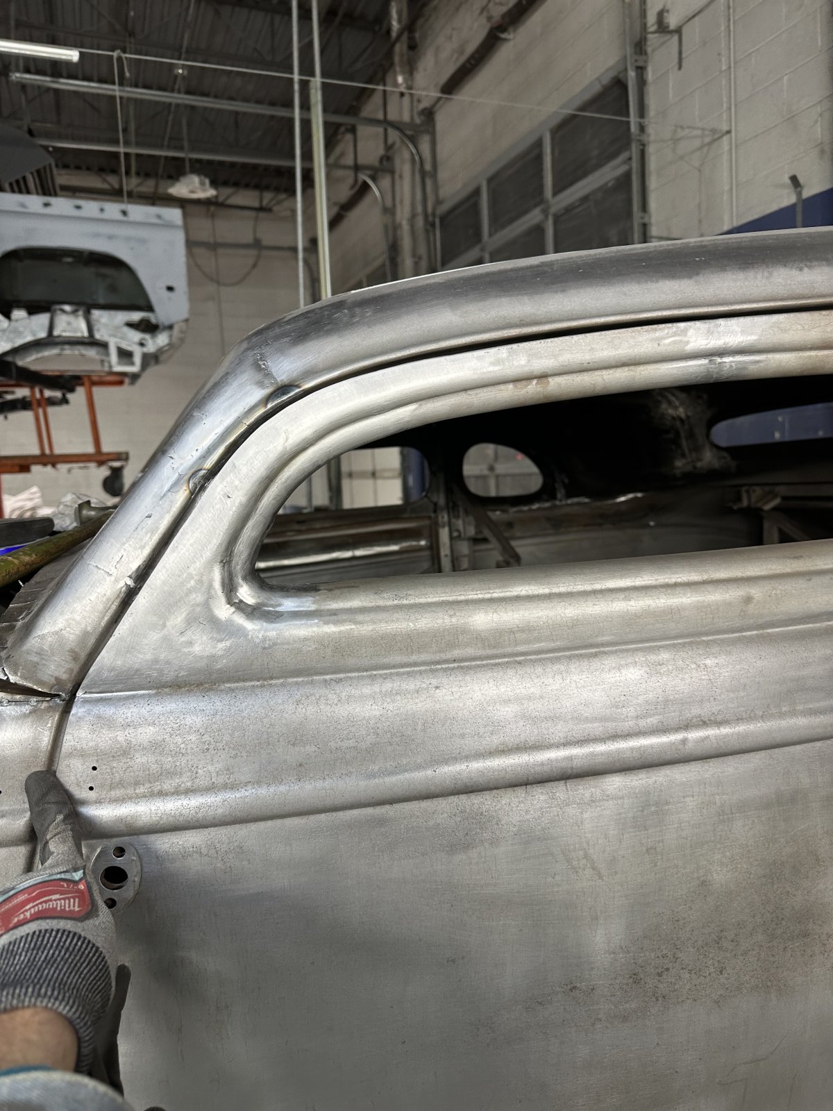

    Making a small transitional piece to fade out the drip rail. AD965942-DDA3-4C54-A355-EE23760D3DD8.jpeg decided I didn’t like the gap between the drip rail and the window so I added a little more on to the window.
    679A96B1-F11D-46E6-8AF0-918354265981.jpeg 630A5E0A-7603-4179-9999-F390E54E8F58.jpeg 8A08FFDF-E283-48F6-9368-B2AF3A2CB05B.jpeg 634E72BF-7209-4950-A726-A943FDFEF4E3.jpeg 768D934B-0F0A-4133-80C1-AE460F35C516.jpeg 53152573-B454-4EF6-AE91-4E61FDAF958B.jpeg
    still have a few low spots in the window to planish out but I think it turned out pretty good. Now gotta finish up the other side.

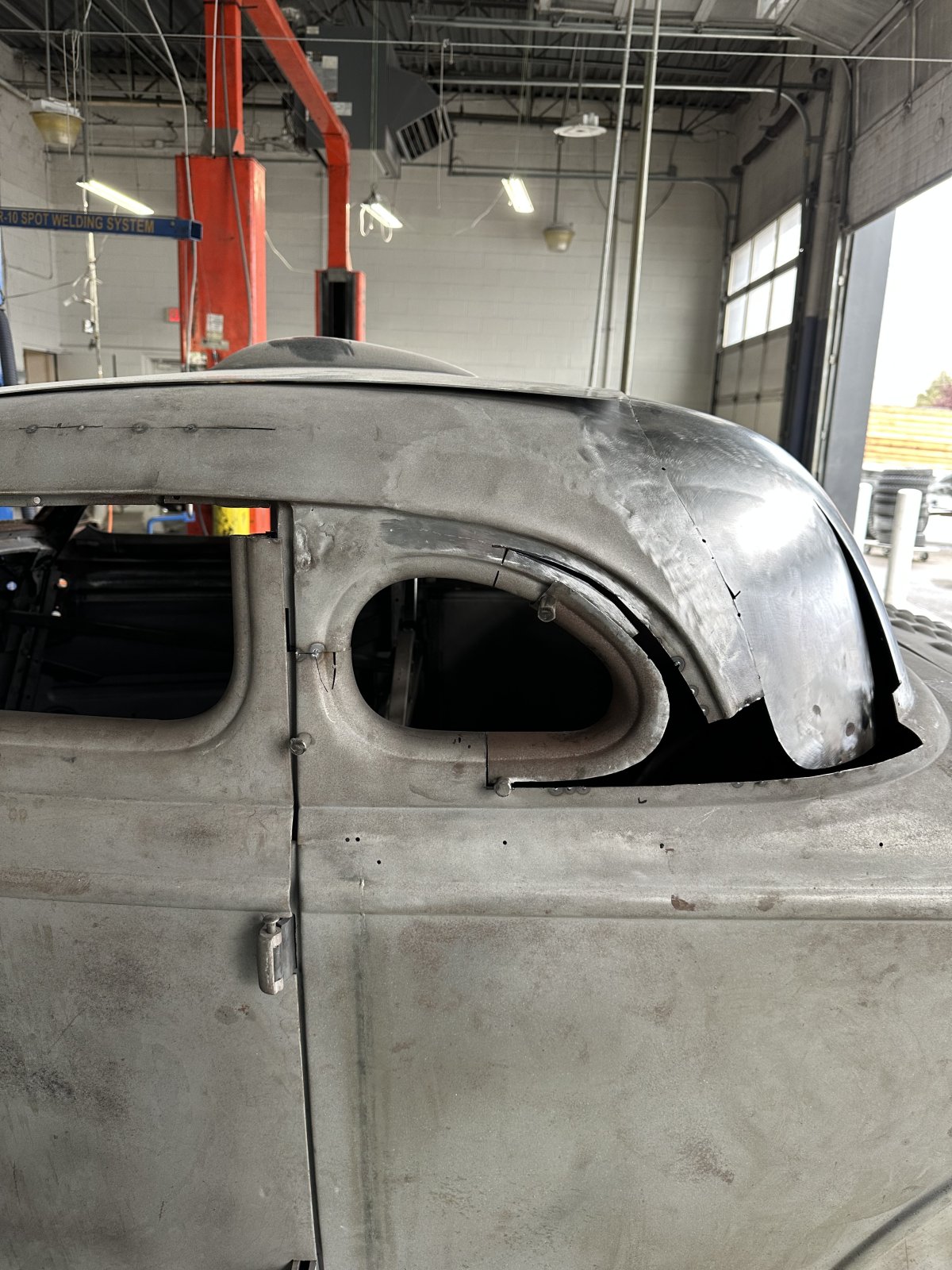

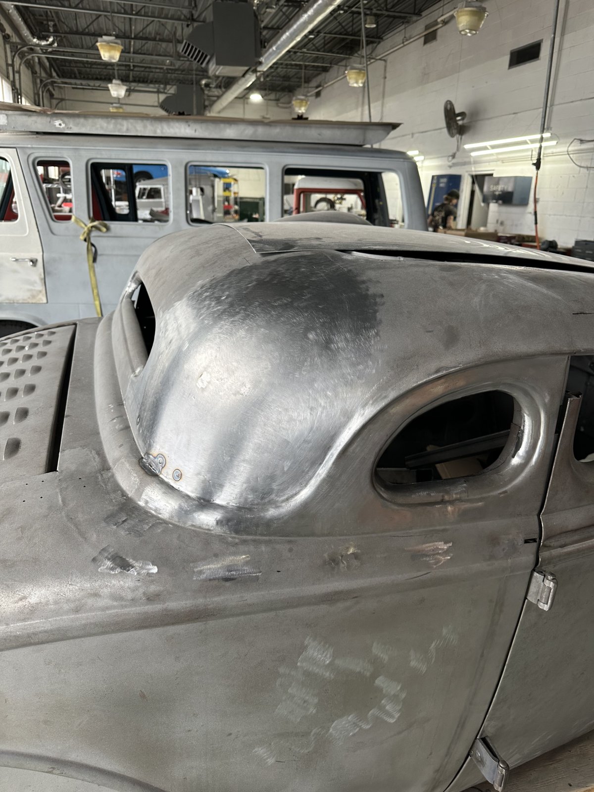

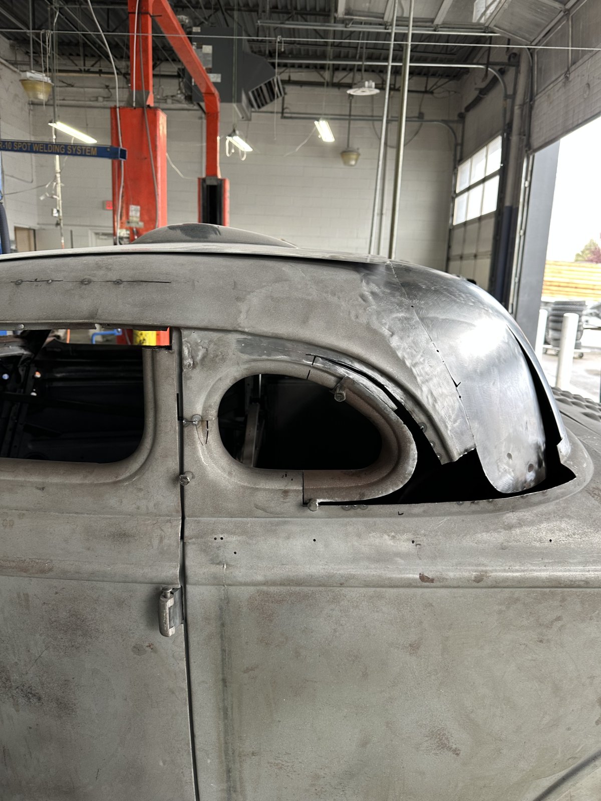

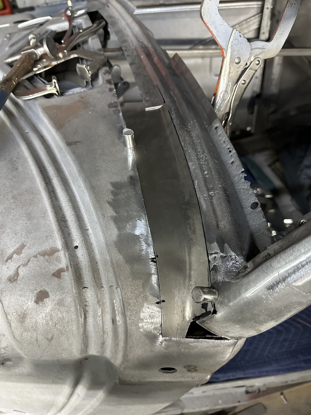

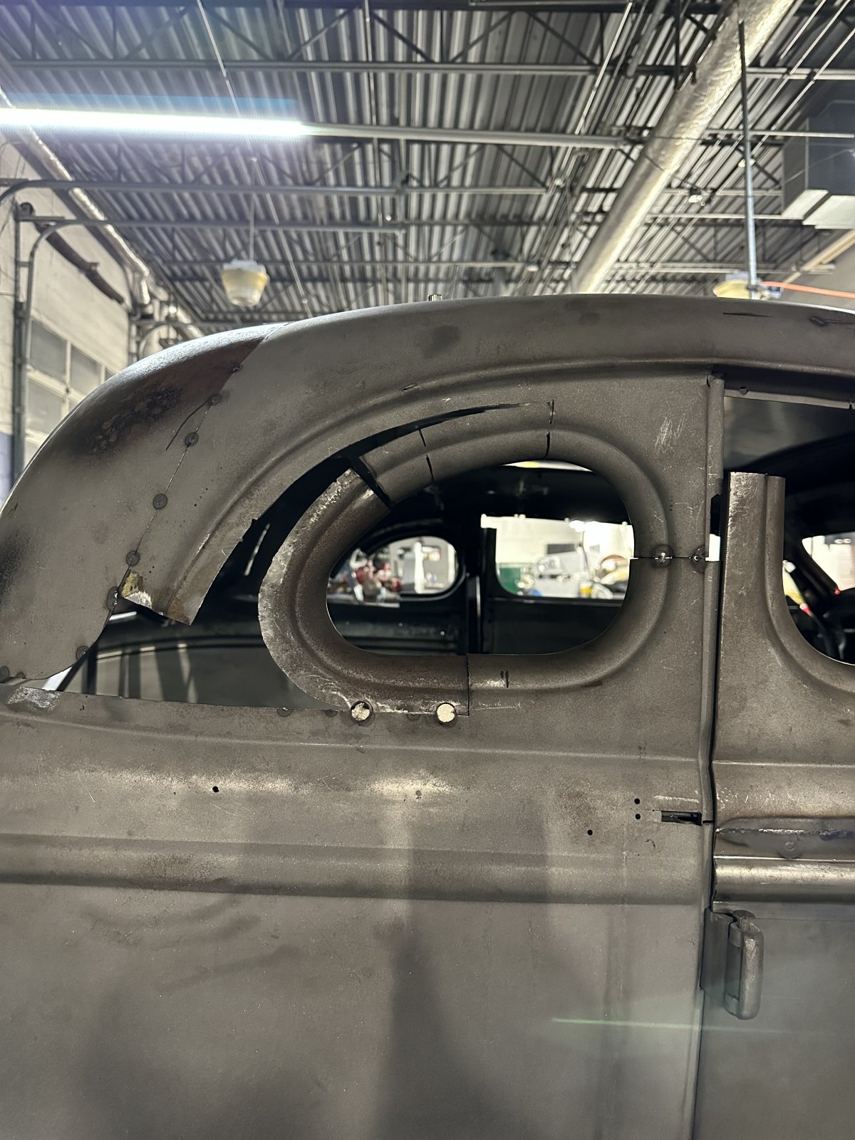

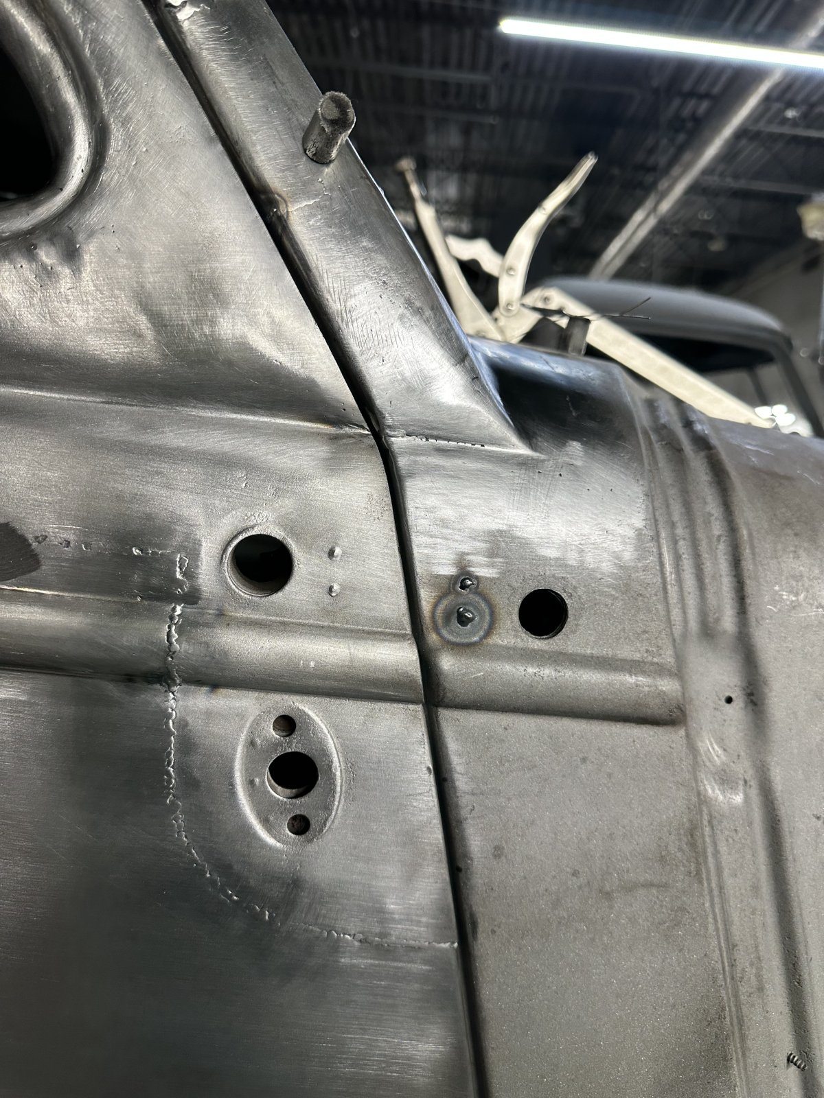

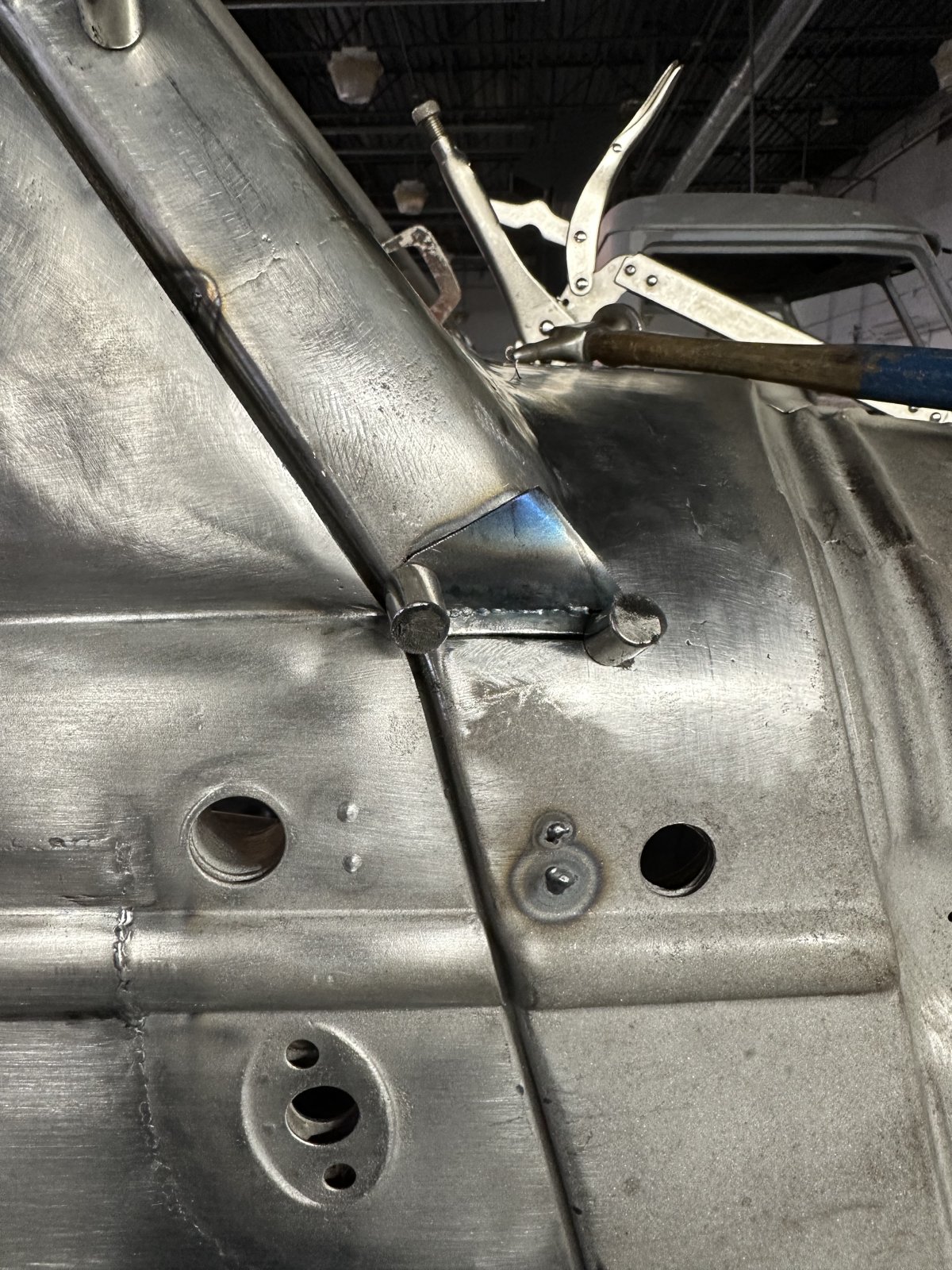

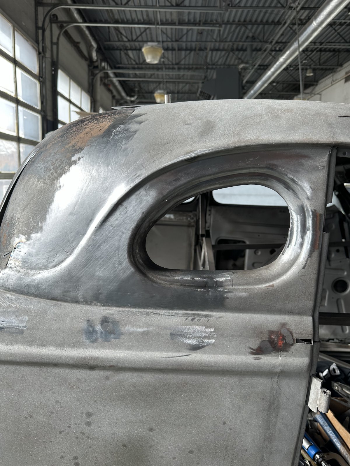

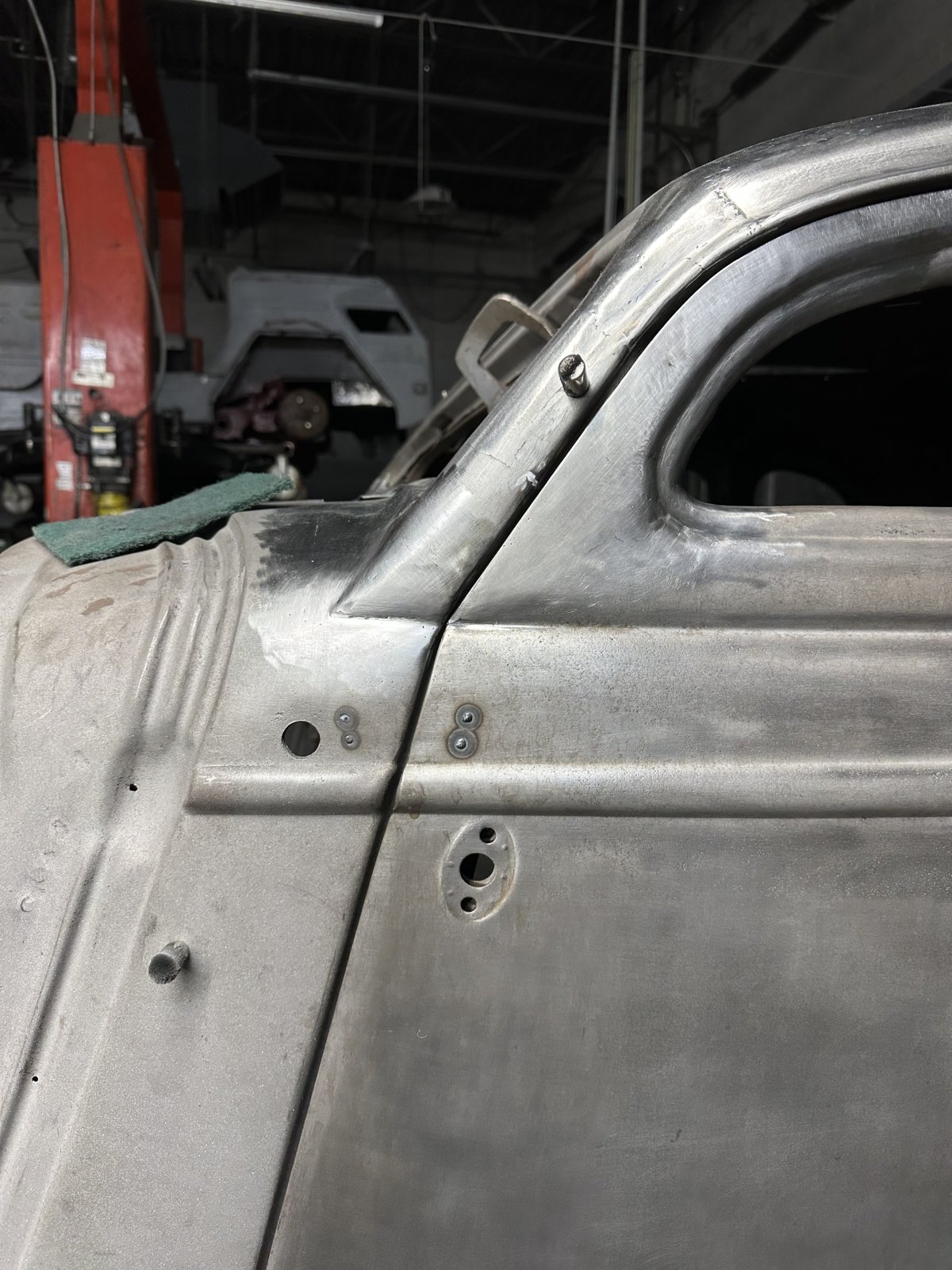

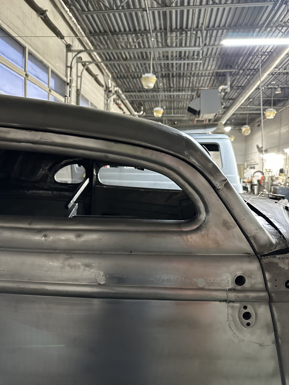

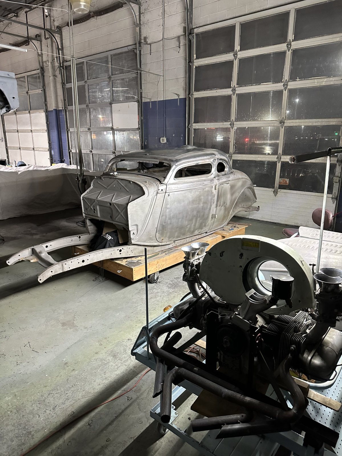

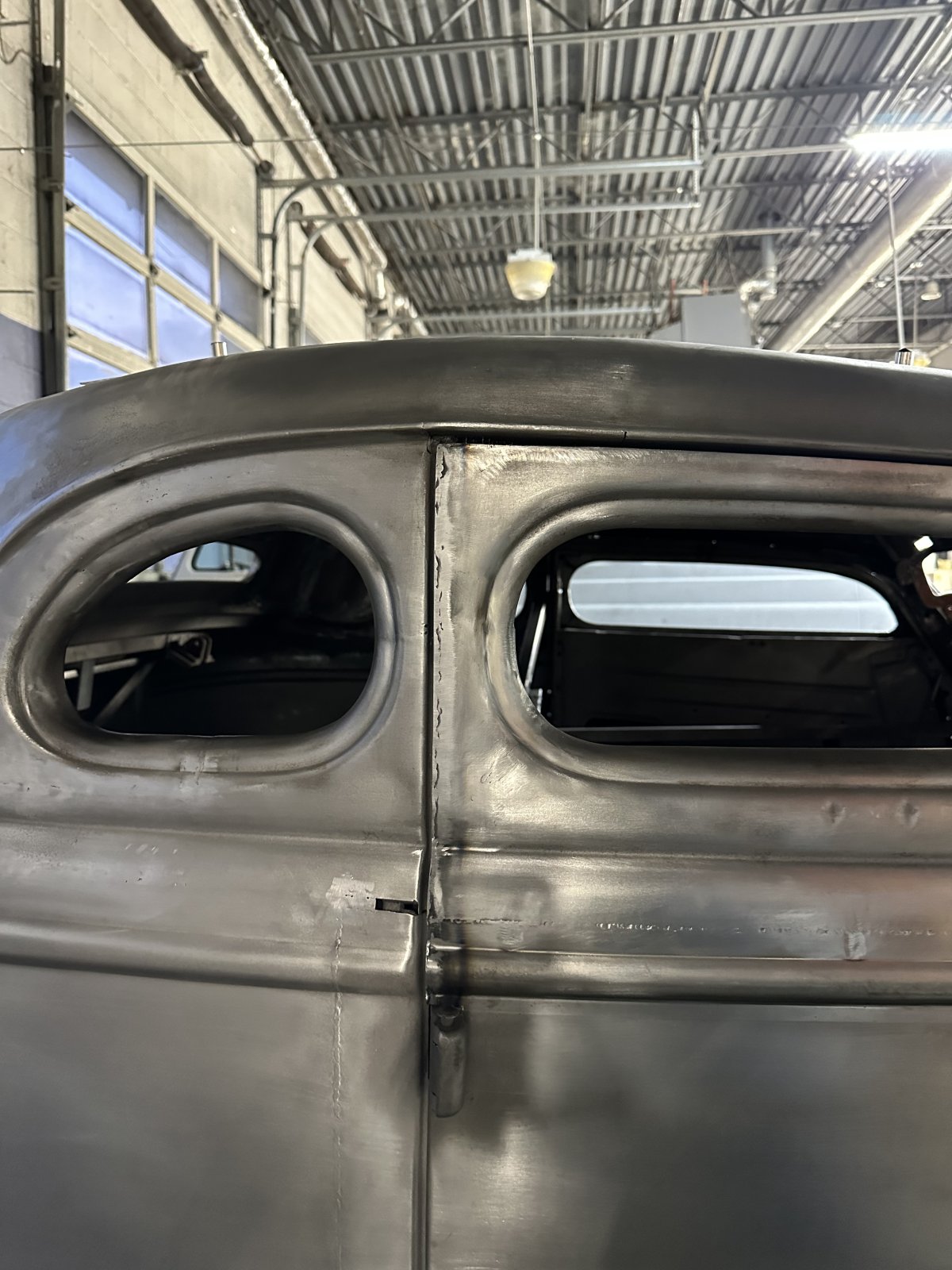

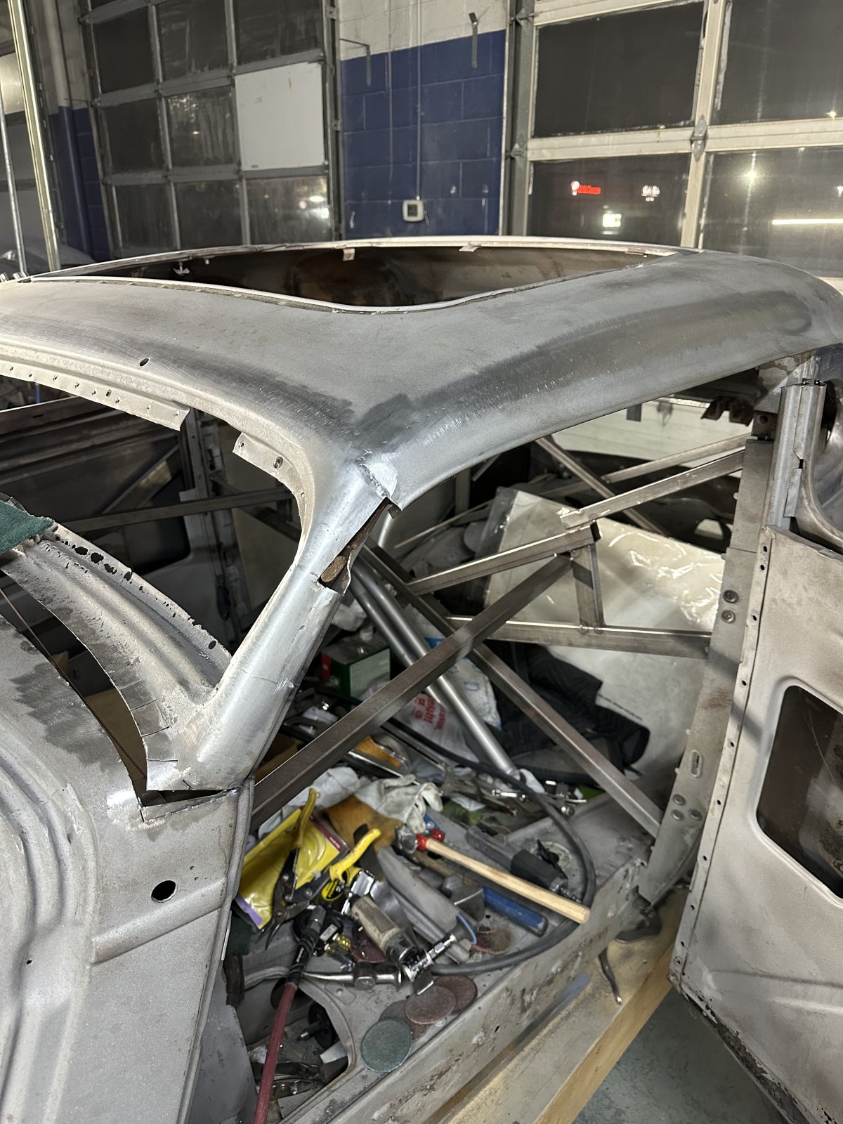

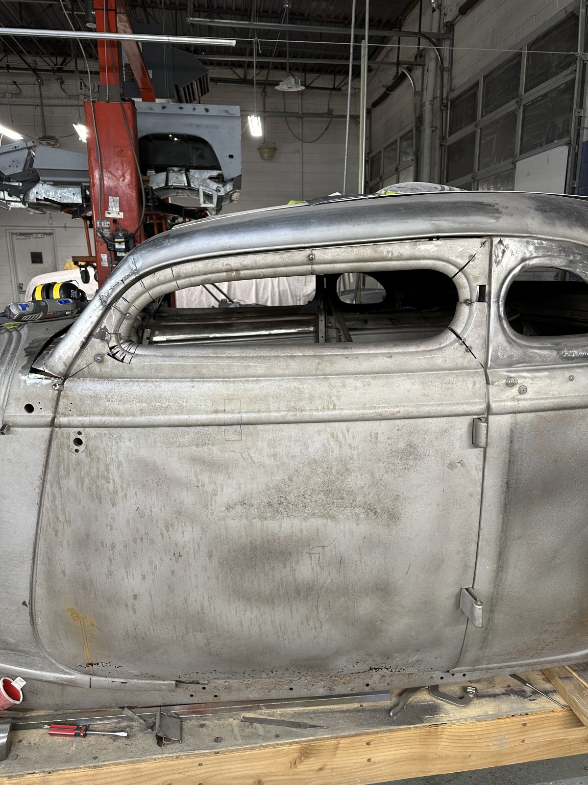

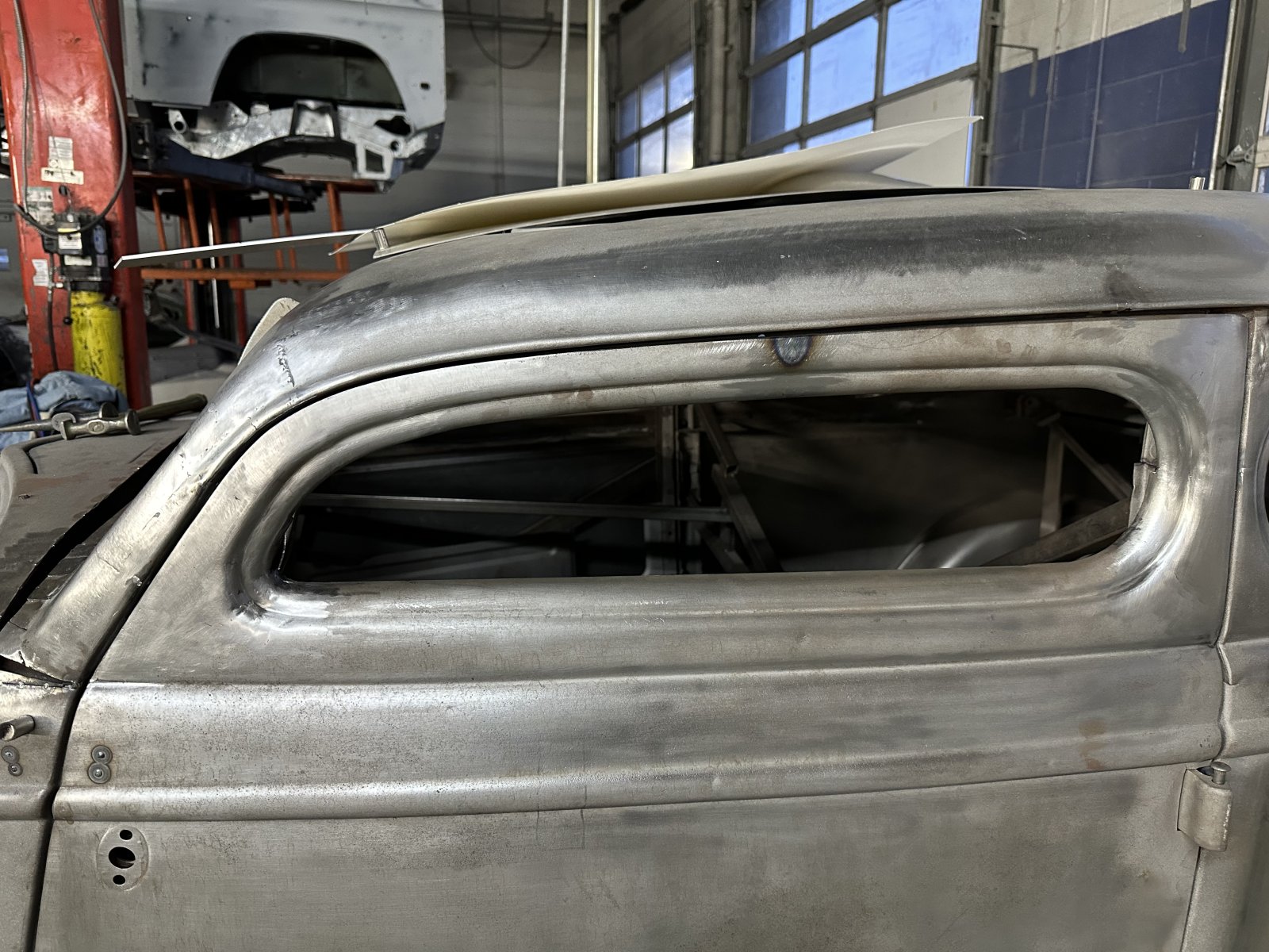

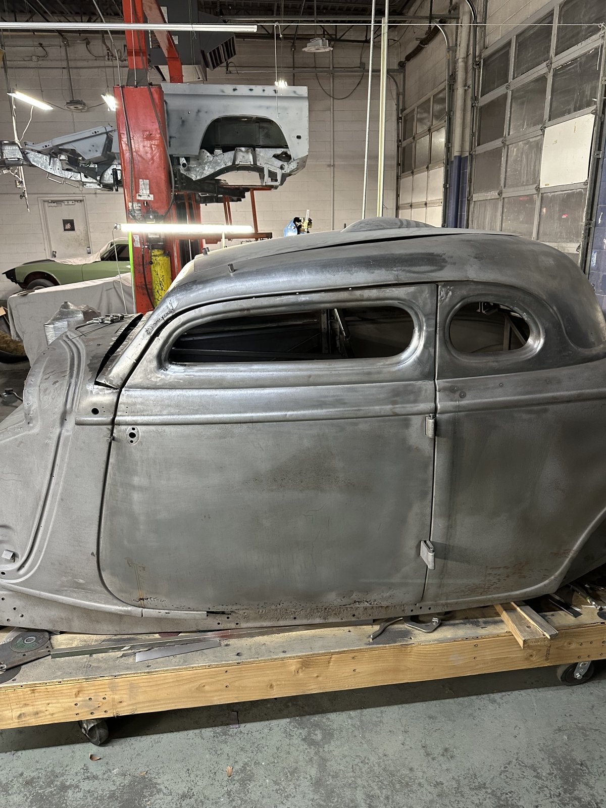

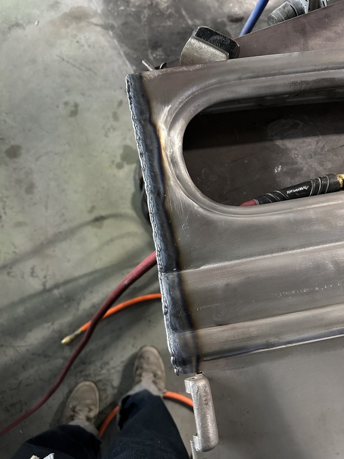

    3901A0F4-5DBB-494E-BC77-9511308E7682.jpeg 418EAF31-4966-4828-8AC3-B644F96A1912.jpeg

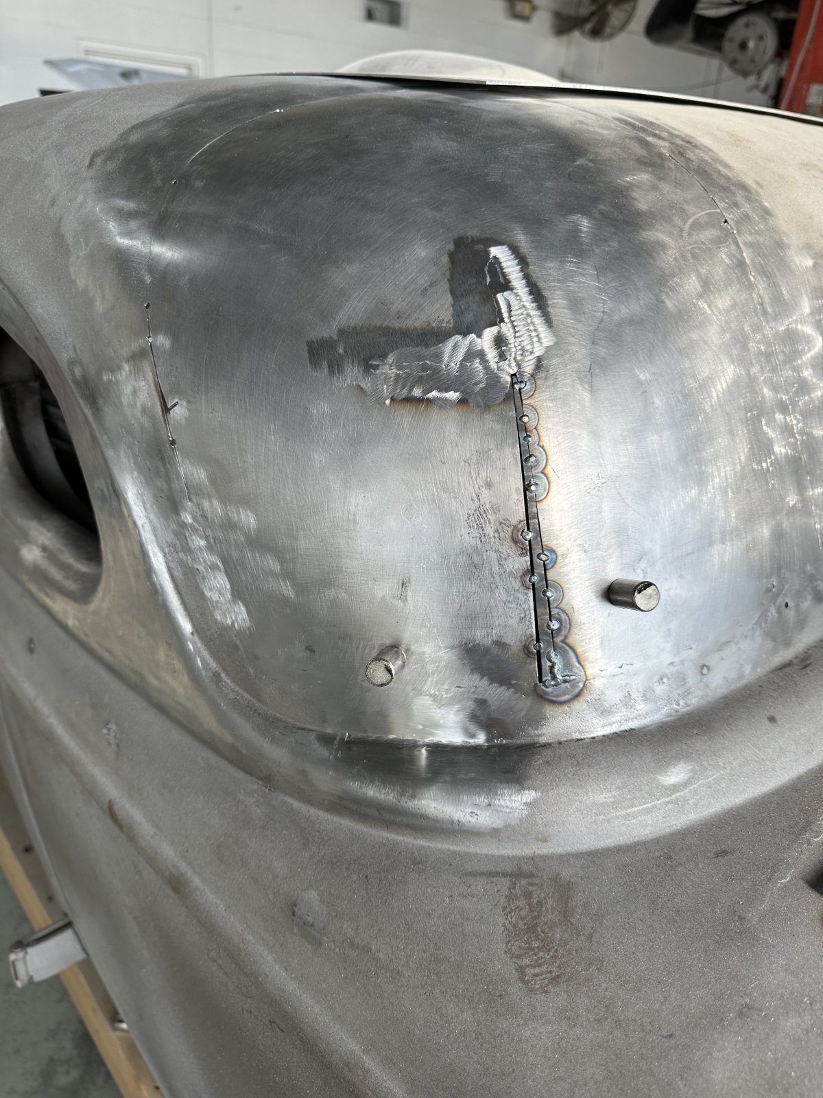

    quick update, was able to pretty much finish up the the back corner. Just have some touch up welds to grind down. C9BC6FC6-5115-407A-99EA-FE1C45884B17.jpeg Getting started on the other side. The damage to the top corner above the quarter window was original. Leaded over by the factory. I’ll have to go back over it with some lead at some point.

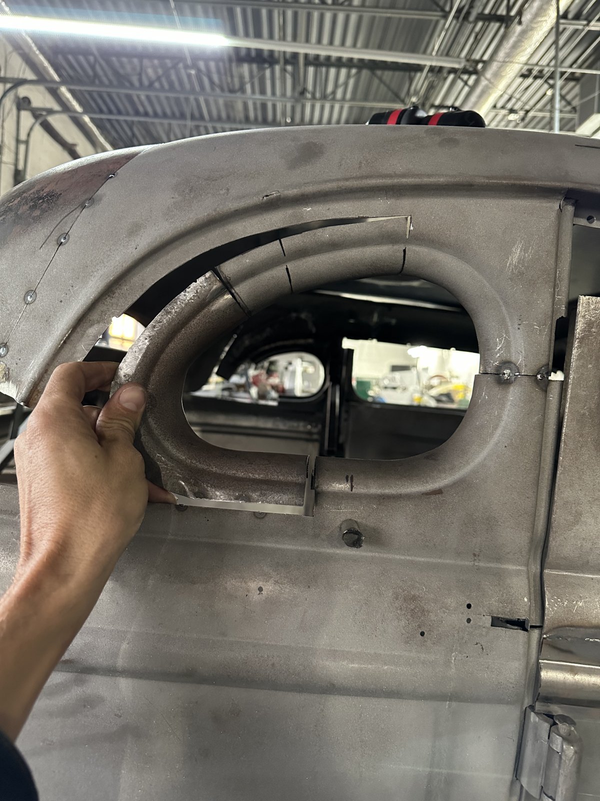

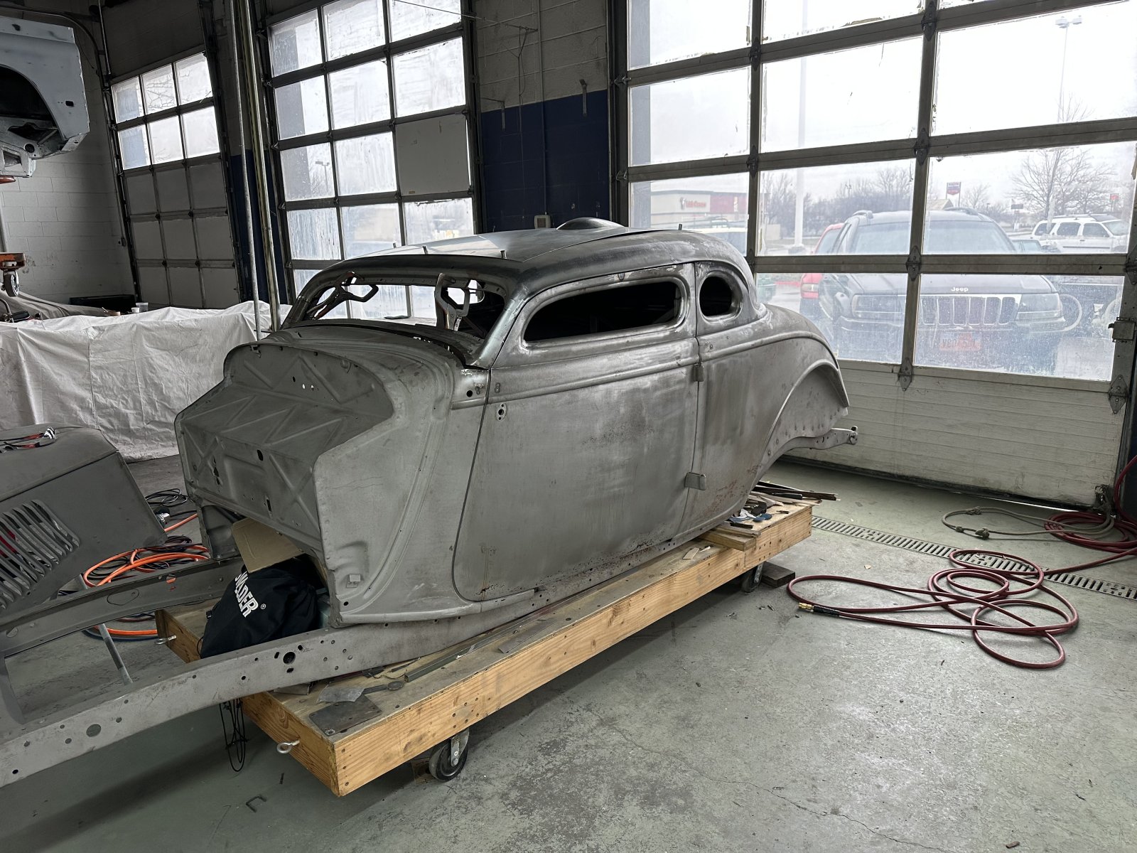

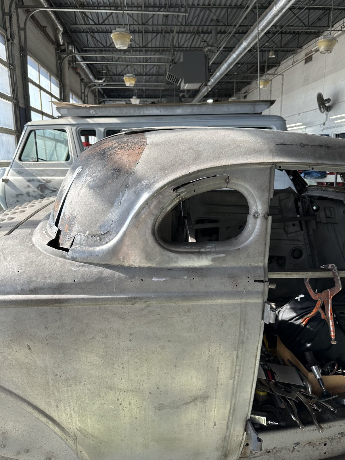

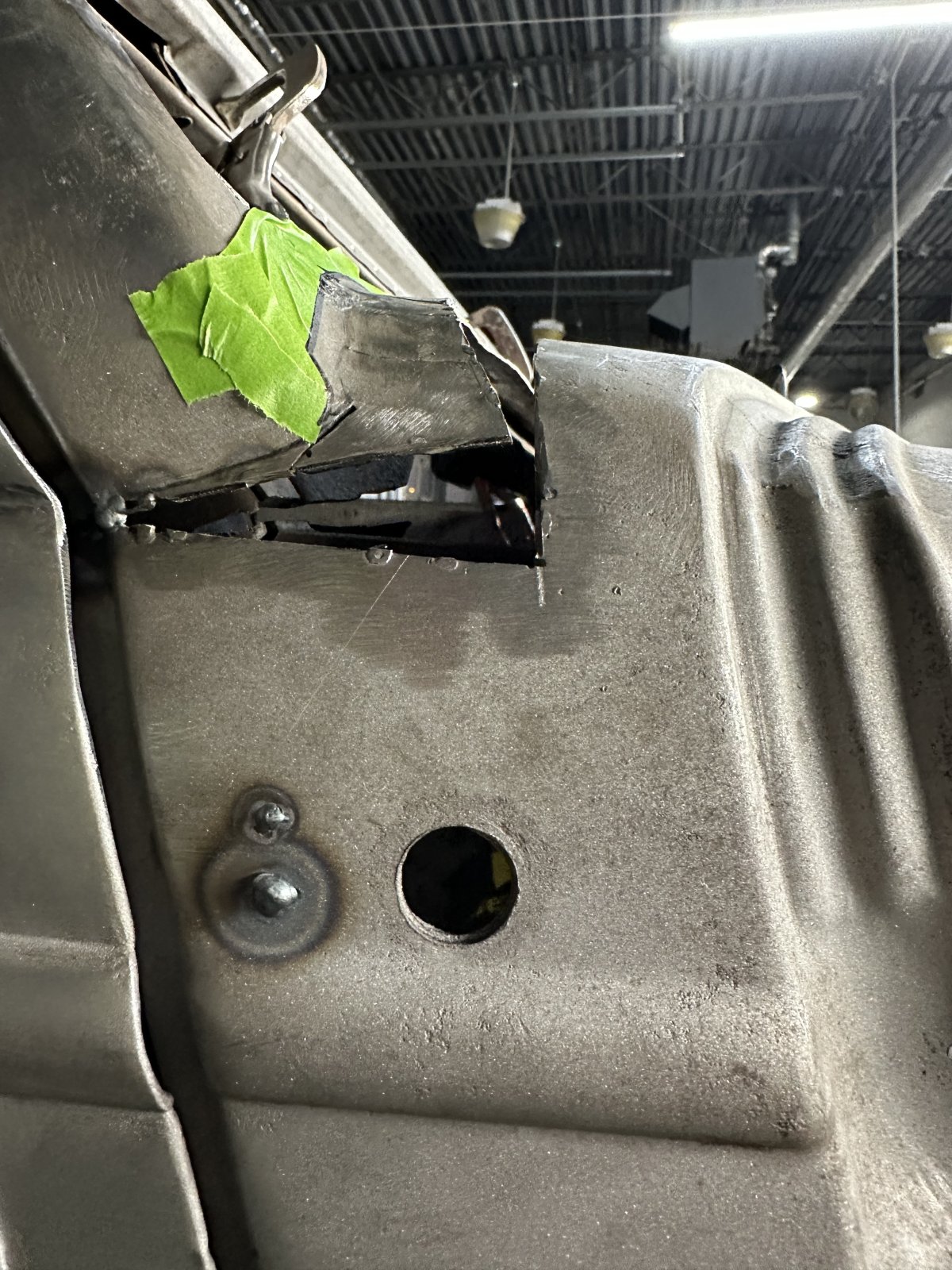

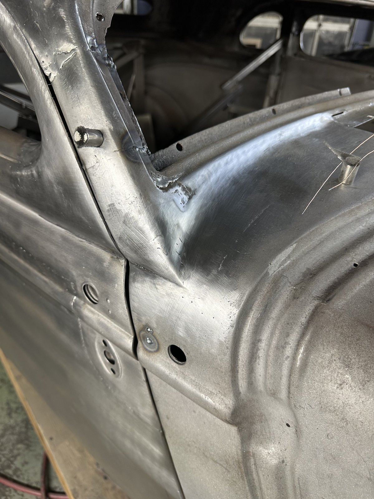

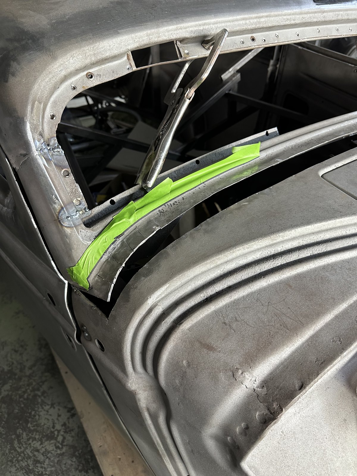

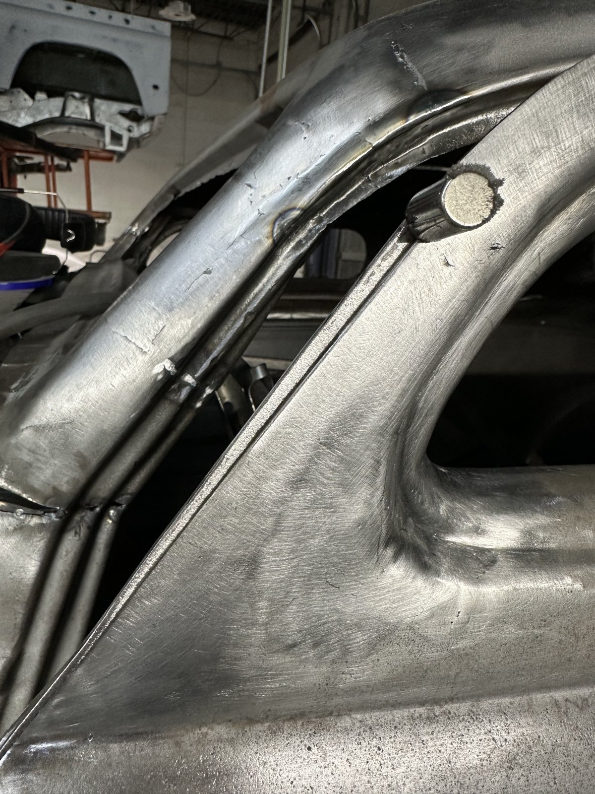

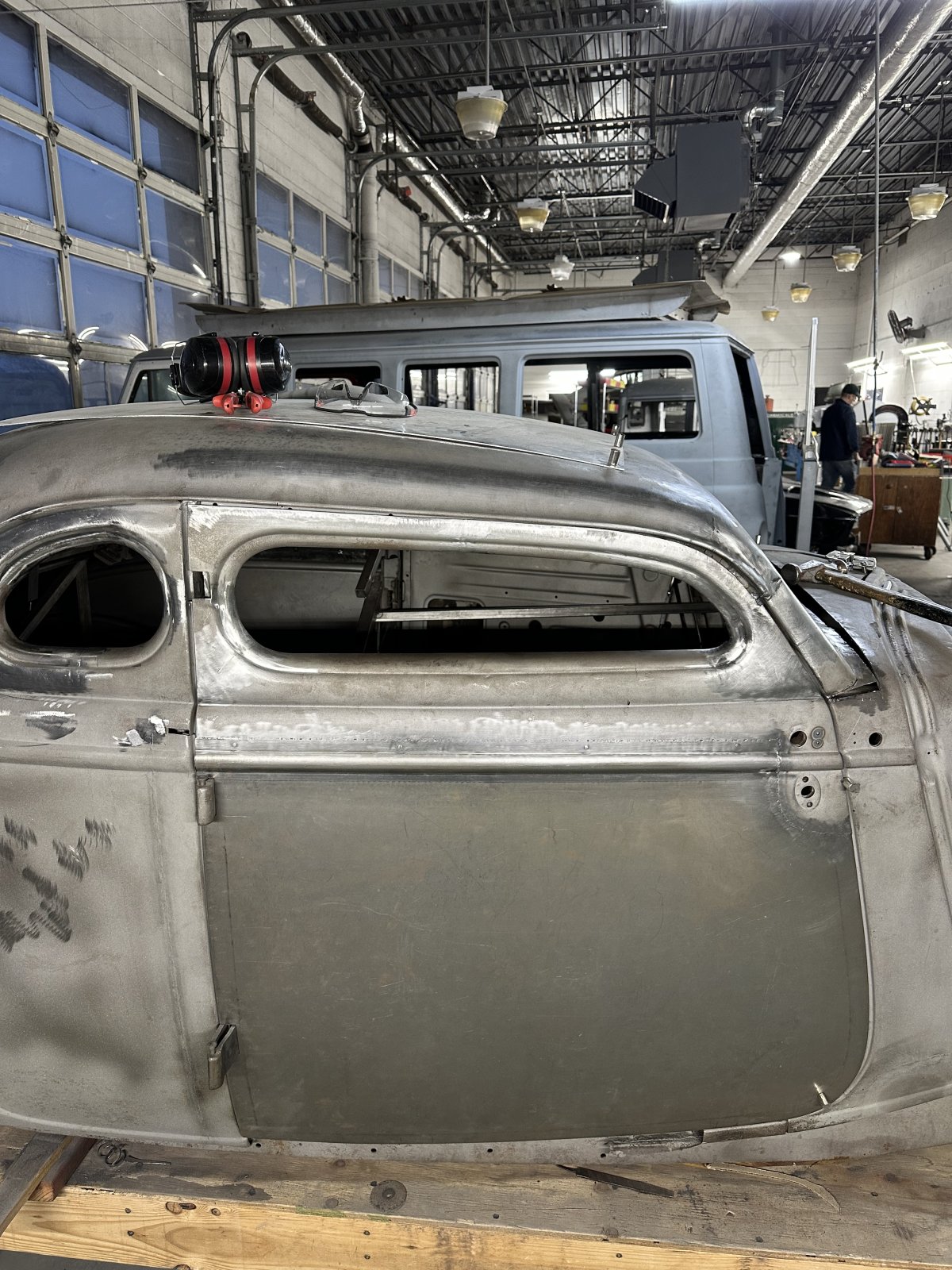

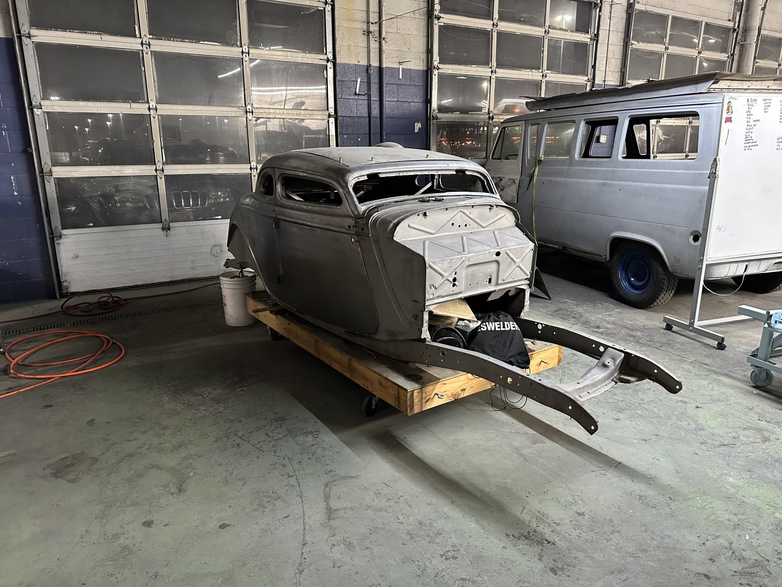

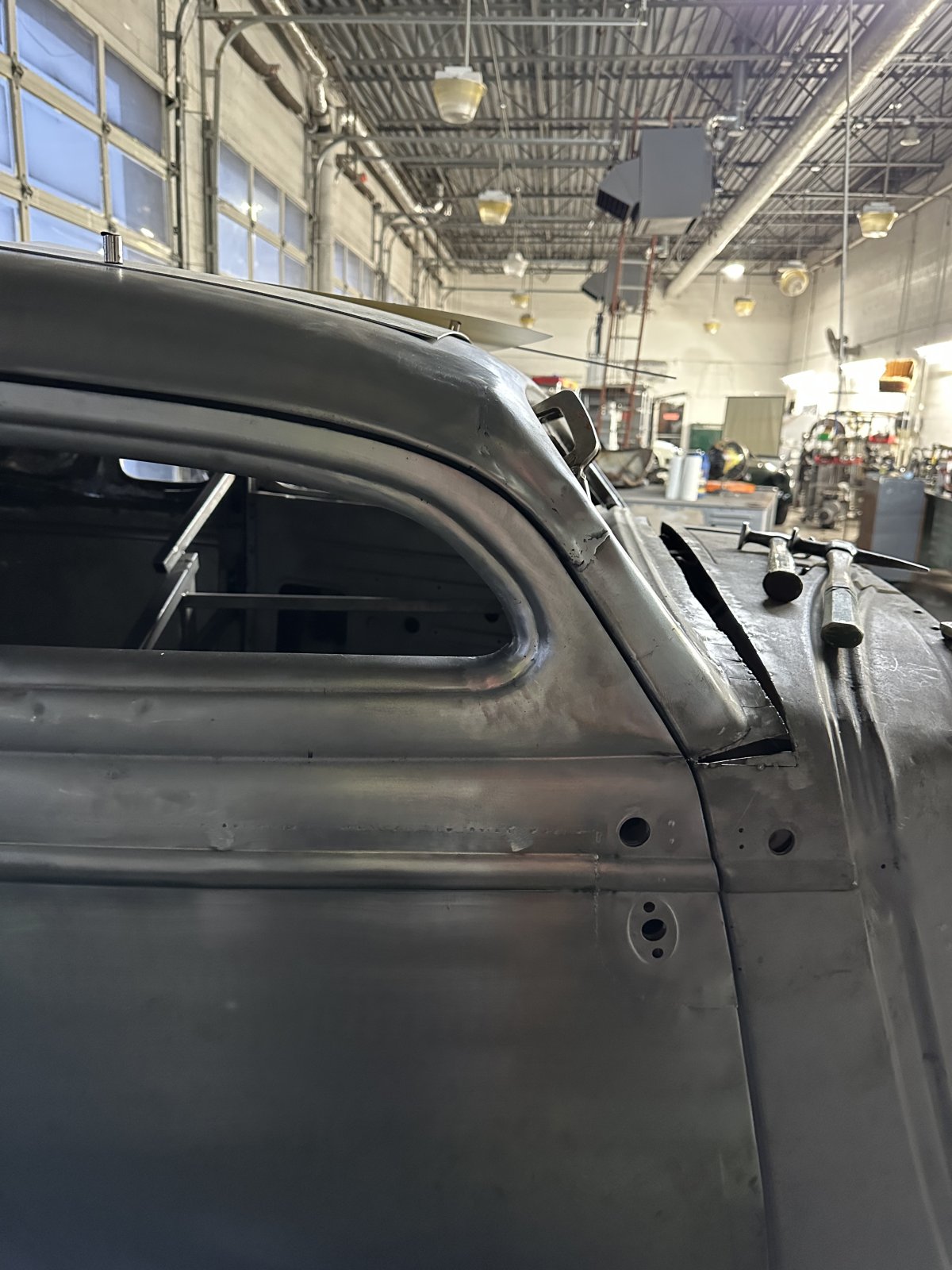

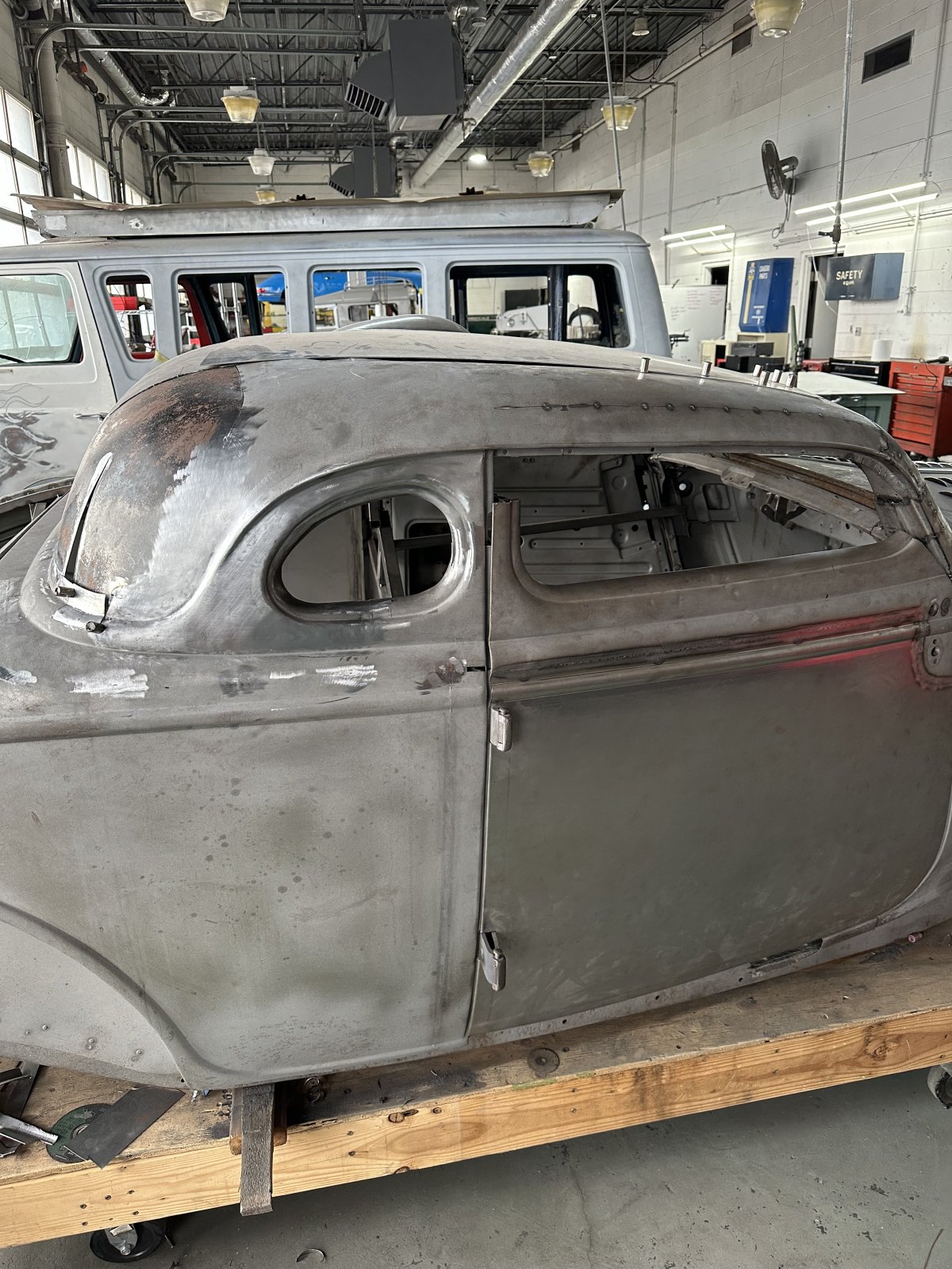

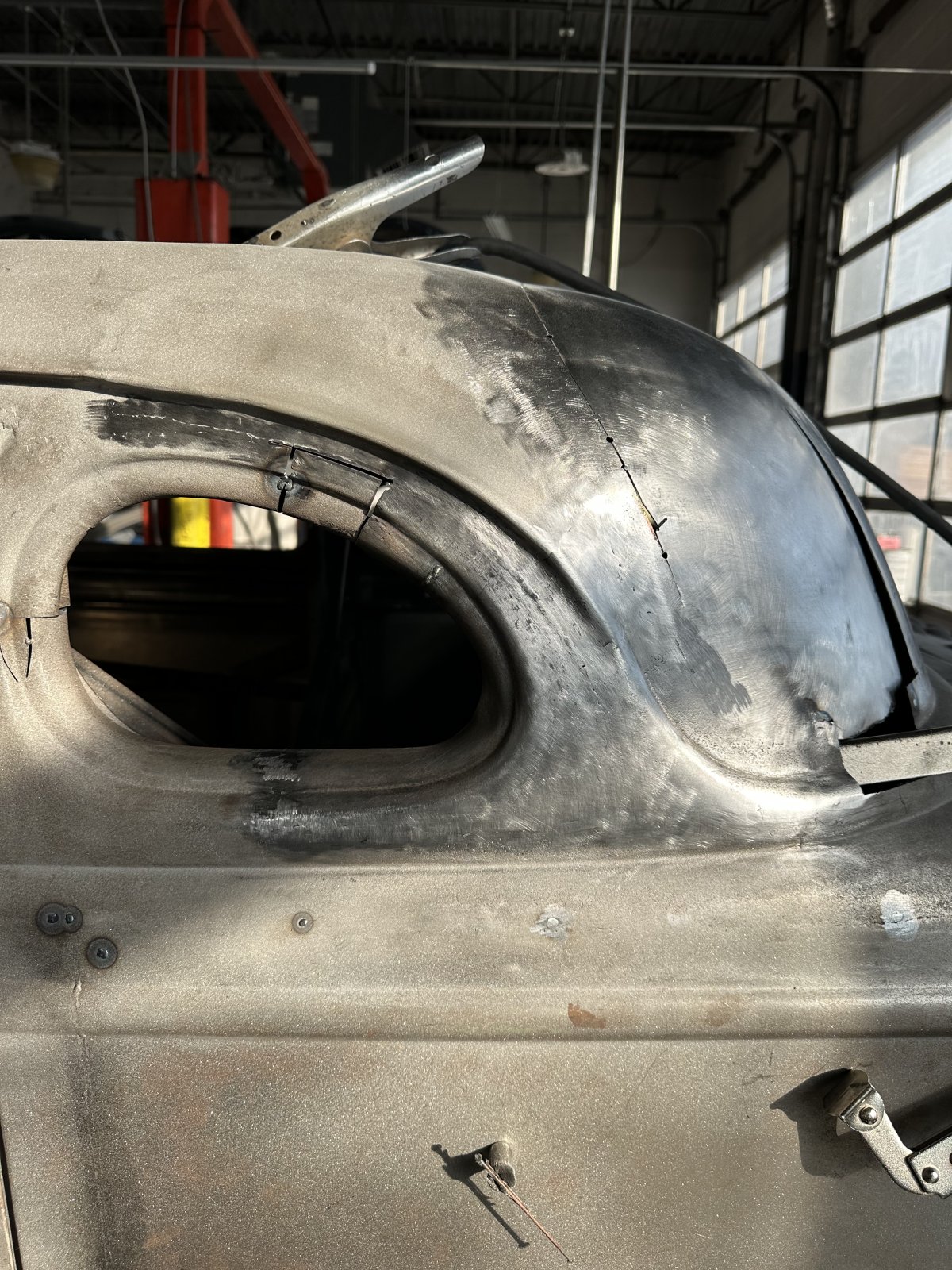

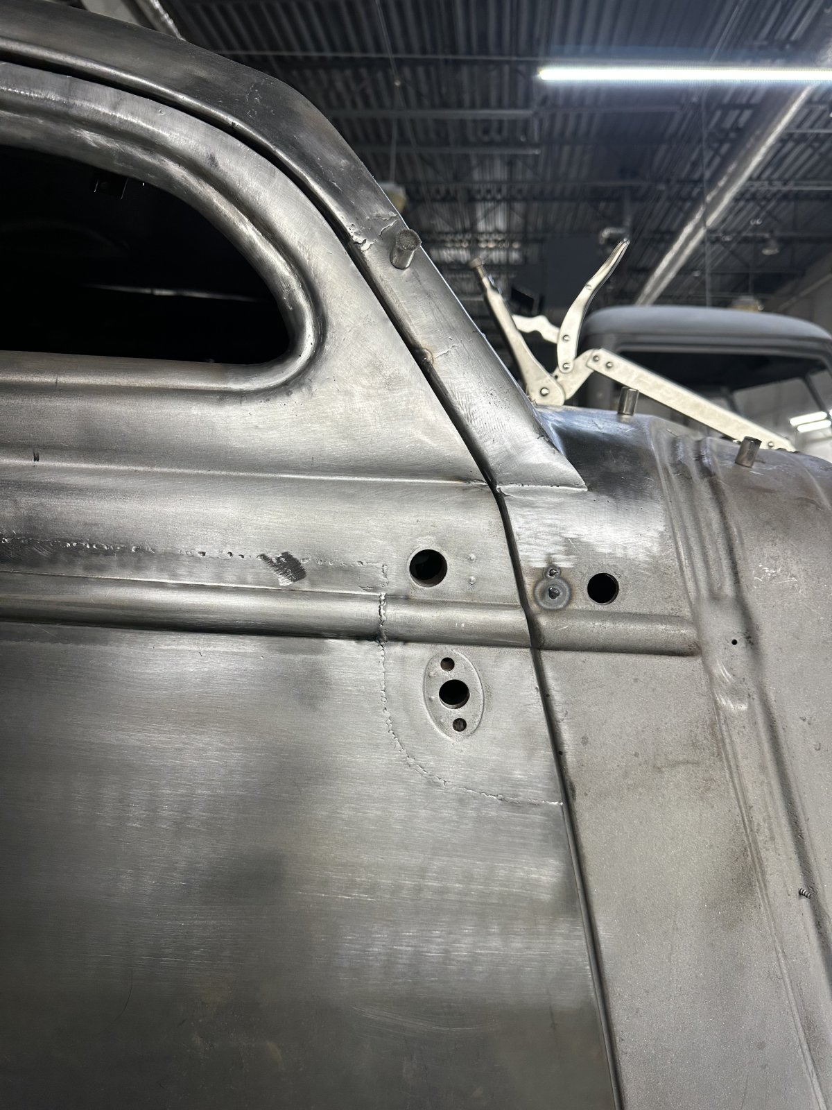

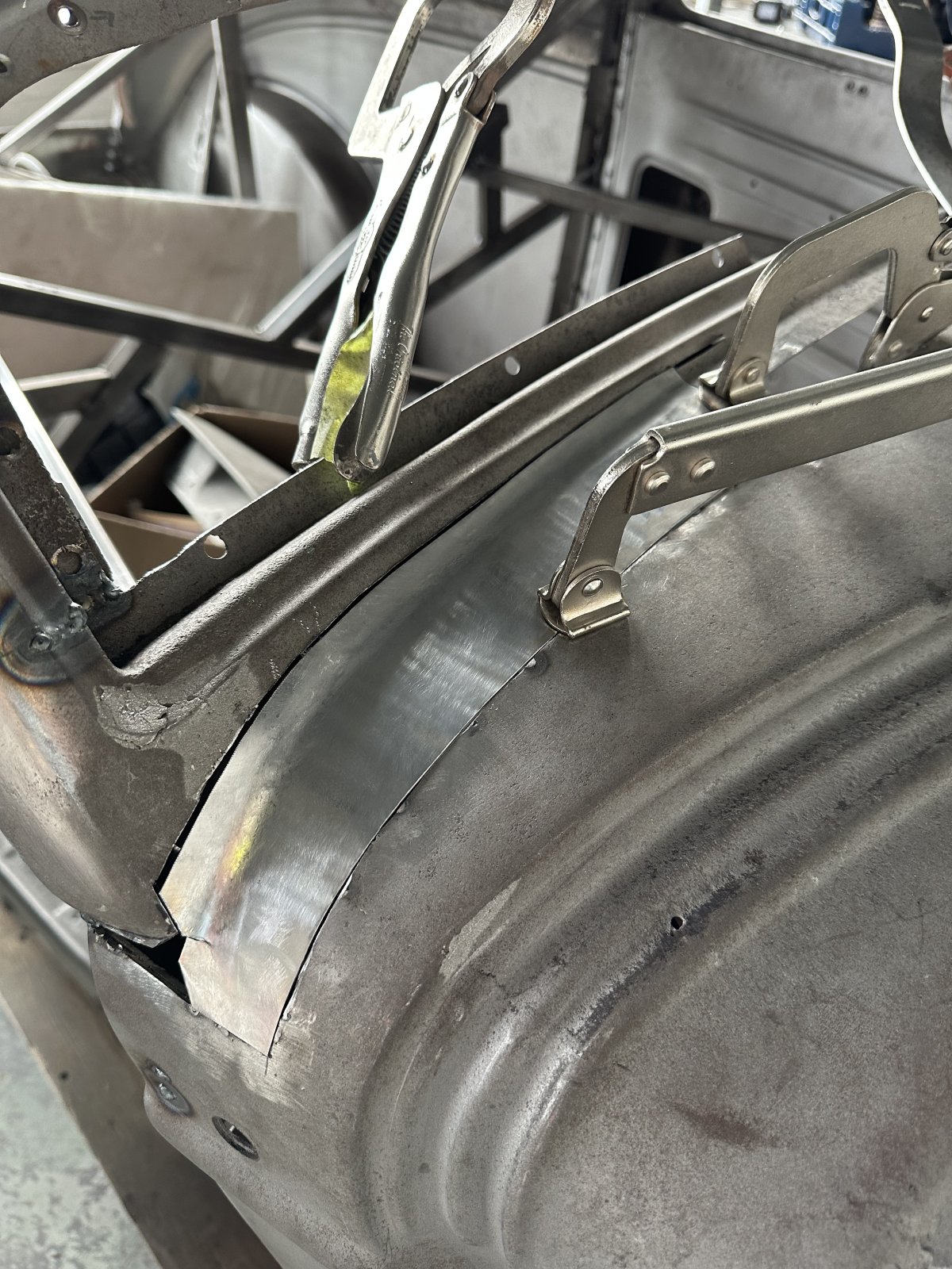

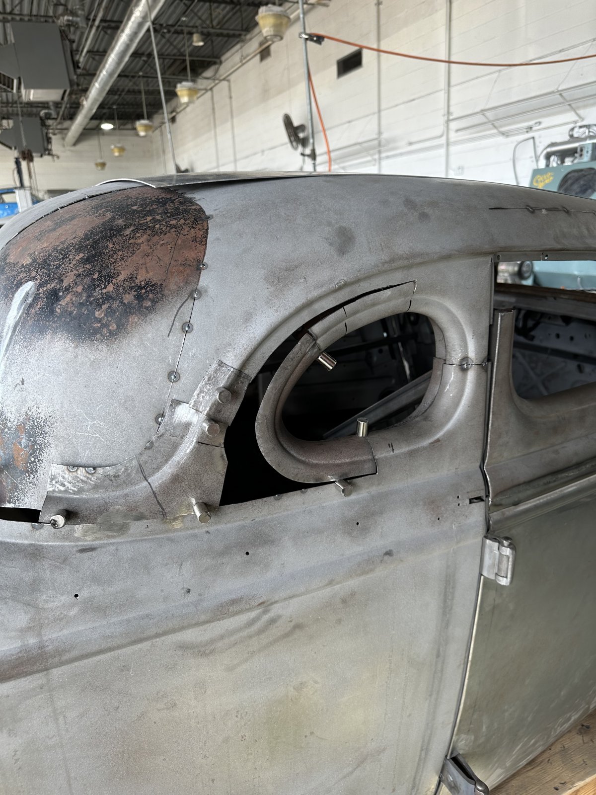

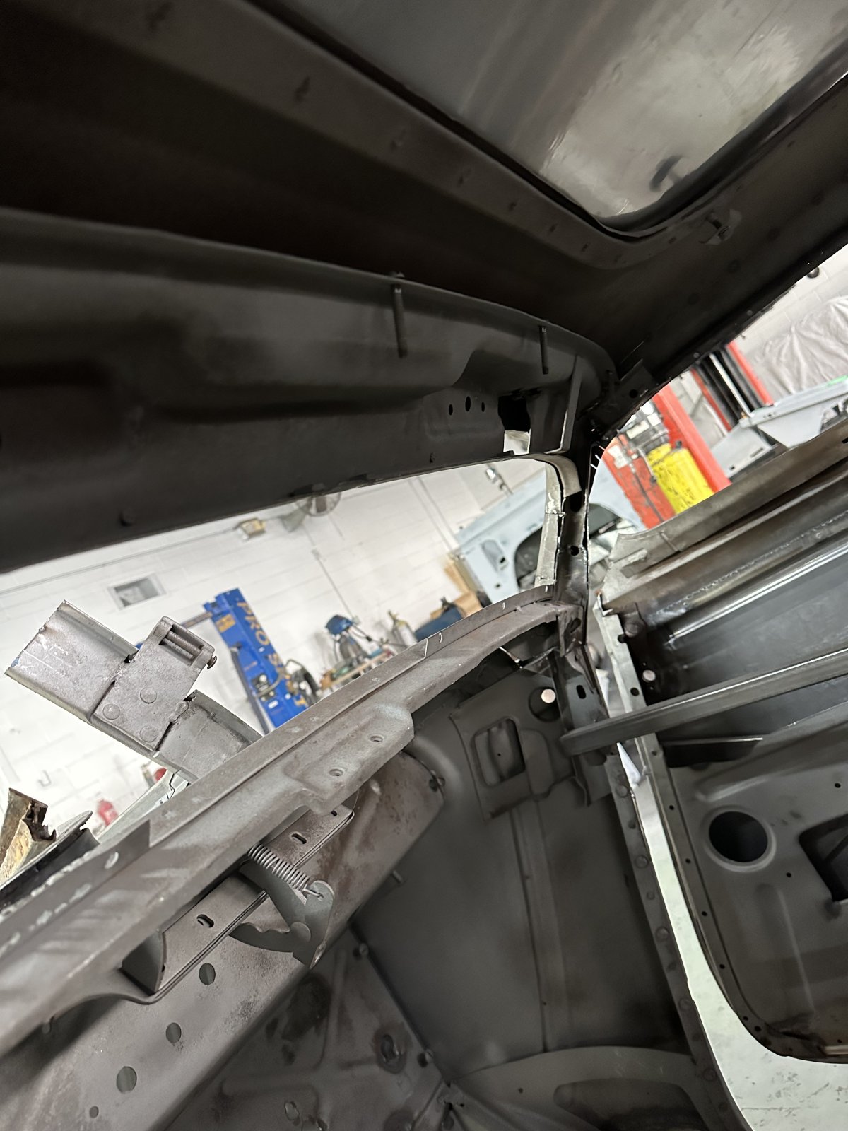

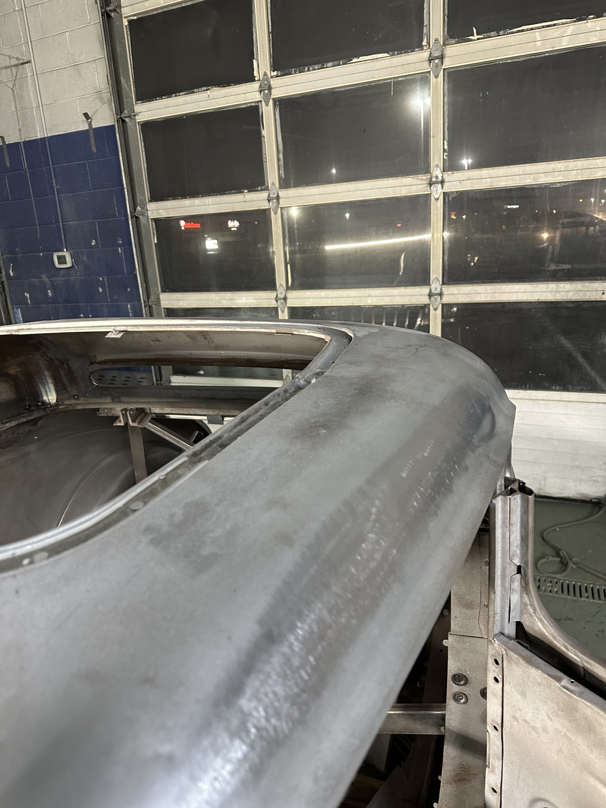

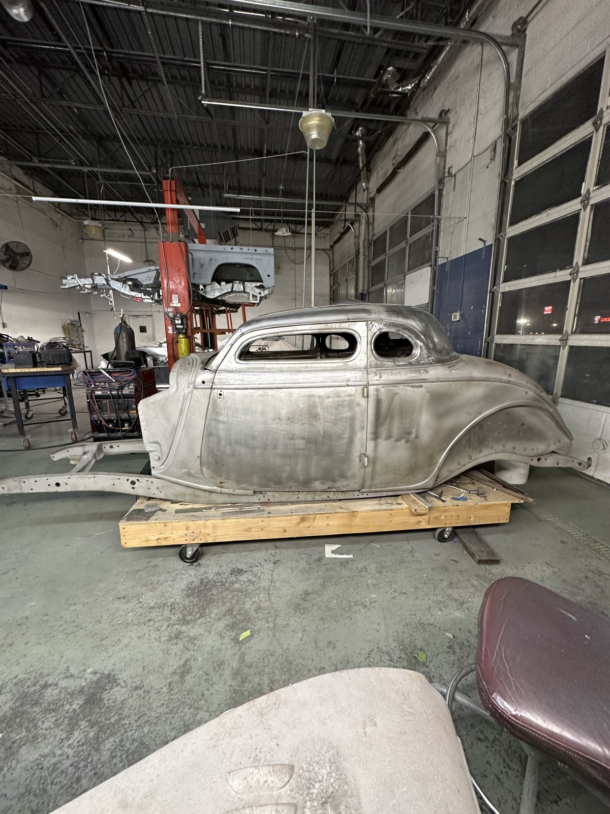

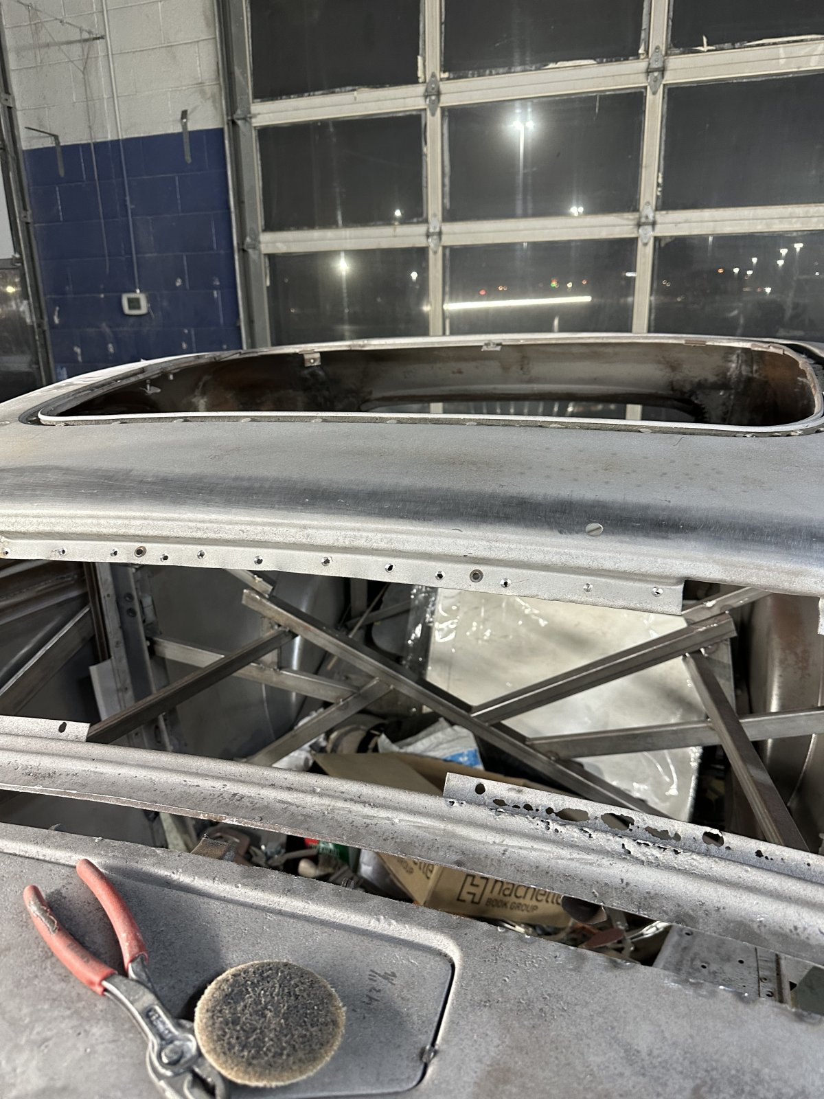

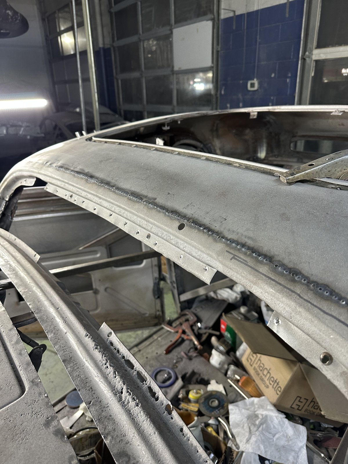

    89385F7A-5D98-4EBD-88C3-48AF7E555374.jpeg AA33DA73-3F37-400C-94CA-DE1062C437D6.jpeg 064FD120-350F-4B97-ACEE-6C14784B3C07.jpeg 51628105-9D9C-4749-872E-F9CA5CFAFBB2.jpeg 4CBC6109-5A9F-4DB9-AF60-85BF673AE9A1.jpeg AB14115B-891B-4657-AE46-761E7FF9F088.jpeg 1C5FA2F9-0F48-4935-B4F8-AD2001FE26B7.jpeg 628494E8-F383-488C-8305-423EFB71A95E.jpeg

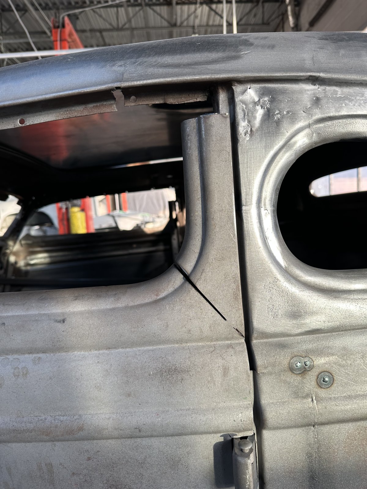

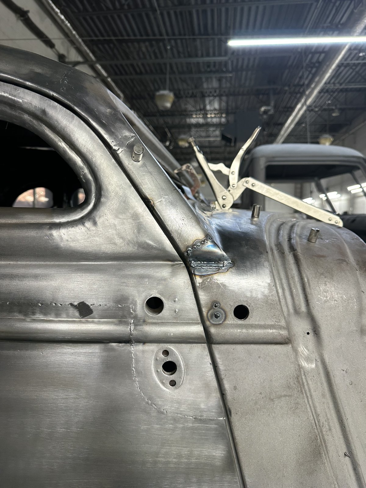

    little more work getting done on the drivers side. This side was a little more difficult to get a nice finish on because of all the previous patches that were done to it. B67799C7-5E89-4633-AA30-5323871C392D.jpeg 9270DC76-D489-4441-B7A9-1D12FE444D3E.jpeg 603E1BCA-BD11-4CD0-9EA1-24A6D663F78E.jpeg decided to cut out the inner structure temporarily to be able to have access to the weld that goes across the top. This way I can planish it. 28D6AA04-D9F0-4D48-94FB-E1AE06E4120C.jpeg 59A45CB4-6AA9-4410-837F-CBBE9BE05A9F.jpeg D4475C63-C536-471B-B455-6135B9020773.jpeg 064D2BE1-A909-481F-A59A-1EA175713ABA.jpeg 330B0387-097C-48FB-947C-CDE4D50833E4.jpeg 509616C2-B11D-4AD9-A629-04430A378D37.jpeg
    I welded up the cut above the drip rail as well. Just have the other side to do. I’ve been brainstorming on how to do the door tops correctly and the least invasive way possible.

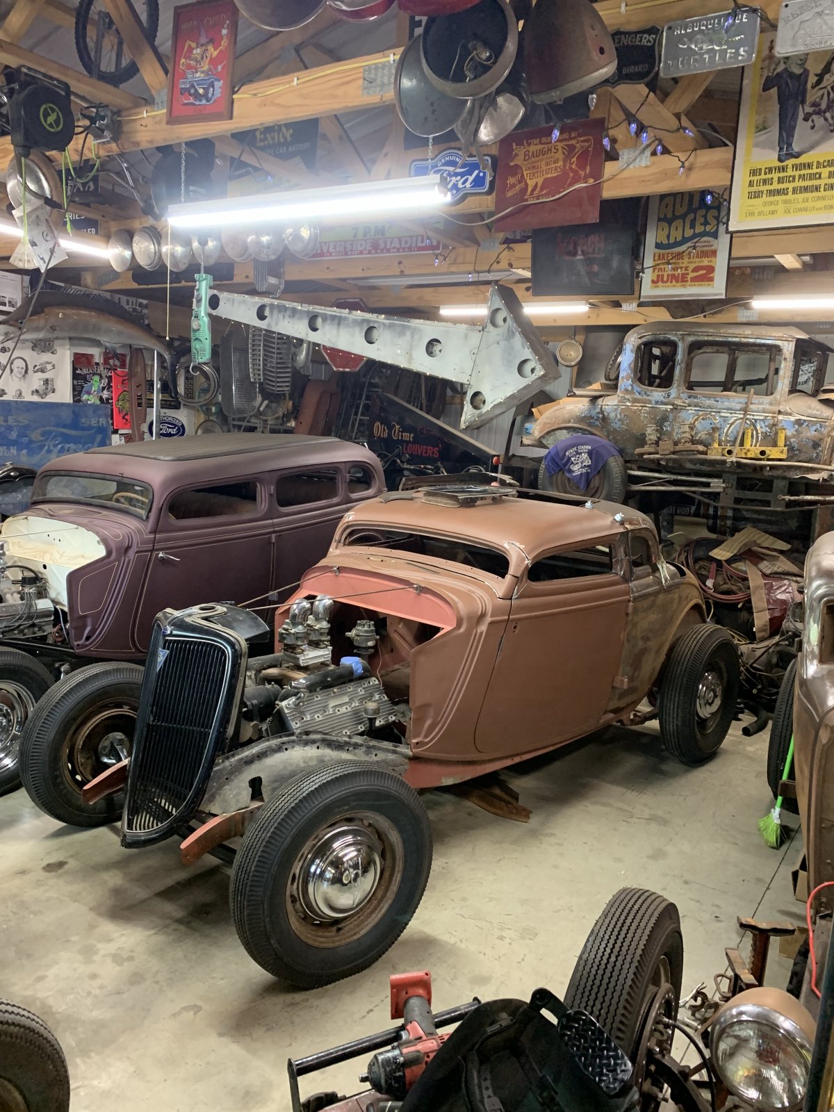

    What's the crazy looking sports car on the rack behind the coupe?
    JalopyJimbo and H-O-O-V-E-R like this.
  27. H-O-O-V-E-R
    Joined: Aug 10, 2017
    Posts: 207
    H-O-O-V-E-R
    from Utah
    Thank you! That’s my good friends Porsche special. It’s specterporsche on Instagram if you want to see more.

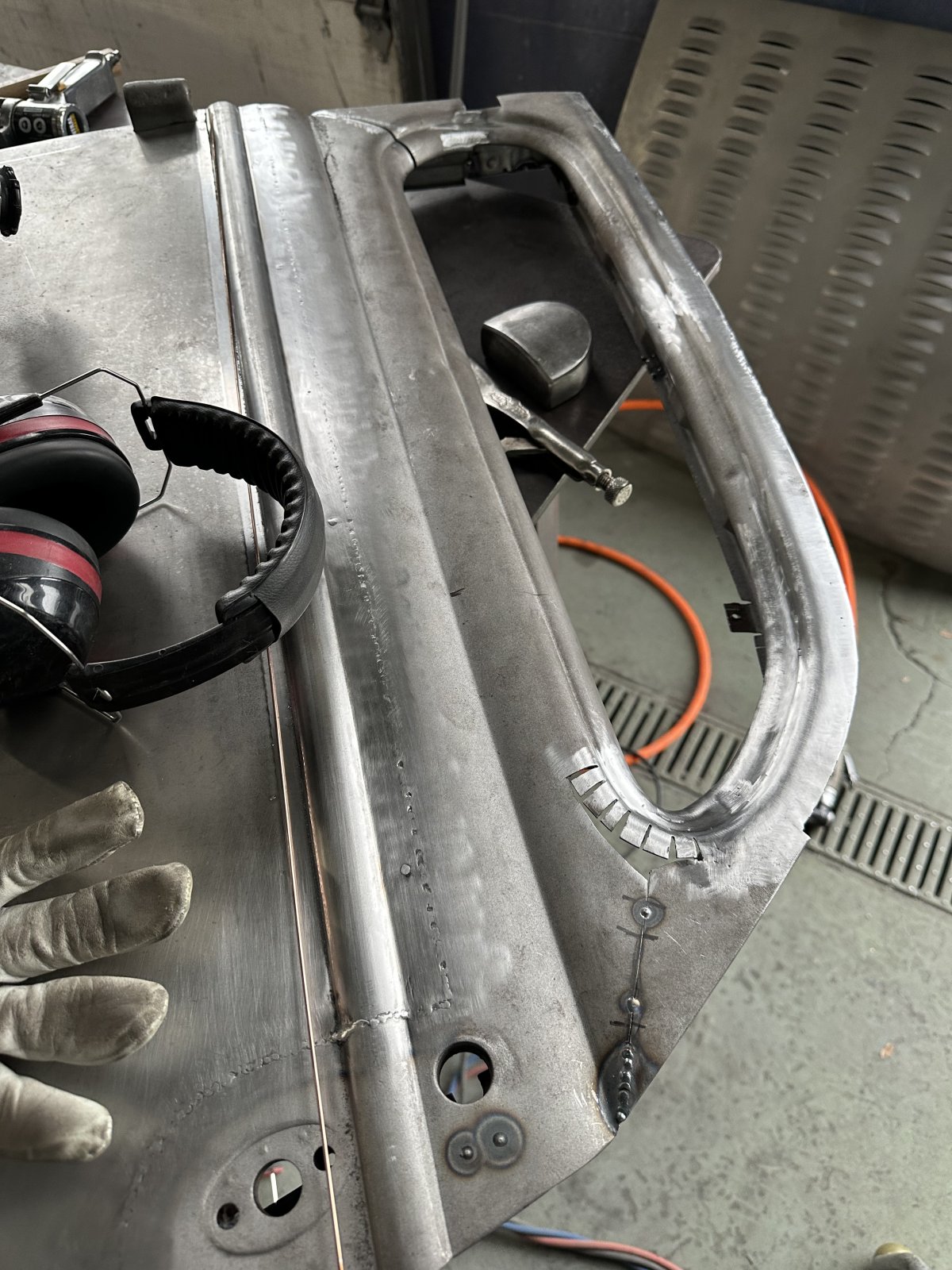

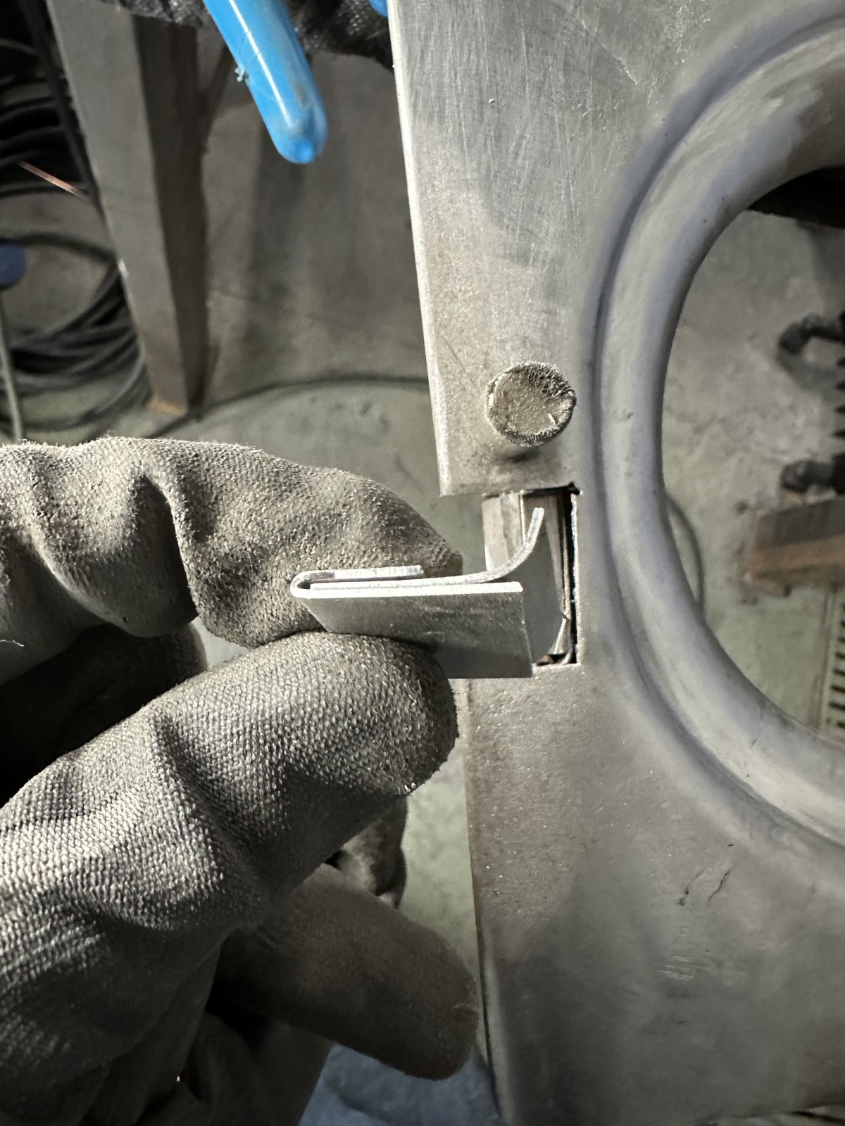

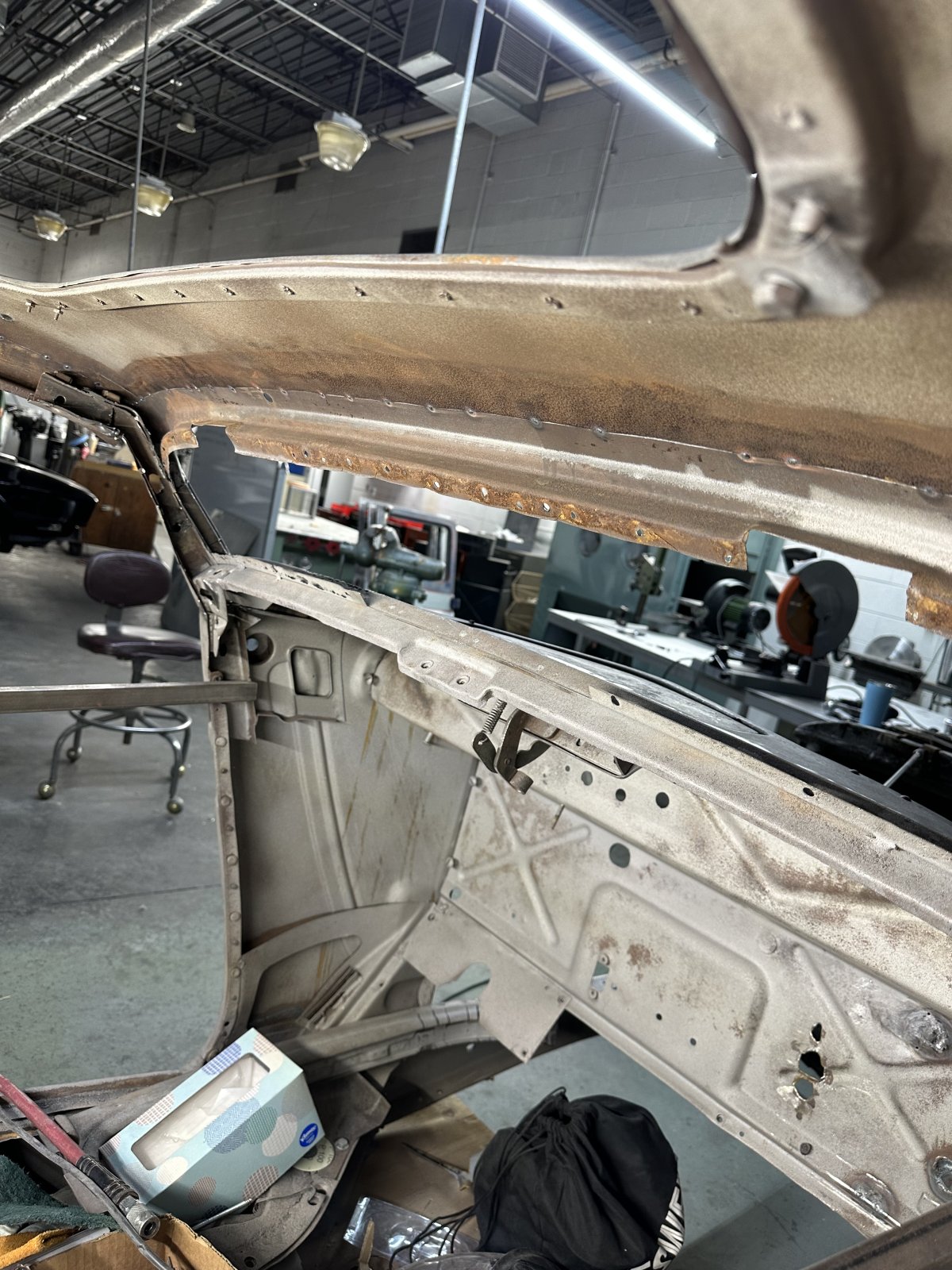

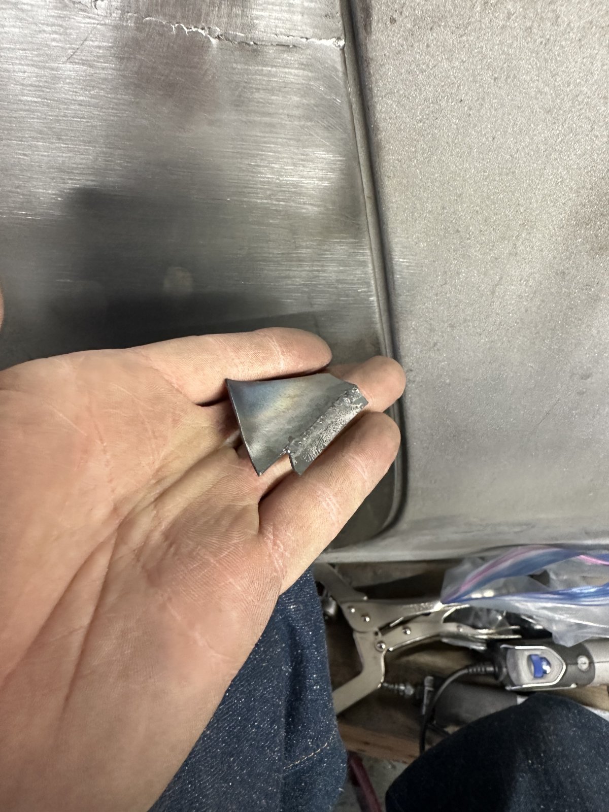

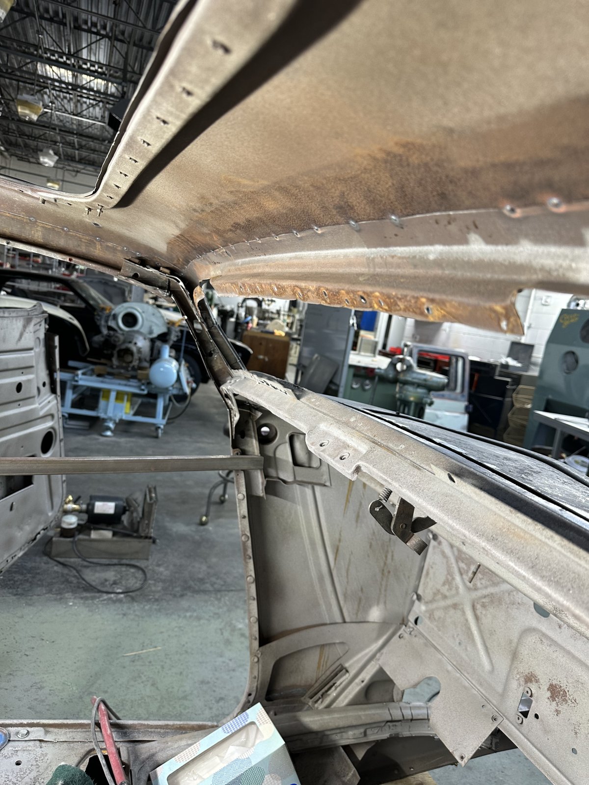

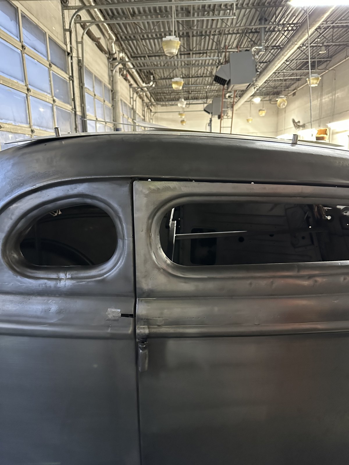

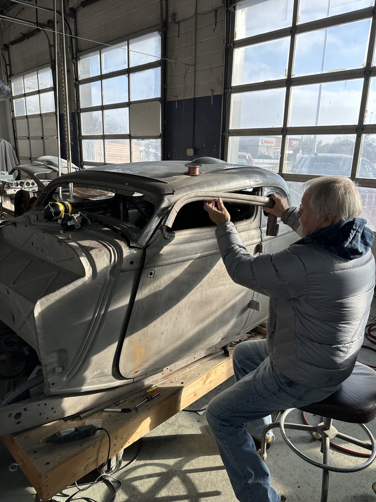

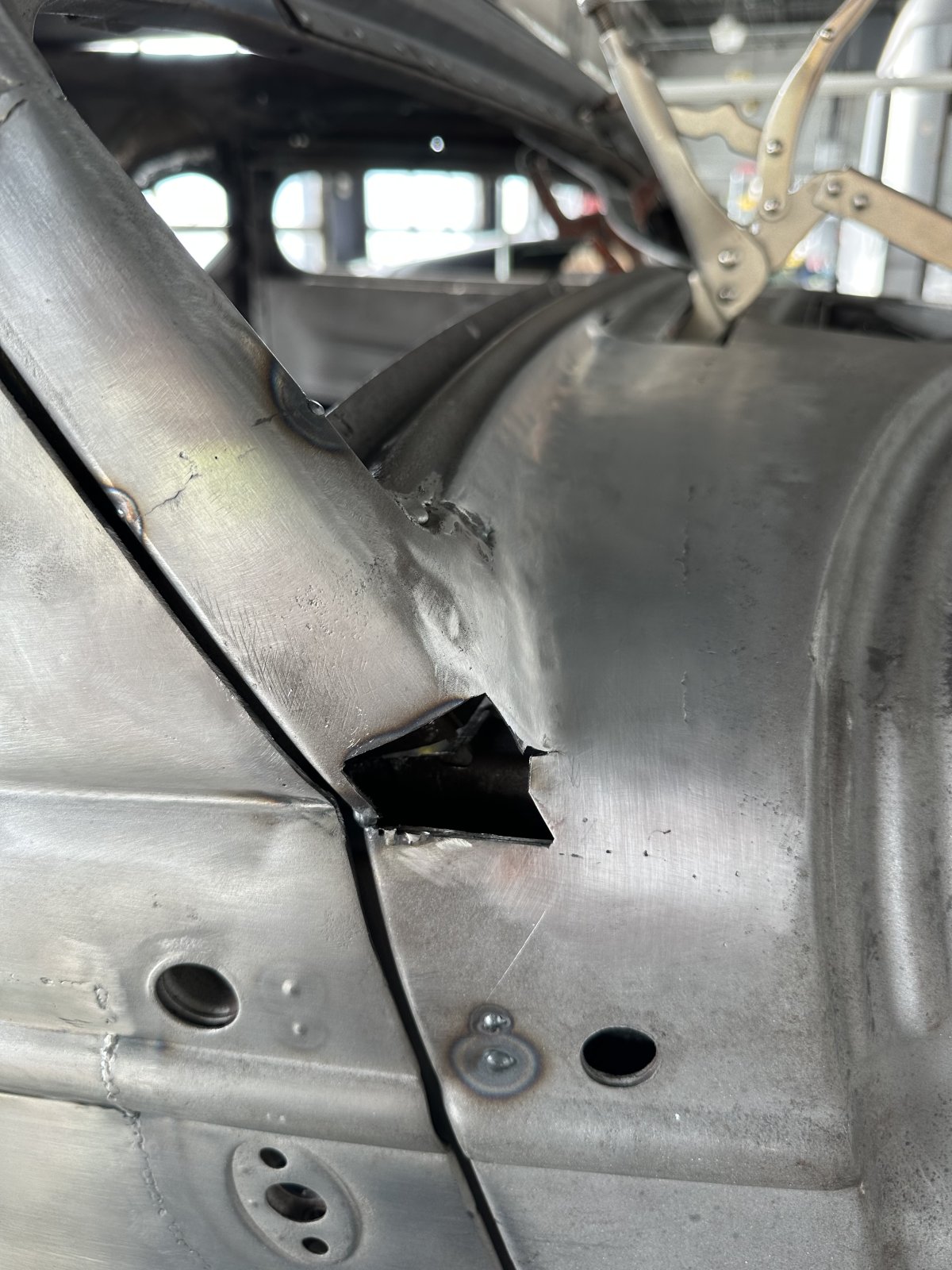

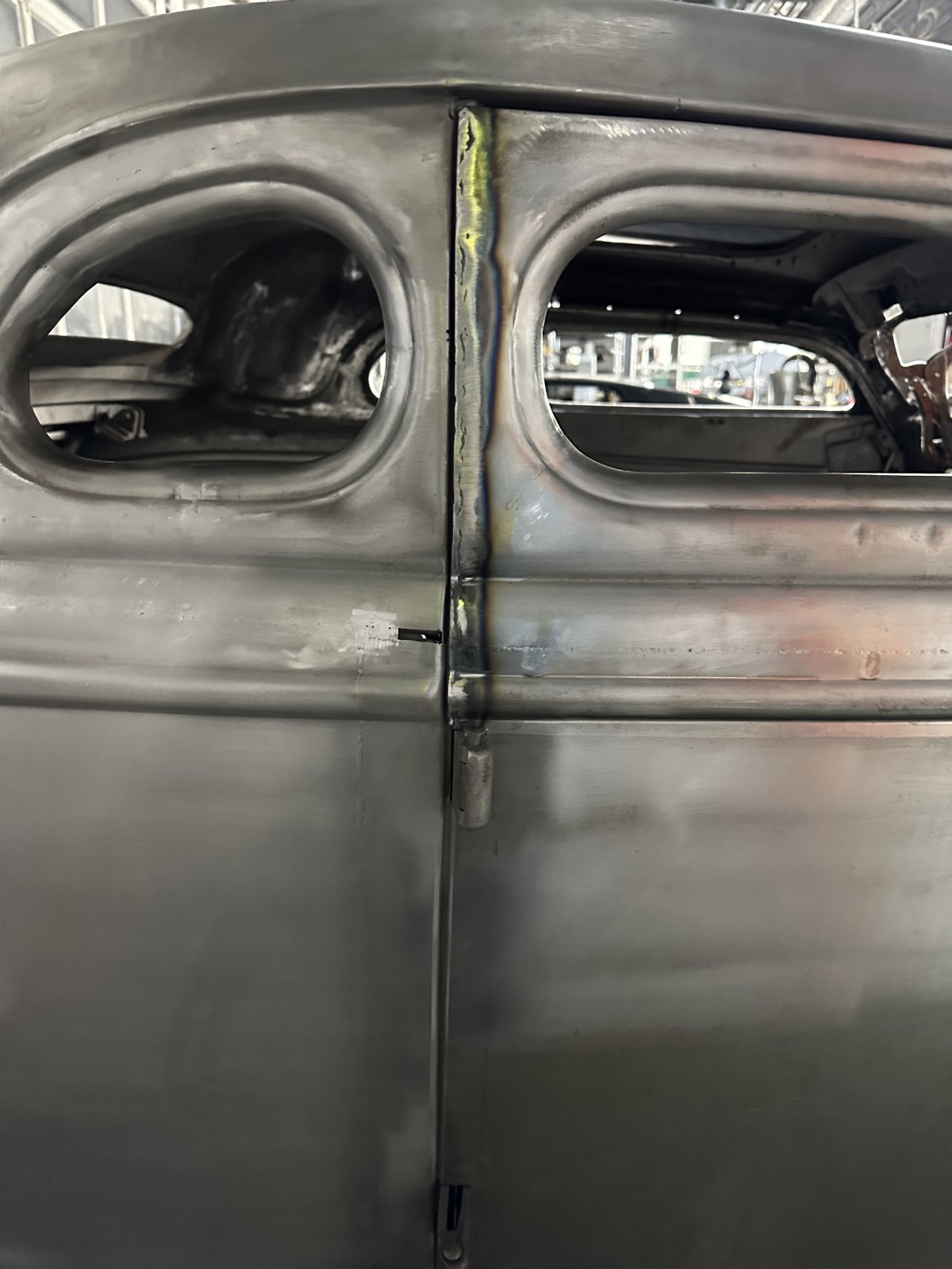

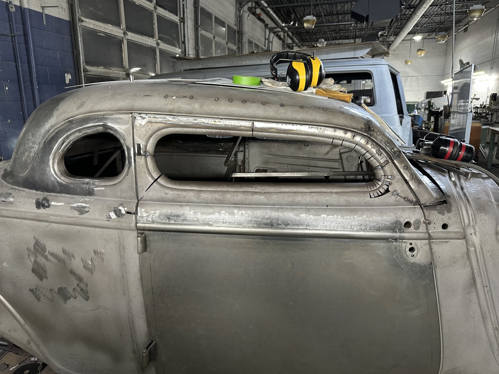

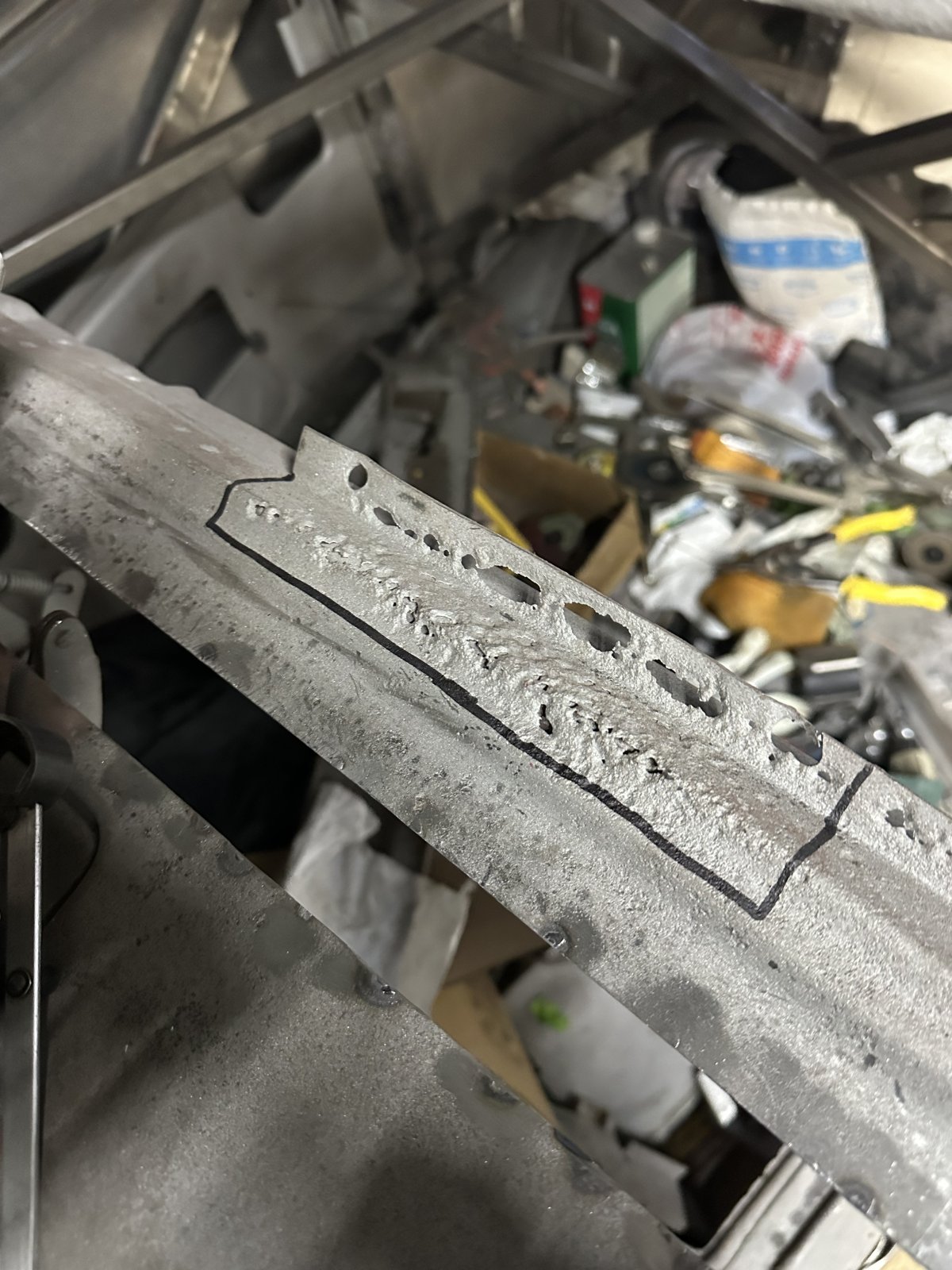

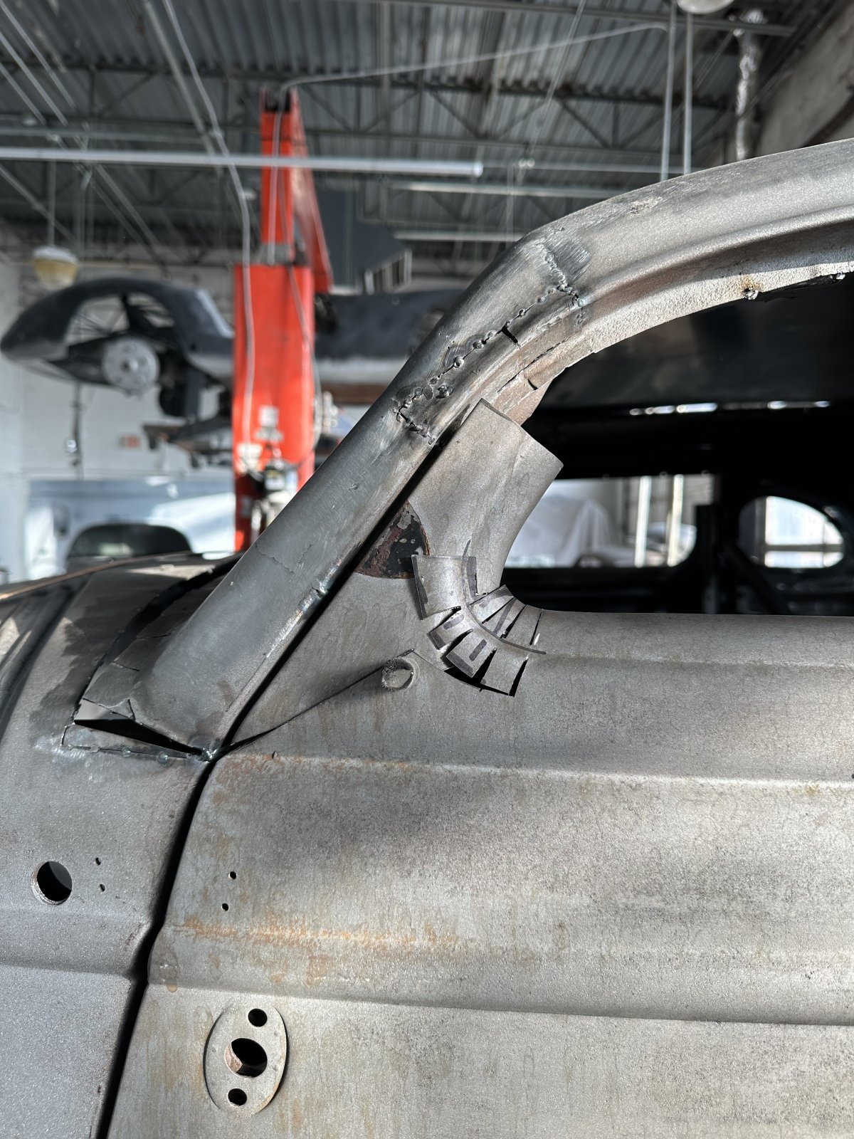

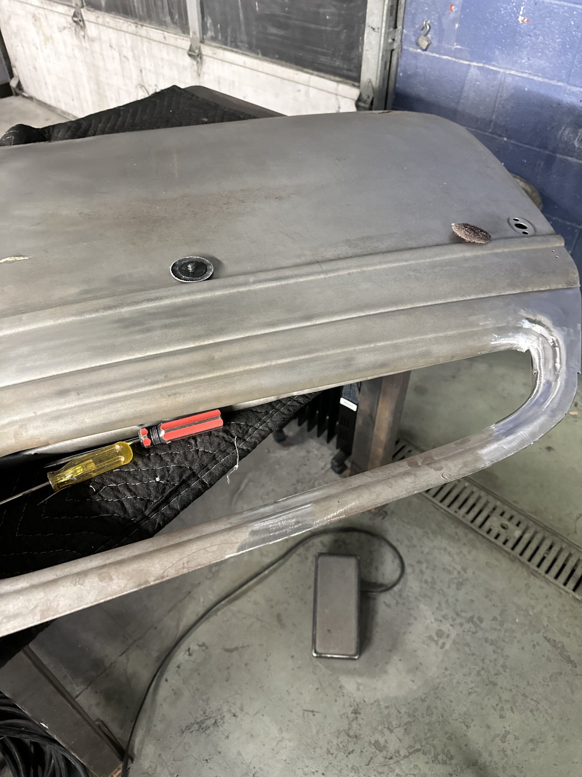

    9B7D9413-2383-4216-A54D-FA58947A9B86.jpeg D23D4472-5477-4F62-B67A-BA28B603BCC7.jpeg 0BAF9F48-1B60-4056-B7DE-725F56CE5AC8.jpeg

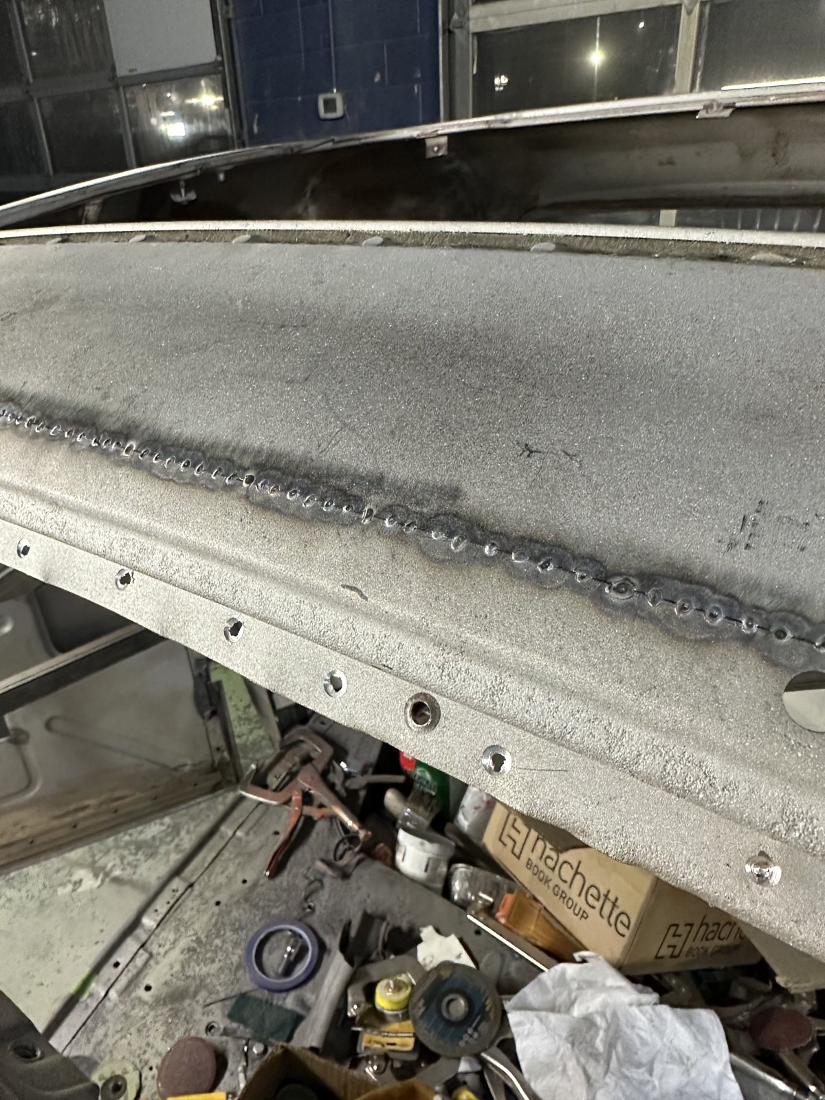

    Hello, thought I would give a little update on the progress. Here I am patching heavily rusted area at the bottom of the windshield.
    74E5E0C2-A83F-4F66-9087-9779F4018D79.jpeg D5108F61-5FCF-4993-A5E7-BF2D2FA07D0F.jpeg

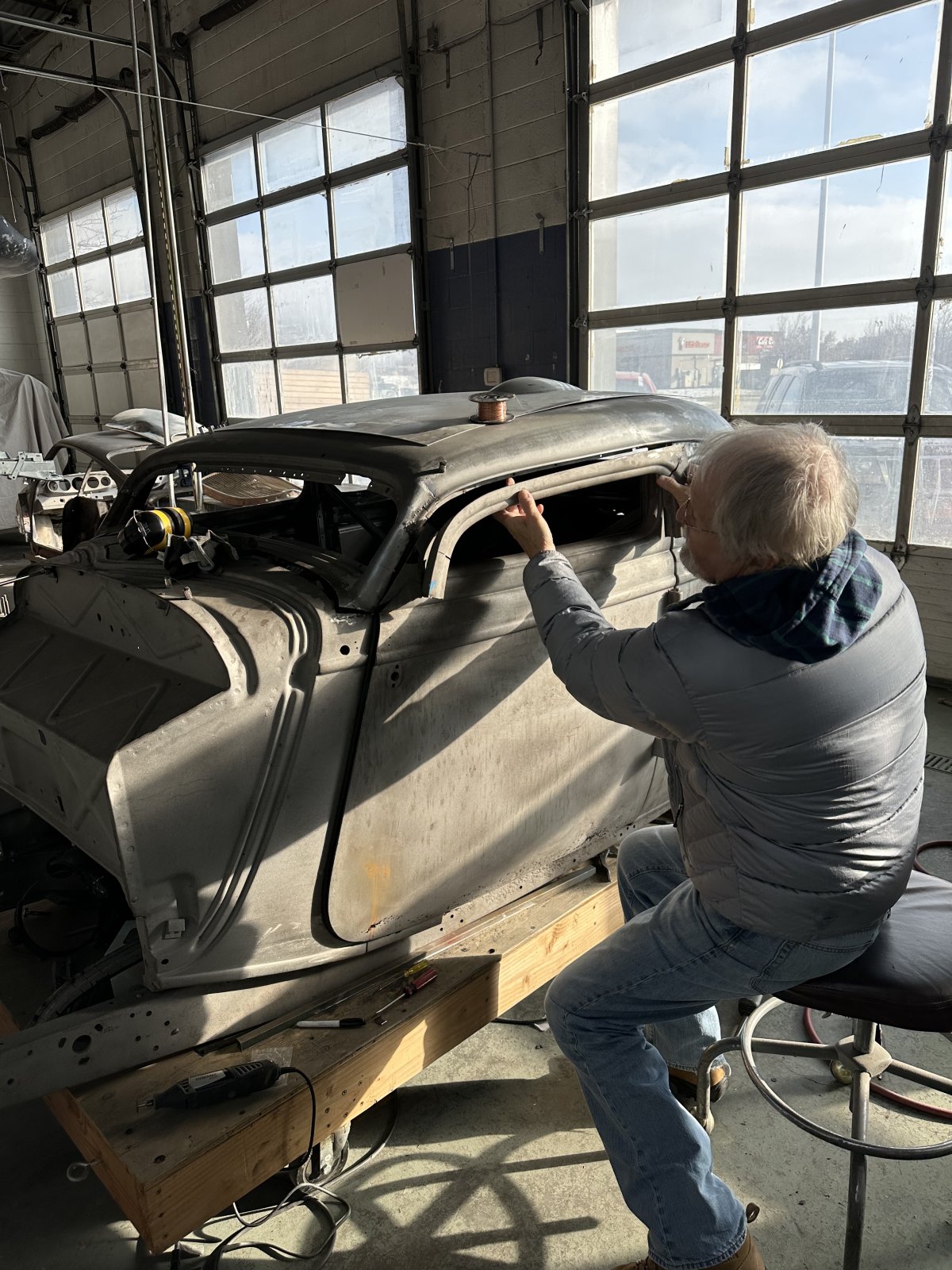

    my dad and I trying to get a feel of how to go about finishing the door windows and trying to sneak a peek of how it will look.
    To be honest I brainstormed how to do this and this is what I came up with. I’ve never seen it done before . I wanted the the bottom corner of the window to have a radius but not a long radius. I like the look of a sharper radius on the bottom corner.
    I had to cut the windows to open them up and line the door gaps up.
    Door top tacked in place.

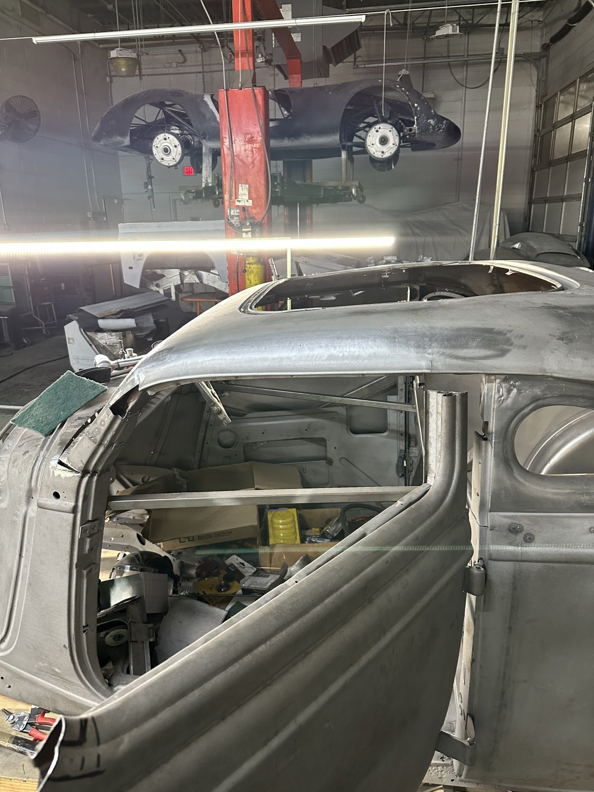

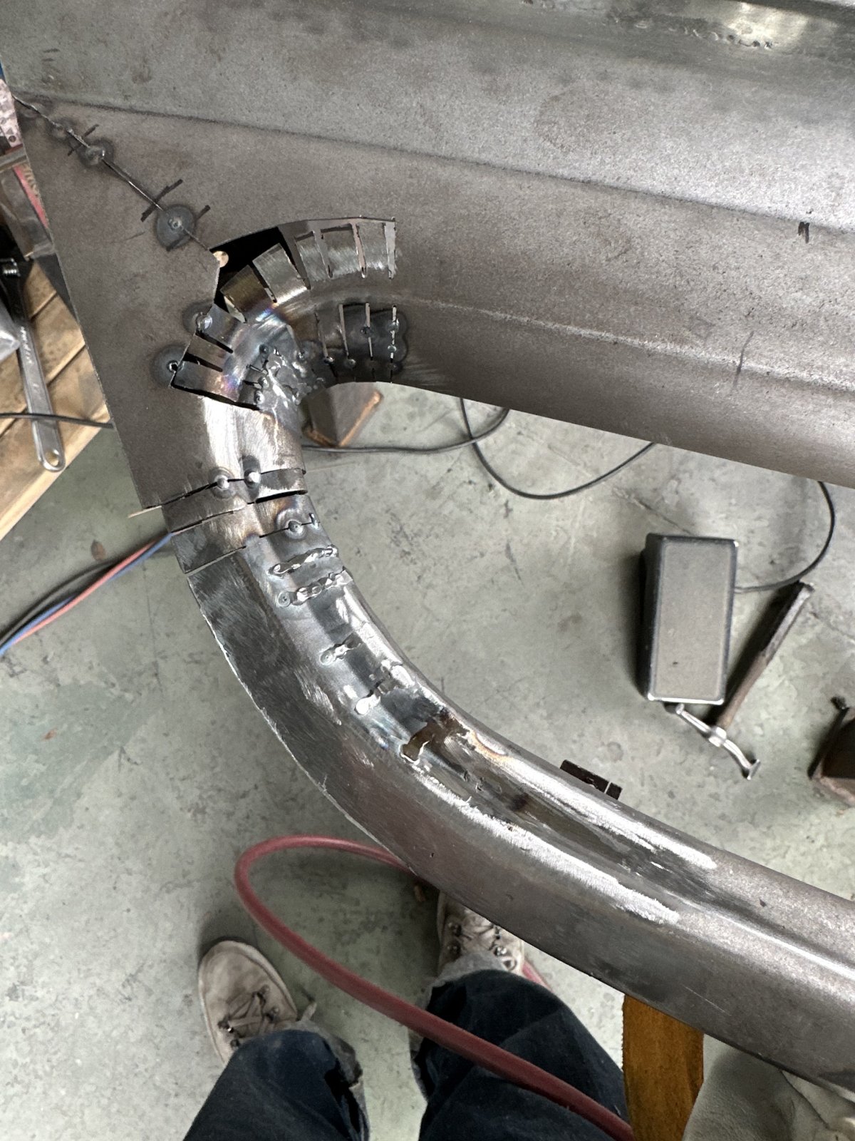

    D148427F-BF38-4679-972D-5C162C71568A.jpeg 08628A95-2CEF-4292-872A-96E31B951A46.jpeg

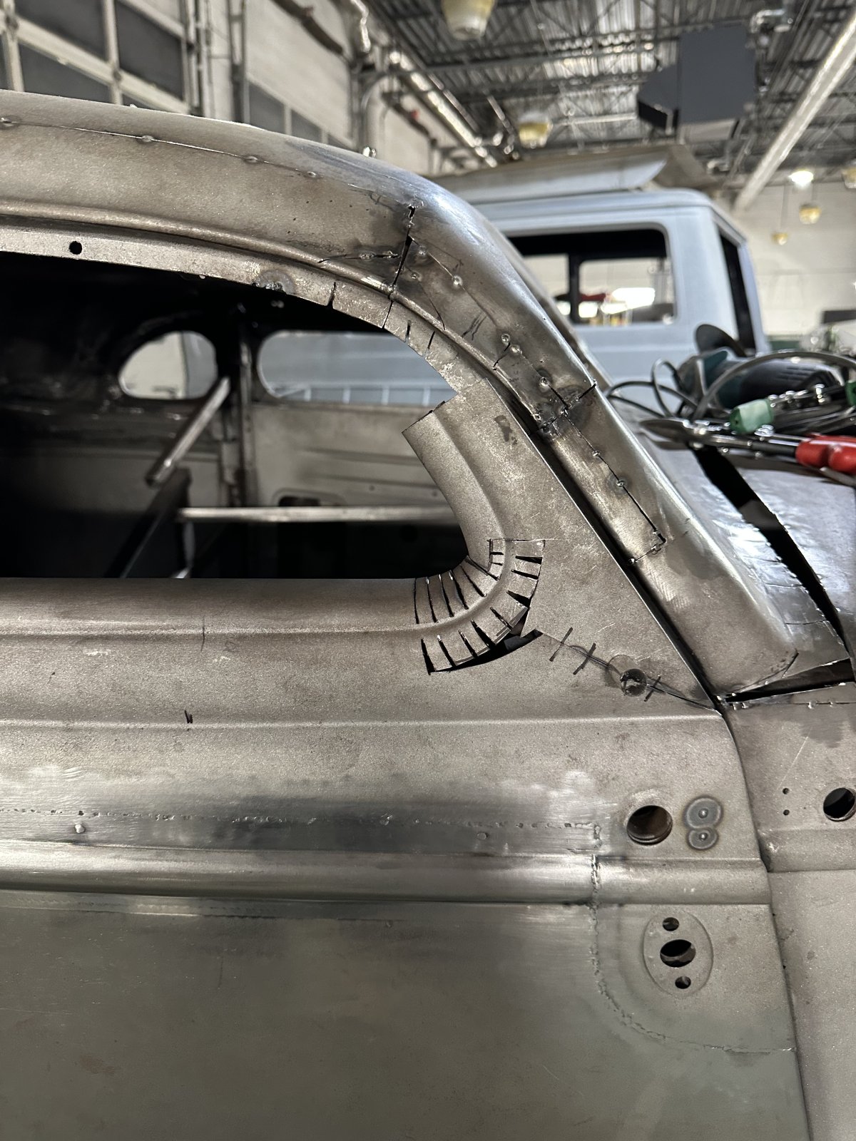

    Both sides done. This side I went crazy on the pie cuts and it was a mistake. I had originally cut that many from the previous chop that I was going to do. Just trying to make it work.
    FBFCE8E2-B930-40BD-887A-FE584D3F1B54.jpeg 65932CC9-0FB9-4A5F-87DF-64C77417414E.jpeg 7D79E184-DAD0-401B-A719-F256CB2AD4C4.jpeg CBE219CC-D703-42F1-8A14-886D6C0F90E2.jpeg
    the rough stages.

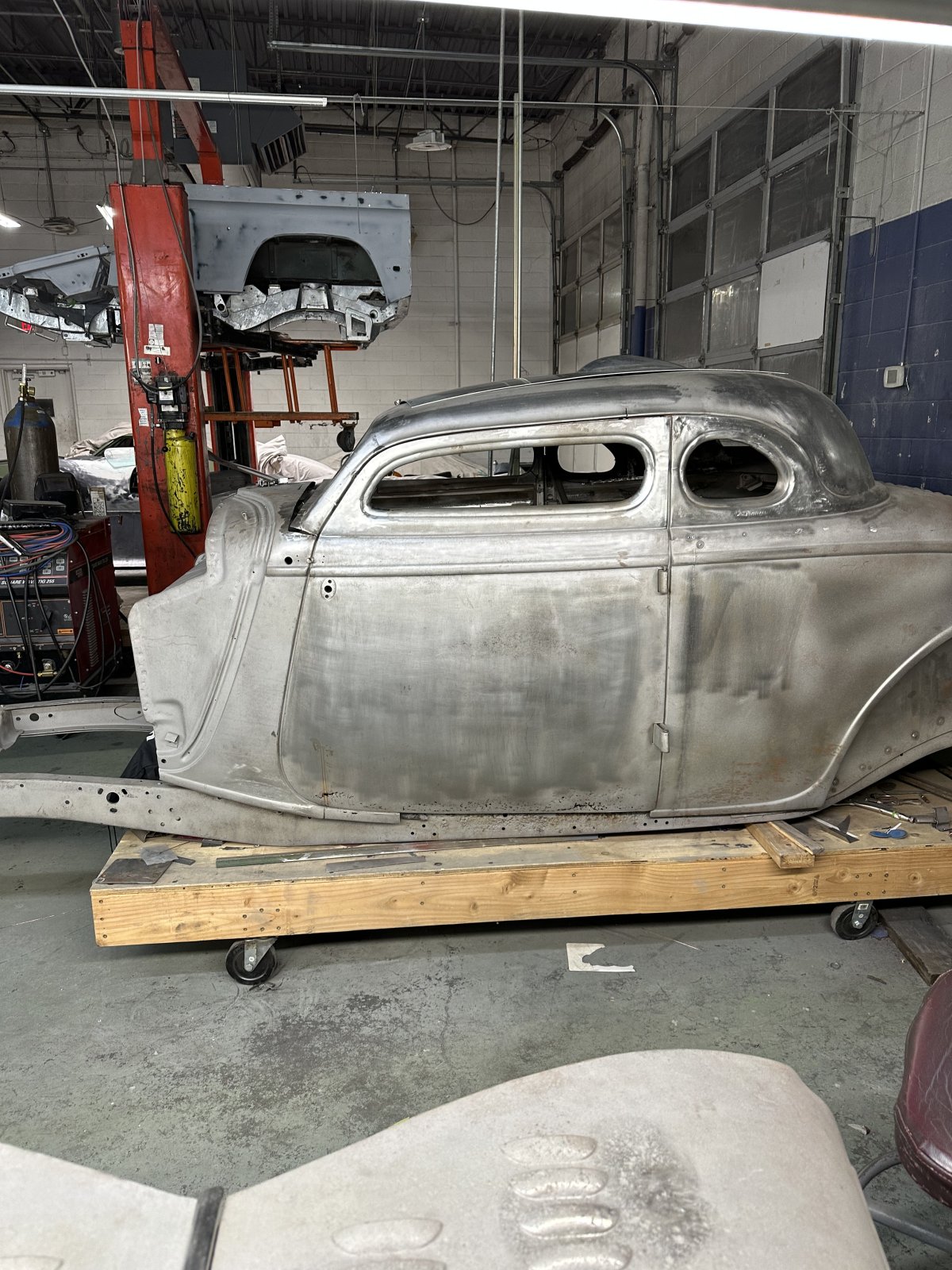

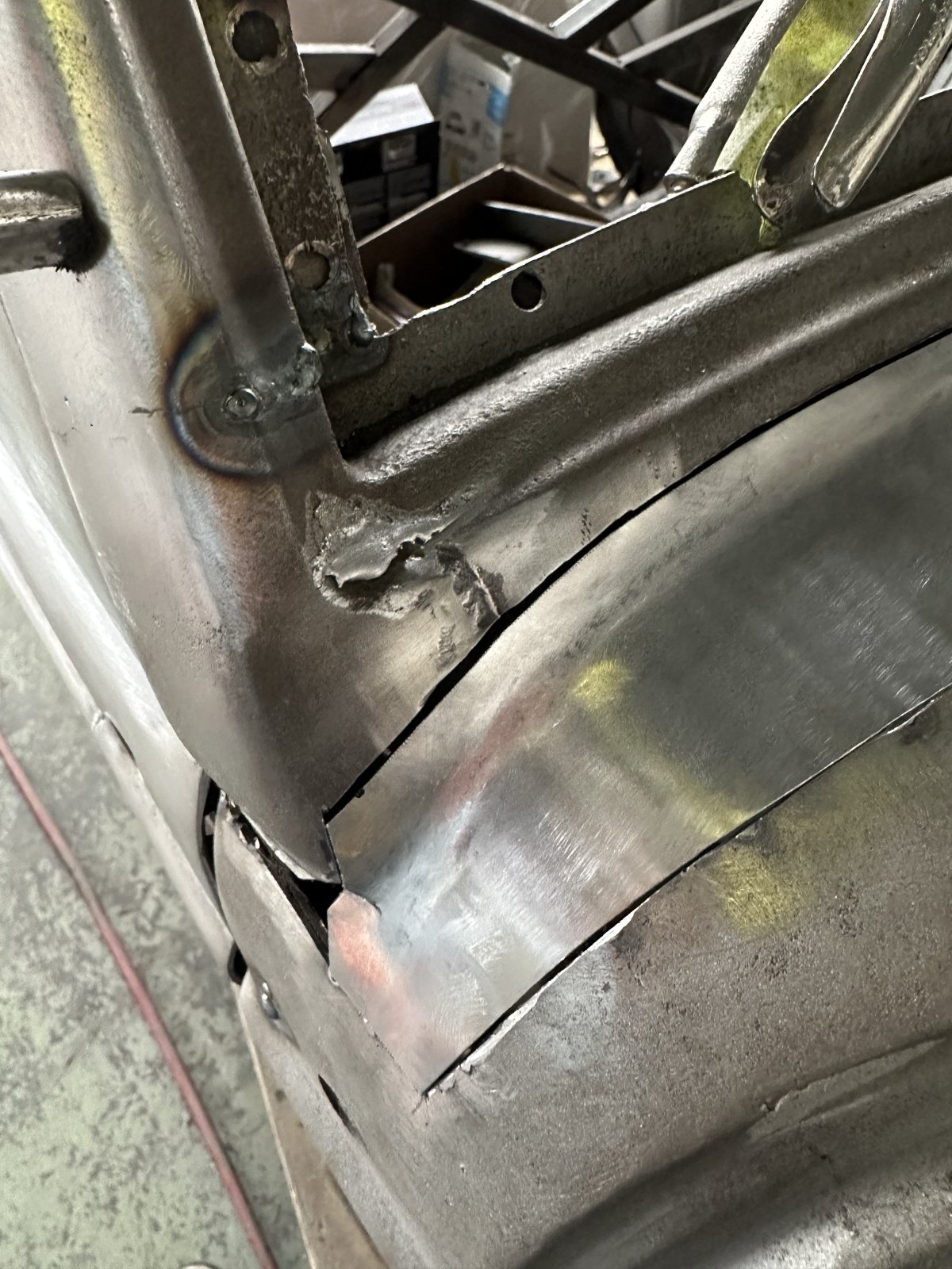

    179F8EA0-A373-4BB3-9EE9-B7F2939AE1FE.jpeg EC2B629F-2081-4104-9213-AFA82A7F33C7.jpeg 8D3C08F4-A4AB-408D-9474-C084FAB93057.jpeg
    Filling in door gaps to get them at least close. Nothing too perfect until it’s all welded up. Things tend to move around when getting heated up.
    D6EB00AB-A8CD-407F-8974-2985A80CE042.jpeg 7AF7D792-C368-4DA5-AD27-F30345F4373C.jpeg 45DBB70B-67B9-446C-BFDC-783A2B0E4176.jpeg 8114F436-3CB7-471D-929E-03241F16CC31.jpeg 017DF21A-72B9-4355-95D3-567FDA7F0254.jpeg
    55468BF9-C757-40DB-B7E5-291388A392FE.jpeg EA565301-4C57-4900-8DB1-6A3AD5FE322C.jpeg 404FB7DE-30CA-4423-BFD3-E14DB20F67D4.jpeg
    filling in where the hinges were. I guess this is the most pictures I can post at a time so I will post another with more progress.

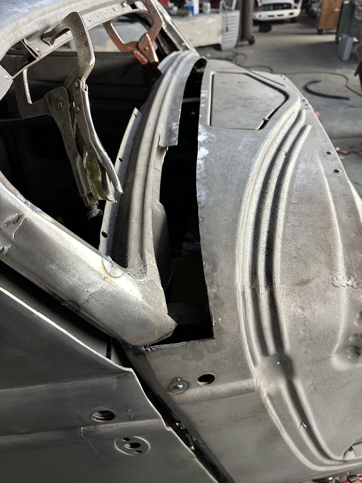

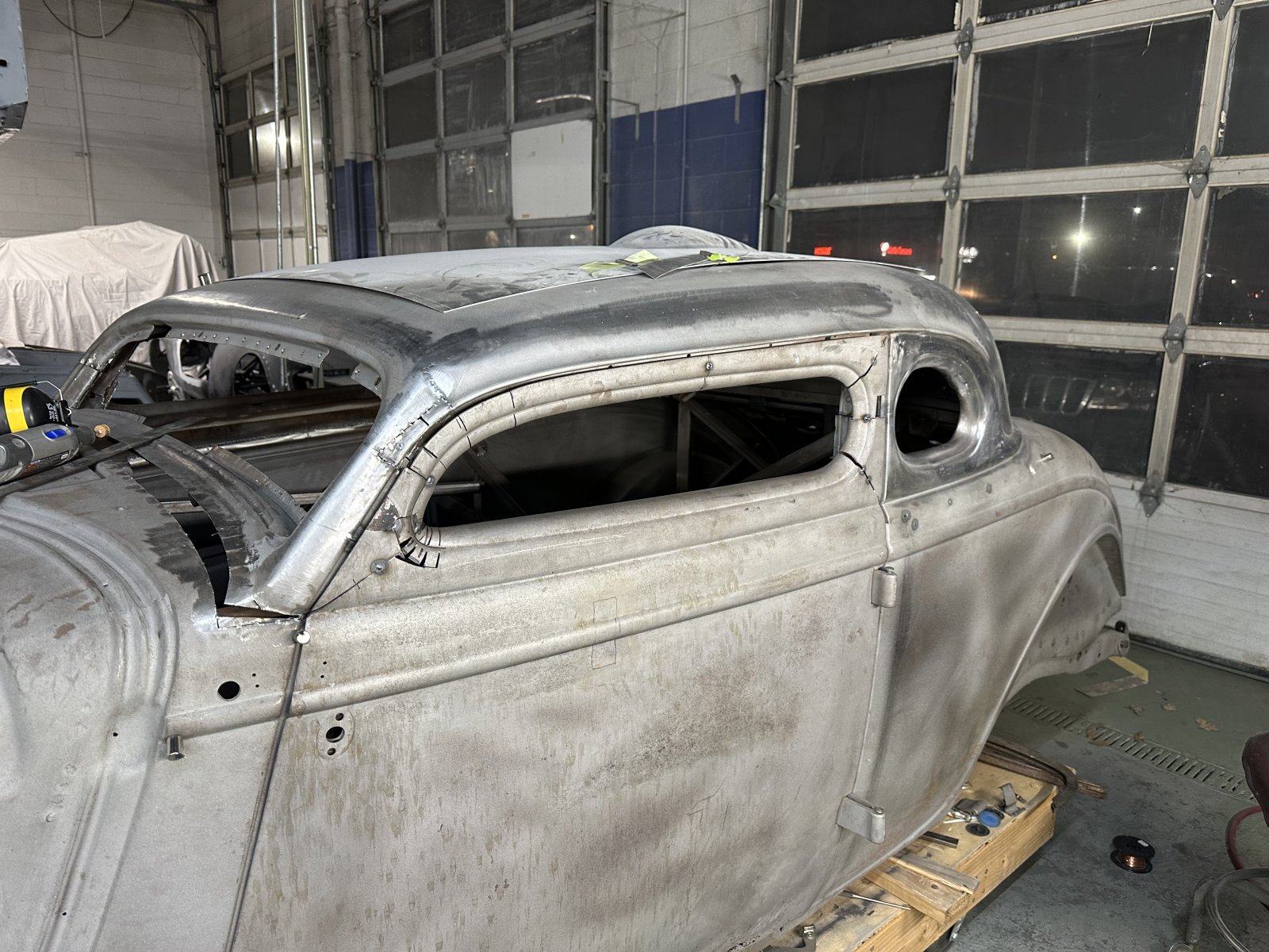

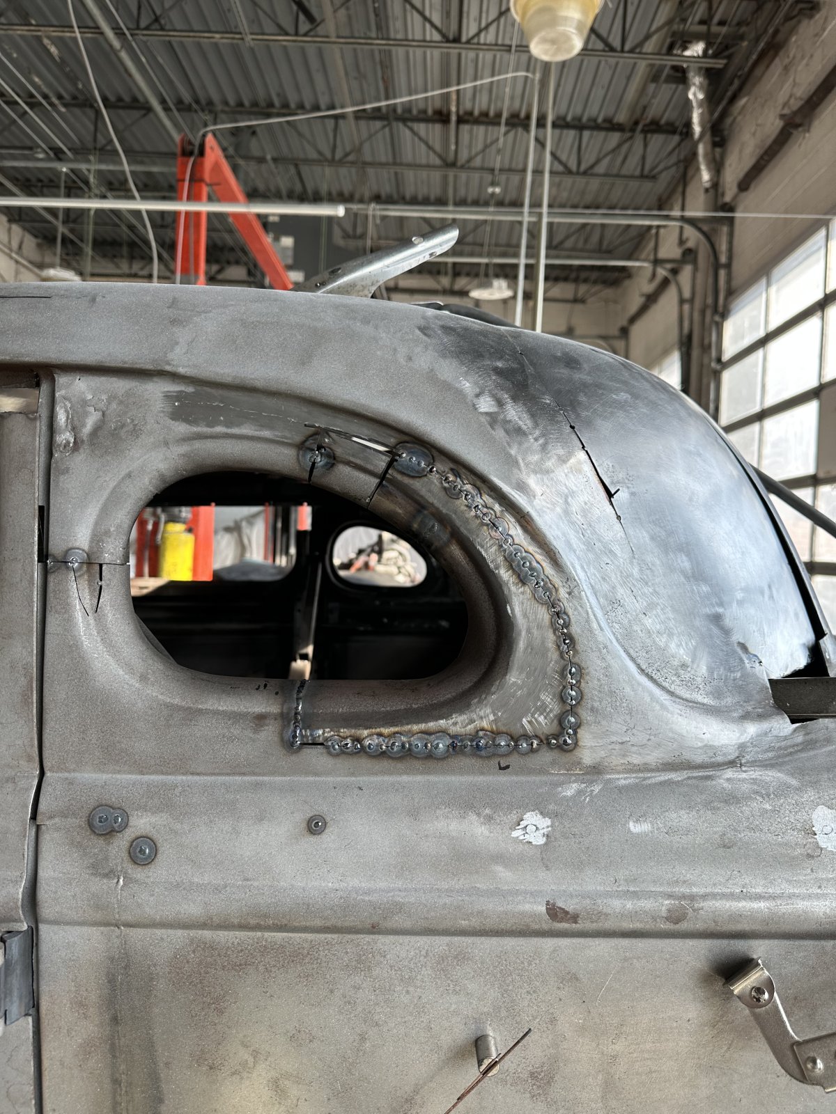

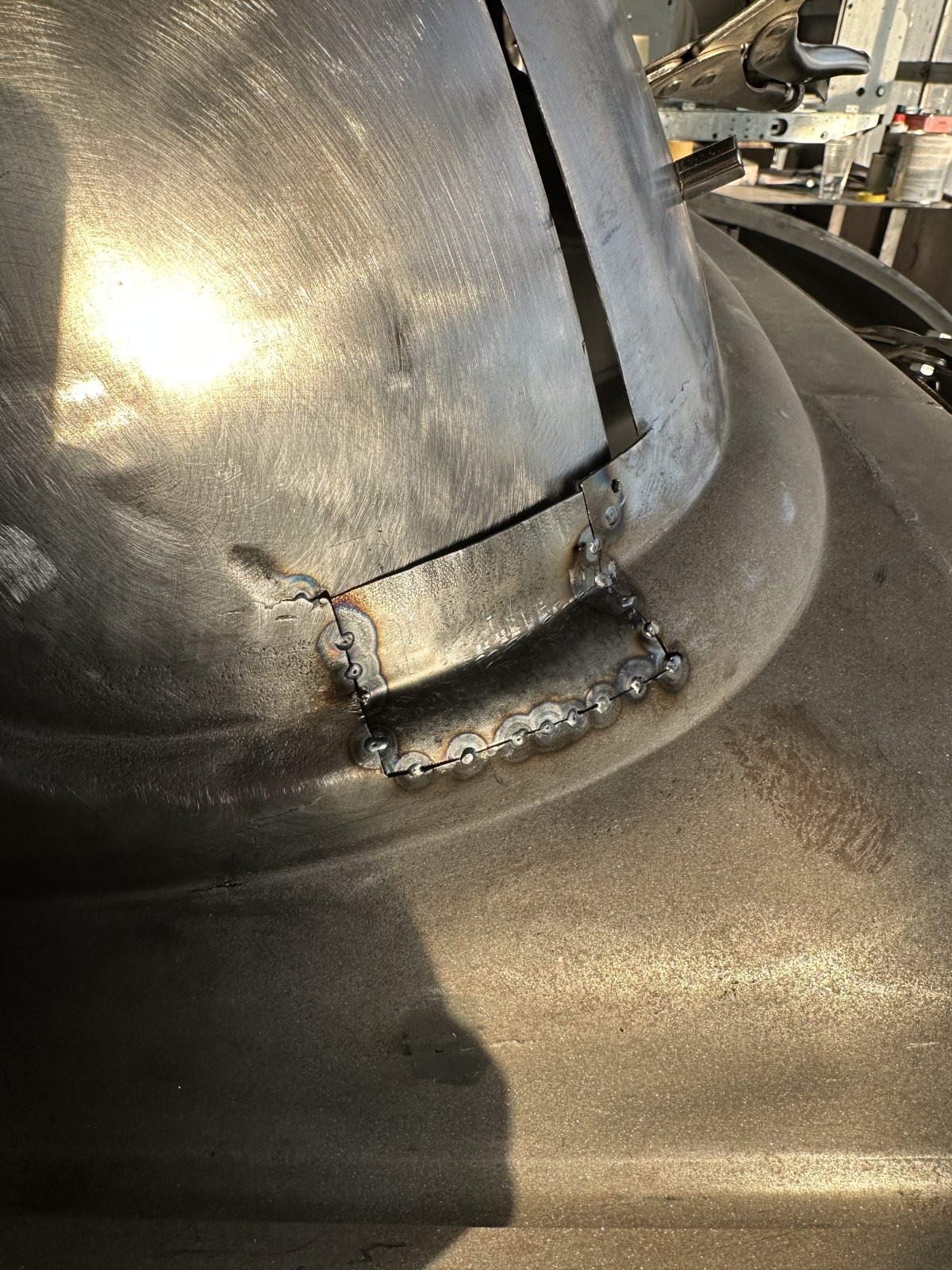

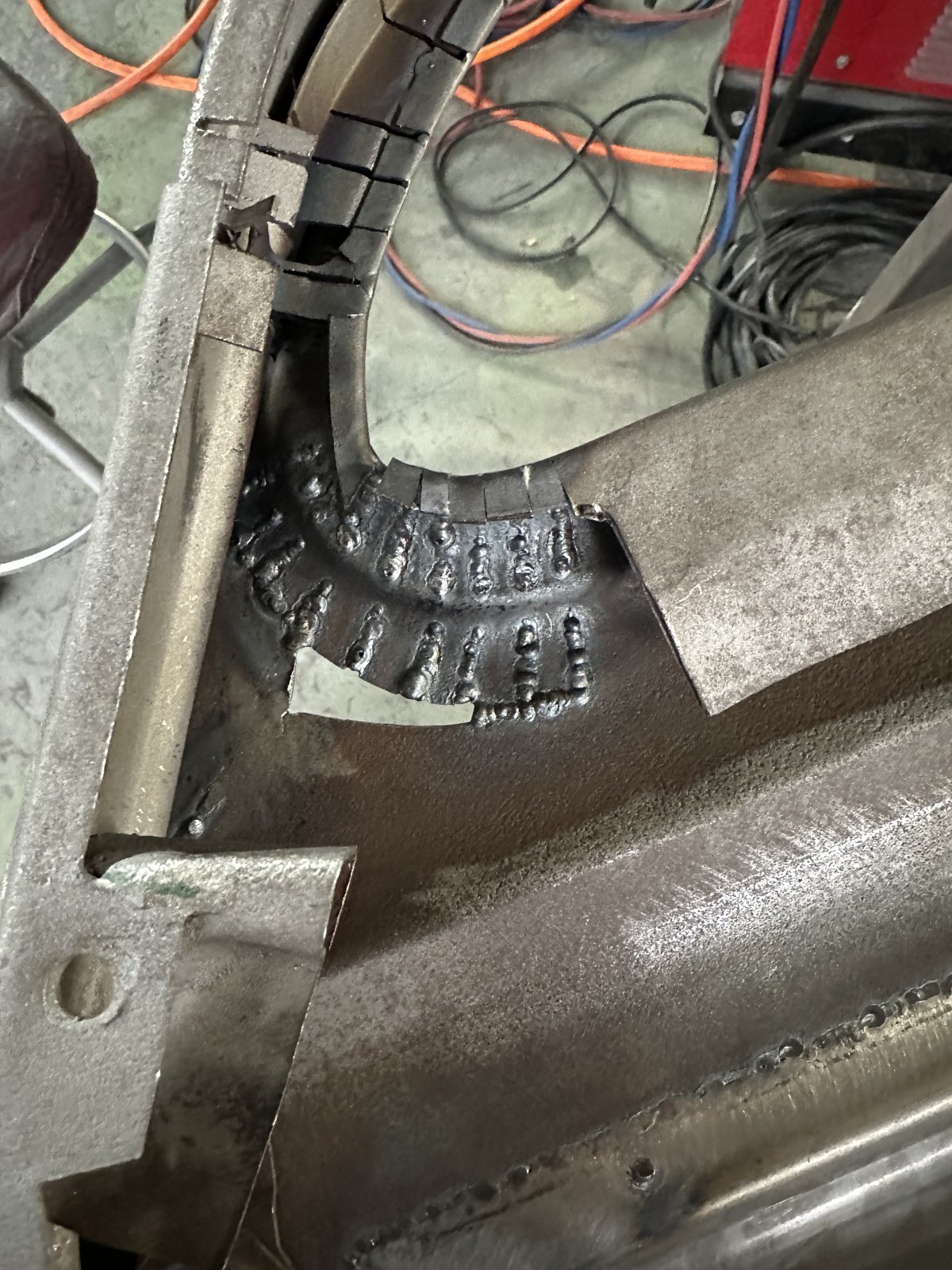

    1530EB6F-8644-4D06-B40E-FD43B23AAC83.jpeg D68E4257-5D05-48FC-8A00-8143C1931032.jpeg 2F3B71FA-E221-4418-935D-311DD82CA56C.jpeg 9F99C45B-0375-4FDC-9423-59A1784CED9B.jpeg 4B7C484D-4F69-4620-BEEC-CA4C4D3A2A85.jpeg 1E73862D-FB13-483B-B140-D4F7DD6DABCC.jpeg B58CC399-64BC-431B-AC3C-857B74DC95D3.jpeg B466B626-E890-4559-B08A-346DE8CDD1A7.jpeg
    adding some material to get gaps right.
    57FAC32E-4391-4865-B9A9-557FA80CBF8F.jpeg C25C8626-9316-458F-9CBF-0CBF3062439C.jpeg D56ADF04-5ADD-4F07-97AE-DF0B0AEE5AEE.jpeg 509F5472-3B14-41F0-BDFC-291150755466.jpeg A39B88F6-6E85-4E6C-BF00-E245622DF3D4.jpeg C304DB4E-F9C4-471C-9CB6-DB680A9D9985.jpeg D701A6A6-03F1-4932-85F9-DA59A21BF15D.jpeg 73DA7EB3-1F83-4EA5-96A7-A0A25417806C.jpeg 2265FB1B-0C08-4FBF-AE03-F4F957A8087A.jpeg CC52698A-02F9-4EAE-AFB2-CACC5A523539.jpeg
    working on gaps. I had to add quite a bit in areas. I also had to cut some inner structure to tilt the p***enger side window in just about a quarter inch to get it to sit correctly. And flow with the b pillar.
    A05D1050-005F-4094-8CD3-AC2FE13D2196.jpeg DE56FDB5-B70A-4C07-B2A7-CB0488E4C055.jpeg
    my dad and I having fun in the shop. Doing a little bit of bonneville dreaming.
    Here you can see the cowl sticking up higher than than the the rest of the cowl. I had to cut it out and make a new piece to fit.
    A9AF1B0A-C032-489A-A32D-AF7ECC4A9115.jpeg AA263AE0-8D78-48F0-82AF-1BBBF6A7ED51.jpeg 48958C58-3F25-4005-BA76-C09DAA1F276F.jpeg 4421C850-5BFA-4F82-9B53-9D762A1D034D.jpeg
    I had to melt some factory lead out as you can see here in the picture above. The leaded both sides like this.
    to be continued on another post. Out of space.

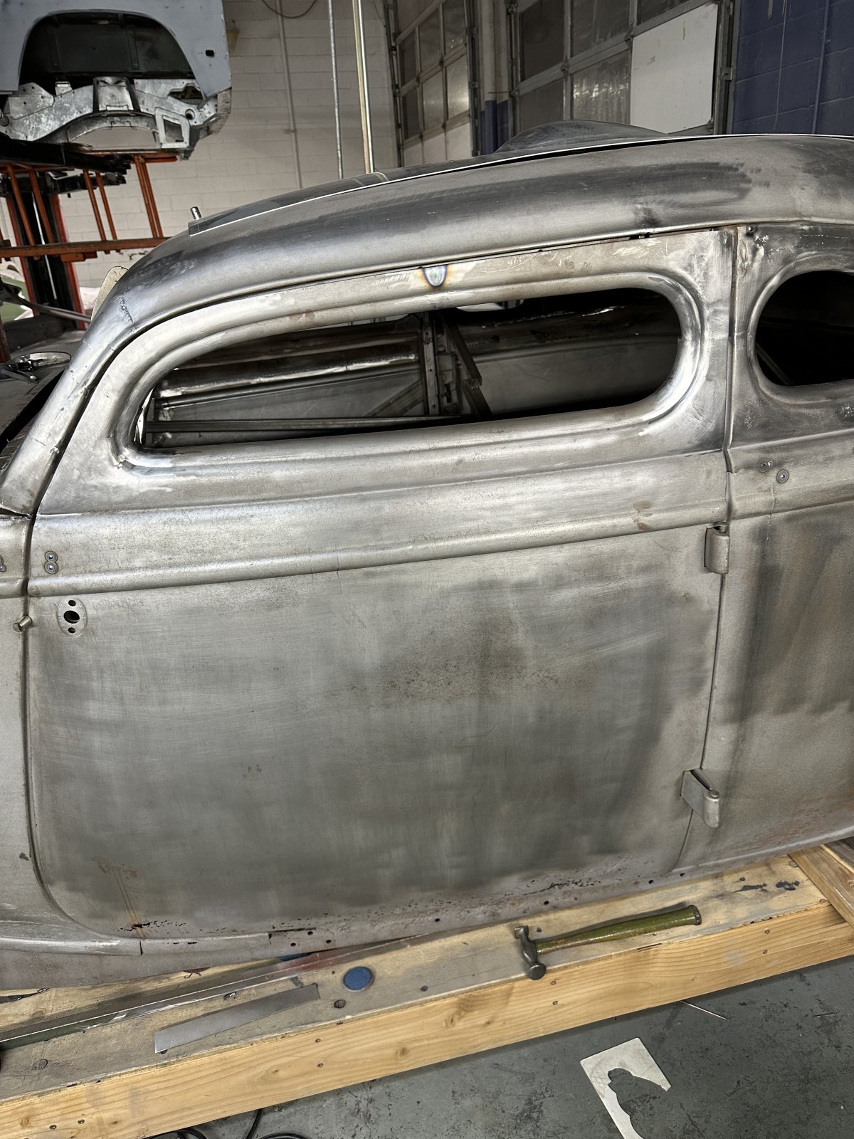

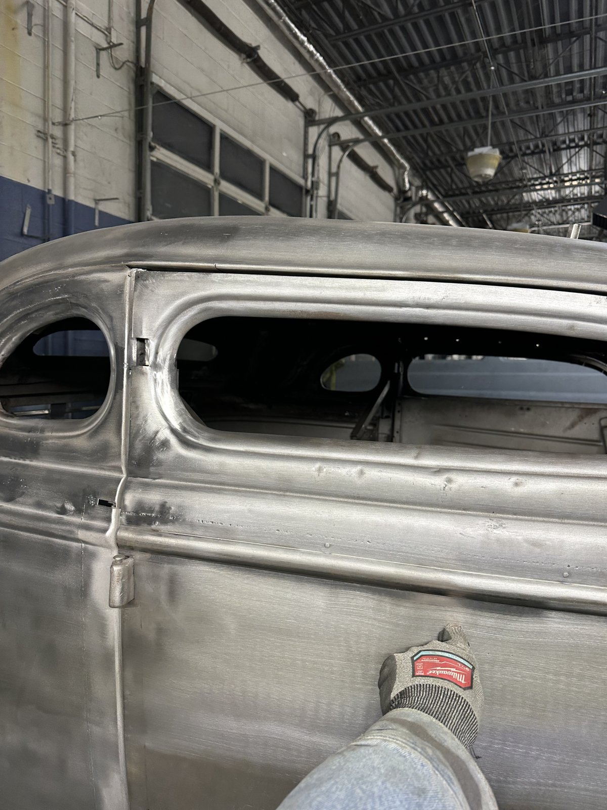

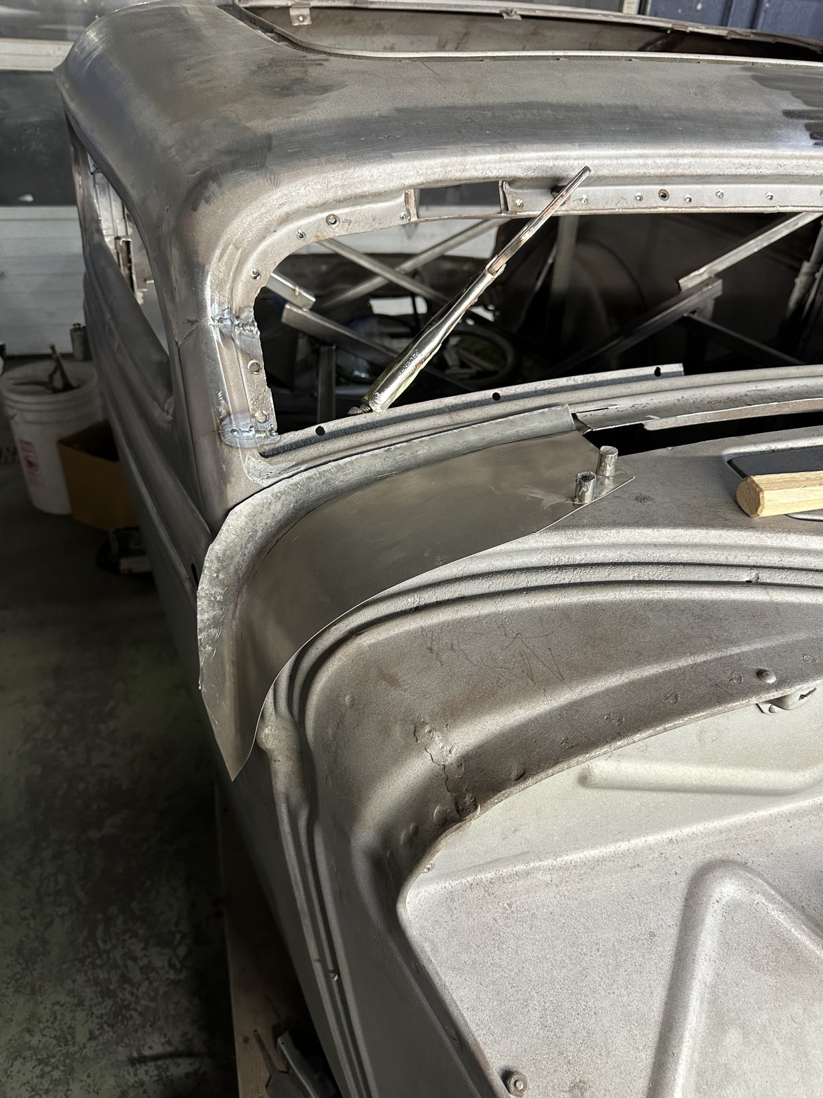

    6752FC3D-6A6A-49EB-ABF7-9F332812B21D.jpeg E97ADCD2-DB8F-4659-9E1B-E4CFF497BB24.jpeg
    677EA17B-53C5-4354-867A-5CBC223331DD.jpeg 4B7AED72-8B33-44DE-A782-54CAD2A254EC.jpeg 6427DE6F-E2DB-4484-84E1-BFC620B98377.jpeg 97055D14-A86C-4738-B978-7AEF485B2FB0.jpeg 8E925F29-D04E-4F1E-B9F4-4CA5F0A32269.jpeg 35B71BF8-B906-4D54-9C0A-BB97D3E7DA58.jpeg 82BD29A3-52E8-4686-902F-BCFFDF107F3C.jpeg
    this is a part I think stylistically a lot of guys get wrong. I like the way it looks when the bottom of the a pillar flows with the lines of the door. I made a little piece to correct that.
    4A6FEA6A-B02B-44D1-8476-13A42798208E.jpeg 5C0B5E1F-23E3-4385-B9C9-0A300CF693CC.jpeg 26BE82C1-5A1E-4D2C-94E4-BE35C44868CD.jpeg 665CE286-EE44-45B3-891F-CB2C04AFEB98.jpeg 061E9DF5-52AC-49CA-B252-71764B7C8B04.jpeg
    here it is for the other side as well. Ok that’s it for now. Thanks for following along. I still have so much work to do. Its all of the small monotonous things. But those are the things that make it look good. I hope!
