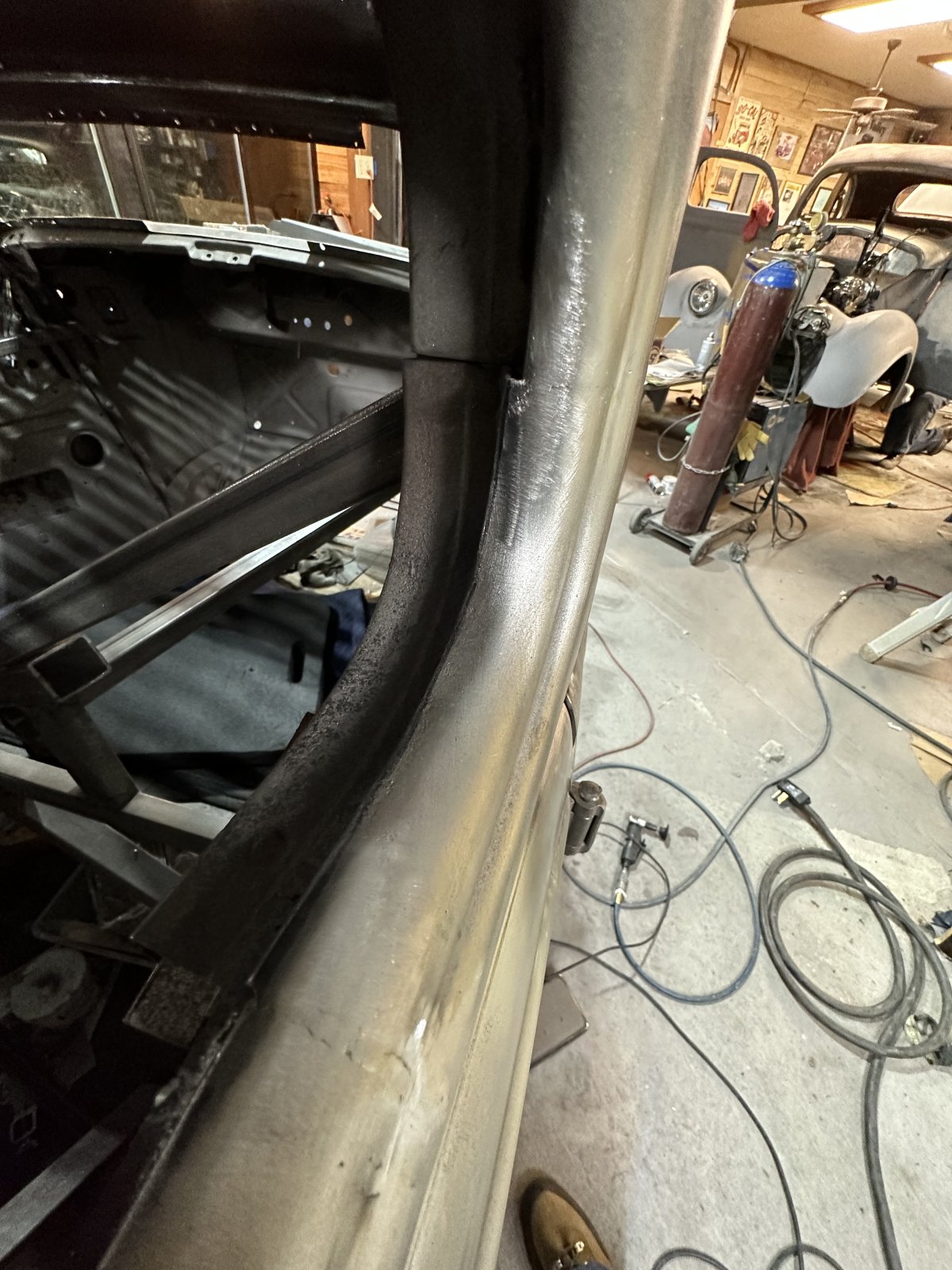

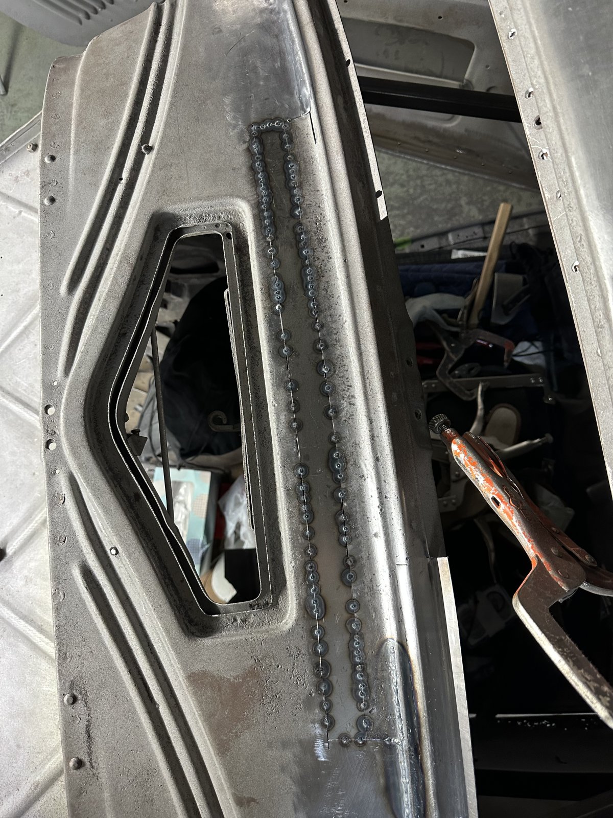

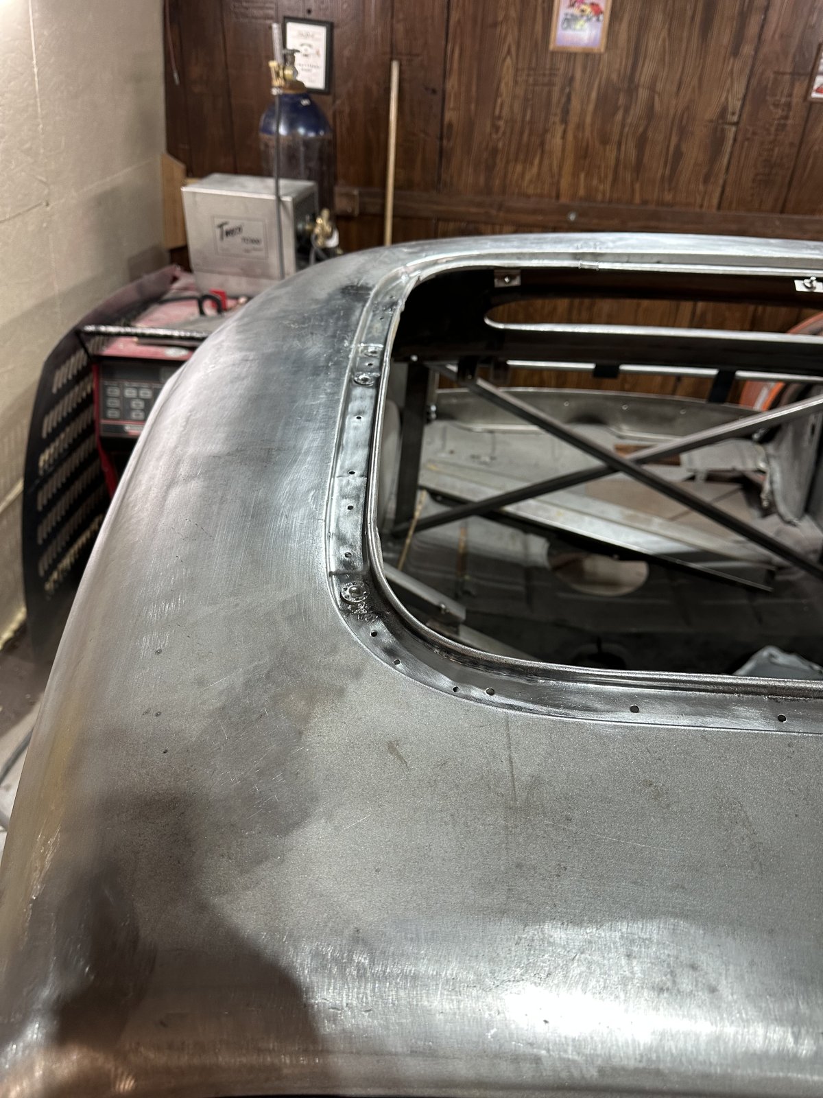

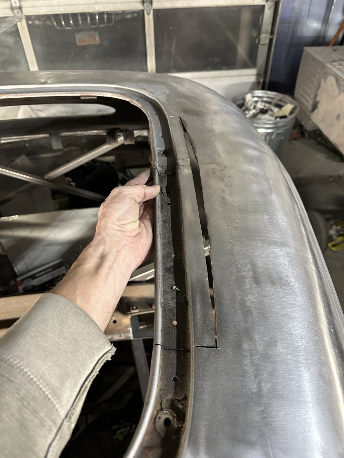

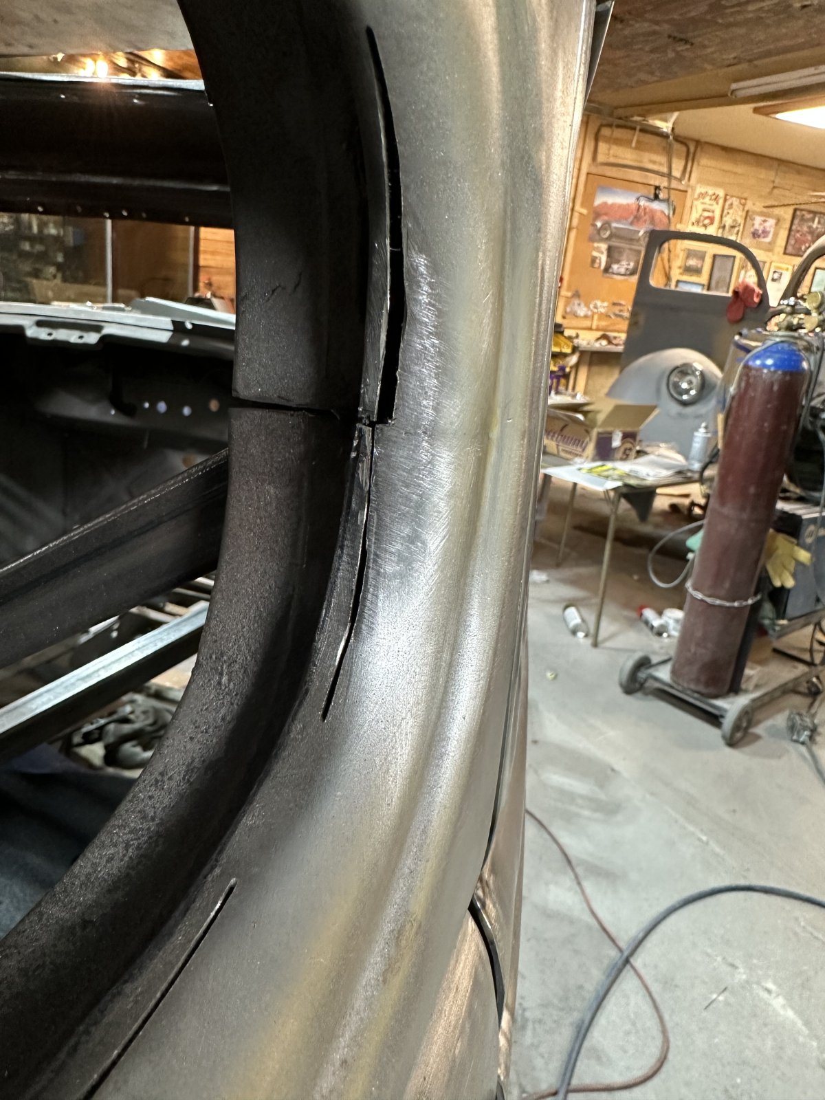

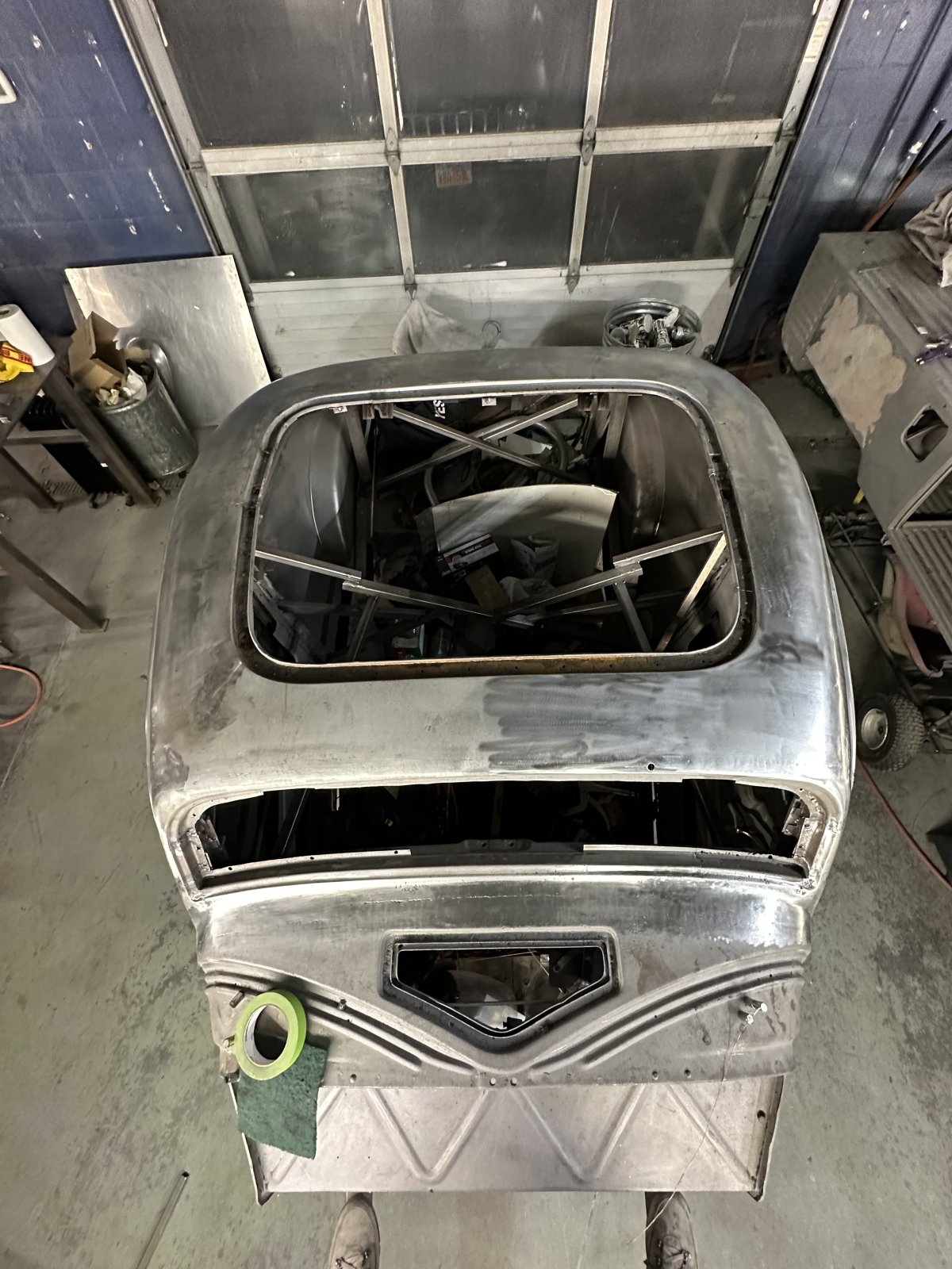

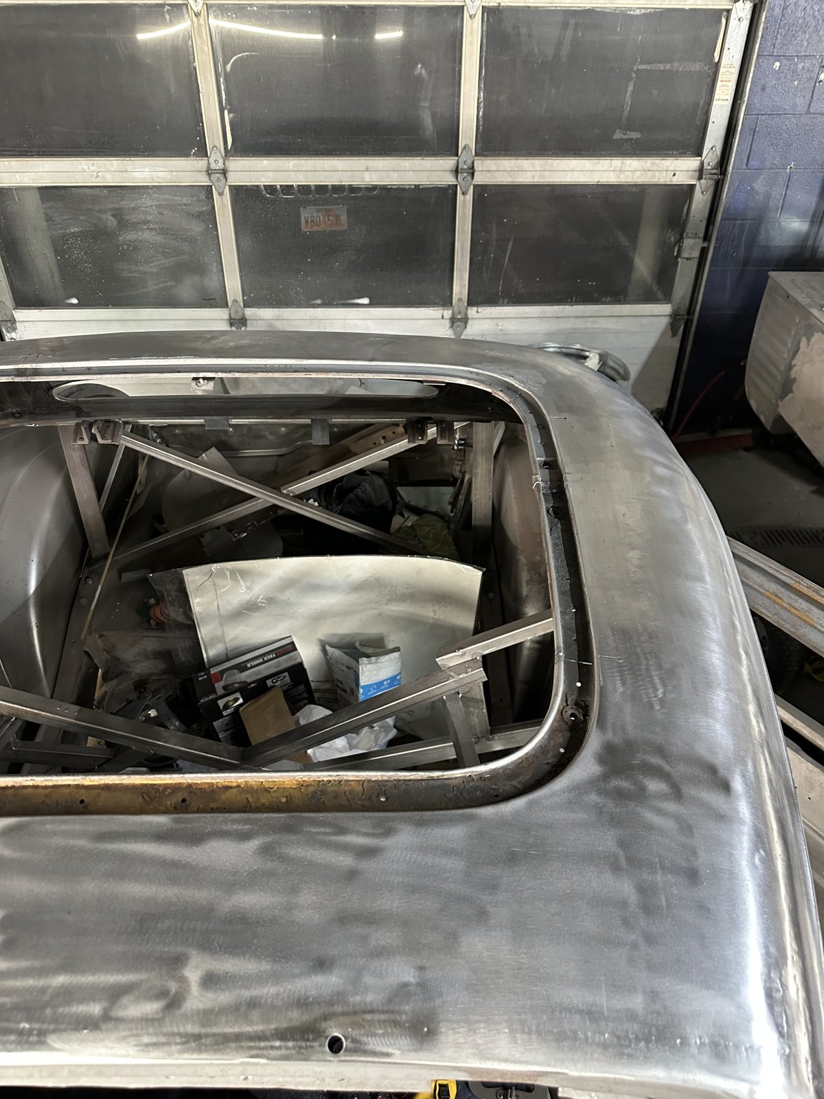

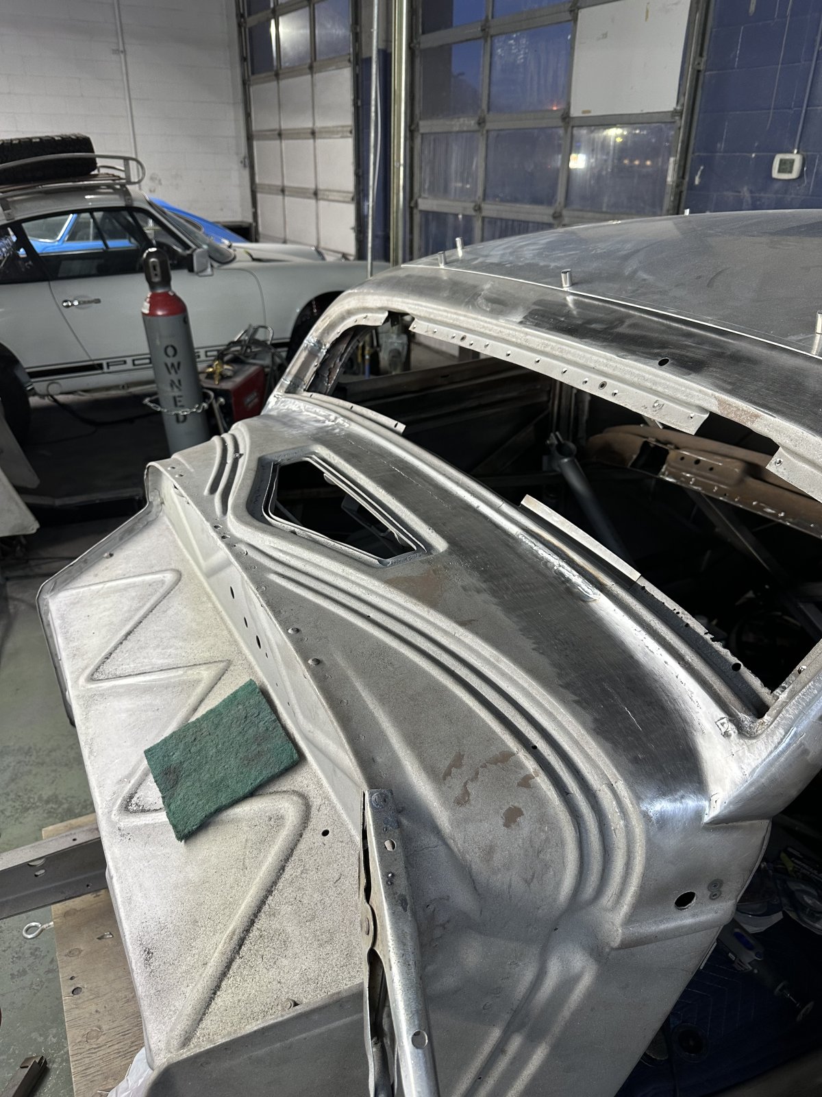

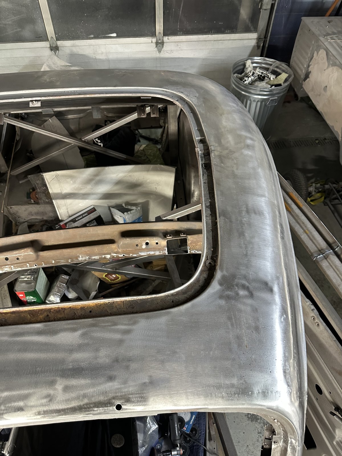

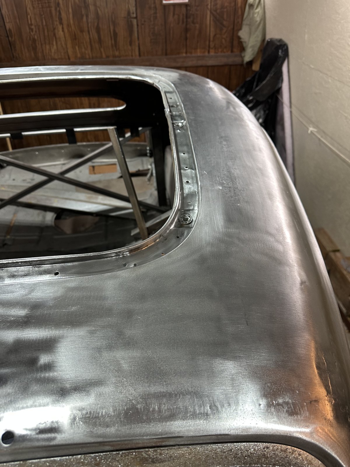

    DC22600D-789F-48AA-9292-F6CC01B8D432.jpeg 2801569D-B126-41D6-ACC3-CD37986BBCD8.jpeg 079018BA-7994-4861-98A1-B0B6C605A5E0.jpeg CAD3FA86-9C87-4FD4-827C-F64ACB77BB35.jpeg

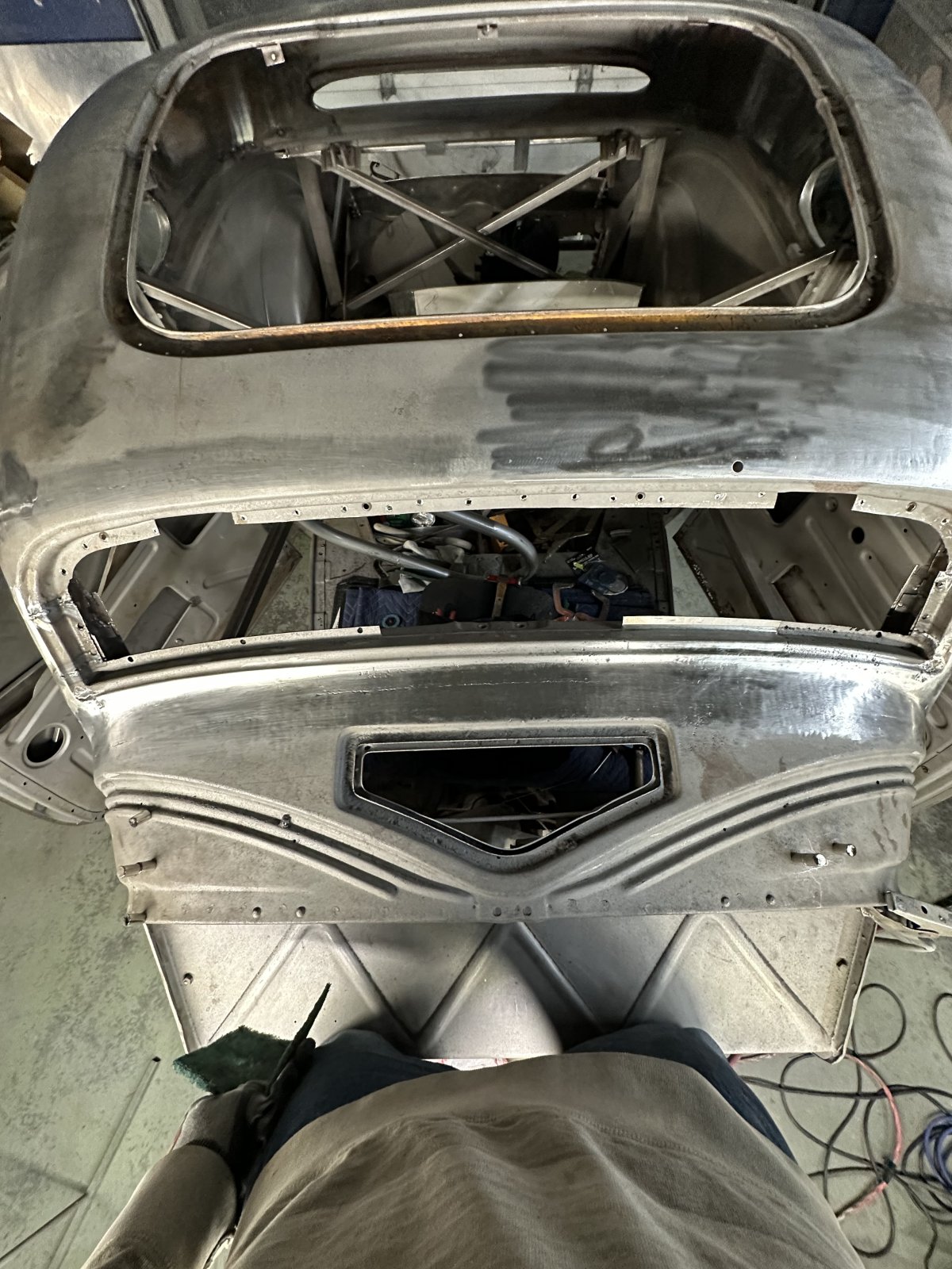

    just finishing up the cowl. Still needs some fine tuning but will do for now.
    As you can see the sun roof driver side (and p***enger side) are not fluid when fitting the two tops together they didn’t mesh perfectly. I’m going back in to blend the two together. 0BC7DFE5-BBC8-4E97-8ECA-0B5FC54E523E.jpeg 4D6F4372-F5F8-4E7D-B441-249C75D6C968.jpeg 4D6F4372-F5F8-4E7D-B441-249C75D6C968.jpeg 9FA578CC-4392-4C69-BDD3-1F2E9B90499D.jpeg
    here you can see the right side done. Thats it for today!

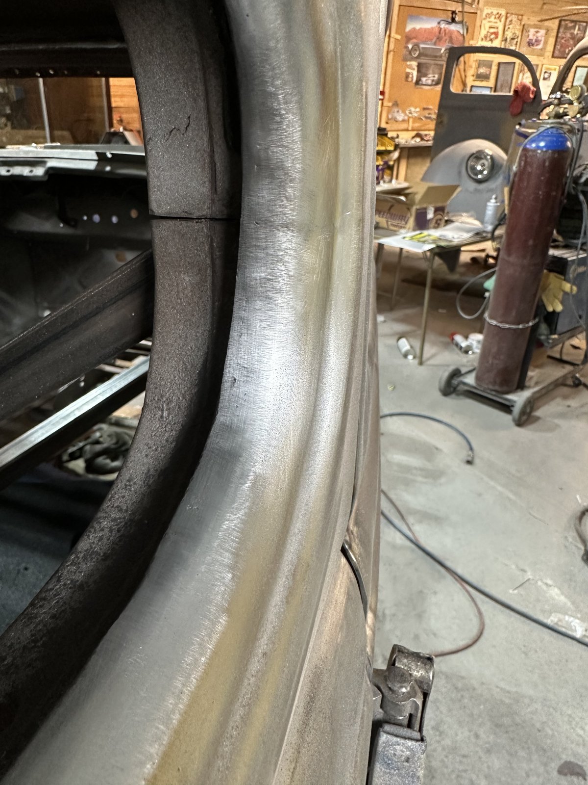

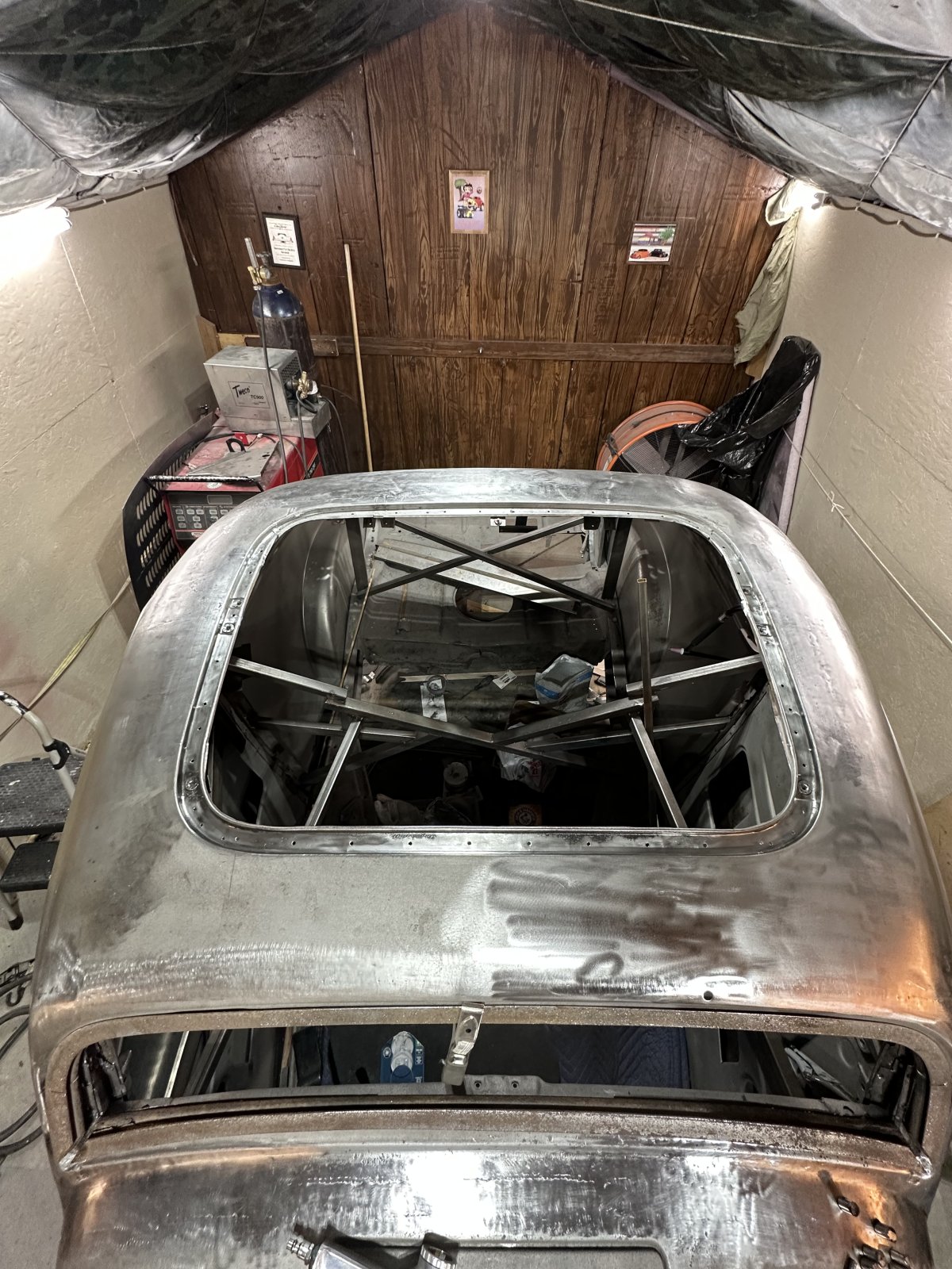

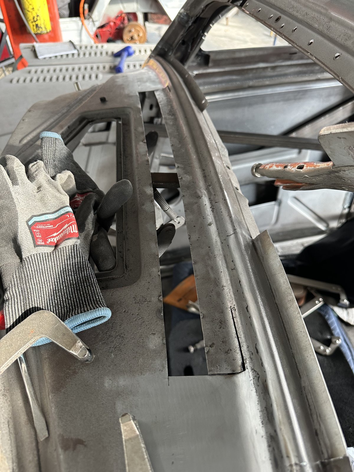

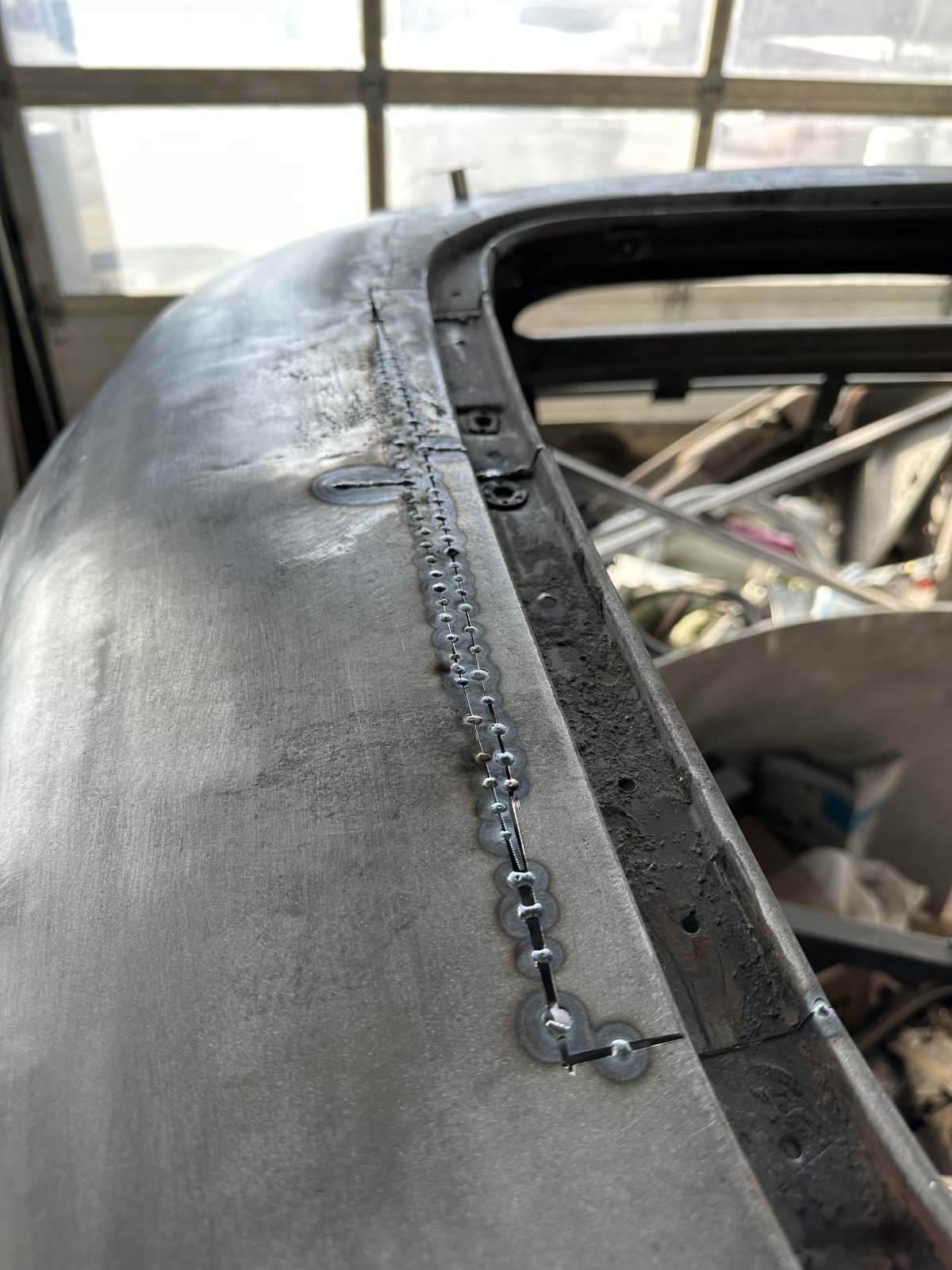

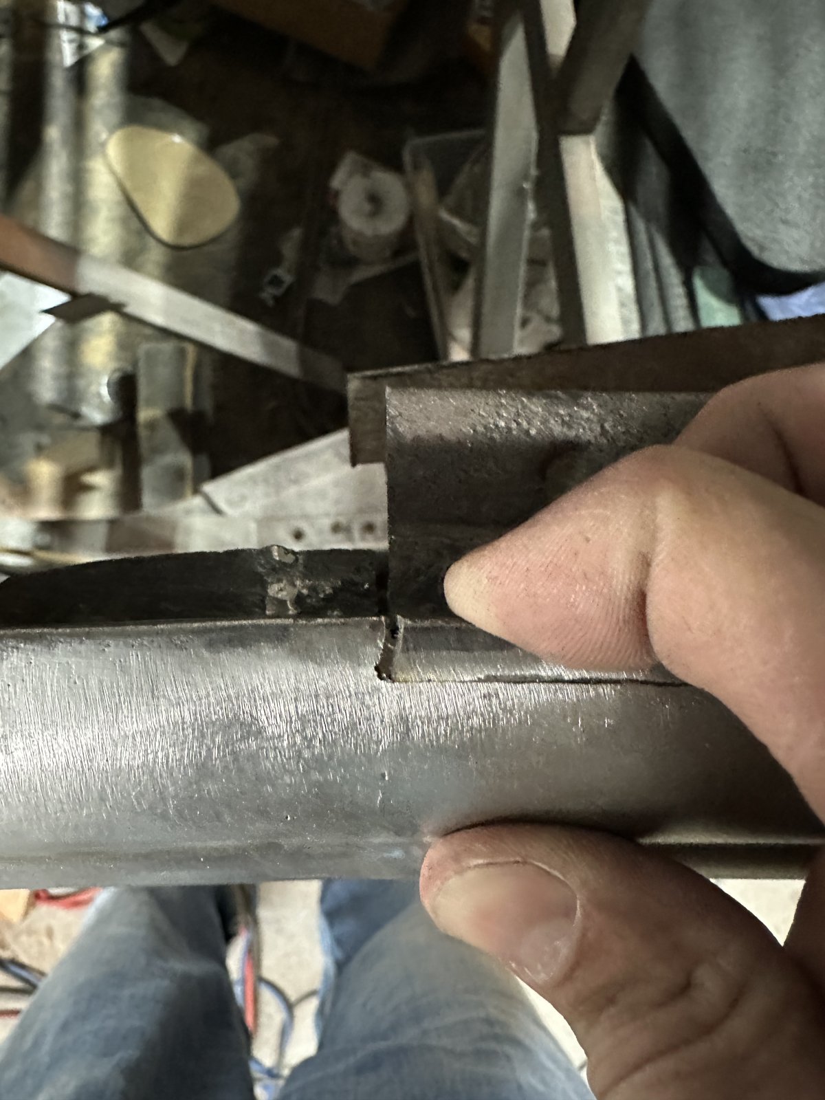

    94CF5B30-CC3B-48B2-ABCA-C95E8072F26A.jpeg 46702415-5388-40CE-8732-FAD0C8C821CA.jpeg CF4C28EE-E5DC-4D1D-B7A8-BBF39BDF10EF.jpeg 51DB906F-712D-4613-81A8-198433B72BA8.jpeg

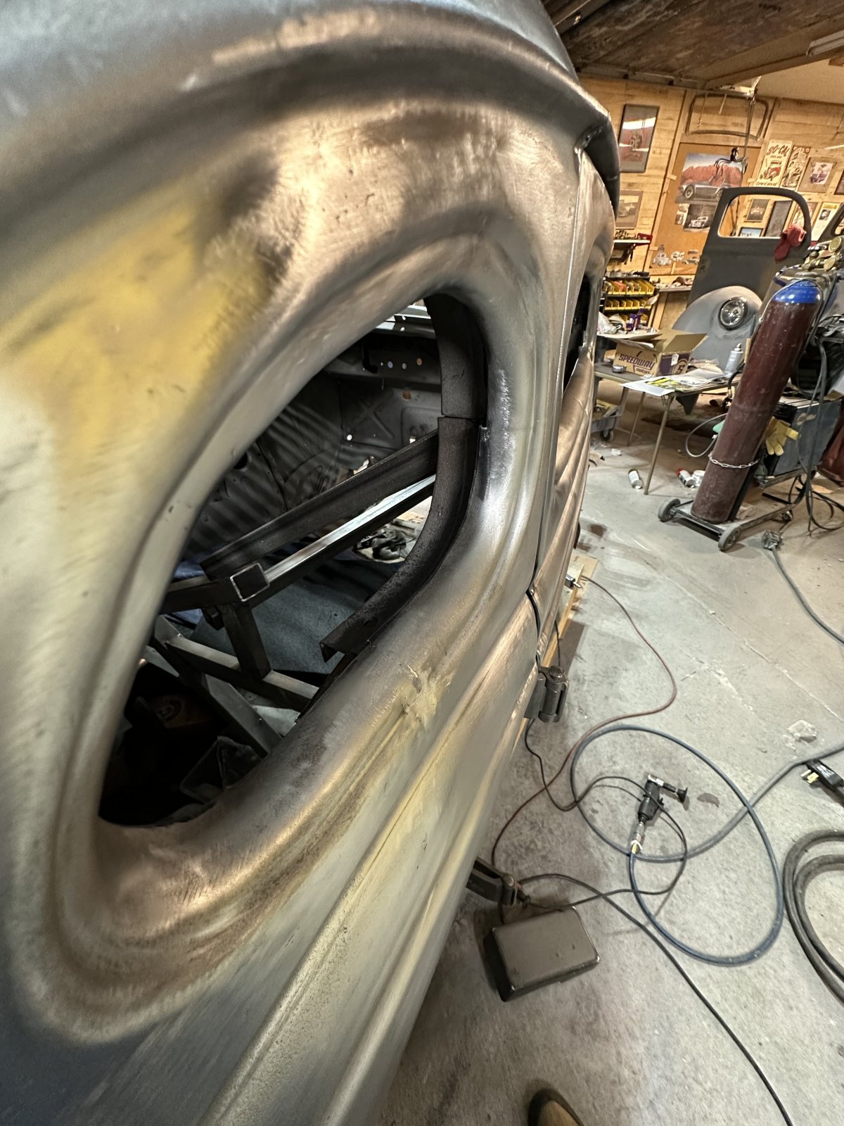

    Well I had to move out of the shop I was in. Luckily my dad had a good friend that was willing to let us keep the rod at his place and work on it there. Hot rodders are some of the best people you will find. Here you can see that I was able to get the sunroof straightened out enough I think it will work. Had to dump a lot of heat into that sliver. Luckily it planished out fine. 0E784E36-33A7-4C25-8D78-591BA23C9A9C.jpeg
    FCB0AB6A-8E4A-4EC9-98B1-798DF205A4B7.jpeg FA064A93-A90F-47A5-A1DB-C81F9625585A.jpeg 6513BE45-CBE8-4D02-B27F-F32853E4FA04.jpeg 60D1D6AC-7E25-4394-87DC-5EB8225C3CD7.jpeg F03E0724-30CF-4875-8FB5-DDF776F92DC2.jpeg

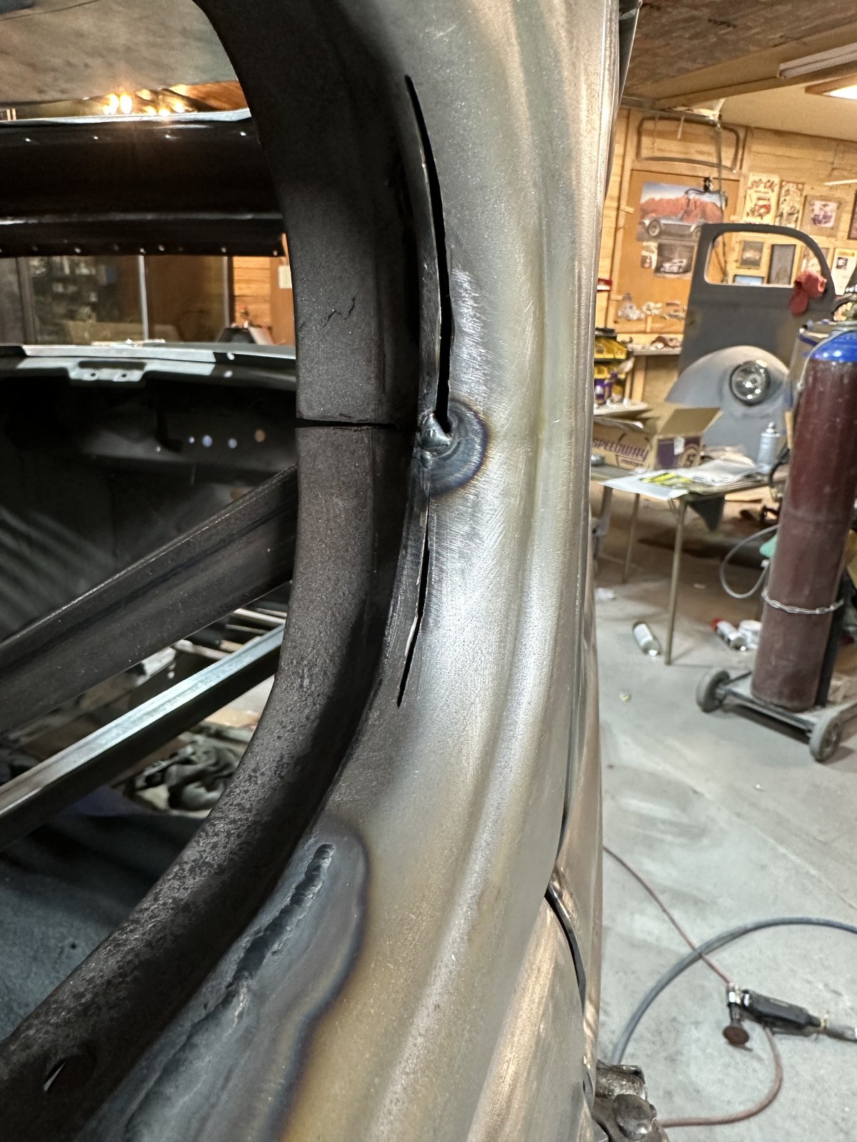

    Here you can see the staggered gap on the inside of the quarter window where the car was chopped. I had been brewing how I was going to tackle this problem for a while. The gl*** won’t fit flat against the quarter window obviously. A friend gave me the idea to do it this way and it worked out great. Unfortunately I don’t think it will work as well doing it to the front door windows. I think I will have to shape a piece and weld it in the front windows for the gl*** to sit flush. I also fitted the hinges on the trunk and installed it in the car. I was surprised at how well it fit. It will definitely take some fitting with a little push and shove but I think it’s gonna turn out nice. Will try and get pictures of that next time. Have a great day!

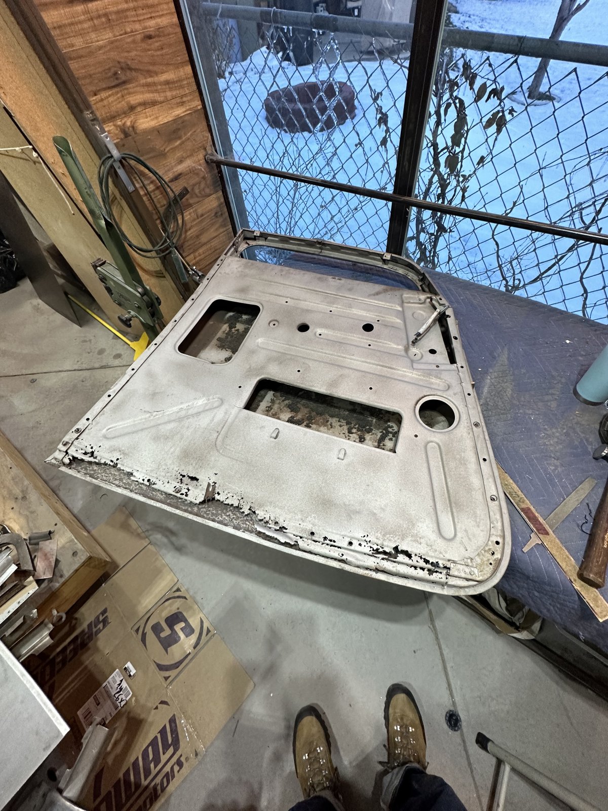

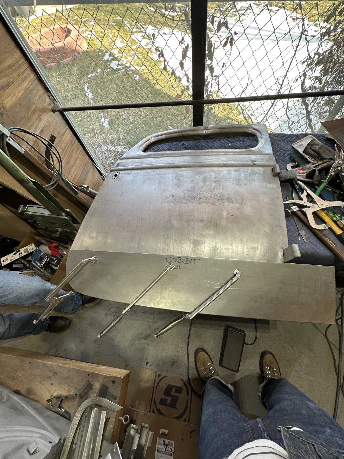

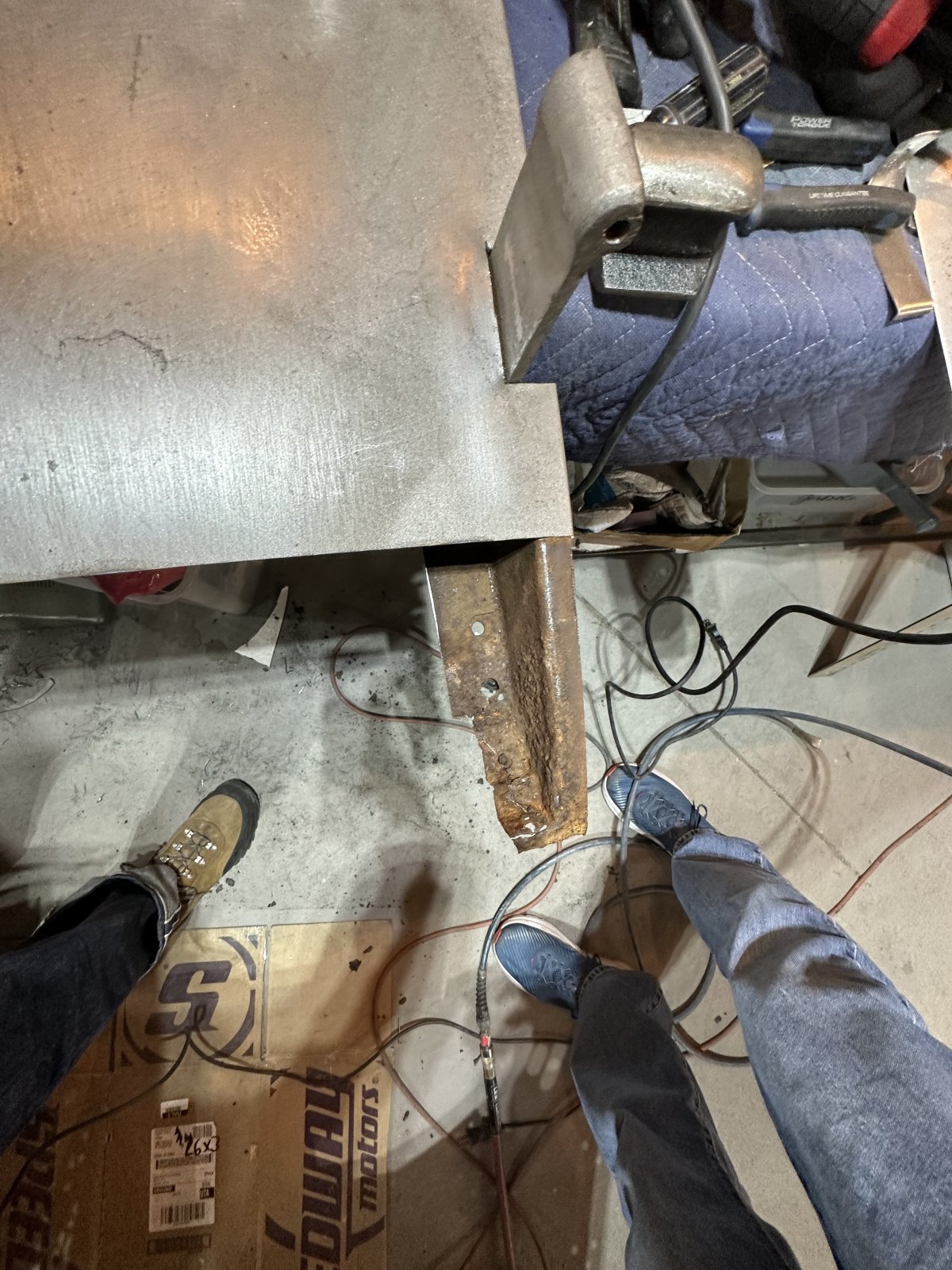

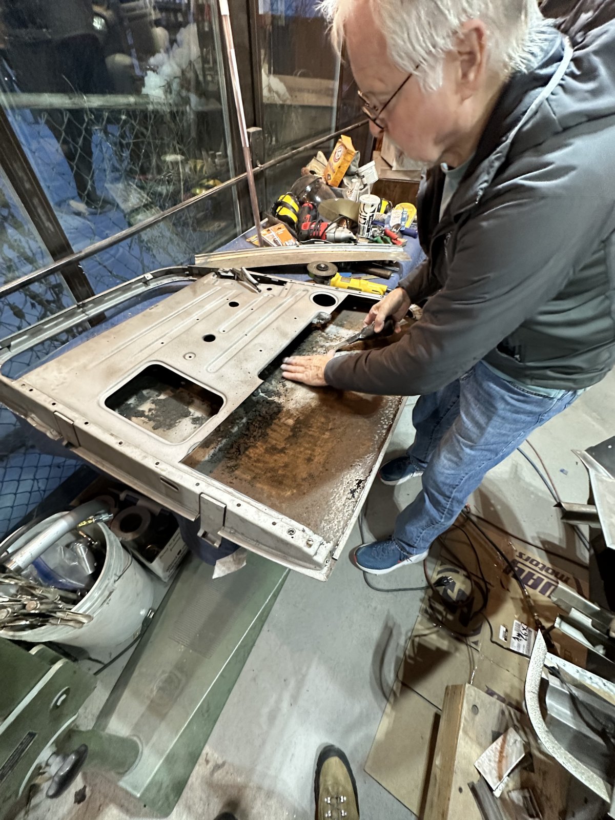

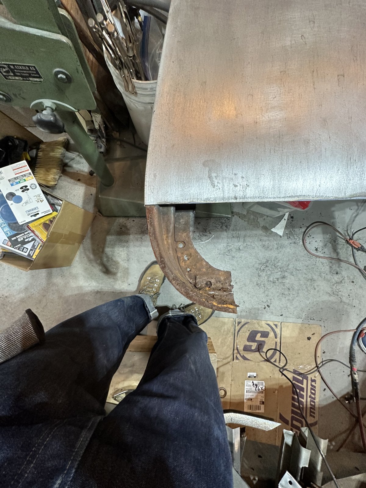

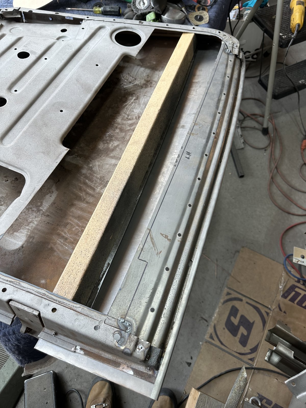

    03E12E8B-5E1A-4E7B-9BC4-5FD7CEE94163.jpeg 7F50A95C-220A-443C-9962-7239C1F5628A.jpeg D7ABF88D-A91B-46EF-954B-ED485663FAF7.jpeg 54015E3E-2903-462F-A9F7-F7B32A103F33.jpeg 474015D5-BD51-45F9-9228-ADCAEE8C32BC.jpeg DC26A2D2-C575-4224-9E3A-9AC3694A44F0.jpeg 3C471C63-DF8D-447B-92CE-01DCC3D1F97E.jpeg A1DB08CF-169F-471A-95AF-7D1FDFBF8627.jpeg

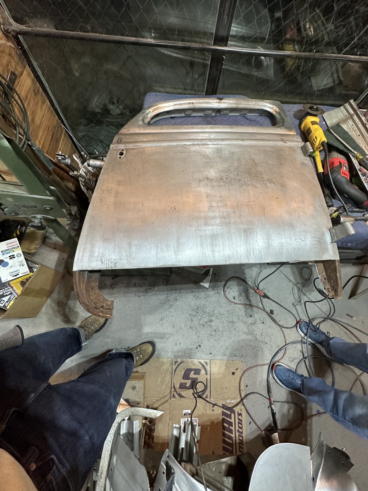

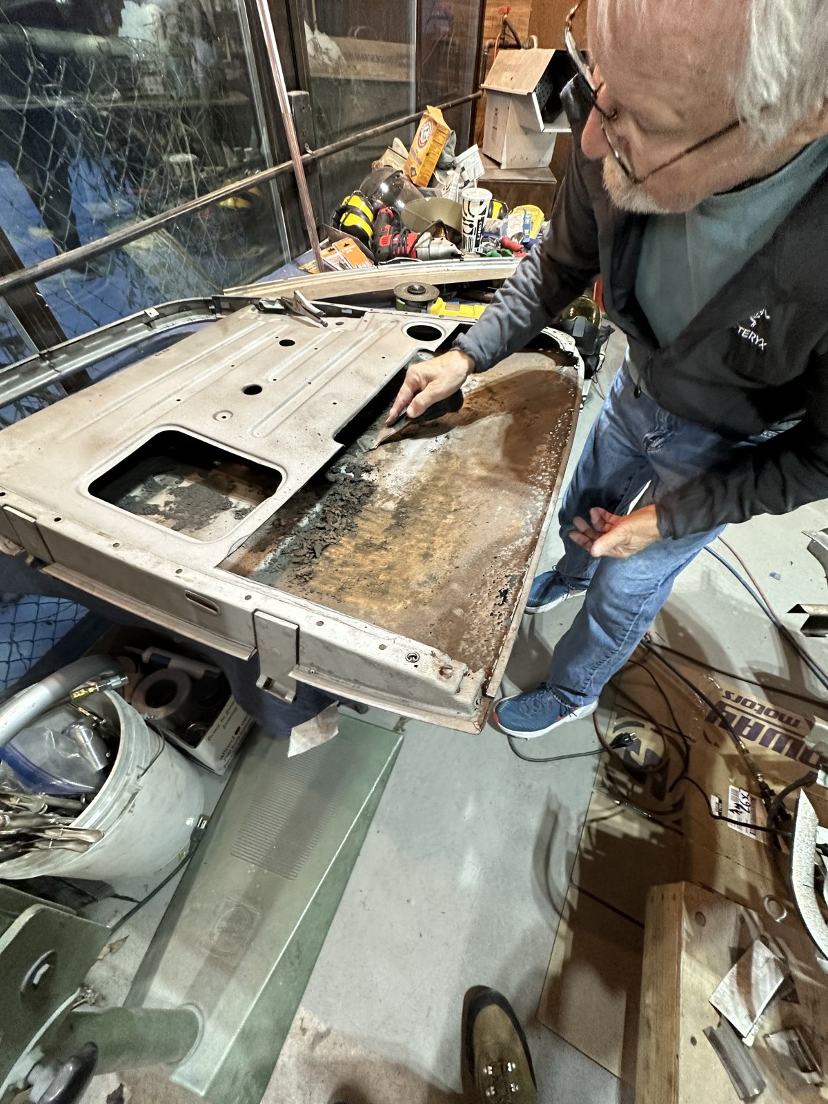

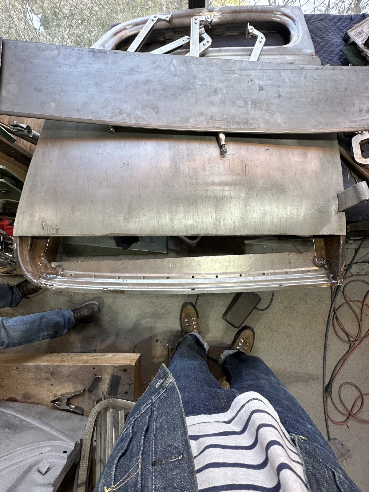

    patch panel day. Cut out the door panel and the bottom section of the door, along with the lower door skin. Replaced with new door bottom. Was pretty rusty and had to do some minor repairs to the structure. 62A81B50-094C-4F9F-B8F0-F5B8271762B3.jpeg
    I fashioned a temporary piece of wood to hold my pre existing door skin in place while I tacked on the new lower door skin
    The 39 guy, -Brent-, brEad and 7 others like this.
