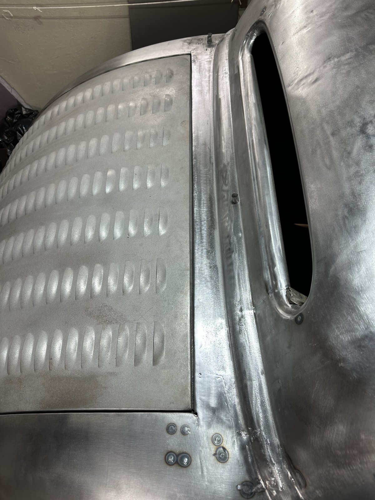

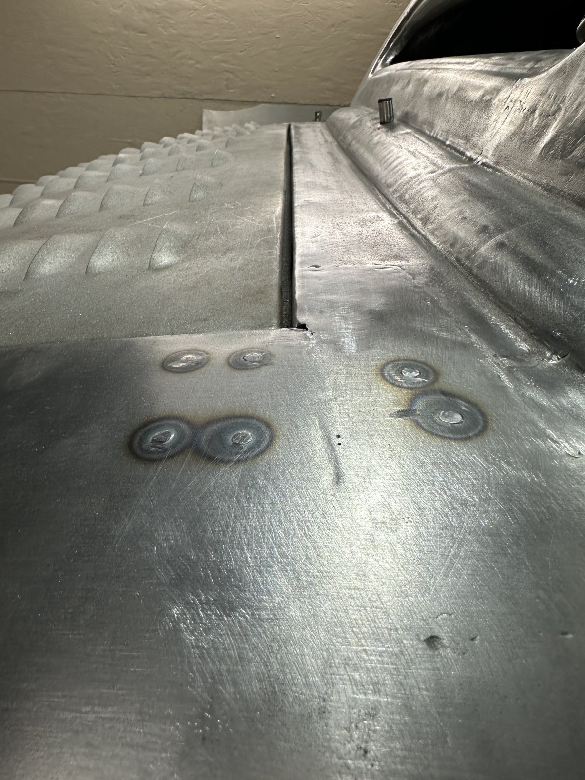

    51DF1314-05C1-48C4-9B93-447D52D81CB3.jpeg I’ve been dreading fitting the trunk for a few years now. Decided to finally try and tackle it. I’ve been wrestling the trunk lid on the ground to get it to fit properly. It’s getting close. It’s tricky getting the hinges the right height and get everything tacked in place. As far as this gap goes its took some extra attention. I decided to weld in a small flanged strip of metal to make up the difference. 49BE485C-F156-443D-9275-5B54C3B20CF7.jpeg
    getting it tacked into place.
    That’s it for now. It’s close. Gonna take some fine tuning as always but getting closer.
