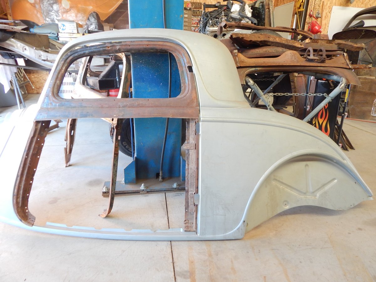

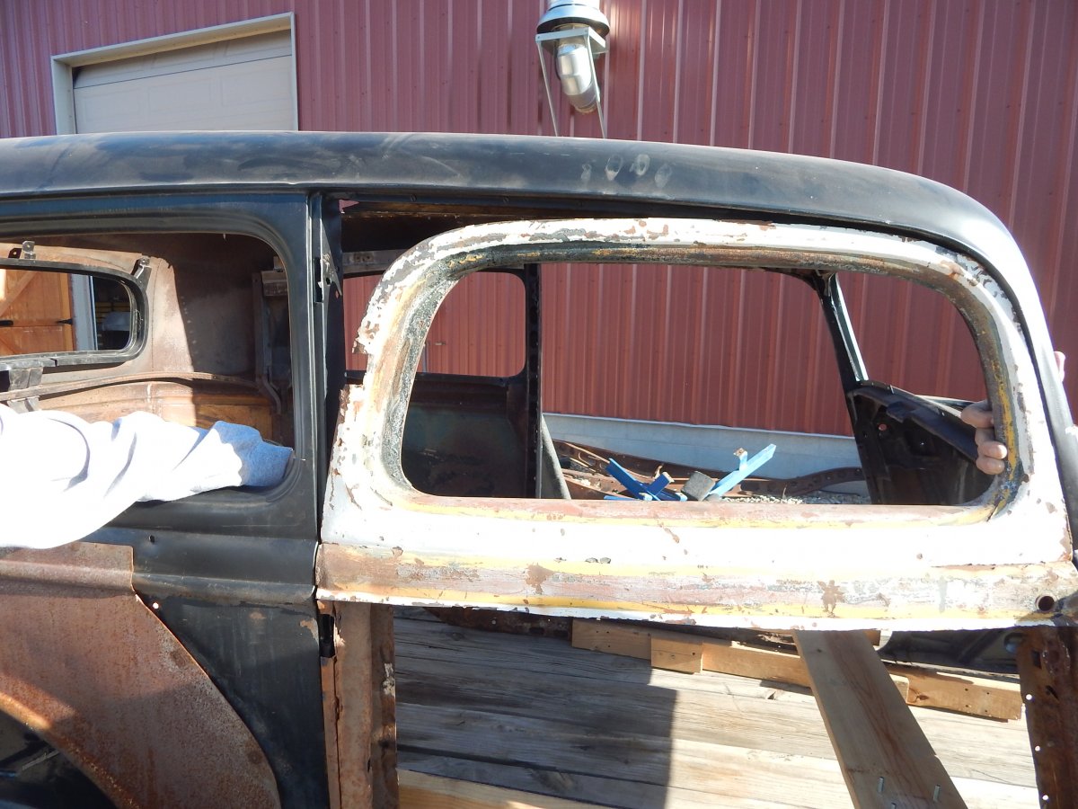

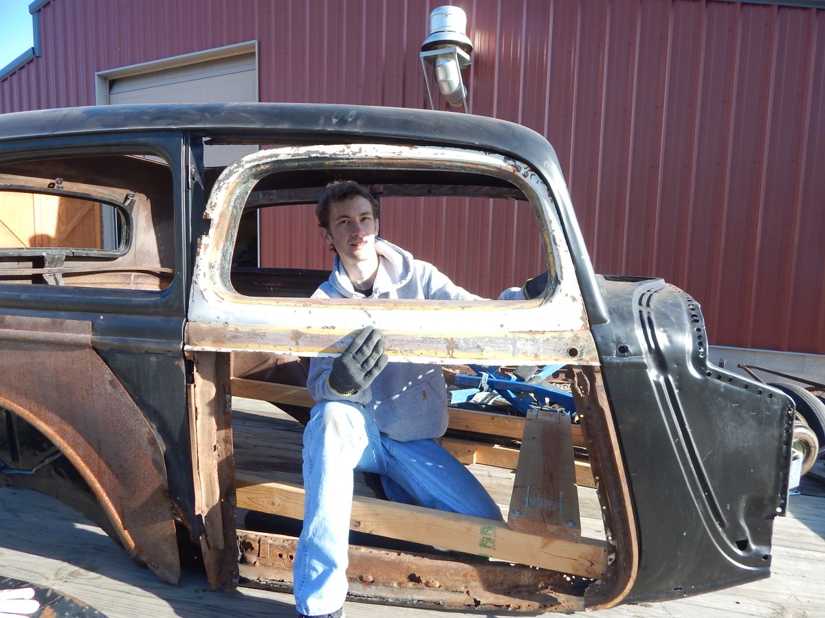

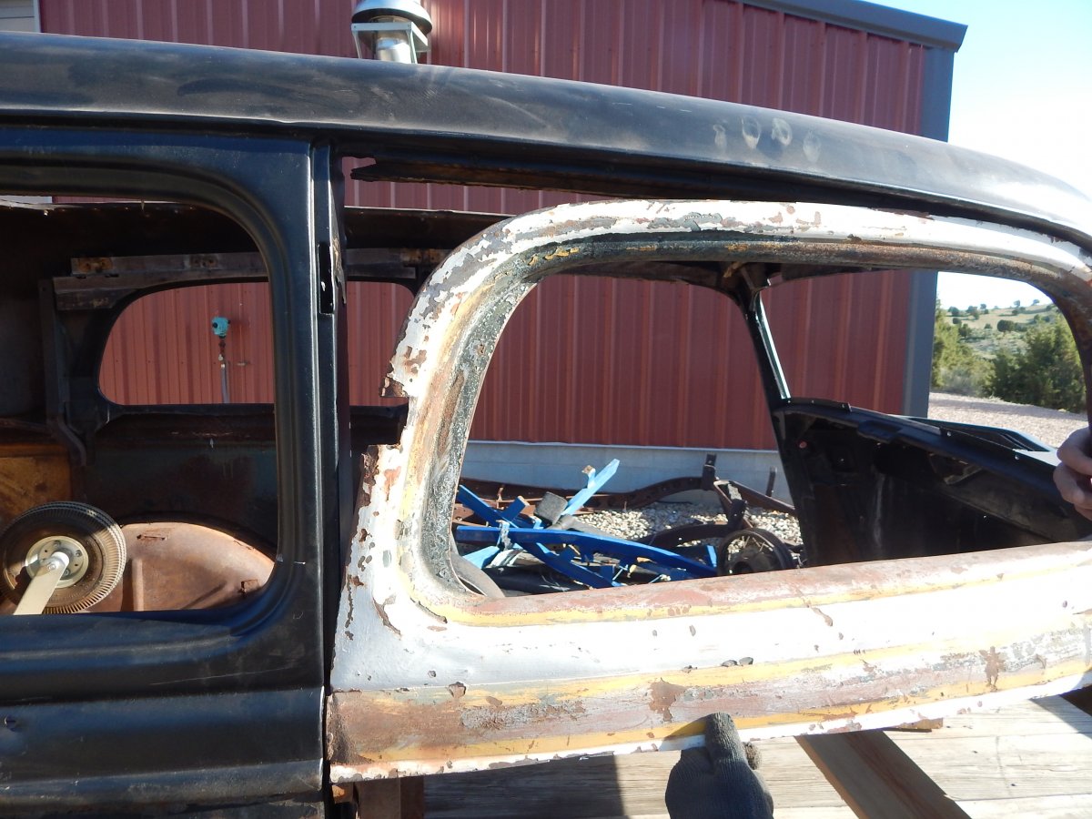

    The seller in Salt Lake City had a 3 window door that needed a skin,so we offered up the door to the sedan to see profile differences,interesting to see how the profile falls away at the top of the door ,not just a radius difference.
    DSCN0321.JPG DSCN0322.JPG DSCN0326.JPG DSCN0337.JPG last pic,seller bought a SAR body sides a whilst ago,he plans to put together a 3 window himself.

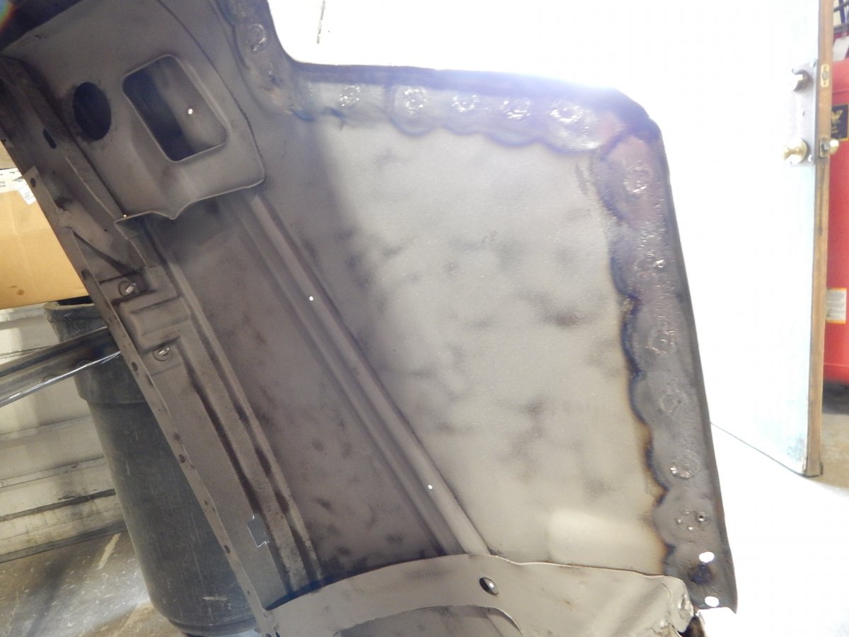

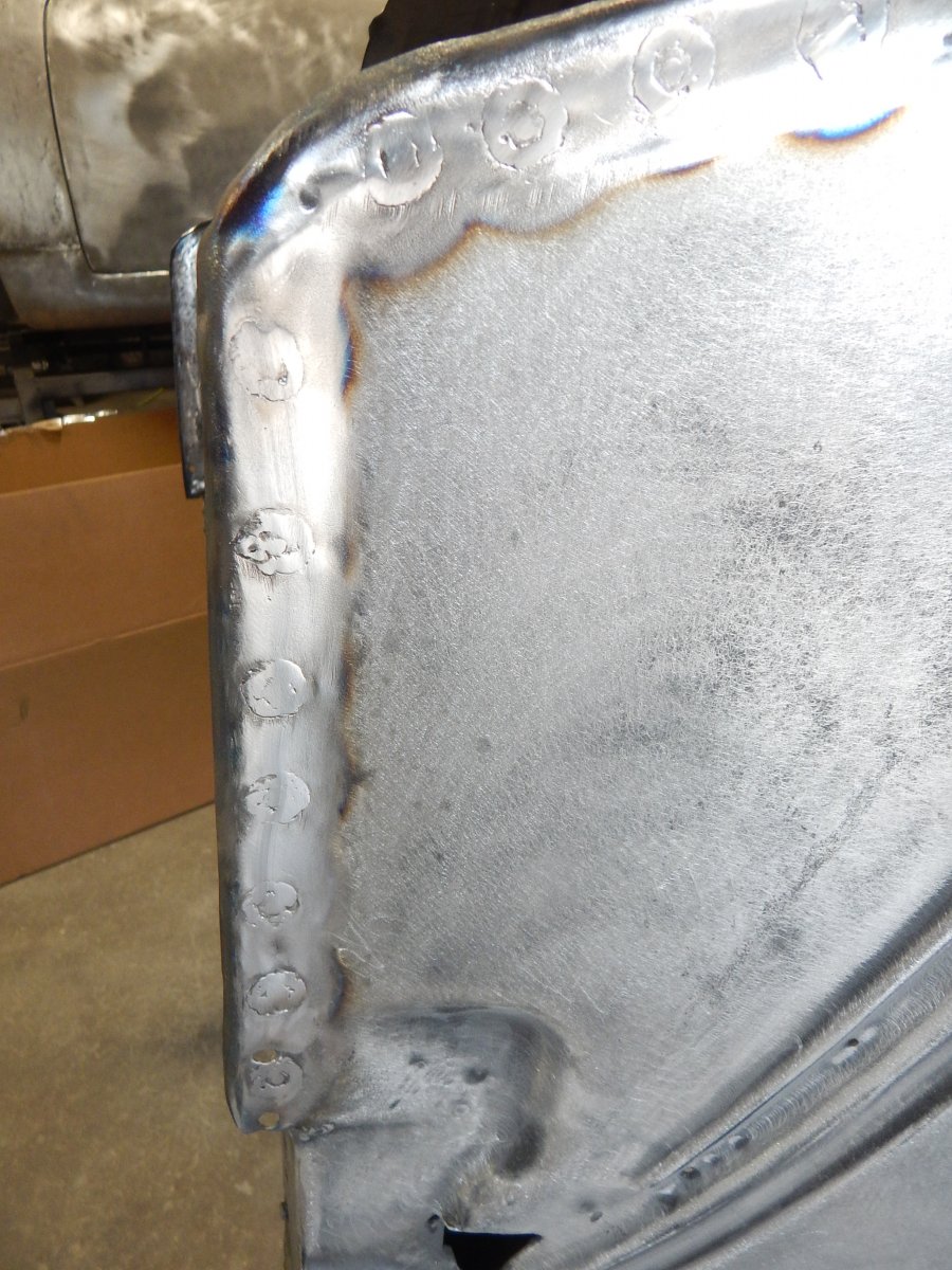

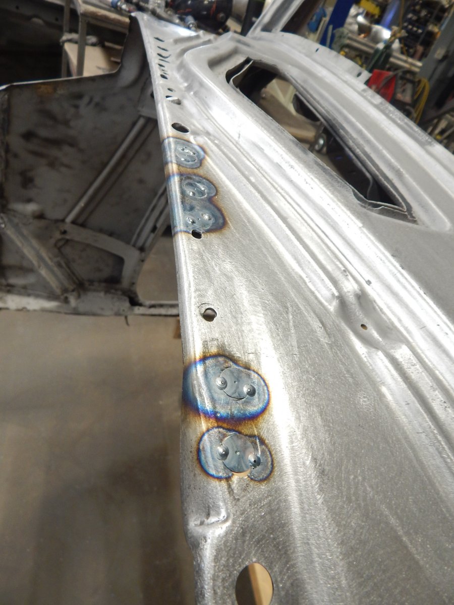

    Conner Tig welding in the oversized drilled out firewall holes.

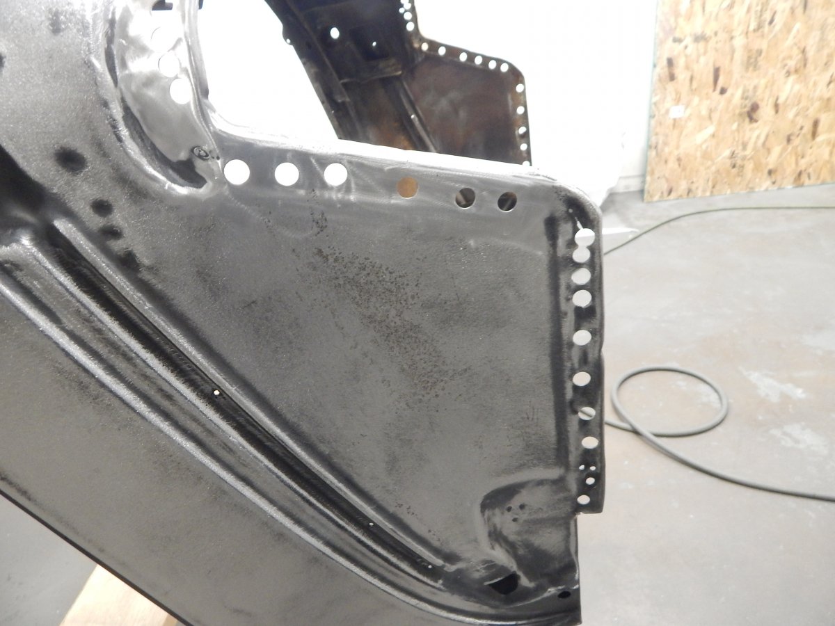

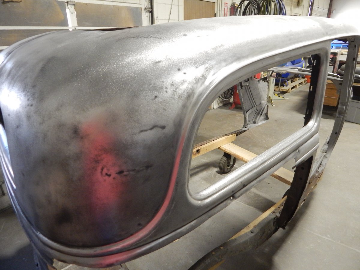

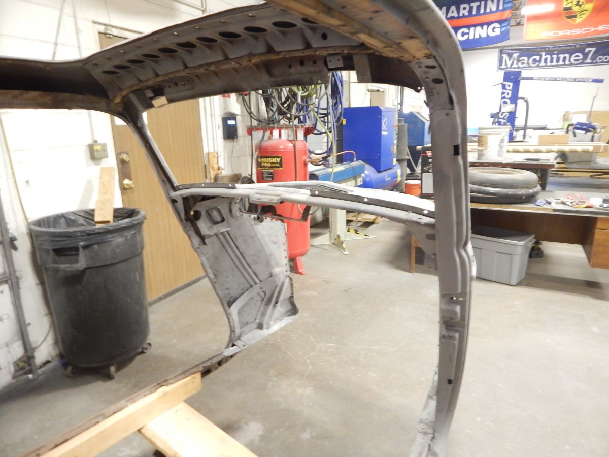

    cleaning up the body.
    and final pic is the 3rd person on our team ,my son ,Dante.
    DSCN0867.JPG DSCN0870.JPG DSCN0871.JPG DSCN0872.JPG DSCN0797.JPG DSCN0858.JPG

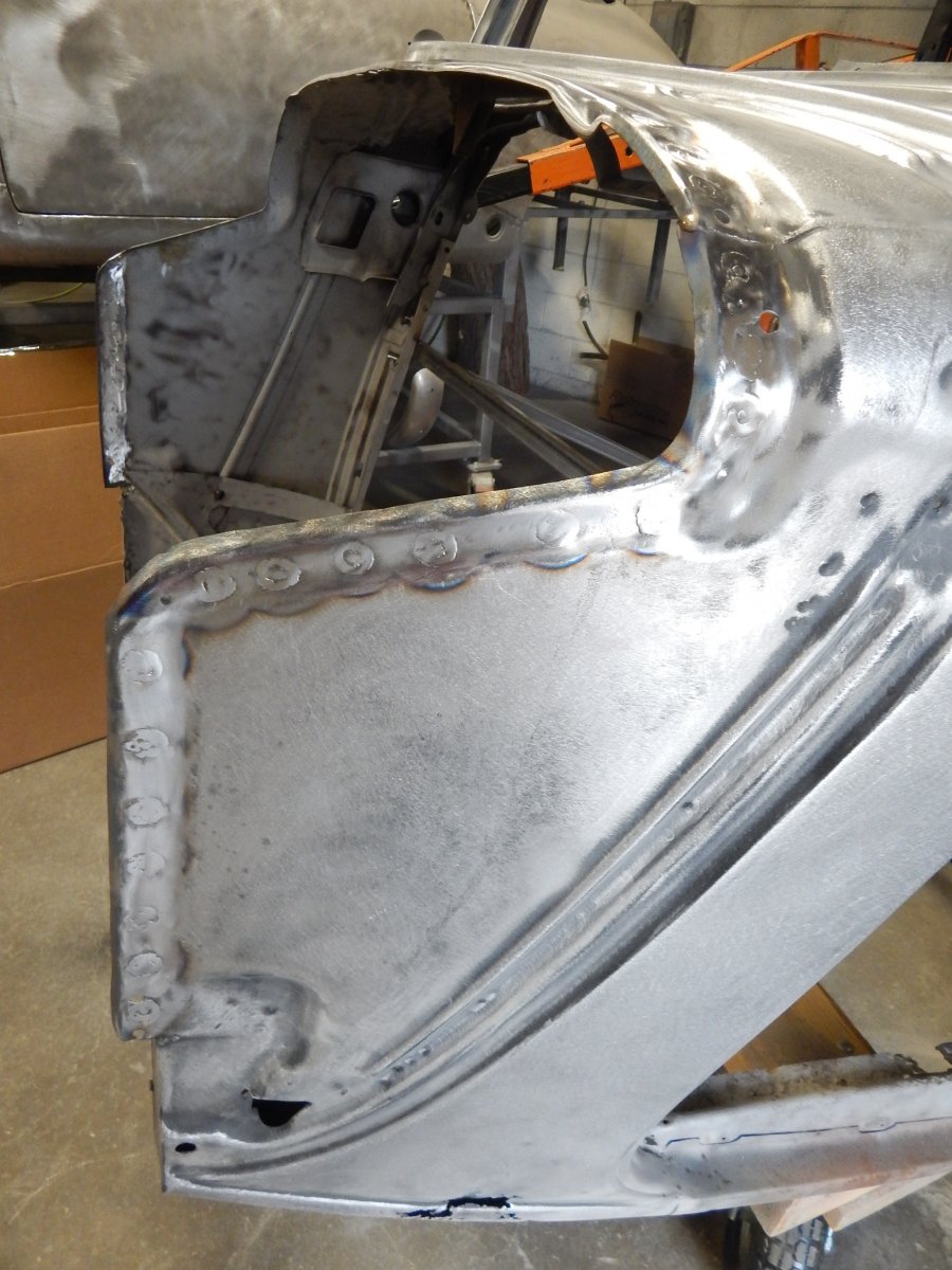

    cleaning up the body,minor metal finishing required DSCN0870.JPG DSCN0869.JPG DSCN0793.JPG

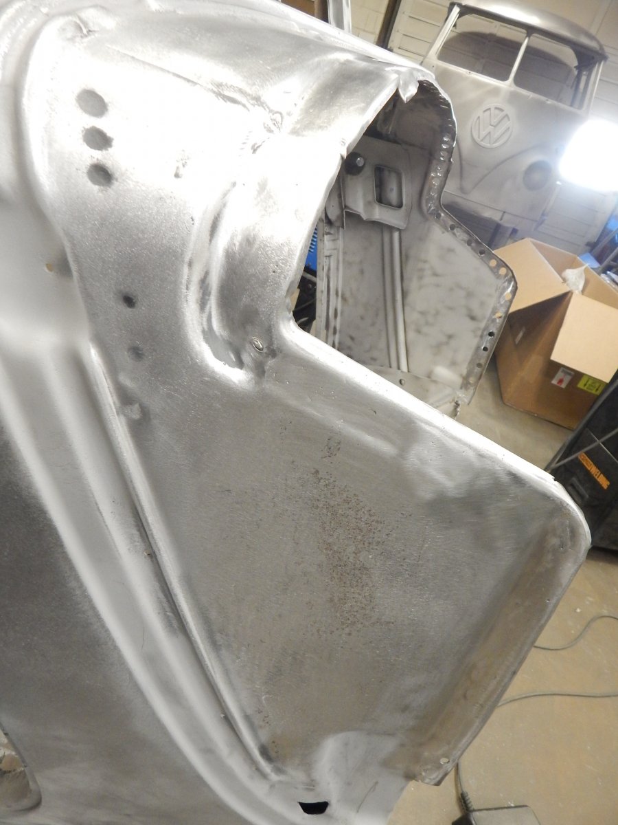

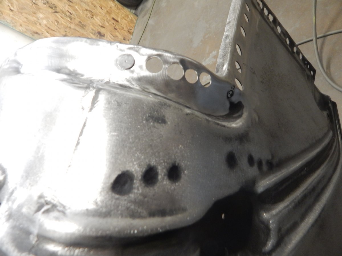

    firewall cont.
    work in progress....
