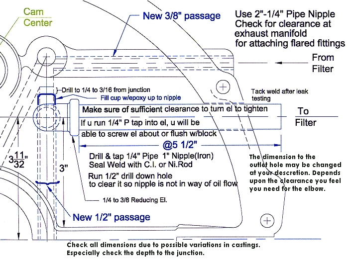

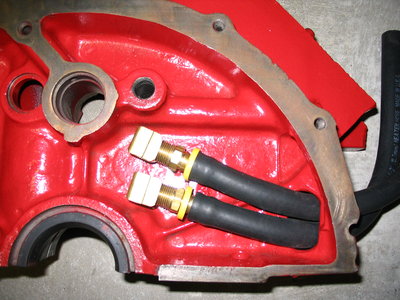

    Should be easy enough, here is a diagram for a Stude V8 conversion
