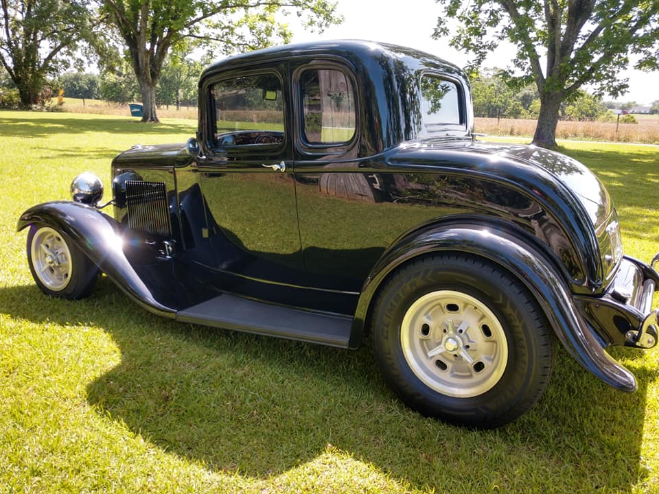

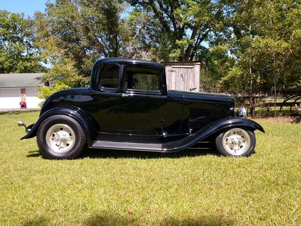

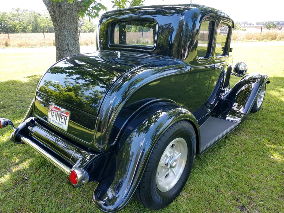

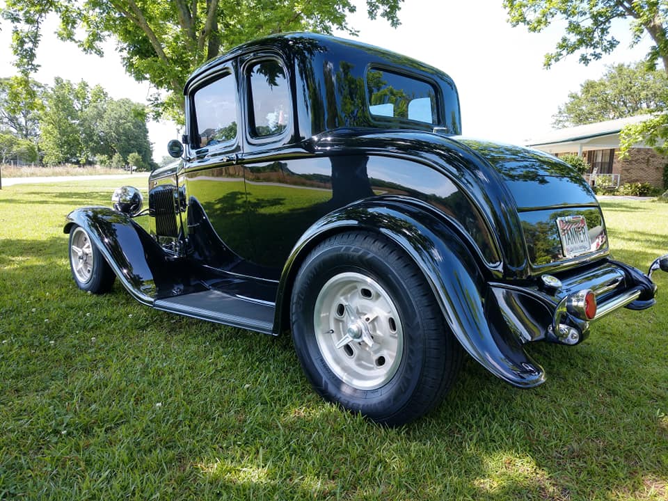

    I did it , just as the Squirrel , answered all depends on the type of mounts you have . I purchased my car 29 years ago , 3 months after the deal was sealed , I was told “ you have stage 4 cancer and a 20% rate to survive 5 years . I was determined to ride in my car before I died . I had a 70 LT1 sitting in pieces . I build it and a 400 turbo . Installed it into my fresh finished ch***is , sat the body on a d took a ride . A year of chemo , radiation , 3 surgeries , the Chevy was out . Sold it to my drag racing Buddy . Installed a 302 Ford and trans to the very same biscuit style mounts , same radiator and trans mount also .
