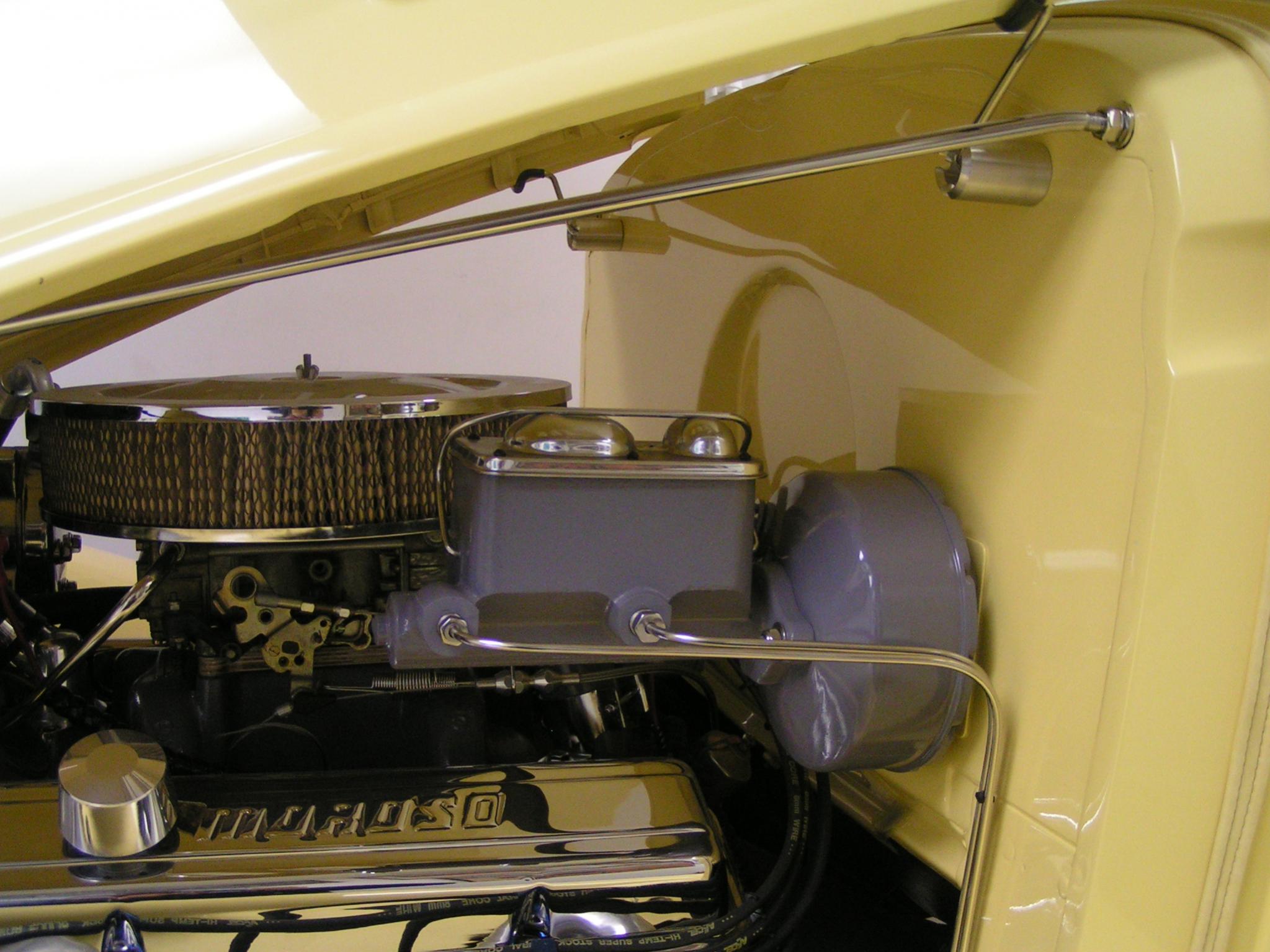

    For my 49 plymouth, I used a MC for a Mustang 2 with manual brakes - disc front / drums rear. I fabbed a bracket so it could be mounted under my floor and I mounted the pedal on the bracket.

    Here is the mock up I did using 1/8" aluminum. The bracket bolts to the original location. The brake pedal moved outboard by about 1/2" and the access hole for the cap was enlarged. There are also links on p15-d24.com of how guys have done this type of thing.
