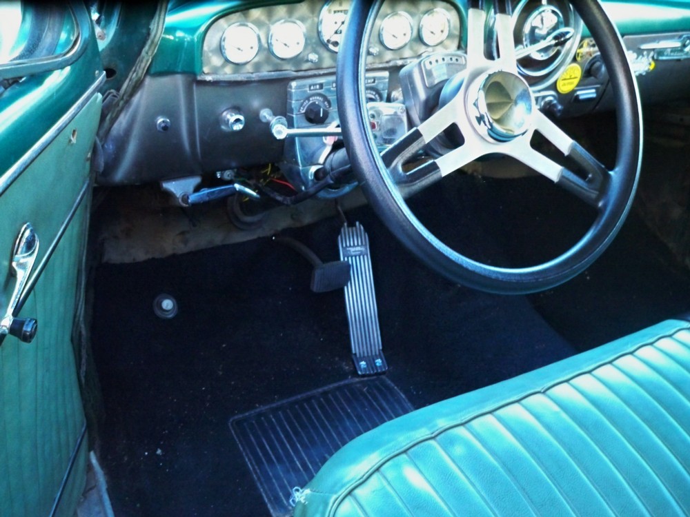

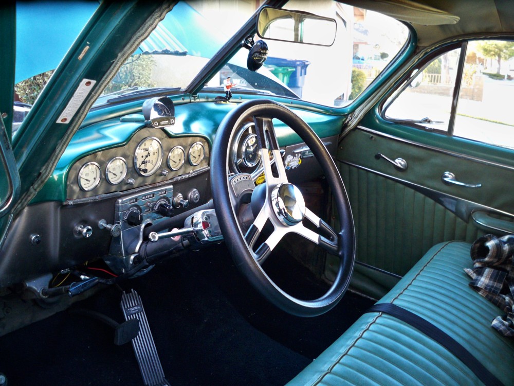

    Installed this one today in my '52 Poncho Chieftain - modified early 70s Slingerland kick drum pedal - so far it out performs those sticky Toyota and Lexus pedals.
