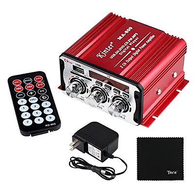

    Ok, the slowest radio build thread shows up again. This won't finish for a while but can maybe give some ideas to others.
    My Idea is to remote mount the thing inside the guts of the 1939 Mopar radio - which is sitting 200 miles from here, so that part is for later. (Pic of that radio is up thread). This post is just for the Lepai radio part.
    I spent about $20 on Amazon and bought some parts. Patch wires and mini switches; car antenna extension, speaker attachment extension. Also desoldering wick. I had the heat-shrink tubing.
    I de-soldered the on/off/volume switch and ran a 10 inch extension - it took 2 wires because the patch wires were too short.
    Next two rotary switches are treble and b***. I almost never touch them in a car now, so I figure to set and forget.
    There is a SD card slot which I will fill with a 32GB or 64GB card full of my favorite music. That's a few weeks worth of tunes. Again, set and forget.
    There is a USB slot which I will plug an extension into, and run somewhere - radio face or under dash. This way I can get new tunes too.
    The RCA jacks I'll probably run to a 1/4" line in jack. That might be mounted with the ****ons.
    The 4 ****ons share a common ground, so I only need one ground wire. I left the ****ons in place and just added extra "hot" wires on the back.
    There is an IR receiver that talks to the remote - I'm not sure if I will try to remote-mount that or not. It would take desoldering and proper physical mounting. I don't know how much you would gain - I'll probably experiment later to see if it's worth it.
    I'll mount the Lepai inside the Mopar radio somehow. (I need to add a heat sink - the Lepai uses the case as a heat sink so I might put the case on, or part of it.) I'll add the speaker ports and antenna off the back, and put everything else up front, using existing openings in the chrome dash grill.
    The Mopar radio has 5-6 ****ons for preset stations which are made from early fragile plastic, mine are broken to stubs. I'll have to wait to see what modern push****on switch fits best (I bought 2 types). And how to mount them, etc. Lots of unknowns yet, but I think I have a good start. I just hope it works when I'm all done.

    They all seem to get bad reviews on humming. Any thoughts on a small unit that works properly with no issues? I want one of these for my 34 and want to buy a good one. I'll spend more for one that actually works. Help!

    X2 and and would be nice with a balance control! The reviews on the ma-600 aren't too bad but only two channels..A pevious [#150 56premire] poster said he had one with a balance but couldn't remember brand..

  15. For the few of you looking for a solution to hiding the unit but still use the remote, it appears the Kinter MA-120 has an "external infrared receiver input" and a receiver cable with the infrared "eye" to place remotely:
    This is only a 2 channel (speaker) unit and still requires a power cord and the auto antenna modification. It would be perfect to install tucked under the seat of my IH pickup with a couple of speakers and still be able to use the remote by mounting the "eye" somewhere on or under the dash. Thanks to OP Justin for this; perfect solution for broke folks that just need some cheap tunes in their old beater...

    Ordered the MA-600. It's smaller. It only has 2 speaker hook-ups, but I will split it to run four, after the amp. I'm looking at a Kenwood amp that has speaker level inputs. I'll post the results later. Oh yeah...$33.57 on eBay.

    I got a blue one that, like your red one, had a display. The display shows mode and FM station frequency. That's useful because it doesn't really tune, it finds the next station up or down. Modes on mine are SD, USB, Aux, FM.
    I bought a 32 GB SD card and filled it with songs I like. It will get tucked away and will be hard to change.
    I took the whole thing apart - it's one circuit board and a little child board for the display.
    I soldiered some wires from the ****ons on the new radio, and de-soldiered and removed the on/off/volume switch. I added a 12-inch extension to this switch via thin wires, soldier, heat shrink. It is electrically the same, just on longer wires. I then did the same thing for the display - that was about 12 wires. I bought some 24-gauge Arduino jumper wires that made it fairly easy.
    Then I gutted my in-dash radio, preserving the switched and knobs. The left knob shaft was shortened; I physically mounted the new radio's on/off/volume knob to it.
    I ran a USB extension and Aux extension to he front of the radio, where the dial display would go - just mounted with a bunch (a BUNCH) of hot glue into a metal face/box with proper sized cutouts, replacing the dial indicator area. I polished the user-facing part. Getting fancy, I also added a dual USB charging port in this area. This area now has the display, 3 USB (one for data drive, two for power) and Aux plug.
    I hooked up the old radio's station memory ****ons to the new radio wires I earlier soldiered on. I also removed the ****on locking detent for the old radio ****ons so they are now momentary contact ****ons that make contact only when held in.
    I mounted the circuit board in a remnant of the original metal case, and screwed that inside the old radio. It still has the SD card in it.
    Treble and b*** are the other two knobs - I set them to middle levels, treble a little up; set and forget. The knobs are not accessible - I could have hooked them up to the other shaft with a lot of difficulty but that's too much work.
    I put in an antenna jack as described above, and used the Retrosound speaker. That was the most expensive part, about $50 delivered. My new radio was $35 and the pieces/parts were about $20.
    I have no pics, sorry. Phone the pics were on died and radio is hours away now.
    It works but I'm a little worried about my internal mounting of the circuit board. Other than that I'm pretty happy with it.
