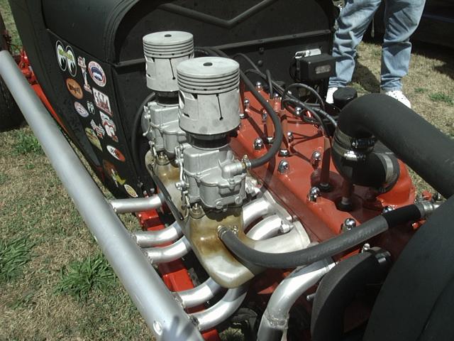

    I would vote for the flathead six or a slant/6. Pete's engine pictured below would be period correct and plenty of torque and power. A balanced flathead with a cam, some milling on the head, decked block, stainless valves, dual or triple carbs, or supercharged with dual exhaust will do amazing things. You can get them up to 265 ci and they will bolt up to a T-5 od tranny to boot. The slant/6 can have the same buildup and end up being a solid rod engine. With the right dress up bits it has a uniquely cool look on both sides of the engine bay. I've got one going into my Suburban wagon, and a flathead set aside for a 29 Plymouth highboy I'm working on as well. Lot's of good info on the p15-d24 forum, slantsix.org, and inliners international.

    Here is an interesting 265 Mopar flatty (if yer motor is a flathead how come yer sparkplugs are slated) linked to a 350 automatic (Wil Cap) in a chopped down coupe speedster. I like the air cleaner housings.
