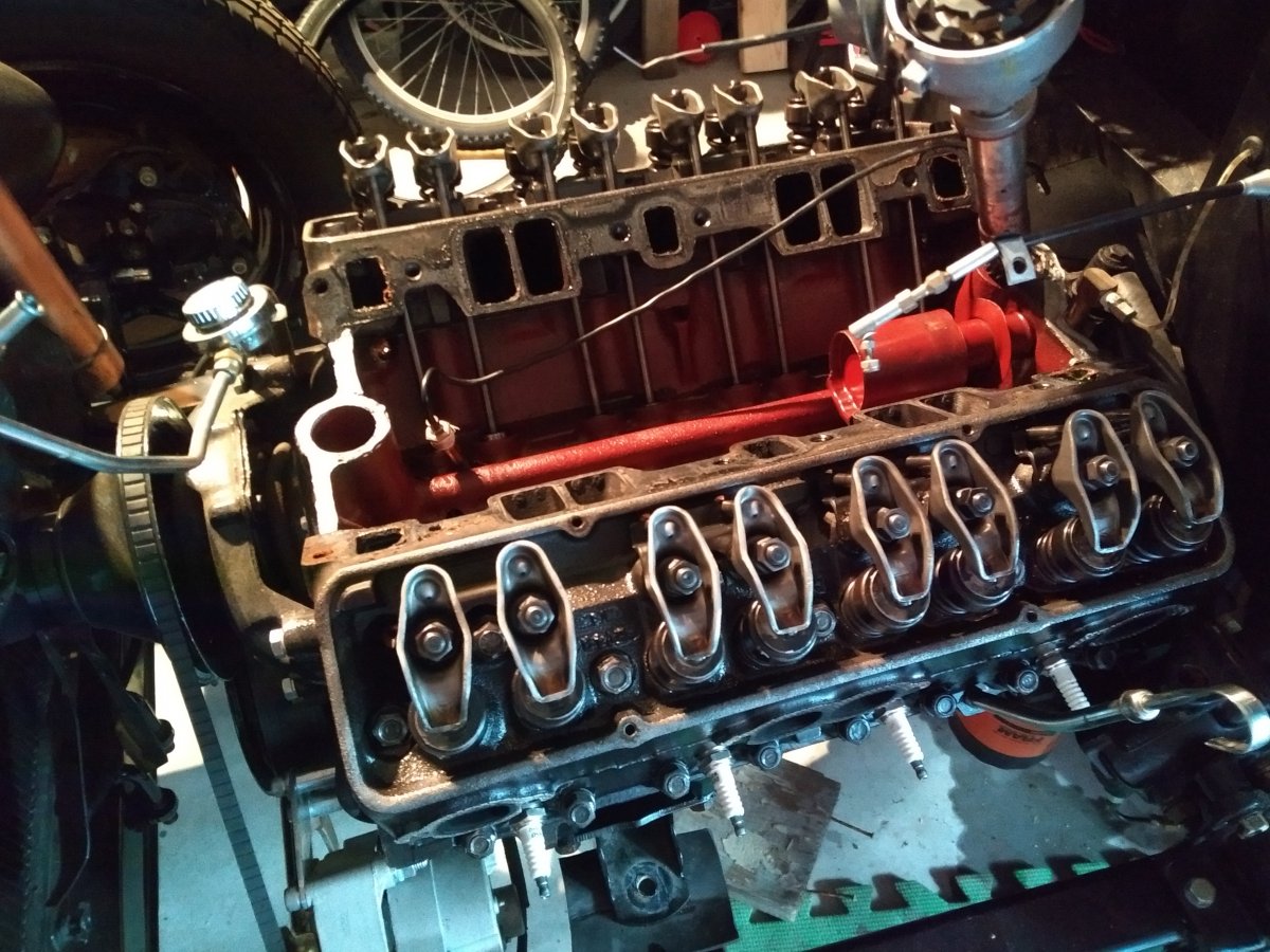

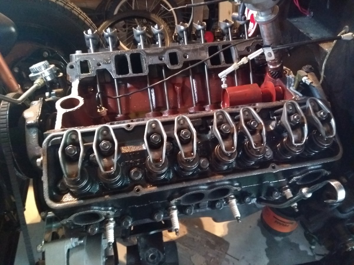

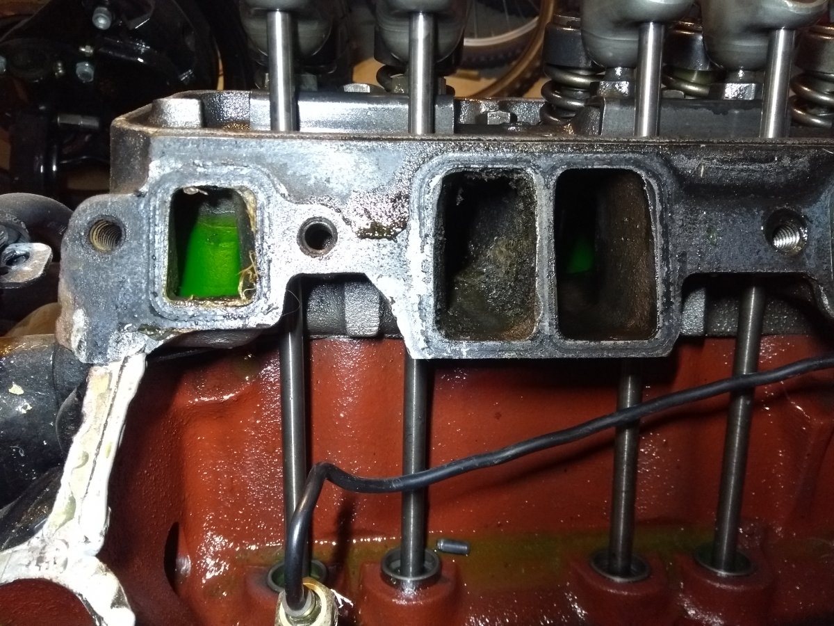

    Hi, it's been a while since my last post, I've been very active here years ago with questions and tips on building a hot rod. Ive ended up my project, it was running for a while but had many different things going on through years and let the project aside. Now it's time to put my model A back on the road. I've build this car entirely from scratch and the only thing I havent done is the engine rebuild cause I have very limited knowledge in internal mecanic and I will need your help.
    I have coolant in the oil pan, I removed plugs and coolant dripped on my foot on cyl#6, I removed the intake manifold yesterday to localized the problem so here I am, I need your advice. Some ports are rusty or have "sludge", and coolant in valves. One of the intake bolt was particularely rusty when I removed it (first on driver side in front). Here's some pictures, I need to be guided, any advices will be greatly appreciated. Could this be faulty intake gaskets, head gaskets? If you need more details let me know. Thank you very much. 1500 miles since complete rebuild 1962 327 sbc with triple deuce offy intake and ford holley carbs. My helper is here with me.
    Also, could this be a breathing problem, I have the rear 327 "canister" and downtube and oil tube breather, do I need breather on valve covers or pcv? Or it's not related at all?
    2020-06-12 17.32.22.jpg 2020-06-12 18.12.43.jpg 2020-06-12 18.13.24.jpg 2020-06-12 18.14.08.jpg 2020-06-12 18.14.55.jpg 2020-06-12 18.15.29.jpg 2020-06-12 18.16.04.jpg FB_IMG_1428150497981.jpg 2017-07-26 19.49.18-1.jpg

    I just woke up and I'm sitting here rubbing my eyes wondering why the goofy oil fitting/line?:confused: It's temp probe!:D
    catdad49 likes this.

    Hahaha! temp sensor exactly! it's time for a coffee!:D:p

    Coolant that has been the in pan with the engine running makes a gray nasty milkshake. I don't see that in your photos. Just green coolant. In your third photo, what is the small object in the valley behind the intake lifter? What did you use for sealant on the head bolts?

    I don't see how properly installed head bolts can leave standing coolant in an intake port with closed valve.
    Is that angle iron underneath the rocker studs? If so why, I have never seen that trick before, must be a Canadian thing?

    I see antifreeze in the #4 intake port and the #5 port,,,,,,could it be that it has 2 cracked ports like that ?
    I don’t know the history of these heads,,,it is possible,,,especially if any ports have been modified and maybe got too close to a water jacket .
    If the heads have a crack in the port,,,it would be easy to miss it with a mag check .
    Looking at the rockers,,,,,is that double nuts on top of the pivot ball ?
    Using an extra nut for a spacer ?
    I have never seen anything like that .

    Those appear to be raised guideplates, just installed upside down putting the pushrod guide section out of view down close to the original pushrod slots in the head. you can see it in one of the first photos..
    I agree, leaking head bolts won't fill up the intake port in the head....coolant from leaking head bolts come out under the bolt head, in the valvecover area and milks the oil..
    I would have the head pressure tested, not just magnafluxed for cracks...the crack could be midway in the intake port where a mag test won't be visible.
    Clockwork 31:
    I'm I seeing this right, cylinder #4 and #5 have coolant puddled on the closed intake valves?? both sides are affected??
    What do all the spark plugs look like??
    Can you post pics of both faces of the the used intake gaskets, it they aren't destroyed??
