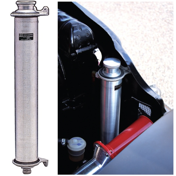

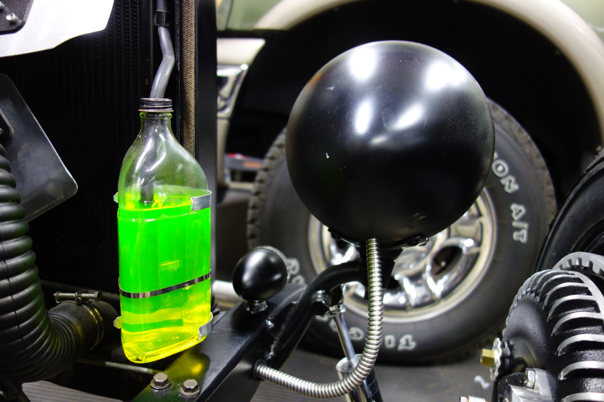

    That might be mine. I posted it a year or two back. The 'knob' on top is a high/low dipstick and the ****** at the bottom has a standpipe that goes up near the top for an overflow function.

    Made one from an aluminum water bottle. You should include an overflow outlet in case the amount of coolant released is more than the recovery bottle capacity.

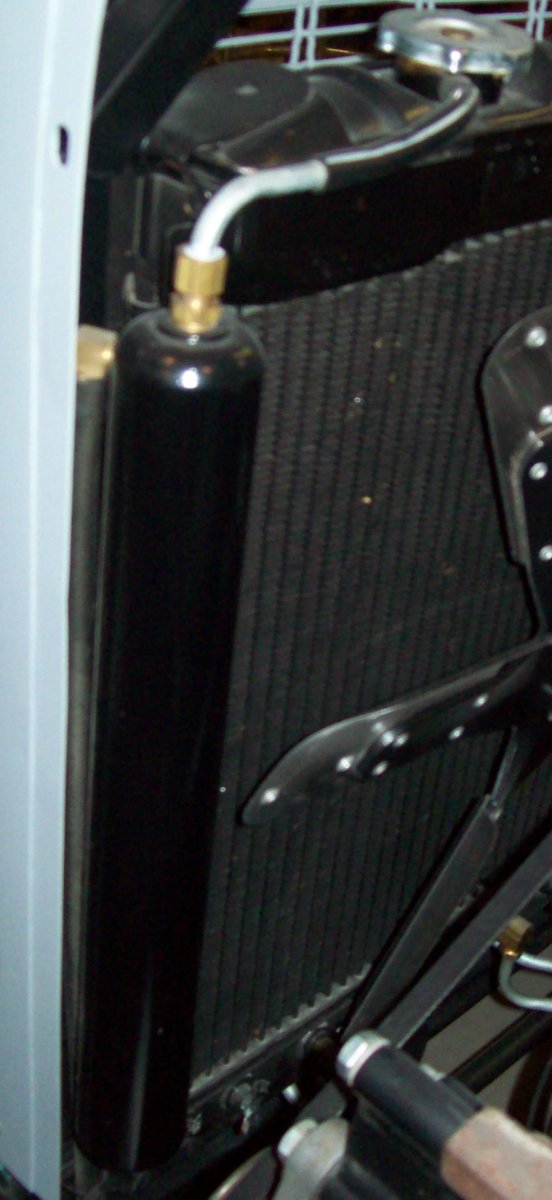

    I made mine from a piece of aluminum electrical conduit. It has a siphon tube to the bottom with an overflow tube out the side near the top. A pet**** out the bottom, too. Painted black to kind of blend in.
