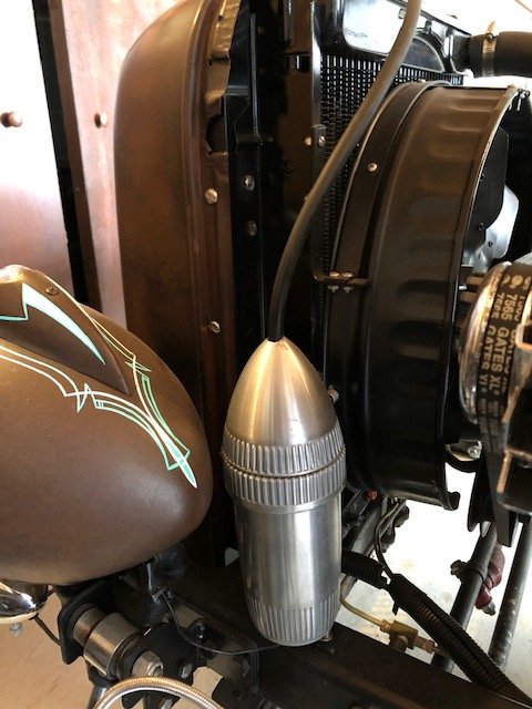

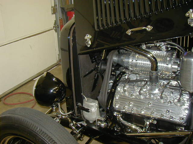

    Here's 1 on an epic 32 that belongs to a friend of mine. I mounted a WWII Canteen turned upside down with the cap facing down so you can drain when needed.. We ended up painting it Black. 12-03-2006   1.JPG 05-20-2007  17.JPG

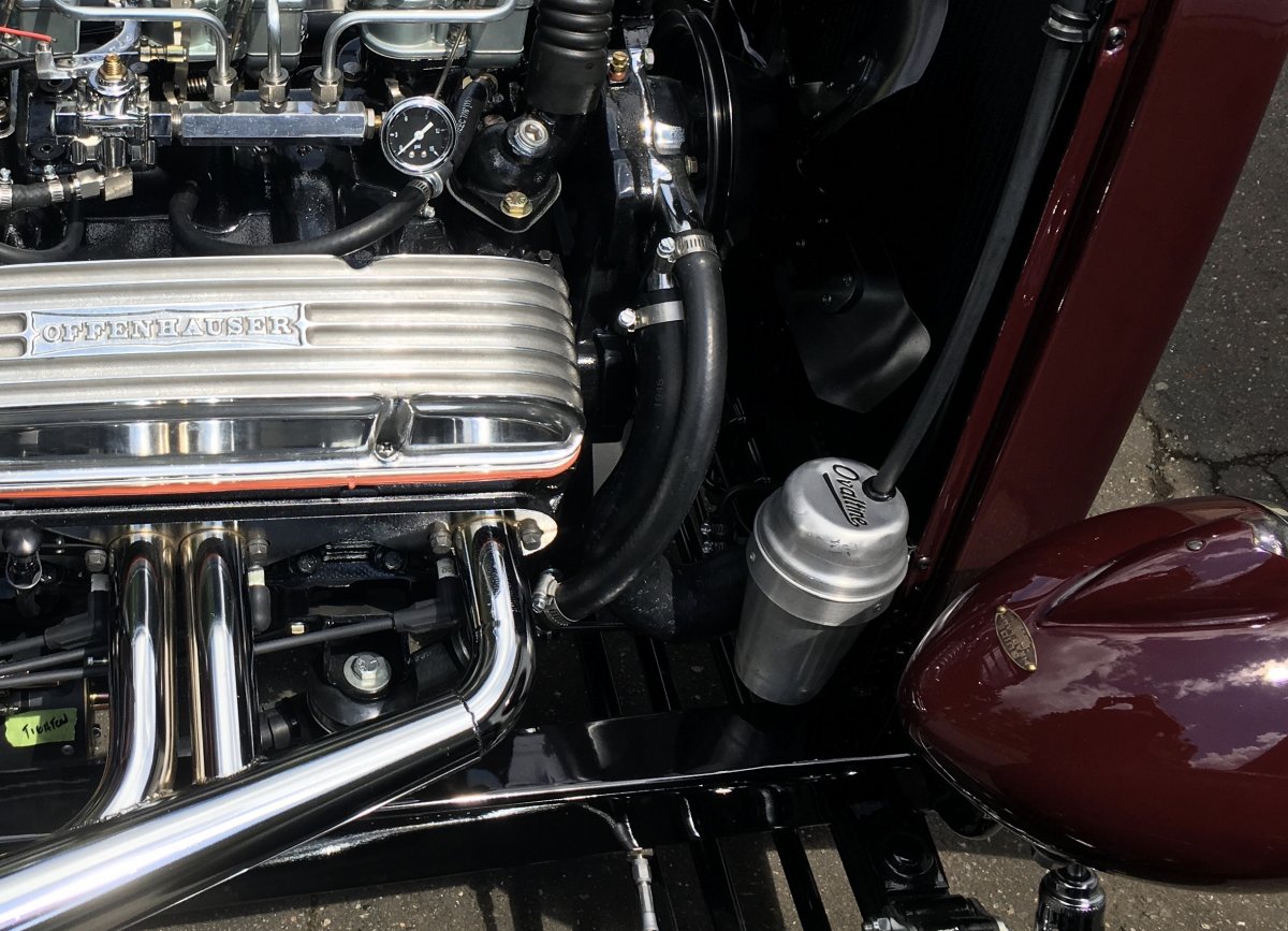

    This is on my PU (upper corner), it is an aluminum recovery tank that I bought for my roadster but went a different route do to space. The radiator line is connected to the bottom and it has an overflow tube to the ground. Clean design, it is tapped for two bolts in the back that hold it to the inner fender.
    My roadster ended up with this one from OTBGear, also a recovery tank and plumbed the same way.
