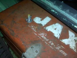

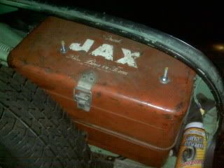

  5. dirtbag13
    Joined: Jun 16, 2008
    Posts: 2,540
    dirtbag13
    heres mine ! will try to get more pics up !
  6. aceuh
    Joined: Apr 17, 2008
    Posts: 1,361
    aceuh
    That's a great idea and it looks cool as well!
