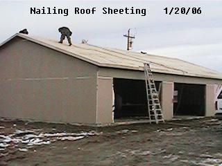

    shop3.jpg Shop10.jpg Shop14.jpg Shop17.jpg Shop28.jpg Shop39.jpg Shop44.jpg ShopPad52309 001.jpg My Shop , with help of Family we built it in the winter 05-06 finished & moved in under 4 months time

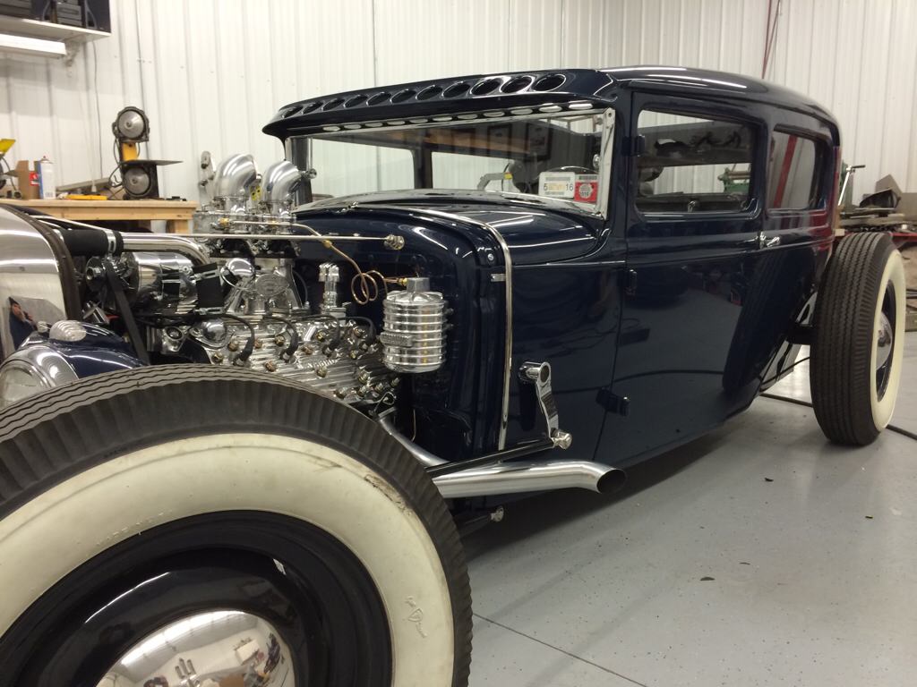

  6. ImageUploadedByH.A.M.B.1421775305.535802.jpg my car that I'm getting close to finishing.

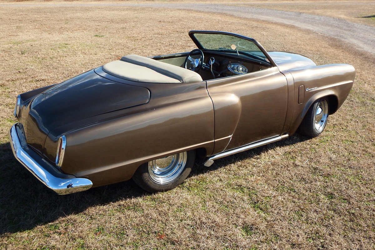

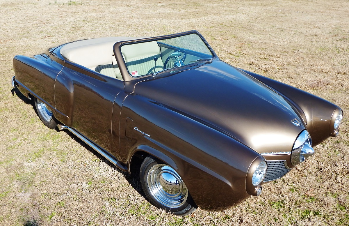

    my 51 studebaker roadster made from a four door sedan and my 20 foot airboat that I built everything on including the hull

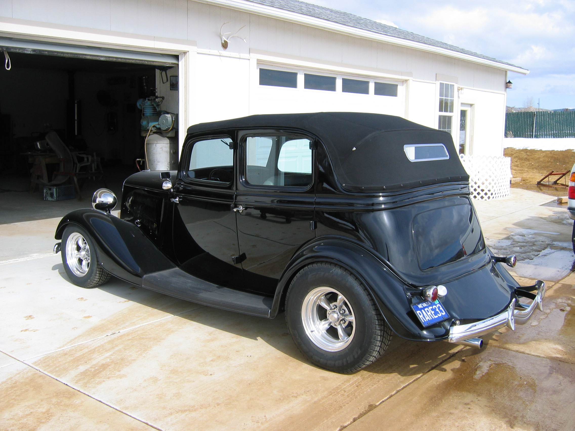

    From This

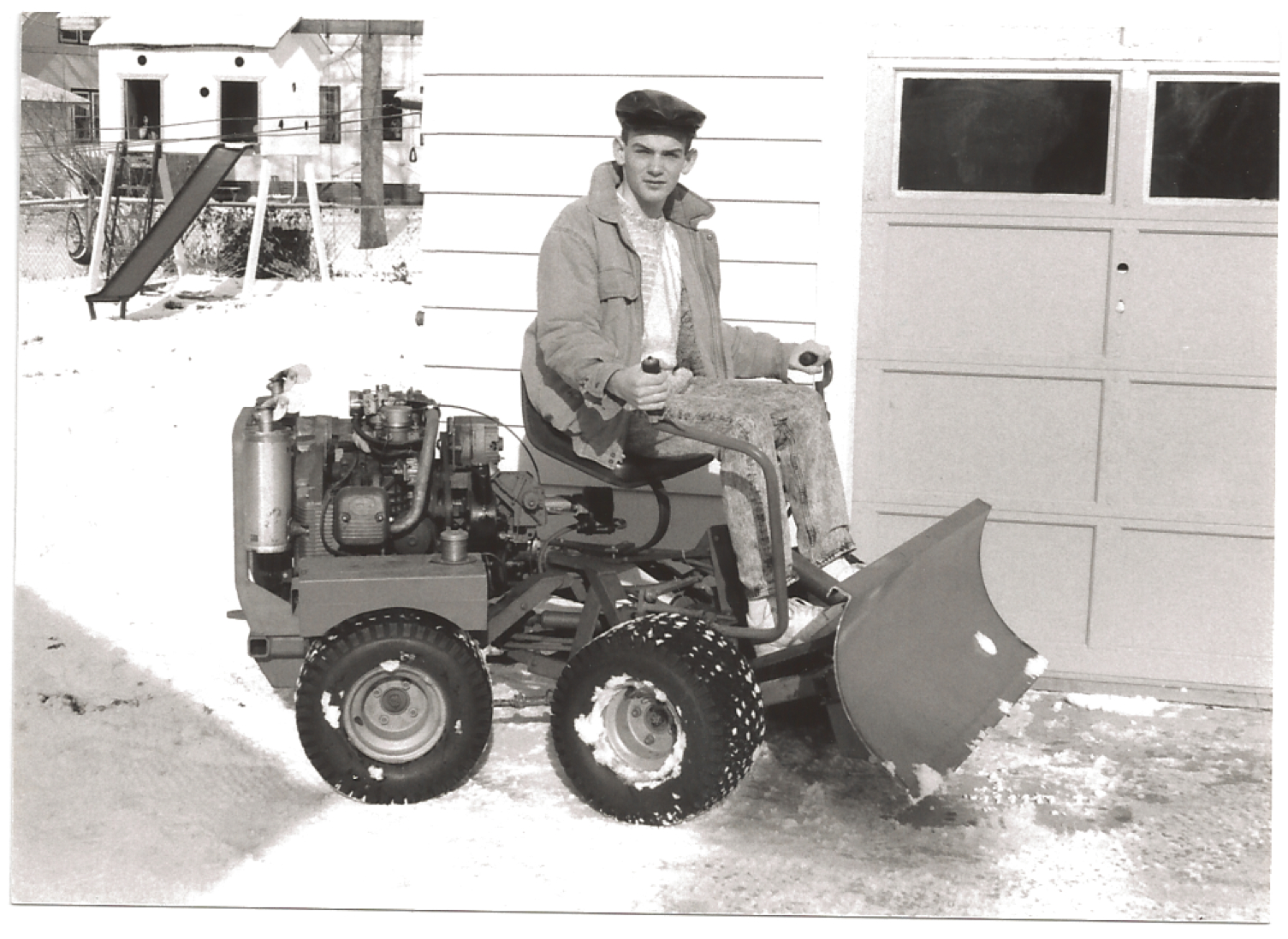

    Built this 4-wheel drive articulated tractor many years ago... (oldest son driving it)
    Used an air-cooled OMC 2-cyl engine connected to hydrostatic drive. Power steering was from a '69 Mustang. Hydraulic lift & tilt on spring-loaded blade. Joystick control.
