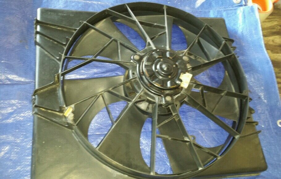

  4. willys36
    Joined: May 6, 2006
    Posts: 3,463
    willys36
    Air flow is the most critical component of the engine cooling process. mechanical fans with thermostat control are the best, hands down. But they often don't fit and let's face it, don't look hot rod. There are very few after market electrics that are up to the job. Plastic ones with narrow blades are always suspect. I run an aluminum bladed pusher fan on my Willys and it moves enough air to do the job nicely on my 354 hemi. I have room for little else. There is a great OEM plastic electric fan that really works well. It is a Ford item made for Thunderbirds and Lincoln Mark VIII. It is even a 2-speed motor so with the proper controller can be further tuned. Comes with a built in shroud. Always on ebaY can usually be gotten for around $100 if you are patient.

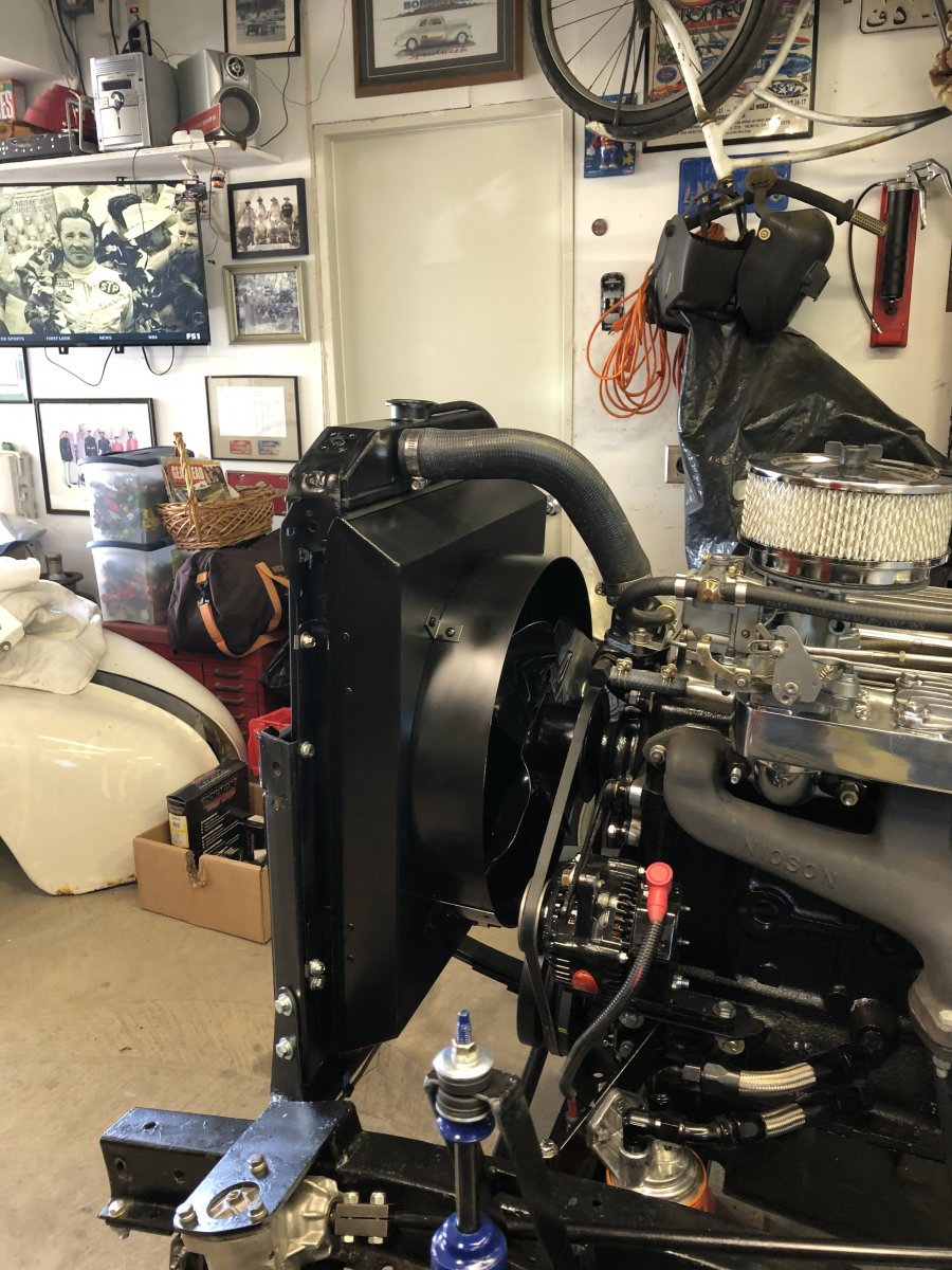

  17. HOTRODPRIMER
    Joined: Jan 3, 2003
    Posts: 66,084
    HOTRODPRIMER
    Let's see what your fan looks like. HRP

    Karl M
  19. Karl M

  20. squirrel
    Joined: Sep 23, 2004
    Posts: 60,996
    squirrel
    I expect a shroud would help a lot. Looks like there's probably not much you can do easily about the cross member, unfortunately.
  21. BJR
    Joined: Mar 11, 2005
    Posts: 12,073
    BJR
    With that much space between the fan and the core, and that much core above the fan, I bet a good shroud would fix all your heating issues. Also what Lbs is your radiator cap? Is it boiling over?

  24. sdluck
    Joined: Sep 19, 2006
    Posts: 3,332
    sdluck

  29. Almostdone
    Joined: Dec 19, 2019
    Posts: 998
    Almostdone
    The pictures helped us a lot. That is a small fan, but it’s mostly about the shroud. The pusher in addition to the mechanical fan is likely a band aid as stated earlier. You may be fine without the pusher if you get a shroud. Plus, in the electric fan world pullers are much preferred over pushers.
    Try a shroud and if it does not help go with a high quality electric puller and a shroud. Blades of a mechanical fan should be 1/2 in and 1/2 out of the shroud.
    You might think about why it it getting hot in the first place. Maybe timing, etc. should be considered. Does it get hot just when moving slow, or also when traveling at highway speeds, etc.
  30. Karl M
    Joined: Jul 19, 2017
    Posts: 119
    Karl M
    Closest point on the blades to rad is 2 inches. Vacuum on ports is just under 12 hg. ...His performance cam....?
