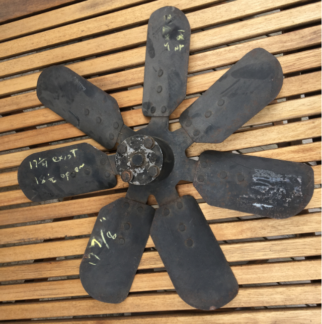

    I've got one of those what I call Ricky Racer fans on my 48 because there isn't clearance for anything else and just like that Jeep wagon my fan is way way low on the radiator. The vendors call them performance fans but no matter what the name, they don't pull any air. That is one in the photo below. No good for moving air at an idle or low speeds.
    Looking at the photos of the fan in the jeep a 6 blade fan that actually pulls some air Like the one Canuk showed in post 37 will pull a lot more air but you still need the shroud so it can pull air though the whole radiator.
    From personal experience this style of fan does not pull enough air at low speeds to write home about. It's claim to fame is that it doesn't much drag on an engine at high speed. Not what one wants for driving in traffic, My 48 would hit 220+ at a light and drop back below 200 when you hit 25/30 going down the street.

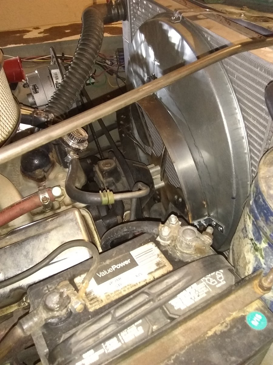

    Here is what I put together. I have not refined it as yet. Tried it out on a long hill, about 65 miles per hour. It stayed at 190 degrees. Drove it across town in stop and go traffic and it crept up to 230 degrees, got nervous and flipped on the push fan and dropped it to 220 degrees. I bailed out and went home checked it with a infrared thermometer and readings were the same. 95 degrees outside today. Did not have this issue till temps went up. The fan pulley is 7 inches and the crank pulley is 7 inches.

    I doubt the band is helping it. But the shroud is the cleverest one I've ever seen!
    Might need to just get a big *** electric puller fan on the back of the radiator...

    Yep wanted to try something simple first. Trash can lid fit perfect, angle lined up with the angle of the fan... What do yo think about a 5 inch pulley...?

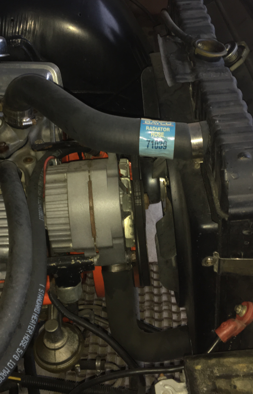

    I'd swap out that flex fan for an OEM style 6 blade fan so it draws more air. Insofar as a pusher fan causing issues I've had one (1600cfm Spal) on my 35 Chevy for 15yrs+ with only minor issue (Loose grub screw on blade). The fan only comes on at low speed and when it reaches a preset temperature as in stop start traffic. I use the OEM SBC water pump with no mechanical fan or shroud.
    If you go with a shroud cover the entire core so air is drawn through evenly and doesn't byp*** it through gaps. Also on the front you want air channeled into and through the radiator, you'll loose air around any gaps, that's why I run a chin panel which directs air rather than it being lost.

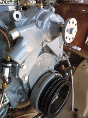

    Try speeding the water pump Serpentine belts crank pulleys crank pulleys are way bigger.

    That's pretty low. Check the specs for your radiator, but you might be able to increase the pressure to 16lbs or so. Remember the boiling point of the water increases three degrees for every 1 psi the pressure goes up, increasing the cap from 7 to 16 lbs would increase the boiling point by 27 degrees.

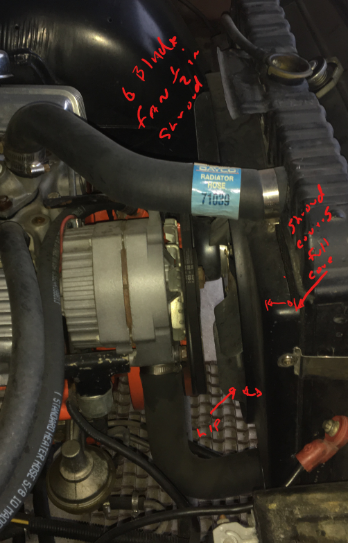

    Fibergl*** shroud in my Malibu, approx 1" deep covering full core with a raised lip around the fan. Fan is 6 blade fixed mounted about 1/2 into the shroud. pulleys are 6 7/8 crank and 7" on waterpump. Cap is 13 lb. Thermostat is 160 degree. Only thing slowing down the air flow is a trans cooler in front of the rad. Rad core is a triple core, high efficiency core with stock tanks. This scar use to struggle with running hot on the highway, now it is the opposite, I may have to change the thermostat to higher one, runs around 170 on the highway.
