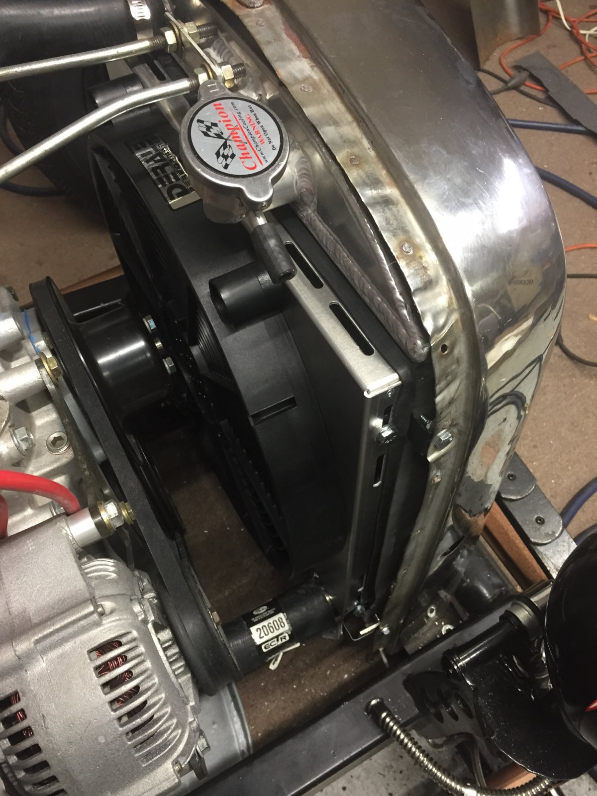

    Here is the shroud.
    Looked in cap and don't know how the hell this grit got into this system. Water and additive has been in there for 2 months.
    20w50 oil has been tried. Made more oil pressure. But brought temps up 10 degrees
    Back to a 10w30 valvoline with zinc additive
    No spring in lower rad hose. May be onto something there. Go pro time to watch it I think.
