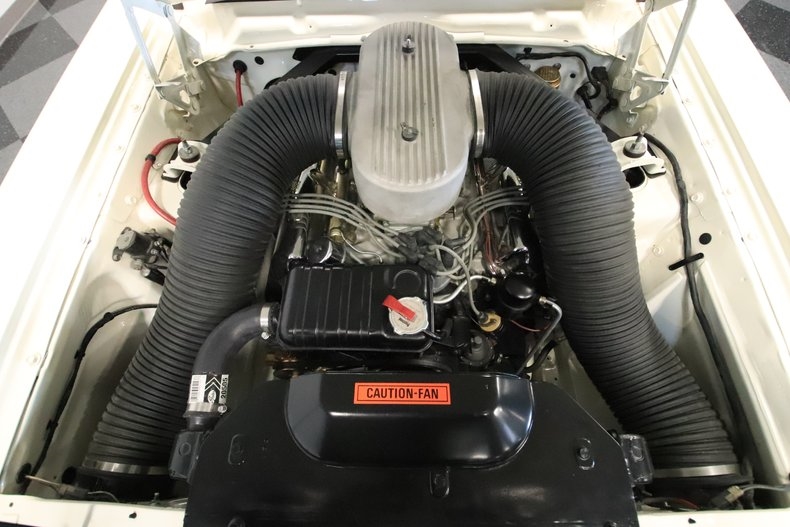

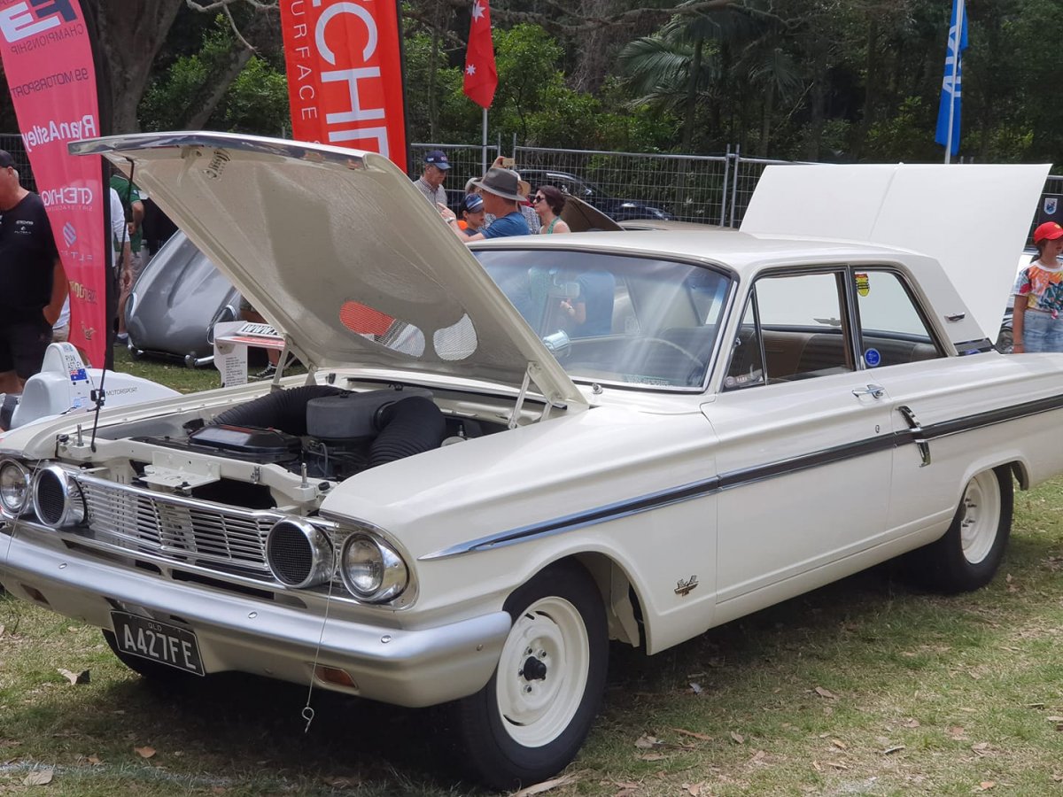

    I recently purchased a 427FE Fairlane (1964) and had it shipped down under, it's damn HOT here now and not yet even summer with bush fires all over the country. The car initially ran HOT thanks to a stuck thermostat (160°), then the recovery tank split on the seam. After a recent tune up it runs pretty strong however when in traffic or stopped the temp. gauge quickly creeps up over 180 then to 200. Once you move again airflow drops the temp. down btwn. 160-180. Cooling is via a 3-row Galaxie cross-flow radiator and an OEM 7 blade mechanical fan. The car and engine is a fresh US build, not by me and something I've never done before.
    The car has a teardrop hood which allows some hot air to escape. The FE (Top oiler) is no slouch with 2x4's, a decent cam and 2" primary pipes crammed into the smaller SBF engine bay.

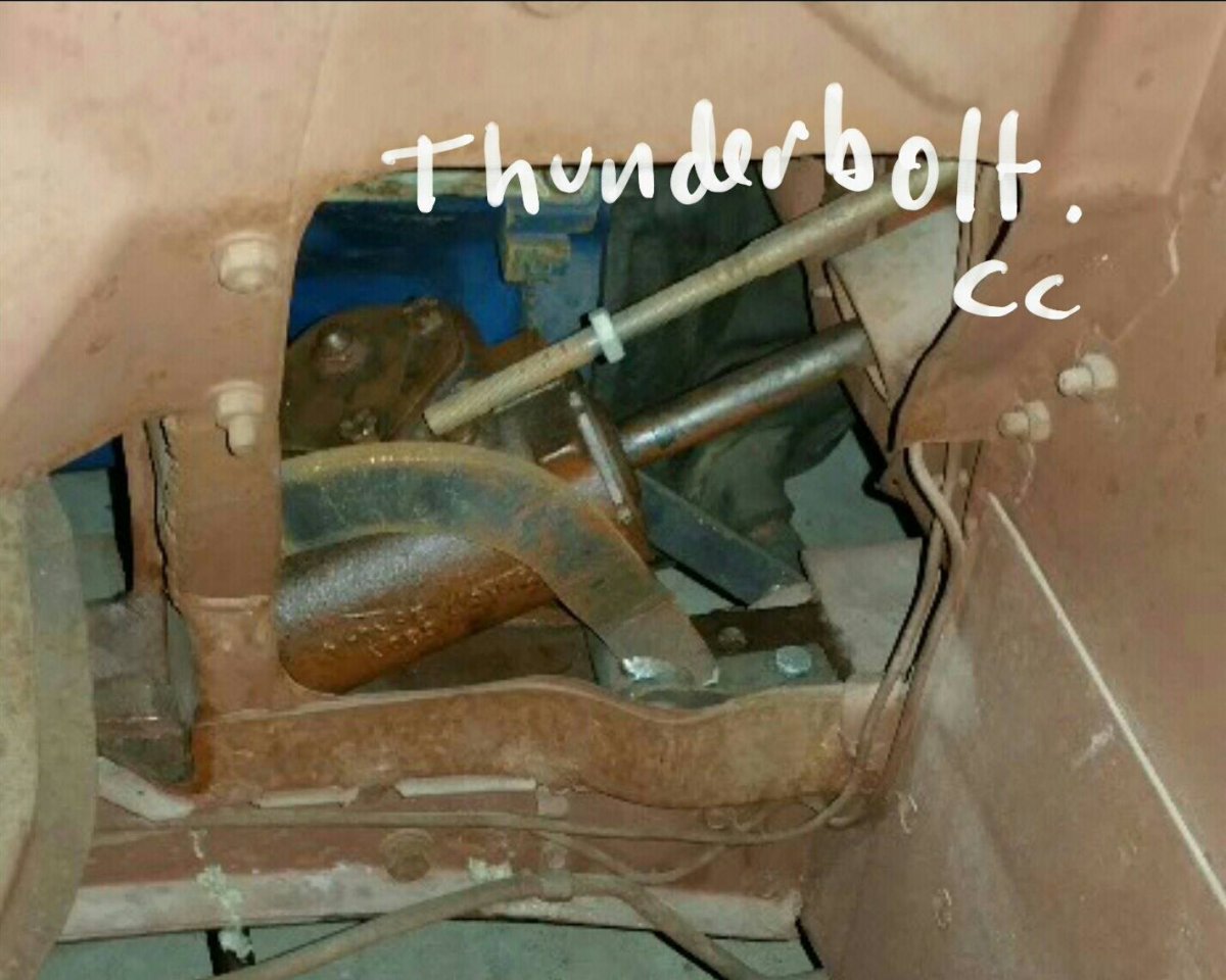

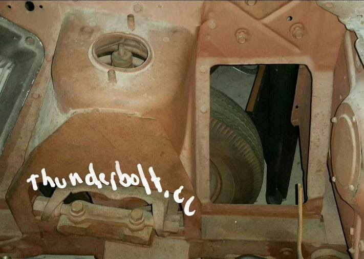

    I'll be modifying the fender aprons as soon as possible as per OEM Thunderbolts to generate air flow and allow all that hot air to escape. All I need to do is reroute the brake lines and junction block, no big deal.
    Anyone got any other thoughts as I'm contemplating removing the radiator to have it checked. I've even thought that the block might be partially grout filled to the bottom of the core plugs? :eek: Some suggest that I should add electric thermo fans, NOT an option. I'd rather add a period correct fan shroud and clutch fan if I can locate them for a reasonable price as they need to be shipped here, NOT cheap.
