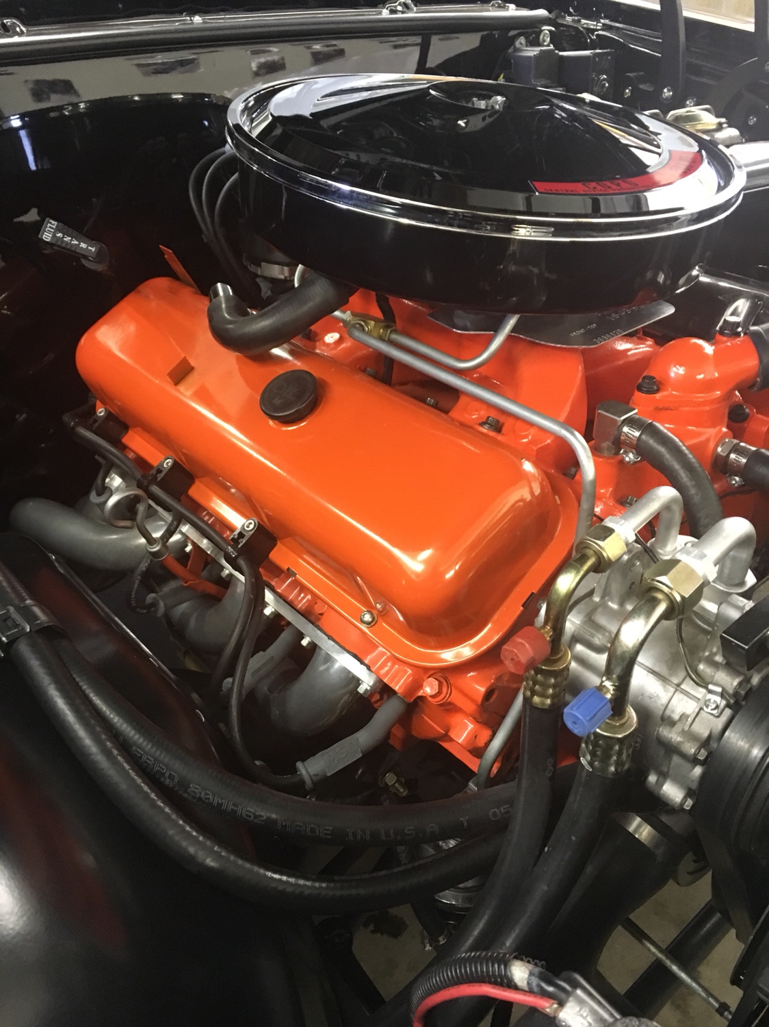

    I’m looking for some help with a cooling system. I have a BBC that will run cool all day in normal traffic or idling in heavy traffic. Tempature drop across the radiator is 10 to 12 degrees. If I run the car up over a mountain rd it will get hot. It has a four row high efficiency radiator, dual electric fans with a shroud. I was leaning towards building a bigger radiator, until this winter I discovered I had a heater issue. The heater only works at idle, at road speed it blows cold air. I have a March pulley kit, that came with a high flow water pump. I think I have too much water flow. March says impossible? My thought is if the coolant is p***ing through the radiator too fast that it can’t cool efficiently ? Same for heater core ? What do you guys think. Thanks. Oh March said my problem was the fans were blocking air flow and to turn them off would solve my problem?

    What do you mean by "high efficiency radiator" ? Looking at the picture I'm ***uming the radiator is new. If so we should be able to rule out it being plugged. Years ago I had a BBC pu with the same type of problem after installing a new radiator. Turned out it was the number of fins per inch difference. The shop I got the radiator from had done all kinds of testing thinking it was my truck. Then about 3 months into the problem the guy called me and said he'd found they made a radiator that had a total of almost 3000 fins more. Installed the one with more fins per inch and everything was back to normal. I knew the truck very well as I'd been driving it for about 6 years at the time of replacement

    Does your lower rad hose have a spring inside to keep the hose from ****ing in? This would restrict coolant flow and could be a reason for temp rise and heater not blowing warm air at speed.

    No help from me but nice clean installation in there.what is the car

    The lack of heat from the heater is what bothers me at this point. I ***ume you have a valve on the system to control the water flow through the heater so you could slow it down. I'm ***uming one heater hose is connected to the water pump near the inlet and the other is connected to the elbow next to the thermostat housing. That should provide good flow and good heat as the pump should pull coolant in and it will be forced out of the intake manifold. That flow should only be stopped if the pump quits working or something blocks the flow. I have seen a case where the impeller comes loose on the shaft when it heats up and expands but that would be very rare. If the lower radiator hose was being ****ed closed it would create more flow through the heater core, not less. Even if there is not enough airflow through the radiator, the heater should blow hot air and get even hotter as the coolant gets hotter.

    the heater hoses look to be in from the same spot in the intake. you need to move one of them to the water pump to get enough flow.

    I think the one heater hose by the thermo housing you see is coming off the water pump. BBC run a rubber 90 deg. in that area...........................................

    First off, that motor is beautiful [emoji471]
