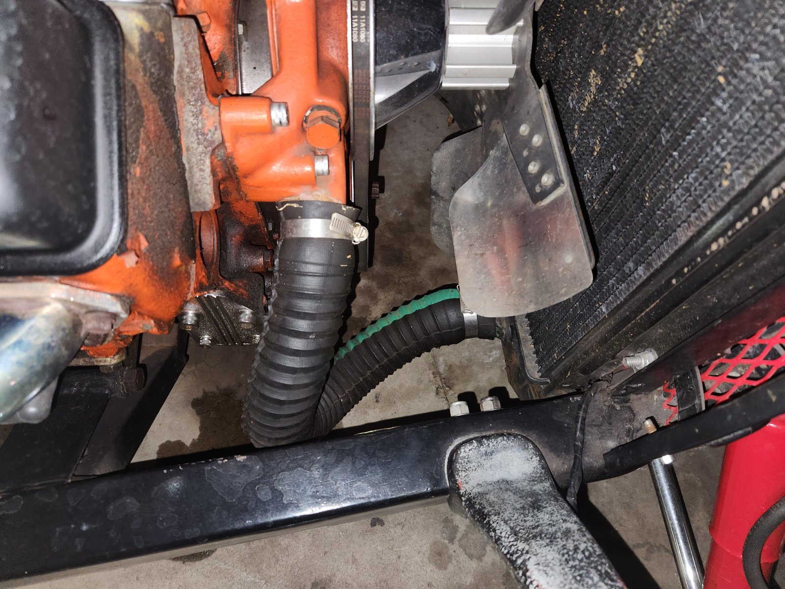

  14. pantodd74
    Joined: Jun 29, 2023
    Posts: 146
    pantodd74

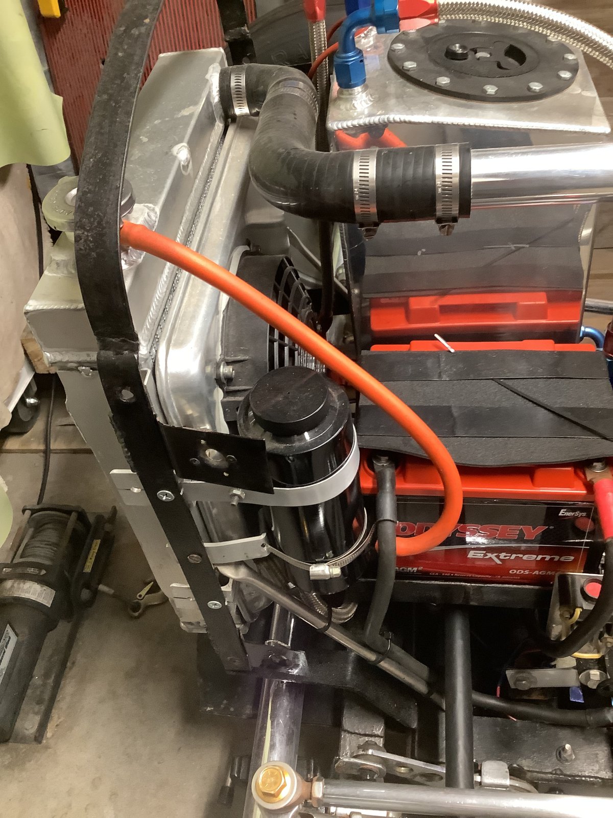

    With that spacer you have plenty of room to build and use a shroud. With what you have now I would use a baking pan. Get one at a kitchen supply. Many have rolled edges and you can section a 1” thick one to fit. Make 4 aluminum tabs and paint it BBQ black.
    If you don’t want the spacer, you can get a circle track shroud kit from Speedway or Summit. I’ve done them both. Also get an over flow receiver …. They have really nice black ones on Amazon. The one on my LSR roadster needs an electric fan and has one of the over flows. The one on my sons 40 Chevrolet is mechcanical 14” fan on a 10-1 engine using one from Summit turned verticle. IMG_6443.jpeg IMG_0319.jpeg IMG_2895.jpeg

    Jimmy six I'm digging the idea of the baking pan. I like the black one you made. That shouldn't be too hard to fab up. I lived in so-cal once upon a time. Marines from 93-97 then stayed till 2011 when marriage failed moved back to Indiana which is home. Lived in Temecula most of the time I was out there. I know all about the heat.

    The kitchen store has been my go to aluminum and stainless “parts” store for engines. Cake lids make the coolest air cleaner covers..
