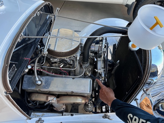

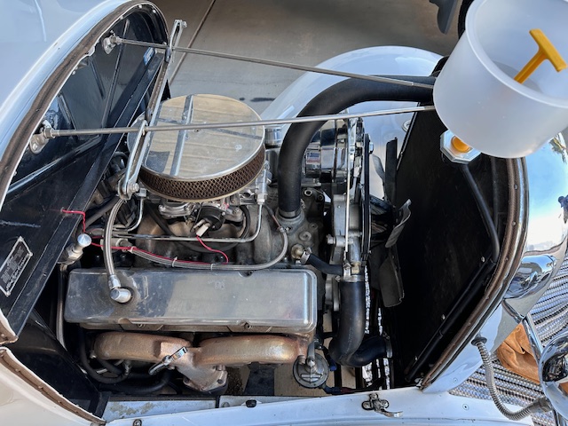

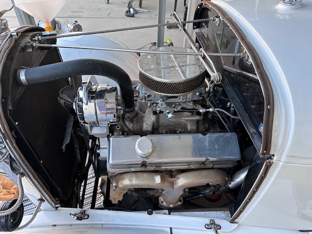

    So today I installed a new 195* stat which is what I installed last year with the new intake. Tolerances soo tight between rad and fan I managed to pinch my index and middle fingers between the 2. Luckily the wife and my youngest was in the garage. I was screaming like a ***** cause I couldn't just pull my fingers out. Took an breath as she was freaking out about what to do. I told her to grab a pry bar and ended up using a large wrench to pry it just enough to slip out my fingers. 2 small cuts and it's good. Brainfart! lol Installed the radiator and hoses. 1 gallon of antifreeze and 2 gallons of water. New rad cap as well. Took it to the liquor store and back and the temp gauge was all over the place at first then calmed down to 195. Let it cool a lil bit in the driveway. Removed the cap and added more water to top it off. Fluid was light green no brown. The temp sensor is in the intake where one of ya'll is running the byp***. The camel back heads are the early era with no ports on the sides with the spark plugs to install it there. Also the front of the heads don't have the acc holes drilled. 4 trips to the parts store to get the right size belt. I will run it this week and drain it next weekend.

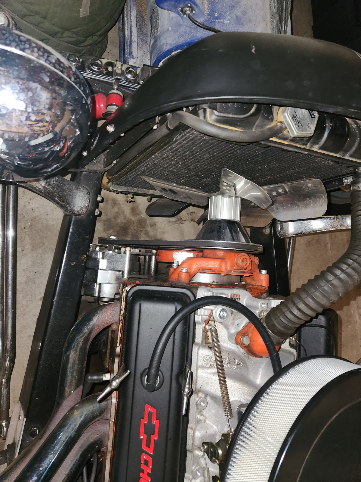

    One thing you might try sitting still is setting a big portable fan in front of the radiator running full blast and see if the temp drops. I've got a big squrrel cage fan that I set in front of rigs that I am running for lengths of time while working on them and that thing puts out a lot of air. We used to use a square fan on a home made stand with the cars we did AC work on in the 70's in a shop I worked in.
    The idea is that will show you if low speed air flow is the issue.

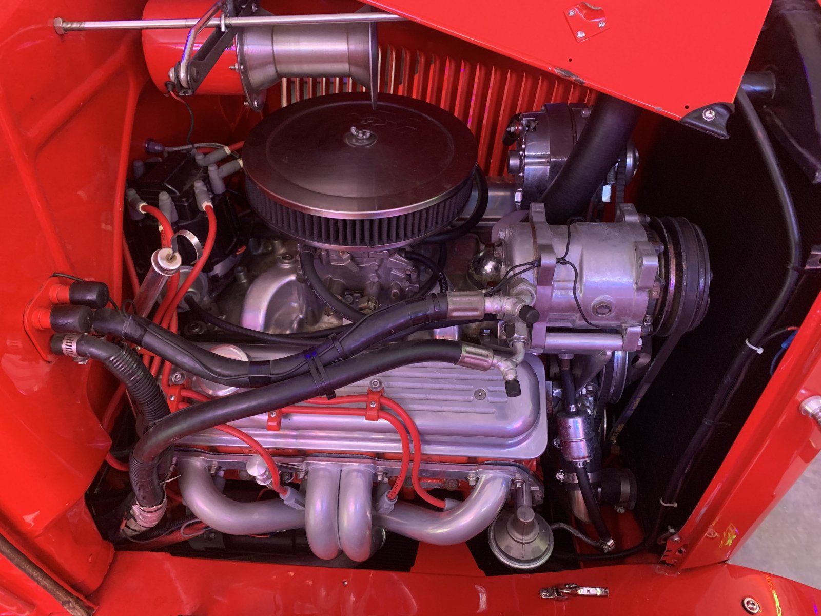

    This is just another proven way to cool one, at least for me. Here in Florida the heat can get brutal, my A-Bone had no mechanical fan just two used swap meet 10" pusher fans. It could sit all day in 90+ temps and stay well below 195 with the full hood on. I used 10" pushers on two other cars as well, zero issues. The fans will only fit if you have a 32 grill shell. I use tap water and antifreeze coolant nothing fancy. It has a 350-350 for power. IMG_0341.JPG IMG_0744.jpg

    You do not have the byp*** hooked up, So make sure you have drilled atleast 2x 1/8" holes in the flange of the thermostate. You have to make sure the engine is running when you fill the radiator and put the cap on before you shut the engine off. Then get a recovery style catch can to ensure you don't get air in the system anymore.

    All is good in da hood with the roadster now. Pulled it out of the garage this afternoon. Topped off the radiator put the front grill back on and went down the road. Topped off the tank and a 1/2 mile later it burped again through the cap and drain line. Sent a spritz of coolant onto the windshield but nothing more after that. The gauge stayed at 200 the whole trip about 30 miles. I will be changing the clutch soon to get rid of that issue.

    Add an over flow bottle or a coolant recovery tank. Doesn't have to be fancy. That will keep from dumping coolant onto the ground so it can blow back at you.

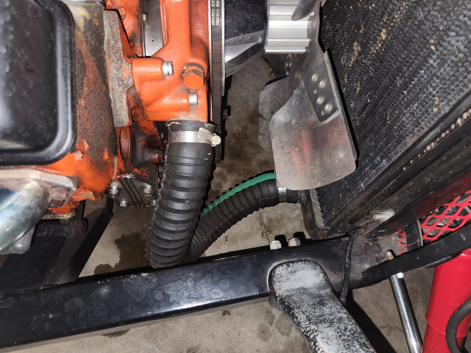

    This one just needs the fan closer to the radiator or a shroud!
