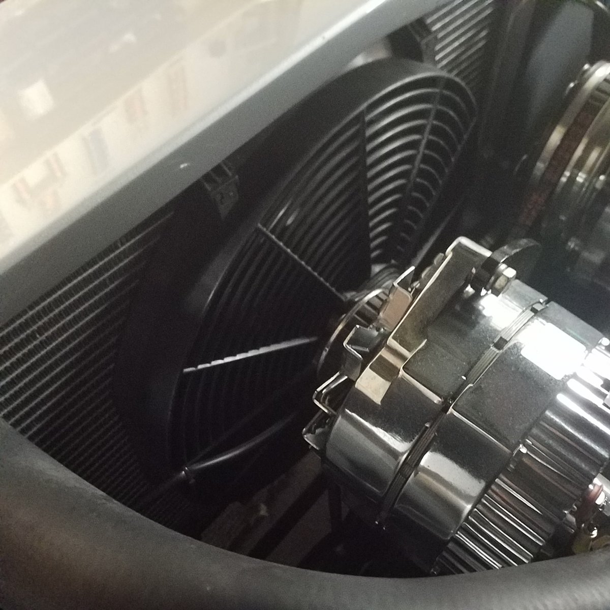

  4. LEE CHRISTENSEN
    Joined: Nov 24, 2018
    Posts: 29
    LEE CHRISTENSEN

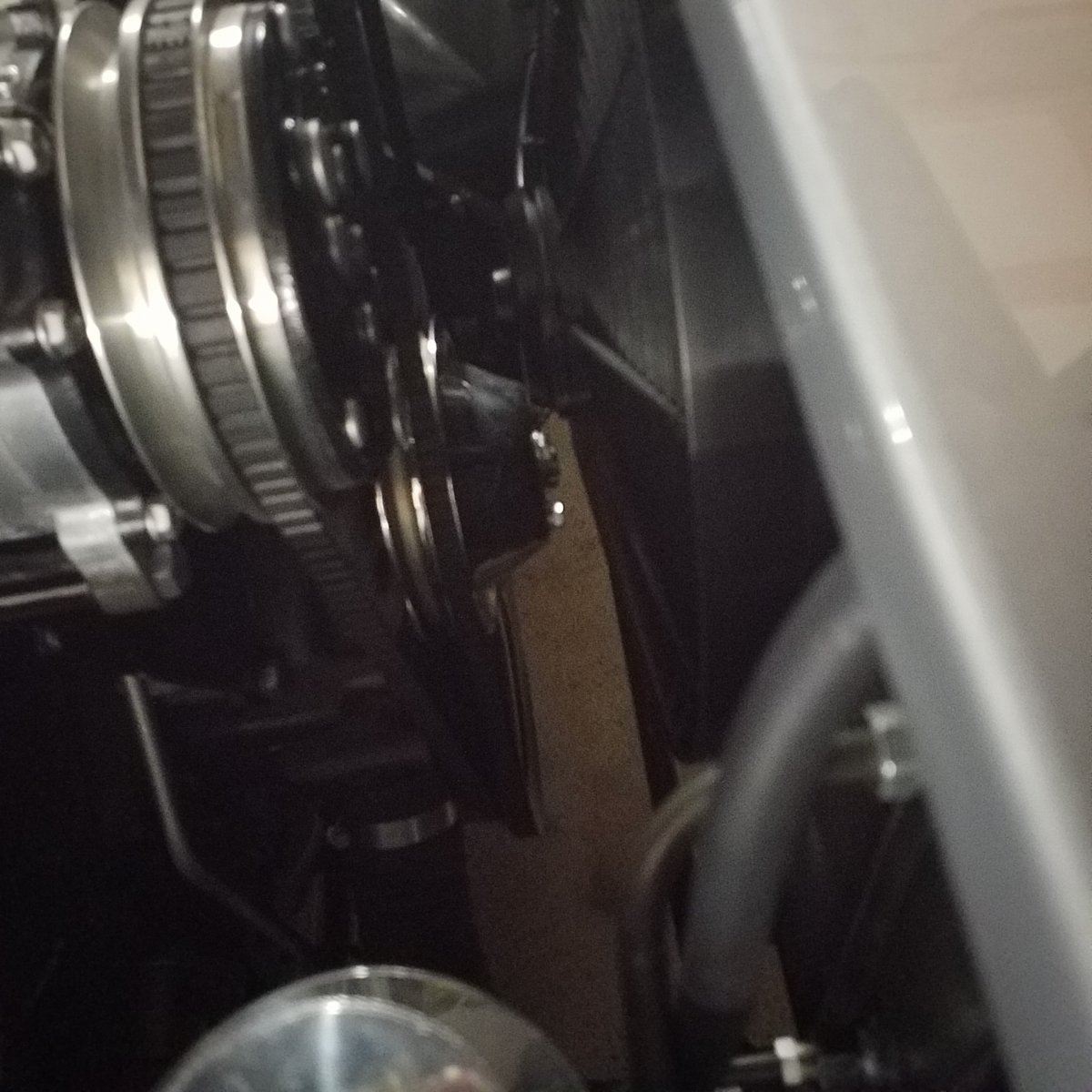

    It's a 1950 Mercury with a 350 SBC, there is no room for a shroud unless I run it around the fan. But the fan would still be mounted to the radiator, do too only about a 1/4" room between fan and water pump pulley. 20190812_083347.jpg

    I've got 2 3/4" of clearance between the face of the radiator to the fan pulley. Haven't found a fan setup that will fit in that space and clear the pulley.

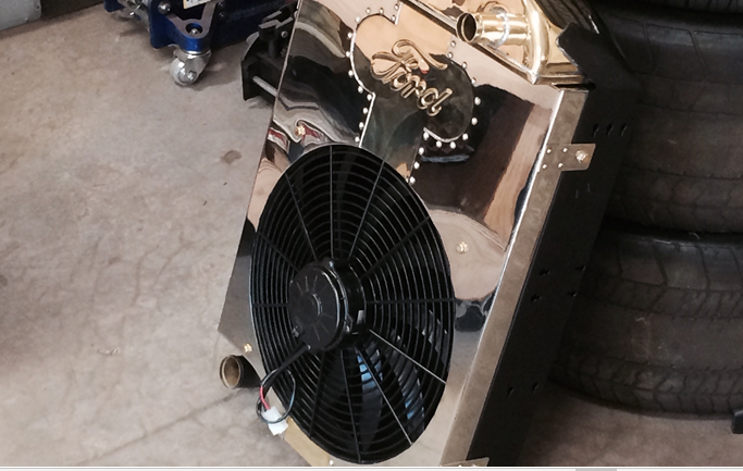

    That is not much of a fan and they should never be attached to the radiator core IMFSHO. The fan should be buried in the shroud and attached to it and the shroud attached to the frame on the radiator. I know the way you have it is the way everyone does it but they are wrong and I am right. And use a SPAL fan, as big as you can fit and their controller with a relay.
    Is it even HAMB etiquette to discuss proper electric fan usage? I doubt it. Oh well, done is done.
    Something like this...not exactly like this cuz this one is mine but you get the idea.

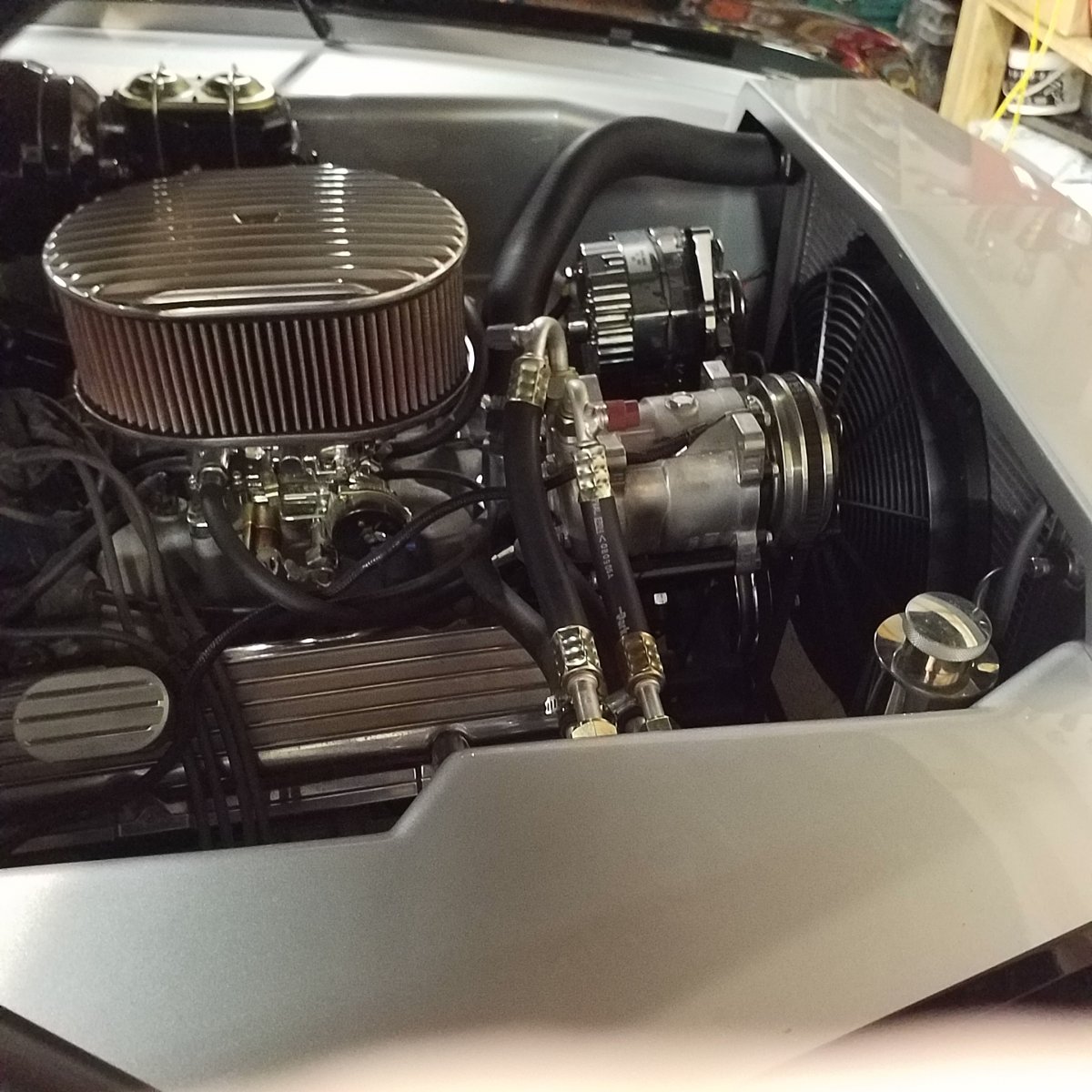

  23. LEE CHRISTENSEN
    Posts: 29
    LEE CHRISTENSEN

    Cooling Components fan is 2 5/8” deep.

    It seems to me that there is room for a mechanical fan and shroud. I don’t understand why people use electric fans when there is room for a water pump driven fan

    ^^ What Moriarity said. A water pump mounted fan should fit and give you room for a shroud. The shroud will help the fan pull air through the entire radiator. You also want to be sure the air can't flow around the radiator from the front side.
