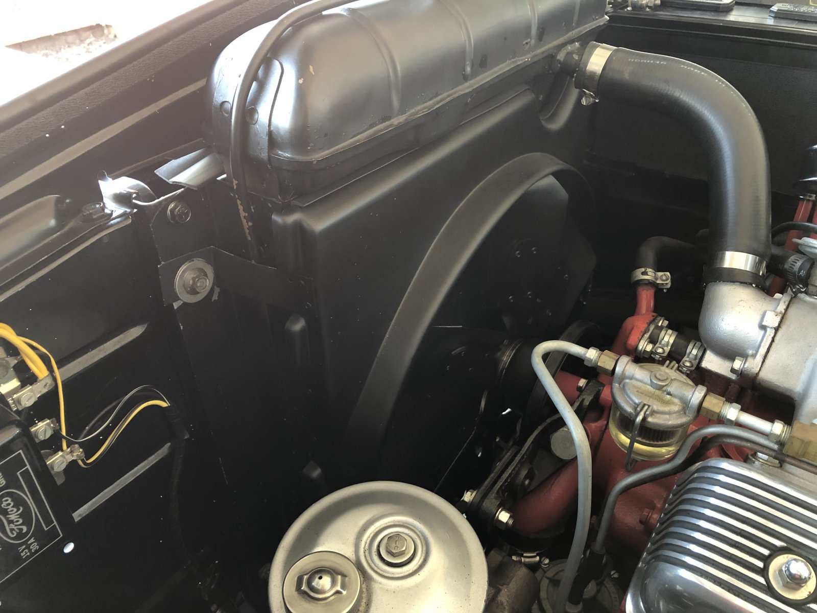

  18. jimmy six
    Joined: Mar 21, 2006
    Posts: 17,185
    jimmy six
    This helped with my cooling problem on long wait intersections or stop/go traffic. A smaller water pump pulley did more. 16” 6 blade IMG_2497.jpeg
