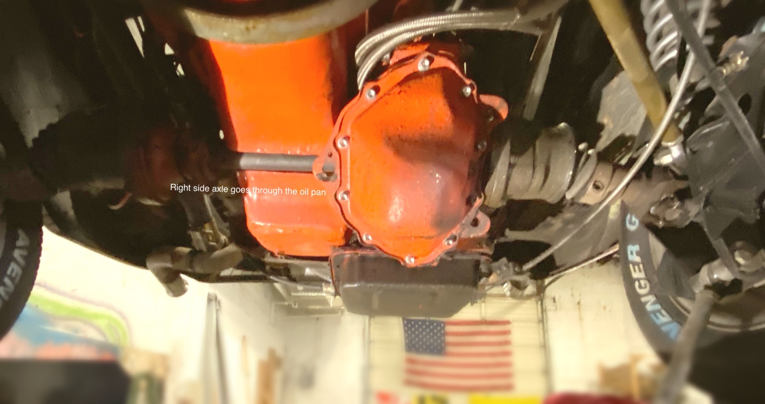

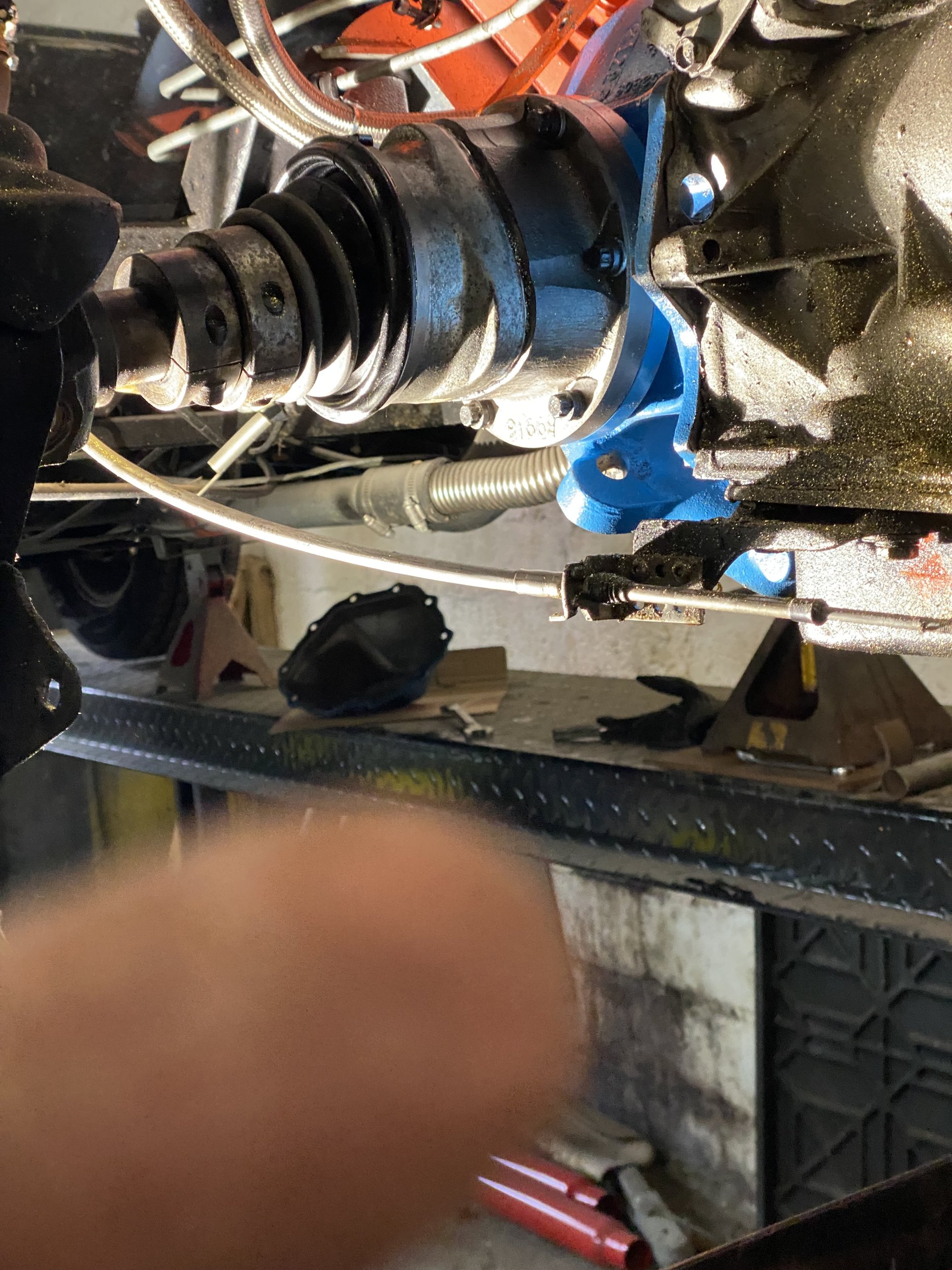

    I finally got both axles in. What a pain in the ***. I need 2 new controller arm brackets and it will be ready to terrorize East Baltimore

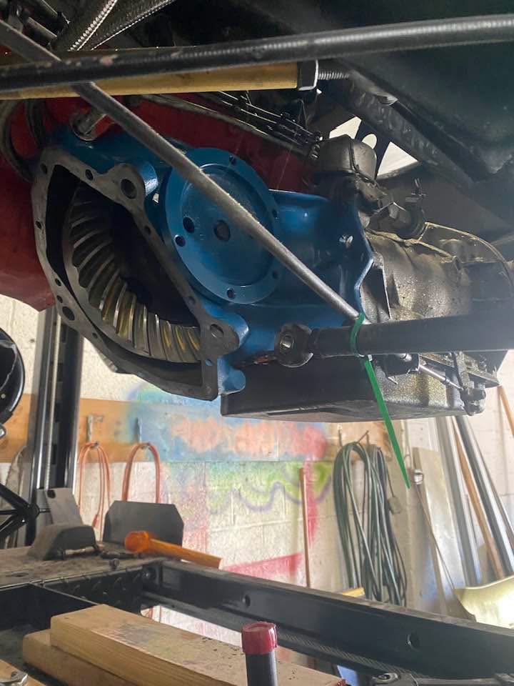

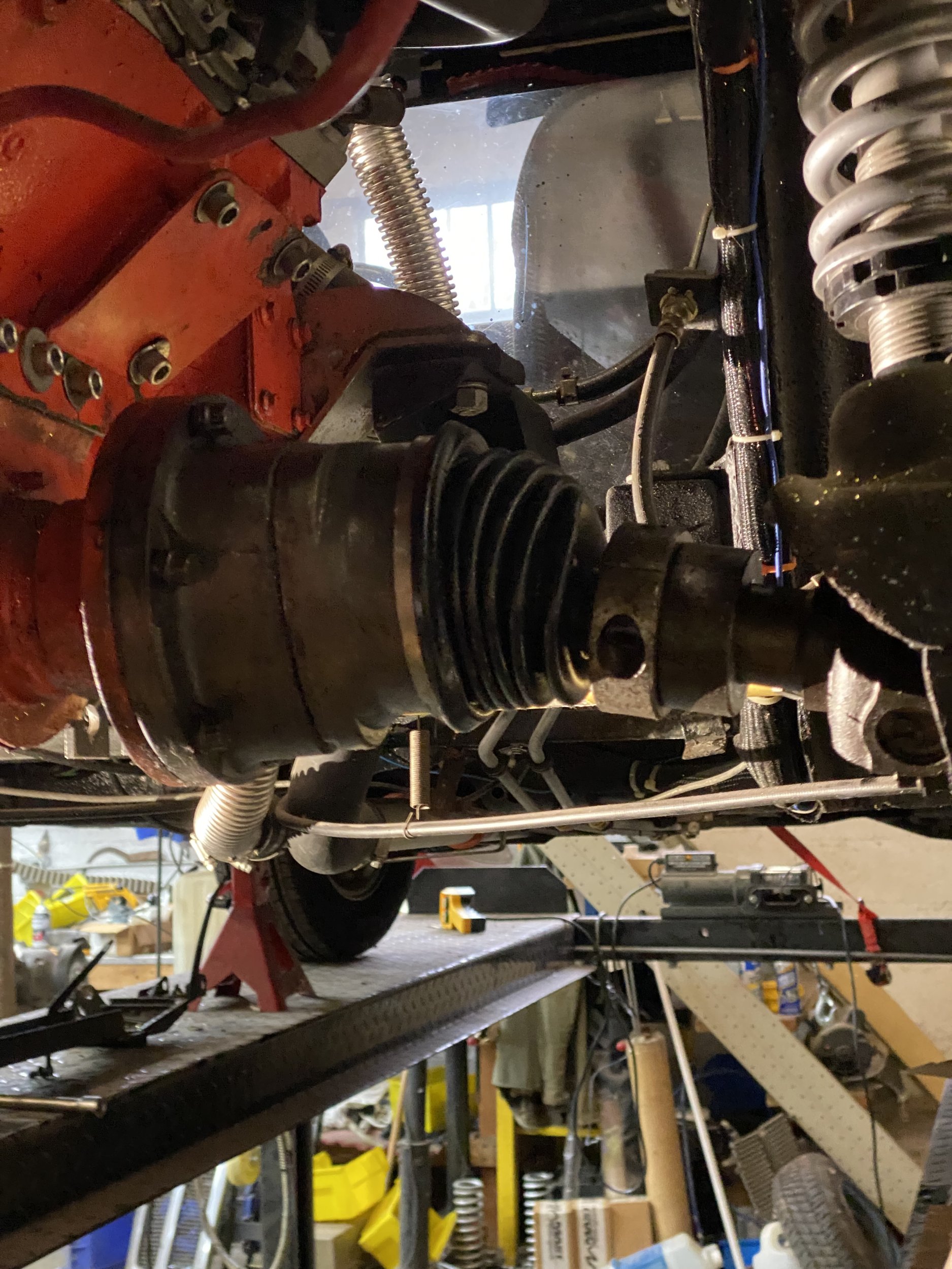

    My old control arm bracket was, to say the least, a real piece of ****. So, with the new 4:10 gears, I decided to build a completely different control arm bracket. Once the final drive was in place, I got to work with some thick wall tubing and some 1”x 2” rectangle tubing. The first picture shows our original idea. The second picture shows the finished brackets today. IMG_3264.jpeg IMG_3272.jpeg

    After some finish welding and powder coating, it came out exactly as planned. For those of you thinking this is ********, let me explain. While functioning as a control arm bracket, it is really just the camber adjustment. There is no lateral movement in this setup. Unlike the Corvair and Corvette setup where everything has a twist factor built in. This is trailing arm up and down only movement. Anyway, here is how it looked after installation IMG_6907.jpeg IMG_6906.jpeg
