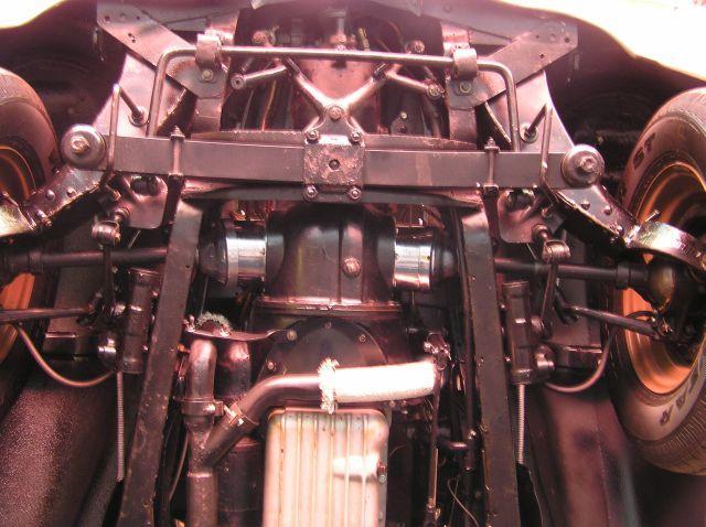

    As a REALLY FNG, I hope these pics work. Not taken by me or of my car, but should help. On the 36 Cord 810 I have, they just cut the axles in half and left the hub intact when the flattie/lasalle were installed.

    What did they use for CVs anyway? I can't really tell from any of the pics.

    It's called a rzeppa joint for the CV's. Has a race and cage inside of that roundish shiny metal cover with some shooter marble-size bearings. I also think there was one inside the boot as well. These went bad often in the early examples and clacked like hell during turns - a very bad thing for a $3,000 car in 1936.
