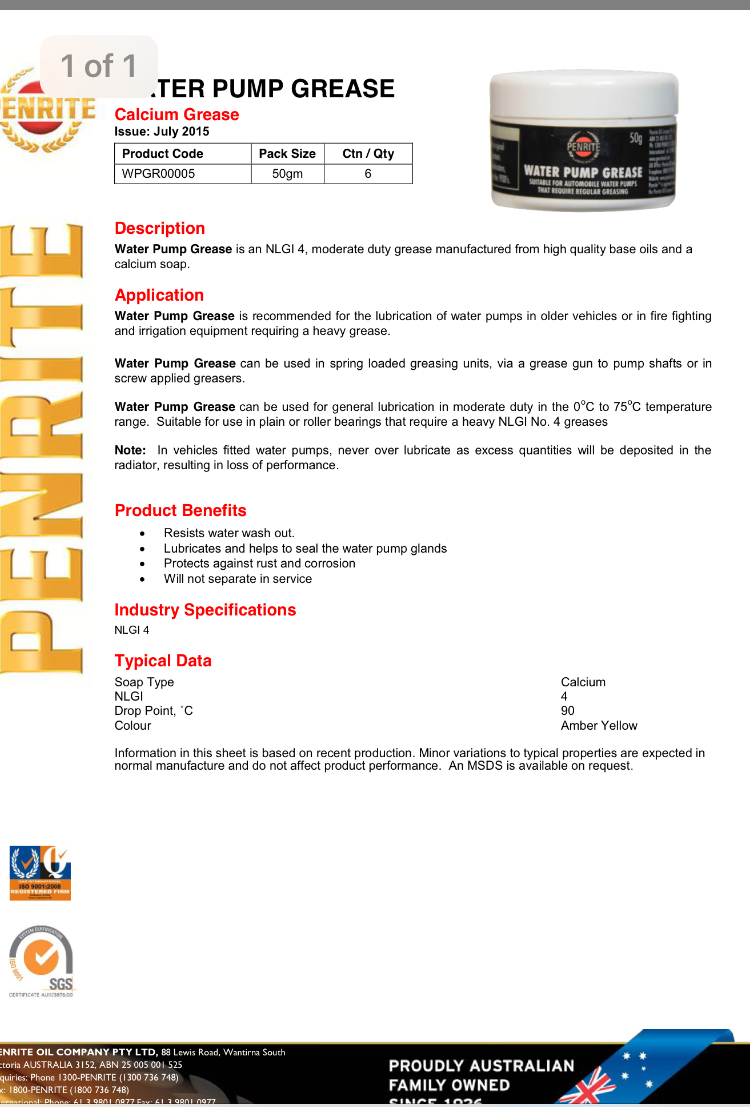

    Torana68
    from Australia
    Or this
    akoutlaw likes this.
