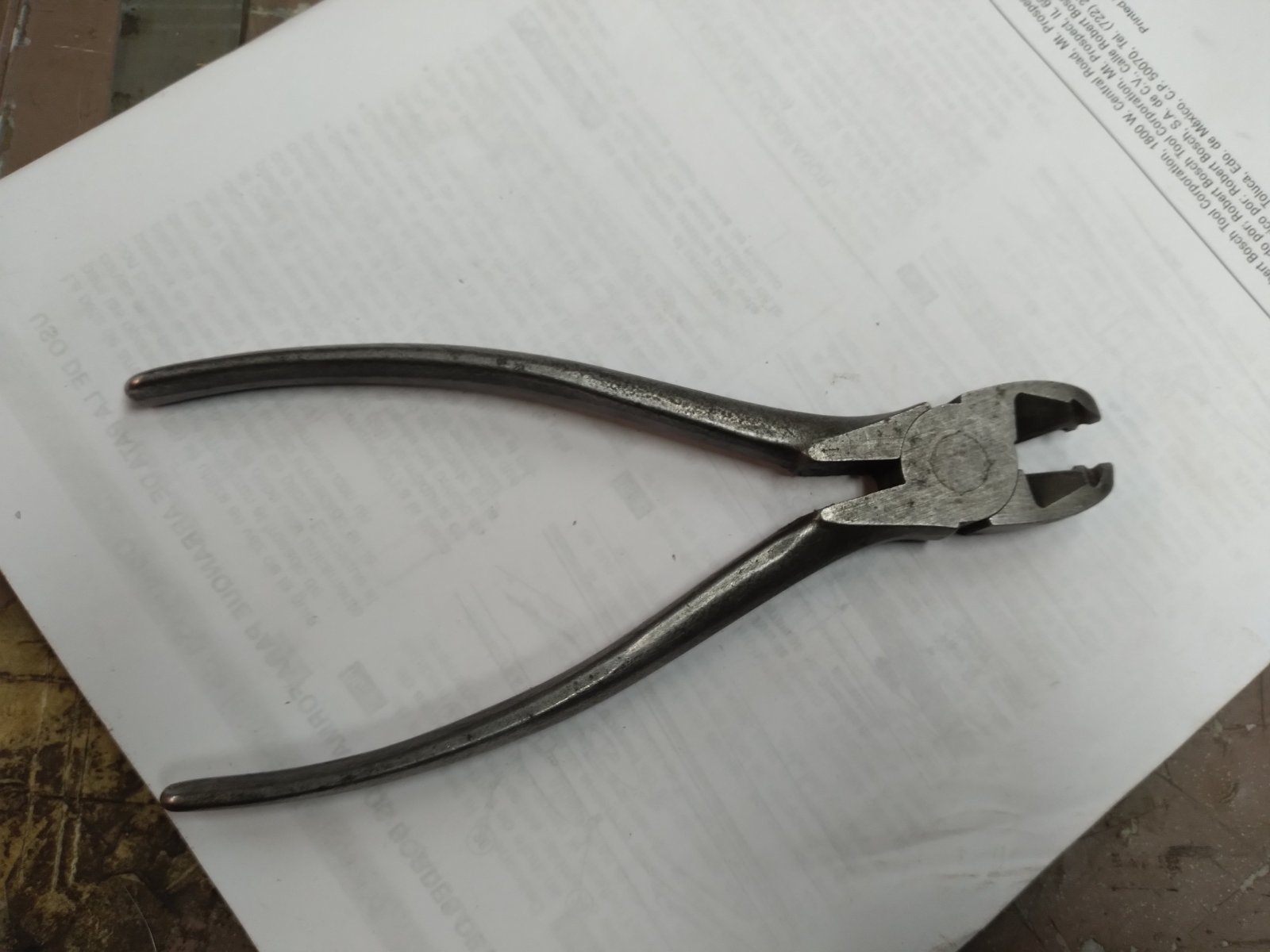

  12. Those look a lot like my hose clamp cutter pliers. Mine have red handles ... but otherwise the same.

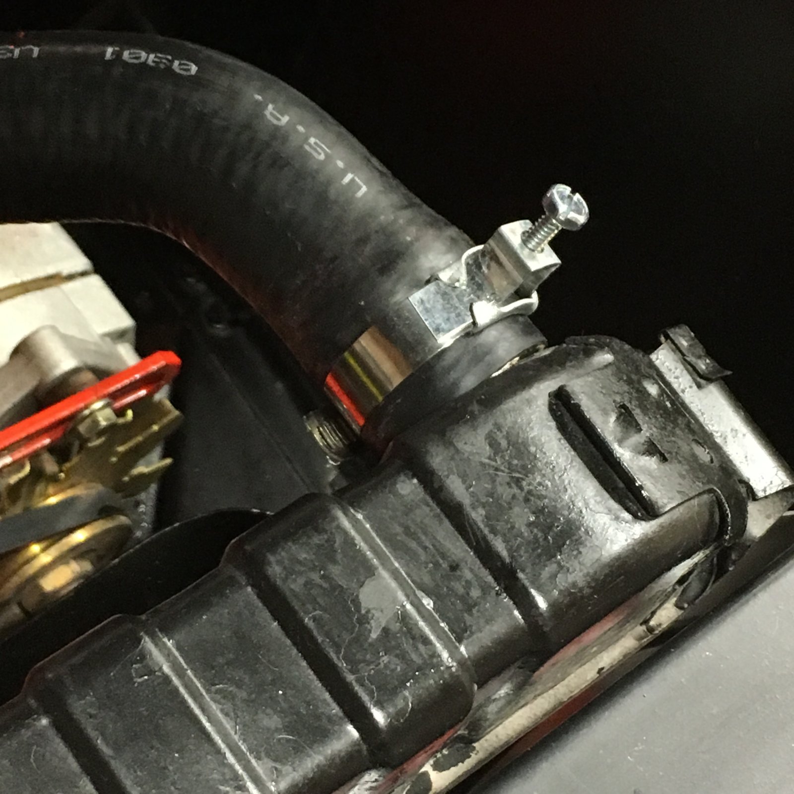

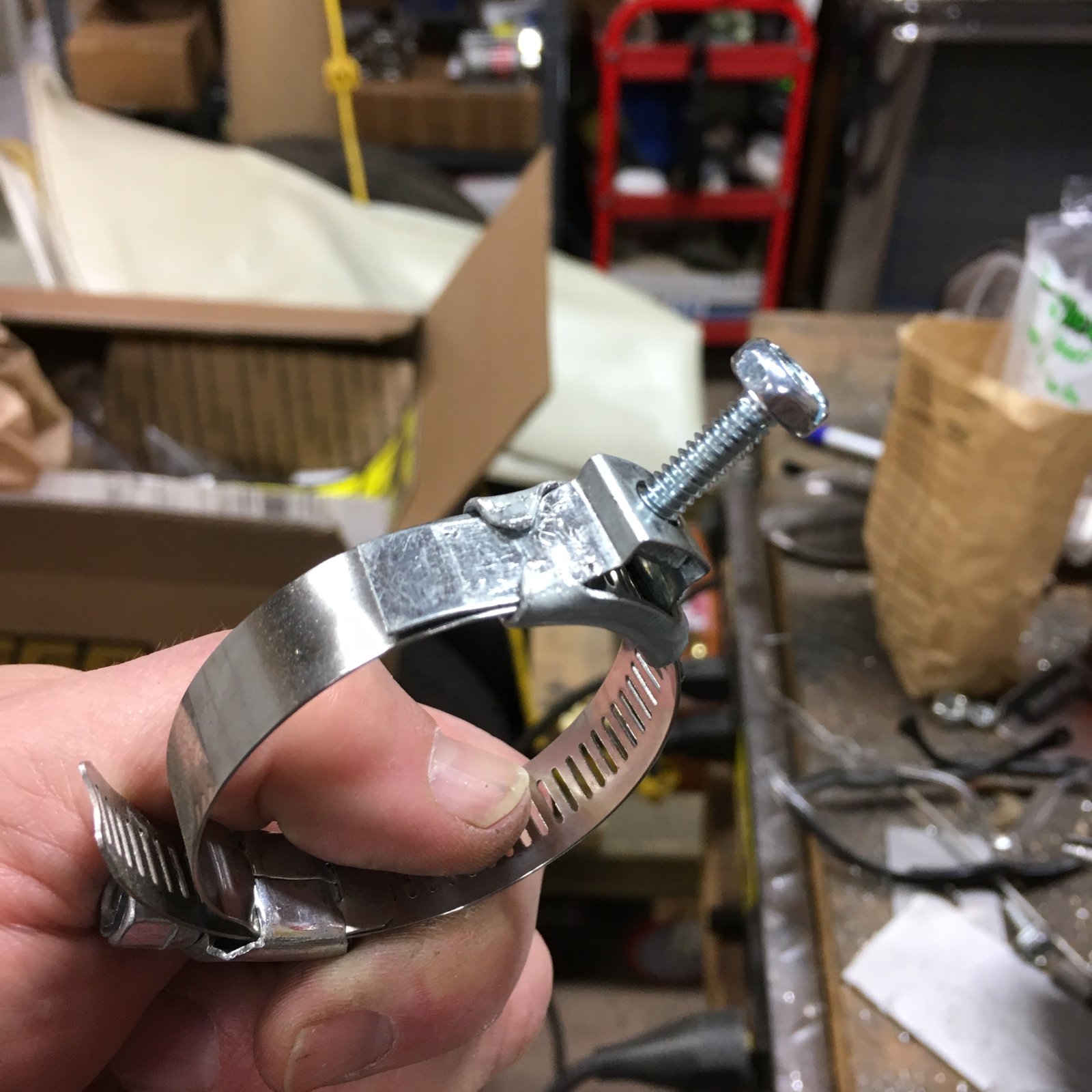

    My 442 has that style clamp like your top pic. They hold tight, don’t leak, easily removable and they are stainless steel so the polish up nice.
    I sold a little 62 nova a few years back and made “tower clamps” for it.
    I should patent them

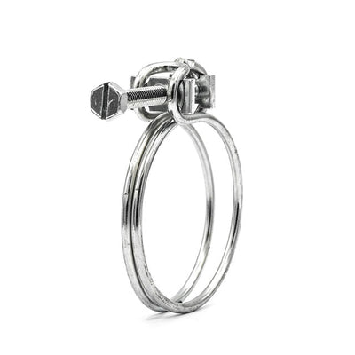

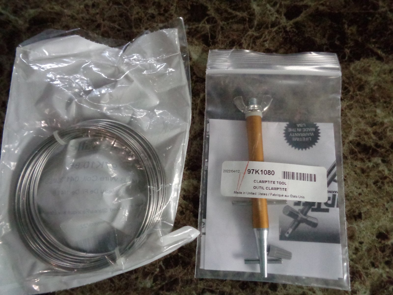

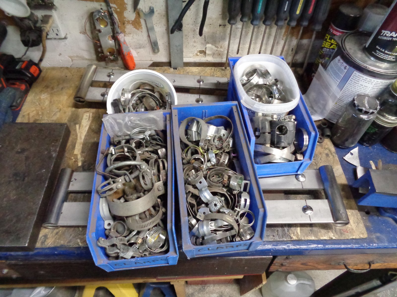

    I have always saved any clamps that I deemed re-useable and have ac***ulated a few bins full; bought a variety of several dozen new ones at a yard sale 30 years ago and bought one of these wire clamp tools years ago that I have not used yet.
    If they do the job, they are not only good, they are good enough.
    29Sleeper likes this.

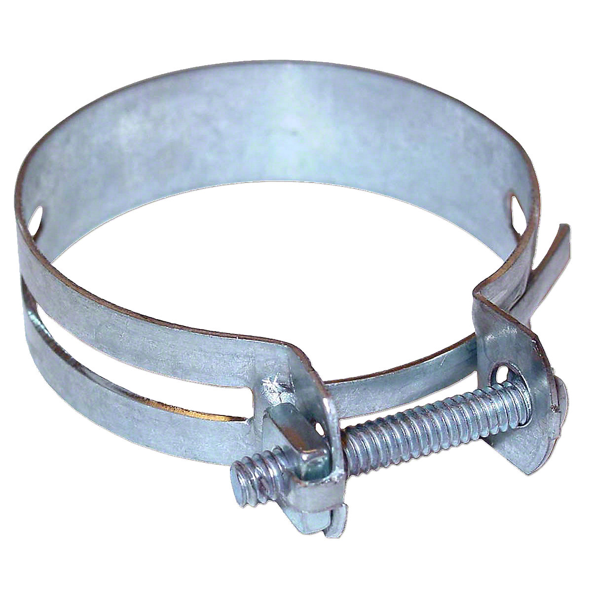

    Worm gears clamps IMO clamp down the tightest. The OP wanted period correct, if you have proper size hoses towers should work fine. I have owned my "61" for 37 years with the tower type clamps, never had a problem. My car is a garage queen and rarely sees weather so they still look new without rust.
    I use the old thumb screw tower type on my "32", besides looking period correct, they worked a hell of a lot better then the early Ford repop clamps with the sliding tongue. Those are junk.

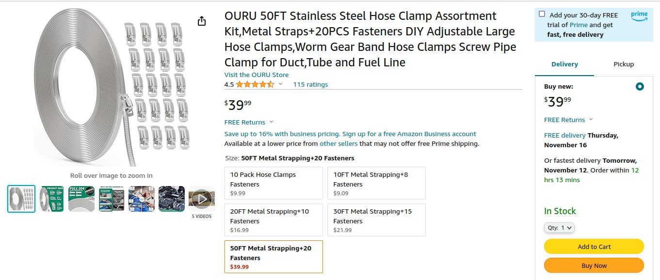

    A 2 B >>>I have always saved any clamps>>ac***ulated a few bins full; bought a variety of several dozen new ones at a yard sale 30 years ago and bought one of these wire clamp tools years ago that I have not used yet>>>>
    Since you seem afflicted with hose-clamp obsessive-compulsive disorder, I suggest this kit might satisfy perhaps one of your deepest desires to have your very own clamp for up to a 16-foot diameter hose should you ever need it.
