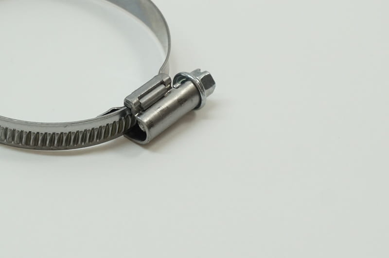

    Sometime back, a friend was using these from the Porsche dealer. Instead of slots to drive the screw, they are pressed like a closed louver. Very high quality.
  4. alanp561
    Joined: Oct 1, 2017
    Posts: 5,985
    alanp561
    Took me a minute. The inside is smooth, no slots so the screw doesn't chew up your hose. Very cool:cool:

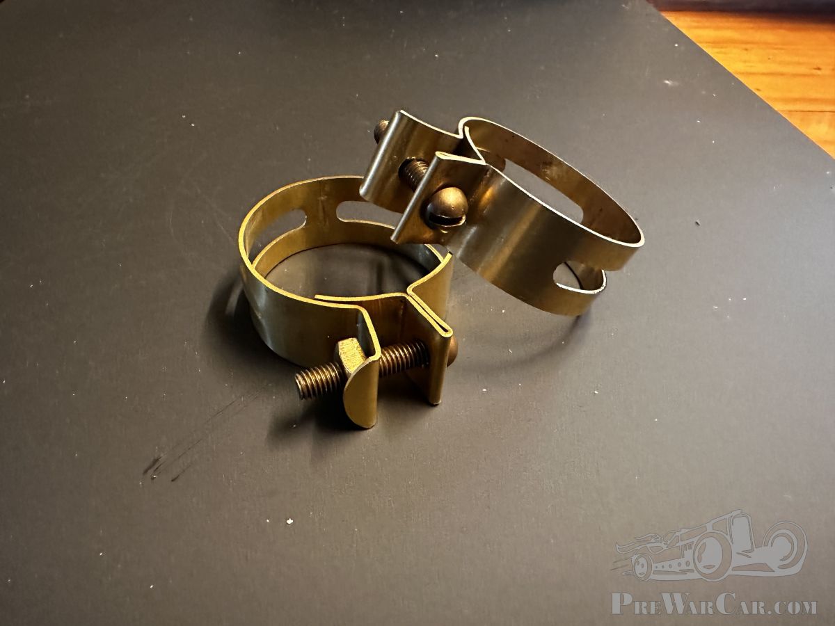

  7. If you have to buy clamps anyhow why not spend a little extra time finding more period clamps. If they're close to the same price as new ones, built better then new ones and only takes more of your time to look for them....I say why not?
    Here's what I found a few years ago, a little more then new, but WAAAY better and it was cheaper to buy in bulk.
    alanp561, teach'm, squirrel and 3 others like this.

    These work, and I am sure have been around for a while...
    at a certain point the obsession for perceived "period correctness" becomes ludicrous.

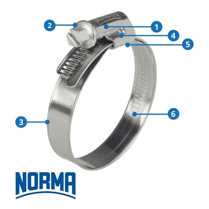

    I just ordered these in various sizes. they are well made and stainless.

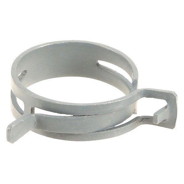

  16. Spring clamps do **** to get off when they're not positioned right. Also they must be put on in the same spot if reusing the hose or the chance of leaking is higher.
    I shouldn't have used the word "period" as much as I should have used "old". That being said I can tell you I paid less per clamp then the T bolt style clamps and I enjoy looking at the box. The whole period correctness of it is lost on most regular people and I never show my cars...so it's moot point. I'm just doing what I like for as long as I can.

    search amazon for "Norma Hose Clamps"

    The Norma brand screw drive hose clamp looks exactly like the Bimmer stuff. 6mm drive nut, large flange behind the nut, formed threads. Numerous subtle details including a slight chamfer on the edges of the band to keep from digging into the hose. These are quality pieces that hold up over decades and hundreds of thousands of miles.
