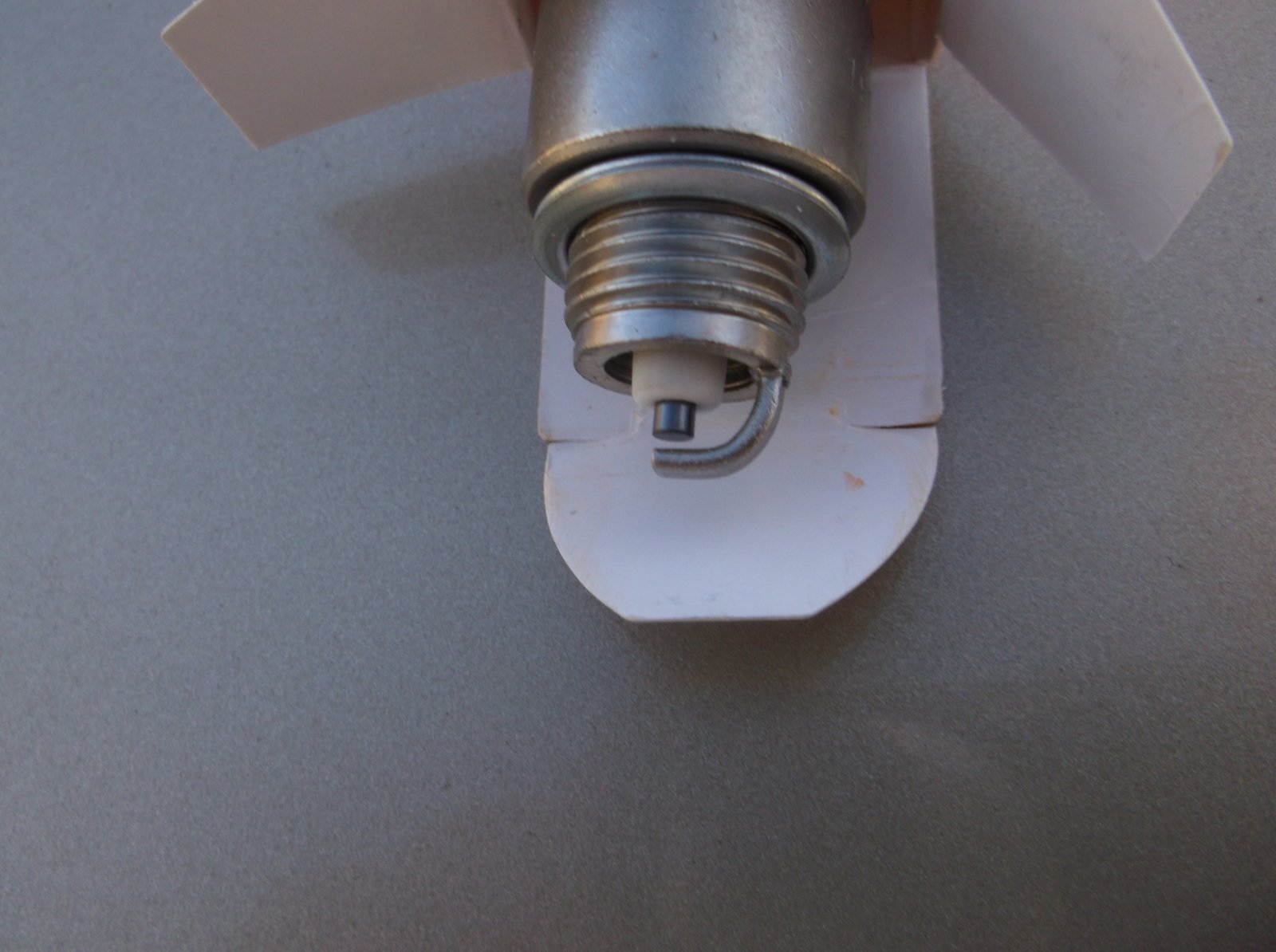

    the end on the orig is the same reach DSCF5631.JPG DSCF5635.JPG DSCF5634.JPG

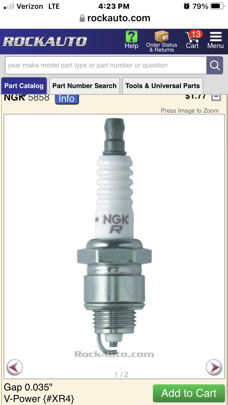

    so these are the correct, and best plugs for my ap . the price is nice . but you have to purchase 8 from rock and $10 shipping . not that price matters if they are better .
