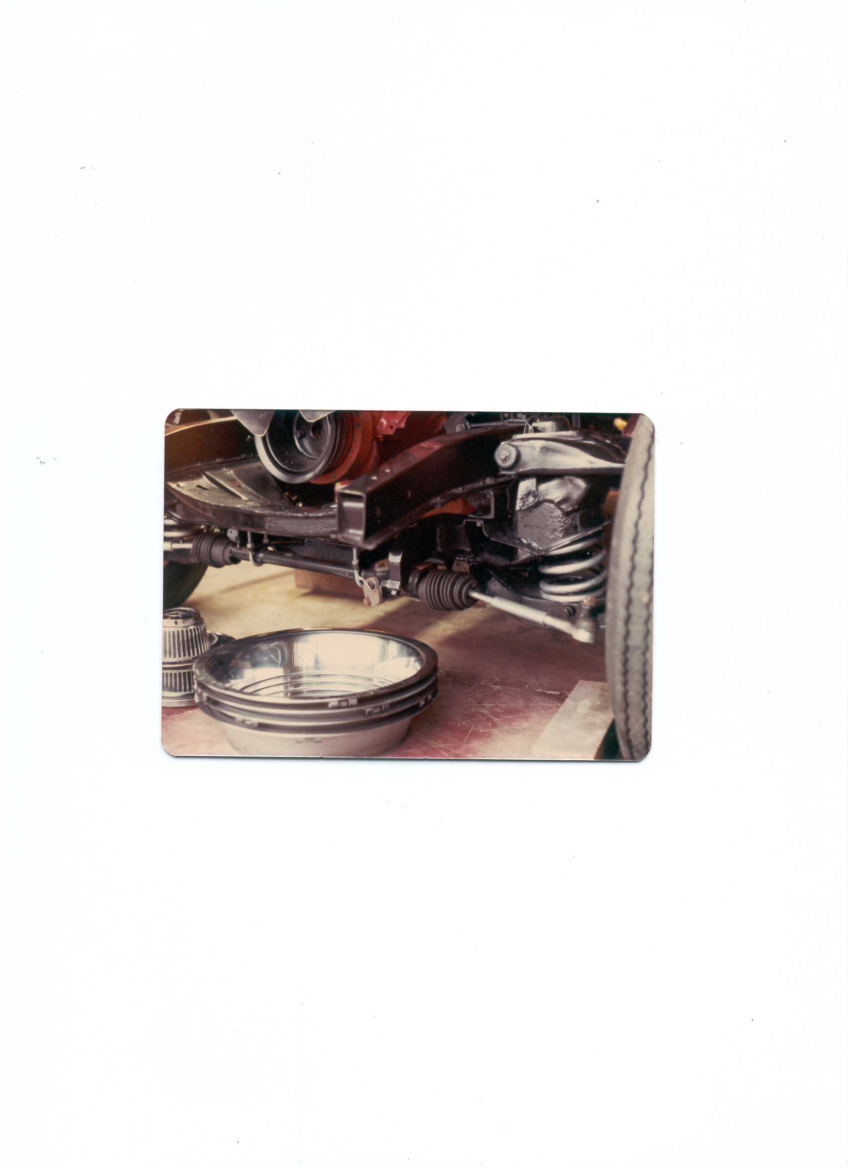

    Really...????? Hmmmmmmmmmm, here's one for all you naysayers:
    Been running a Corvair under this car since 1977...!!! Used a Pinto rack (with lengthened arms and modified steering arm) and have NEVER had a bumpsteer issue...IF you get the Ackerman correct, you won't have a problem. The car does not turn on a dime, but knowing that, you can learn to drive it that way. Keep in mind this was pre-Mustang unit...
    Currently the car has 140,000 miles on it...I've rebuilt the front end once in those miles and had to redo the brakes three times (due to the smaller drums they tend to wear out faster), I'm now about to rebuild (or buy new) another rack as this one is getting worn. I've never had a tire problem (wear) and the front end aligns very well.
    A lot of HAMBers have seen this car at the HAMB drags...I'll drive it anywhere anyone with a Mustang front end can.
