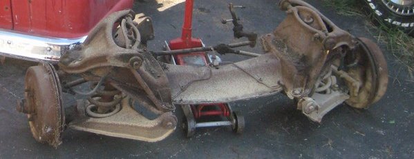

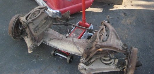

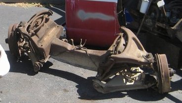

    "Sounds like the Corvair van suspension would make a nice swap into a bigger car or truck."
    Here are some pictures of a Corvair van suspension.
    They are front steer and use 11" x 2" brakes #228.
