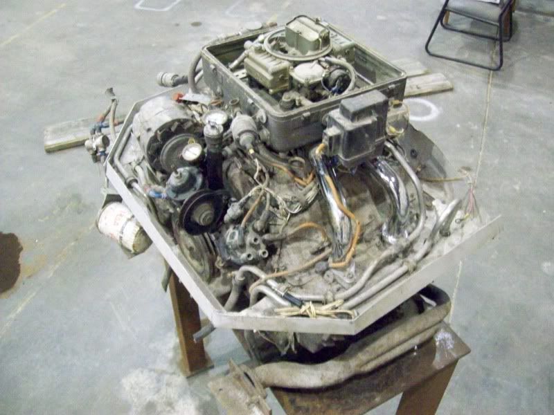

    Picked up a corvair engine today. Has SOLAR on the cast aluminum valve covers also a cast aluminum oil pan cover with fins. The odd thing bout the engine is, it has a box that a Holley 4 bbl carb that sits in for a pressurized induction. Googled corvair solar and didnt get much engine info. Where might I look for numbers on the block or heads? Any info would be nice. Thanks in advance.

    Here's some pics

    It's some kind of hot rod but not an airplane. The sheet metal has been made to fit into some kit car body not Corvair or VW.
    In the sixties there were a lot of different people making Corvair accessories. They were considered a poor man's Porsche and a lot of sports car fans bought them. I'm sure I have seen the valve covers and intake manifold before. The supercharger carb box is a new one. Could be for a Paxton but I don't see a drive pulley or mounting brackets.
    Whatever it is somebody went to a lot of trouble and expense building it up.

    Supercharged Dune buggy?

    It's definitely not for an aircraft, so
    it's nothing to do with 'Solar Aircraft
    Co.' and the other 'Solar' company
    that someone mentioned here, as
    being now owned by Caterpillar,
    makes (and I think, has always
    made) - industrial gas turbines,
    so it's probably nothing to do with
    them either. Most likely, it's
    somebody's fairly well-thought-out
    and somewhat "bucks-up" home-built
    engine project, dating from the
    late-60's or early-to-mid-'70's, and
    likely for a dune buggy or a sand-rail.
    Offy made cast aluminum finned
    valve covers and finned - stock and
    deep-sump - cast aluminum oil pans
    for Corvairs. Another company,
    IECO, circa late-60's-early-'70's,
    made steel-tube 4-bbl manifolds for
    Corvairs, very smiler to what you've
    got. If you check out the list number
    stamped on the Holley carb choke
    tower, I'll bet it deciphers out to
    a 390 CFM carb - which is what IECO
    used and recommended with their
    manifolds. The box around the carb
    is for a either a centrifugal
    supercharger set-up - probably a
    Paxton - or for use with a home-brew
    turbocharger set-up. It's kind of cool
    but I'm not sure what you'd do with
    it - other then maybe buy a Corvair
    to stick it in, or build yourself a
    'late-60's-style' gl***-bodied dune
    buggy, that were all the rage for a
    while back then. But neither - with
    the slight, possible exception of an
    early-model Corvair maybe - are
    really "HAMB friendly" Still 'kinda'
    cool' though. :)

    I still say it was for a kit car. Someone has gone to the trouble to make shrouding to fit to the body which is necessary to keep an air cooled engine from overheating. They made heater ducts to feed heat to the body too. Neither of these things would be necessary on a dune buggy. The engine would be out in the open and there would be no heater.
    There were a lot of sports car kit cars based on VW pans that had room for a Corvair engine.

    What an interesting unit.
    The big circular connector & carb box scream aircraft, but the rest of it does not.
    The heads are the 140 horsepower units, which originally had 2 single throat carbs on each bank. More than one aftermarket company made a plenum & chrome runners to mount a Holley carb.
    The OEM oil filter mount has been cut off & tapped for a remote filter. Not a common mod even in a buggy or kit car - it was not usually in the way.
    The two fittings on the valve covers & the elaborate hard lines plumbed to them are again aircraft like, except for the rubber hose at the head. The large vertical loop in the lines rules them out for turbocharger oil returns - unless the turbos were a foot above the carb.
    With all of those mods, they kept the stock fuel pump? And a more or less stock ignition?
    It would be interesting to see closeups of whatever that circular connector is wired to. What does the warning sticker say on it?
    One thing does come to mind. In the sixties, car parts were fair game for aircraft ground support and military prototypes. The SR71 aircraft ground starting cart was built around a pair of bad*** Buick V8's. There were experimental vehicles as well, like the Gamma Goat. This engine could have been part of some prototype, and modified later. The military looking airbox may have simply been a way to connect that carb to a donaldson type air cleaner - dirt proofing the entire holley.
    Keep in mind is that the stock Corvair engine rotates "backwards". There are cams made to make it rotate the "right" way. This was common when putting one on a VW transaxle.
    The 140 heads are desirable to Corvair people With those heads, headers & a stock cam, probably good for 150 - 160 hp.
    Thanks for the pics.

    Ok, after the morning coffee, and the re-post of that pic...
    That flywheel & pressure plate appears to be a VW adaptor flywheel.
    The OEM corvair had a flat flywheel like any other GM car of the era. The ring gear was welded to the pressure plate, not on the flywheel
    The two studs hanging out on the bottom are VW style too. I believe it is already set up for the VW, so it may have the "reverse" cam in it too.
    B.

    It has a VW adapter on the back. So it could have a reverse rotation cam or the transaxle it was in had the ring gear flipped. Corvair and VWs spun opposite directions

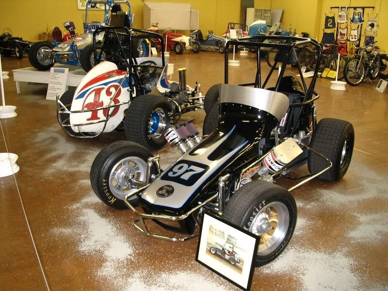

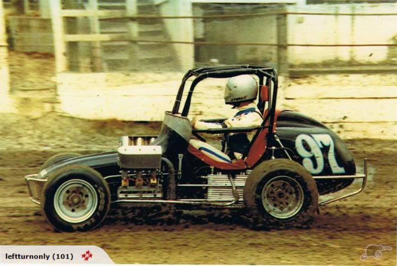

    Above: Back in '78 my Dad and I, plus brothers built and raced a Corvair powered LTC midget. The motor featured TRW forged pistons and internals, a Crower reverse-rotation cam, Hilborn-style constant flow fuel injection (made by dad), and a dry-sump oil pump (also made by dad). It was turbine smooth and pretty quick, but we didn't set the world on fire, so to speak. It was a father and sons project, built on a low buck budget.
    After a few seasons it was sold and we moved on to other midgets and racing endeavours.('nuther story)
    Years later many parts were located by Tony Putt who retrieved them and the car was rebuilt as a show-only vintage midget.
    Above: The Corvair midget on display after rebuild by Tony Putt.

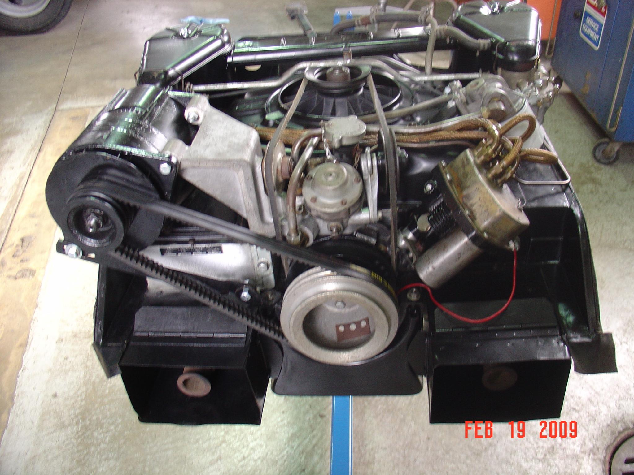

    Here are some pics of a Corvair "Military" motor. We restored this a few years ago and it is on display at the Buffalo transportation Museum. This was used for the Canadair Personnel Carrier, that never got into large production.
