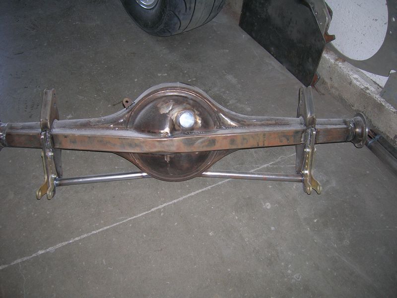

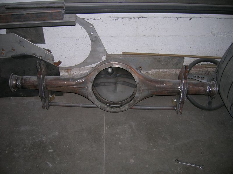

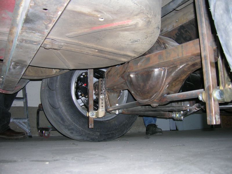

    When i built the driveline i tried to make it as bulletprrof as possible, 5/8 wheels studs, strange 35 spline axles and spool, 1958 olds/pontiac rearend with back brace, strange chromoly yoke, chromoly trans yoke, 1350 series u-joints, 4 link fit underneath the stock body with x locator and strange coilovers, so far so good.
    jp
