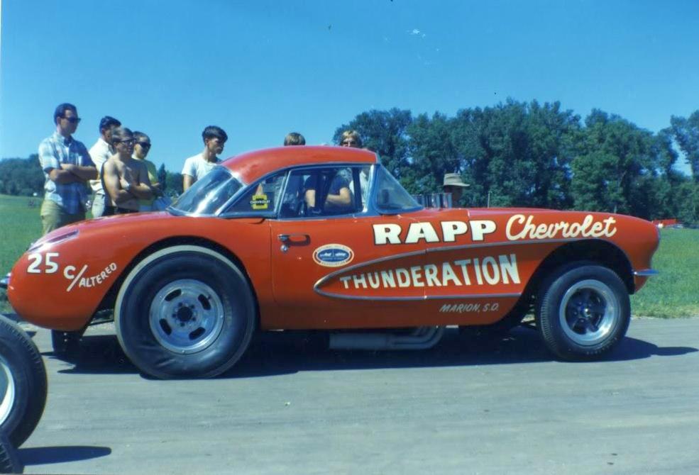

    Good eye, but also see how the front and rear wheel axles are pushed forward compared to a stock 56/57 vette. Notice how the stock vette center line of the car rear axle is about 5" behind the rear of the hard top.
    Thunderation's center line of the rear axle is abour 2" inside the hard top. The front wheel alxes on both cars pictured, look to be pushed forward about 2". I see that on many SP/M cars. Jim

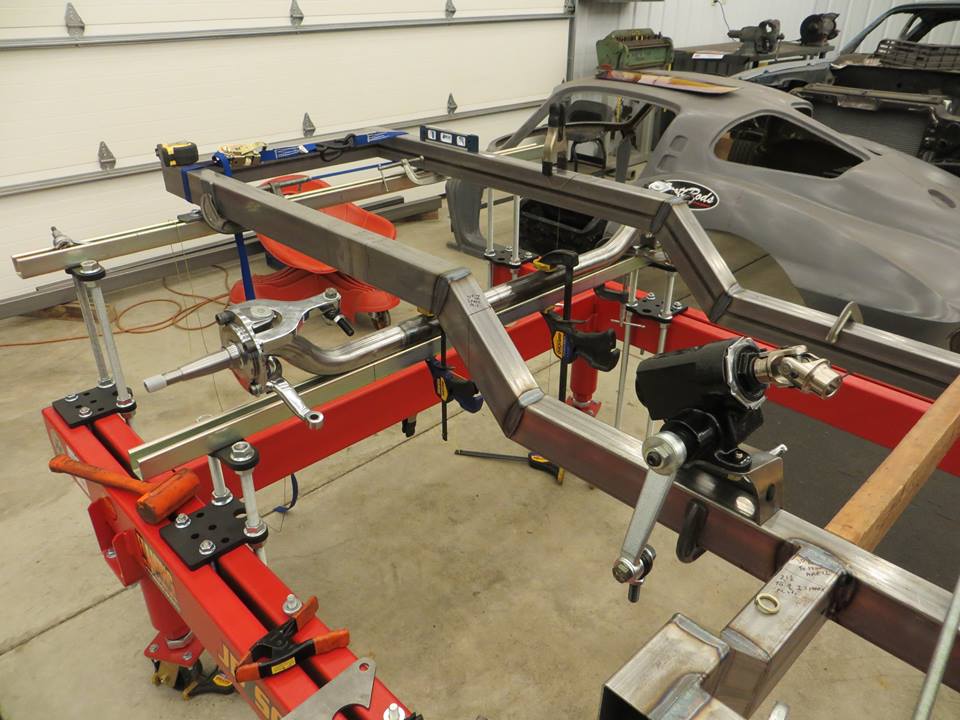

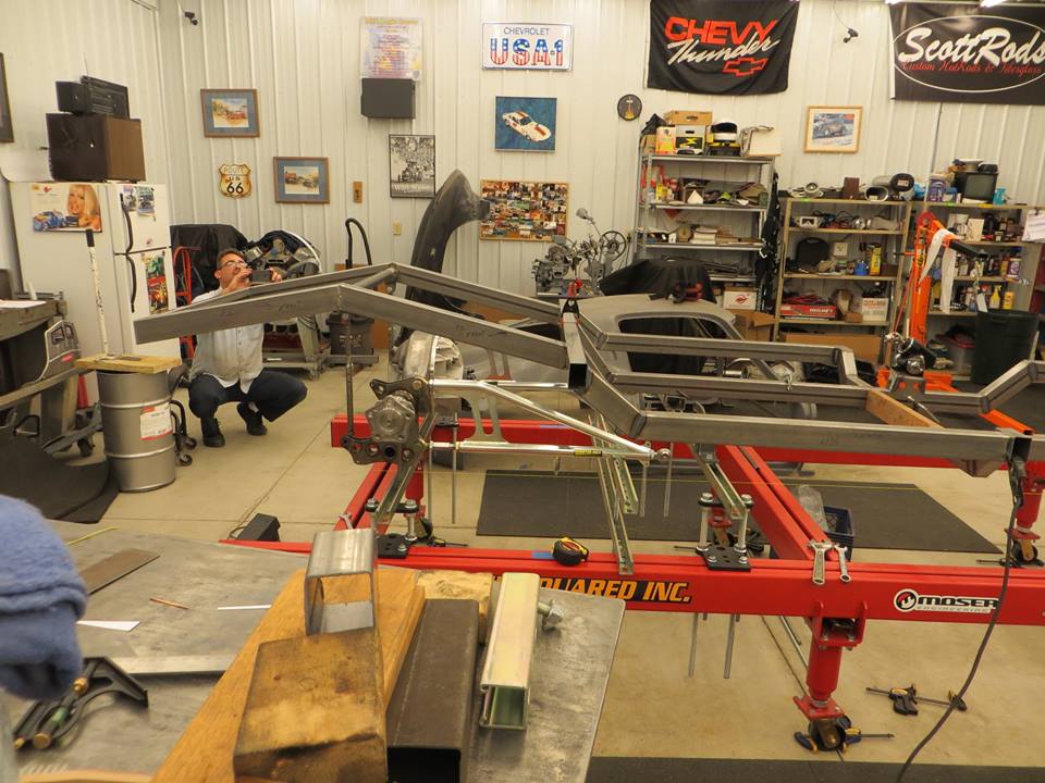

    my vette 18.jpg Heres an update on the ch***is for the ScottRods Vette G***er build. my vette z-frame rails.jpg

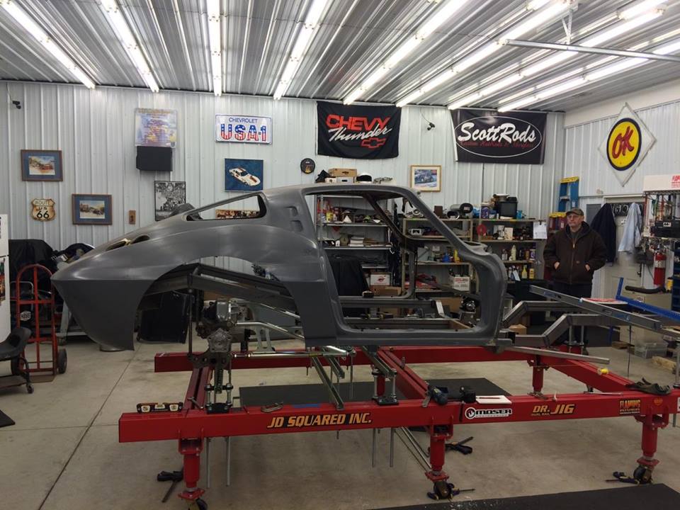

    Got the body mounted , time to start the main hoop and cage. my vette 20.jpg

    That is one beefy steering arm Scott! Have never used a Corvair box...how does it compare to the Vega/cross steering set-up? Almost used that set-up on my '63 Corvette.
  19. Scottrodsllc
    Joined: Dec 13, 2009
    Posts: 232
    Scottrodsllc
    from ohio
    I don't think there will be any difference between the two box's, The corvair box is a little lighter and fits this application a little better than the vega.
    Rat Sass likes this.

    I am searching for another steering arm, I'm a little fussy about my stuff and I donot like the "beefy" look of this steering arm, Also a straight pitman arm would work better on this and I have not had any luck finding one of them either.
