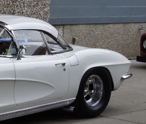

    I’m still trying to figure out how they got that wide of wheel/tire under there!? That has to be pretty tight fit! IMG_5644.JPG

    I agree with Chuck's ***essment on the tire width. For a while guys were pro streeting the old Vettes and this may be a left over from that style of "improvement". When I bought my avatar car in 1982 that was the plan of the owner. The super wide tires came with the car and I sold them to a neighbor. It also could be an ex-racecar that had the rear end narrowed. Even fitting an 8" wheel is tough if you want them tucked in. There is only so much room before you run into the leaf spring.

    Well mini tubbing and narrow rear frame rails, stretch quarter panels as needed.

    Whatever he did it looks good.

    Not that hard to do 31 and without frame modifications. Jim D hits the mark, its the rear springs that reduce tire width. My friend's 61 with a 436" sbc , which I wrench and drive for him, has the rear springs removed and moved to the inside of the frame and mini tubes. Lot of room now.
    My red car sits real low, mini tubes, 4 bar suspension, coil overs, No frame mods. It runs 315/35/17s, 12.4" of tread, side walls are wider. 11" rims, 13" side walls. Stock rear housing width, although be it the 9.3 (57-64 Olds/ Pont) Sorry no pictures, as I am still on the laptop, not my main PC. Jim
