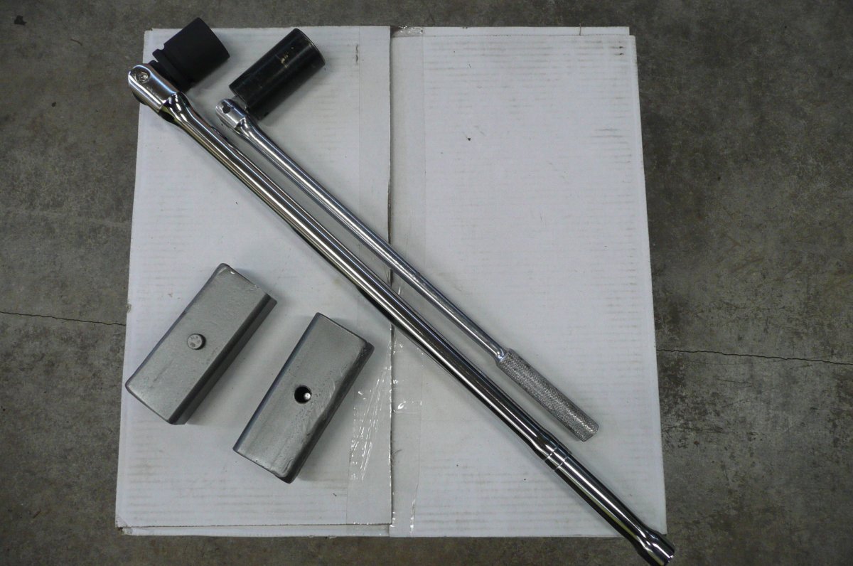

    A couple of other things needed attention. I had 1" lowering blocks on the car. When removed, I found cracks and mis-shaped holes where the spring center bolt rested. I knew I didn't want aluminum again, so I built a pair using some 1-1/2" x 3" tubing. I just cut the tubing to 2" wide, welded in a piece of plate, and drilled holes in the center. Put a short 3/8" bolt/nut on one side and done! Now I've got new solid lowering blocks, 1/2" thicker than previously. I also installed new properly sized u-bolts, 2-3/4" instead of the 3" bolts I had on hand when originally built. Much better.

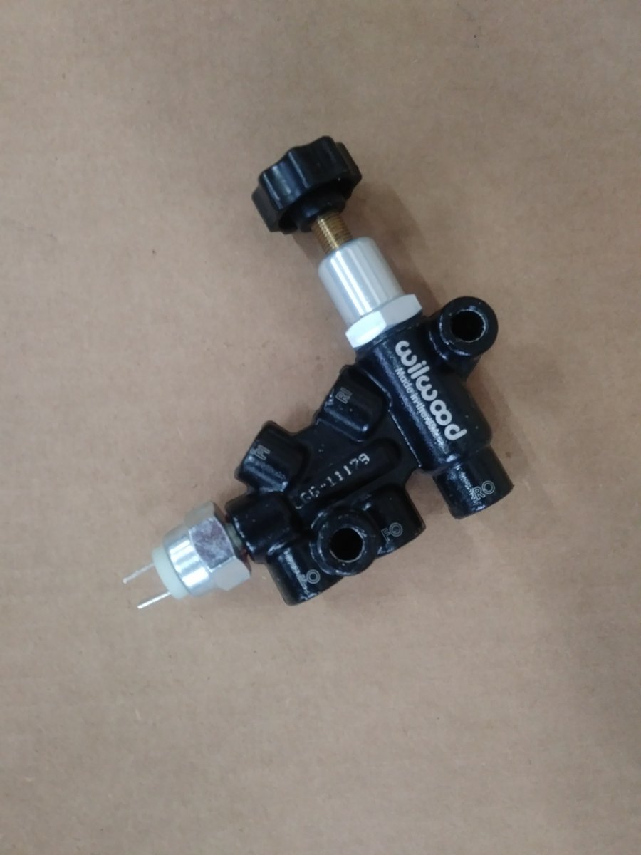

    I got the car back together, and after adding about $50 worth of LS gear oil, took it for a test drive. Noticeably higher gear, and a real difference when I really get into the throttle. Only thing is, brake pedal feel really ****ed! Here's another snowball. I never did have a very good brake pedal feel. It always took one pump to get a good pedal. I always ***umed it was something about having disc brakes on the front and drums on the rear. NOT.

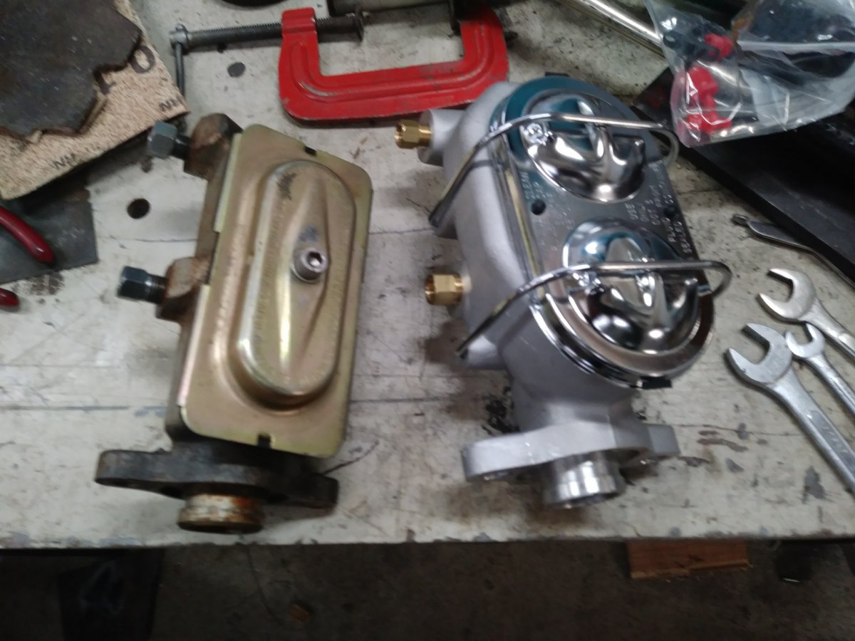

    I tested the master cylinder and sure enough, it wasn't working properly. I was also su****ious of all the fittings I had in the system, with residual valves, proportioning valve, brake switch, tees. Time for a new master cylinder and removal of the now redundant residual valves. I decided to use the proportioning valve combo that Wilwood makes, which includes a brake light switch. This is a great little unit for building brakes.
    I was also ready for an aluminum master cylinder, I was tire of looking at the rusty piece in my nice engine bay. I decided to get a slightly larger bore size, thinking I would need to push more fluid with the bigger calipers vs wheel cylinders. I ended up with a 1-1/8" aluminum master cylinder, which turned out to be a little bigger than the one it replaced. I was determined to make it fit, and finally got it finished. A good brake pedal makes me happy.
    Had to cut away some inner fender and a little under the hood. It's such a tight fit that I have to loosen it to add fluid. Almost impossible to work on with the Wilwood clutch master cylinder next to it. Finally got er done. What I thought was going to be a $500 project turned into more like a $2000 project :)
