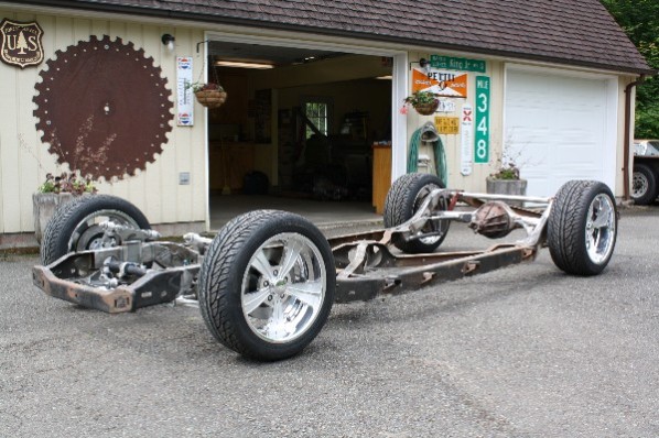

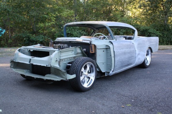

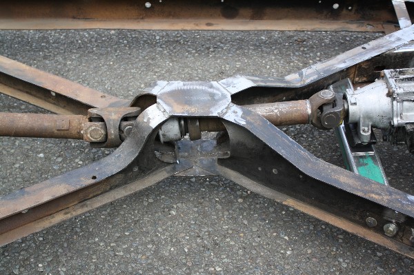

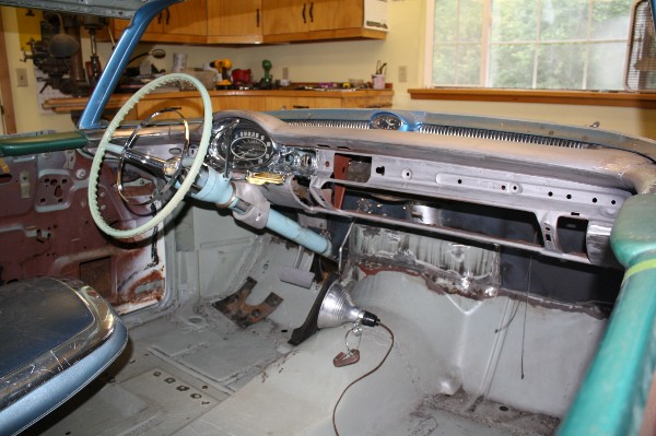

    I know this is a old thread but thought I would add this info in case anyone was interested. Here is my 57' Buick Super with 87' C4 front suspension. I used a Flat Out Engineering crossmember for 36-54 Chevy truck. It measured 29-1/2" which is exactly what my frame measured in between the frame rails. I used a 57-64 Olds/Pontiac 9.3 rear and made all my own brackets for the triangulated 4-bar. My engine is a 1966 425 Nailhead. Thats a 66' 401 I used for mock up and the two piece drive line is out of the same 66 Wildcat that the 401 came from. I also used a 57' Olds 98 dash.
