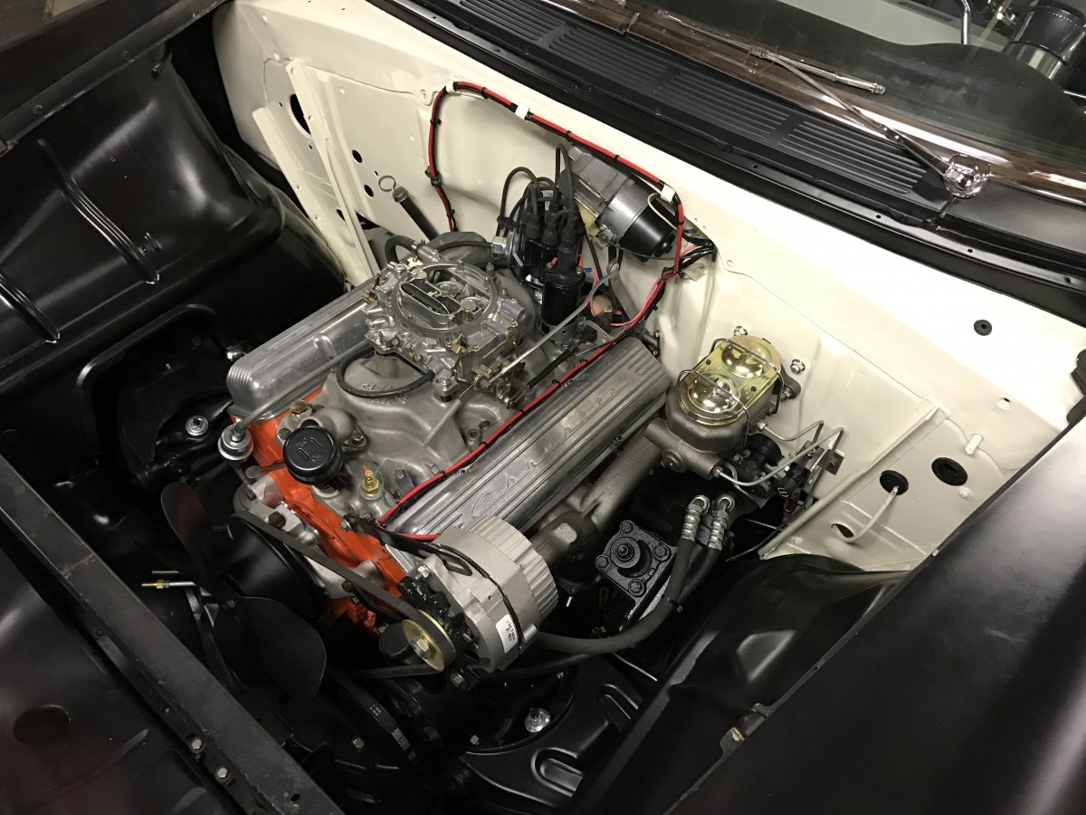

    I bought the same covers as you and they cleaned up nice enough for average standards.... Corvette covers 2016 002.JPG

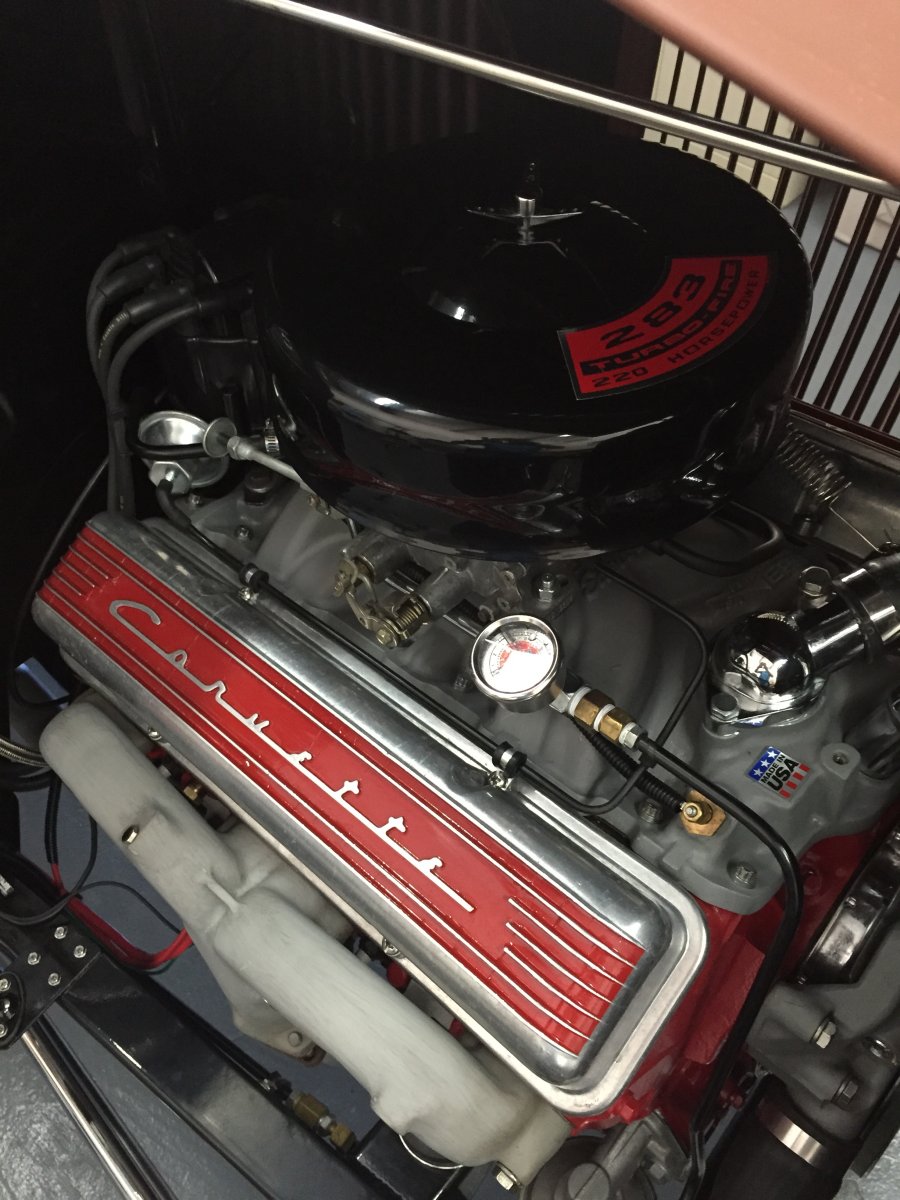

    I ran a set on the Fordor and I thought they came out great!
    Then again, I'm a poser so what do I know.

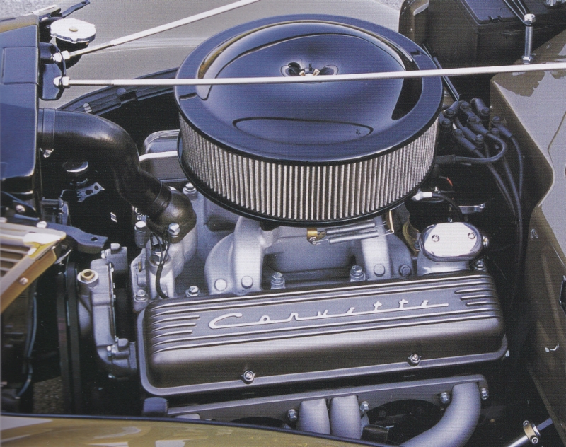

    These ones are getting the classic '60s polish and paint, but I'd like to get another set for my O/T ride and do this. IMG_20150911_0001.jpg

    They are about the nicest I've seen. How was that done?

    They aren't mine, but I think he painted them with a cast iron paint. They look damn good, don't they?
