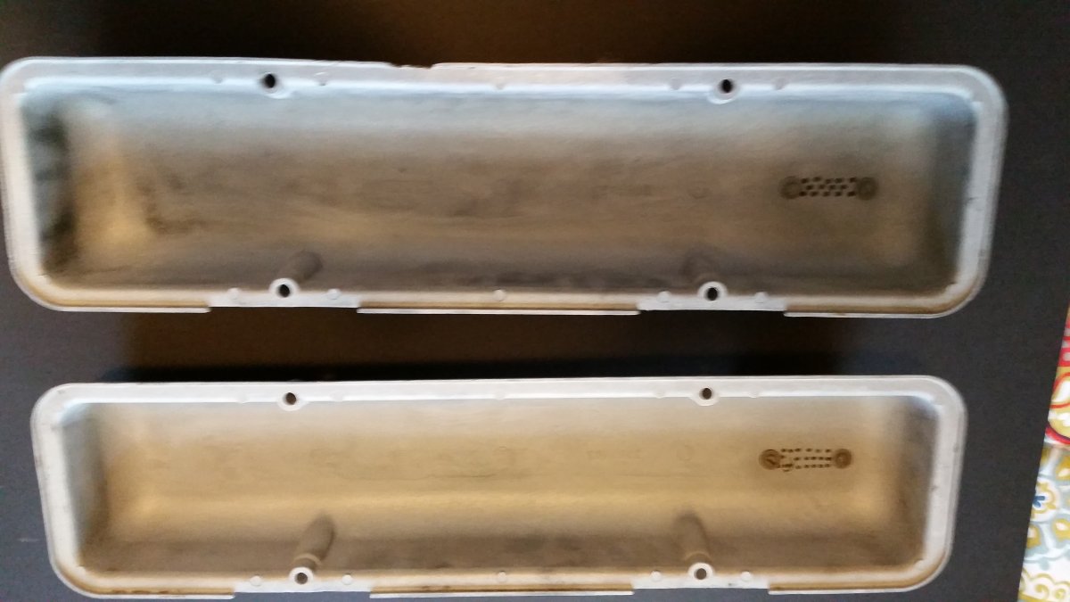

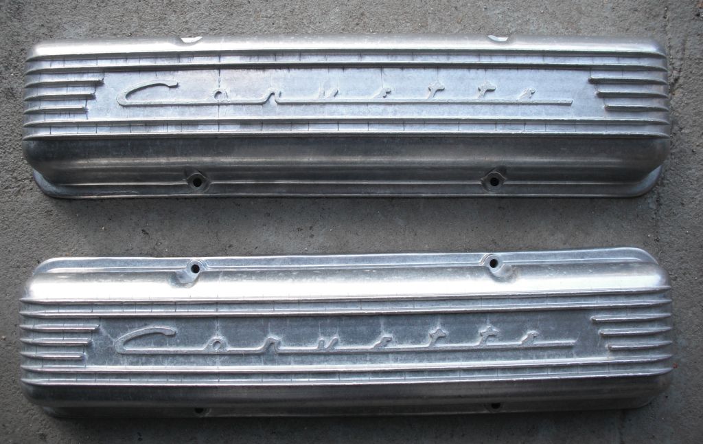

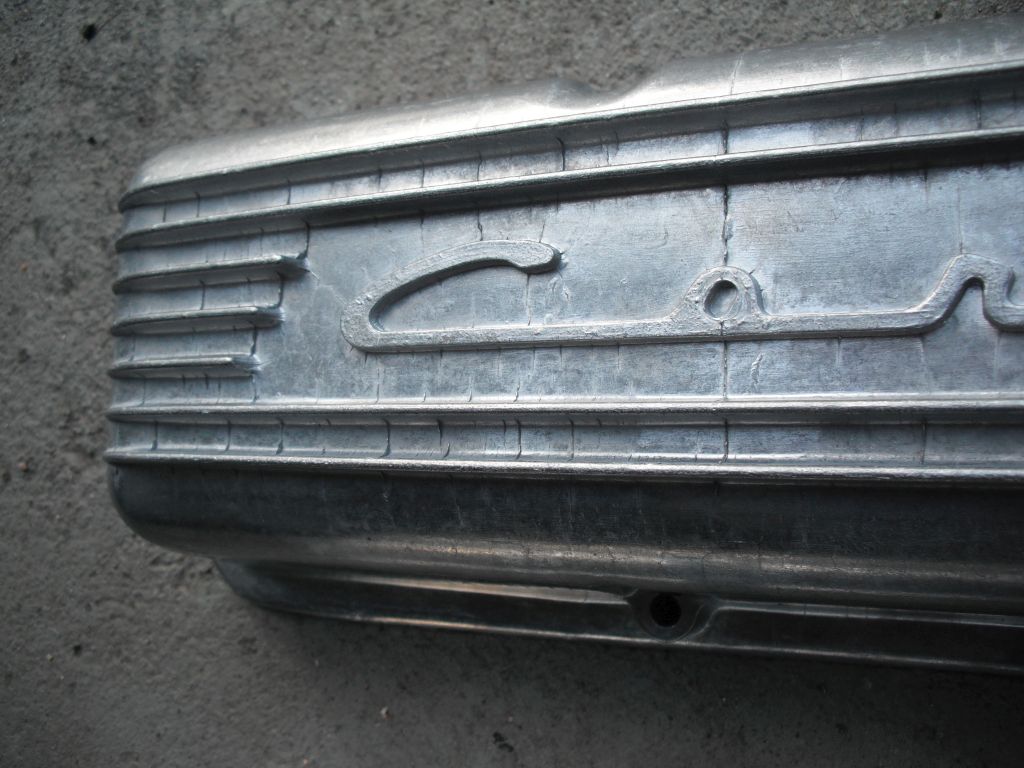

  3. falcongeorge
    Joined: Aug 26, 2010
    Posts: 18,339
    falcongeorge
    from BC
    there is literally no comparision between these and my original 9 fins, but then the molds were brand new when the nine fins were cast.

    Yikes! I think I have a pair of new ones that are nicer than that. Want me to look?

    I bought a brand new set from Chevrolet back around 1967. They looked like yours. I would swear they just knocked the sand off of them and threw them in the box. It took me quite a few hours to get them to shine on the sides. I painted the fin area Chevy orange and bolted them on my 283 that I had in my first 40 coupe. They were a great looking valve cover then and now.
    Took a lot of sand paper and elbow grease I didn't have a buffer then.. These days I start with 320 or 400 sand paper and work my way up to 1500 before buffing the aluminum.

  8. Mine were old and the line was very faint through the O. looks like the molds have worn some over the years

    Wow, those molds ARE on their last legs. It's almost criminal that they are still selling these. In that condition (semi-shitty), they should be marketing and pricing them as "seconds". They're essentially "driving those molds for free".
    Reminds me of buying a model car kit made from the original 50+ year old tooling. The bodies sometimes come out "soft" on detail, casting flaws, sink holes, etc. because they've shot zillions of castings through them.
    It wouldn't be rocket science or a huge up front investment to professionally clean up the mold or make a new mold. They'd sell a lot more of them and recoup the investment in winning fashion.
    This plan would be "pushed" by consumers flat out refusing to buy any shots from the old molds. As long as these are selling, they'l keep popping them out.

    In the cobweb infested recesses of my brain:confused: I recall hearing that that line through the "O" of the casting was caused by a broken mold that was only repaired, not replaced.
    Anyone?
    henryj1951 likes this.
  28. falcongeorge
    Posts: 18,339
    falcongeorge
    from BC
    that's the story I heard.
  29. henryj1951
    Joined: Sep 23, 2012
    Posts: 2,304
    henryj1951
    from USA
    Thats my story -n- i'm stickin two it.:p
  30. falcongeorge
    Posts: 18,339
    falcongeorge
    from BC
    And that occurred in 1967, so if you are looking at a valve cover that is original, and doesn't have the flaw, its '67 or earlier.
